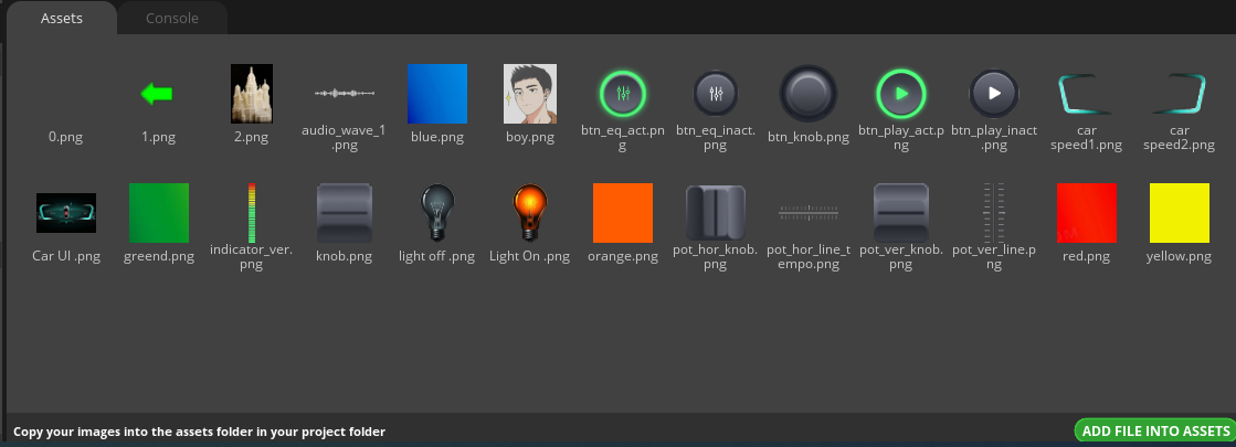

Note: Add the provided image material files first! (Add according to the actual material provided)

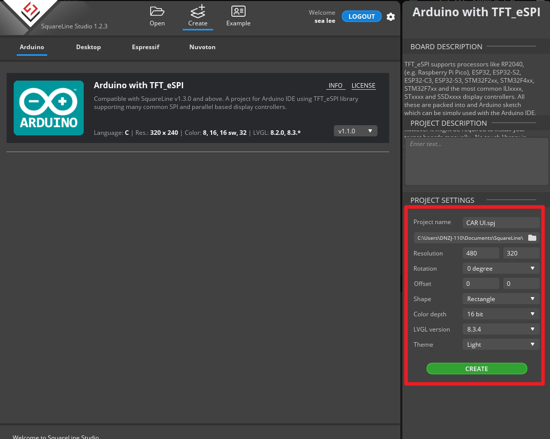

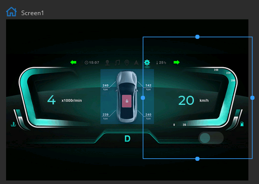

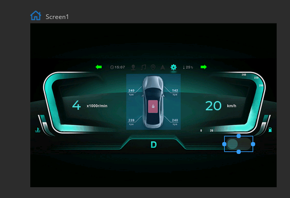

1 Create a new project in Squareline Studio as before. Firstly, select the Arduino module, and then do some simple settings for the project, such as the project name and display size (480*320), choose 16-bit color, etc. Click create to continue.

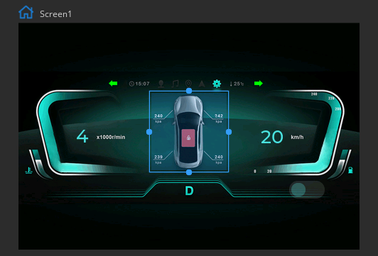

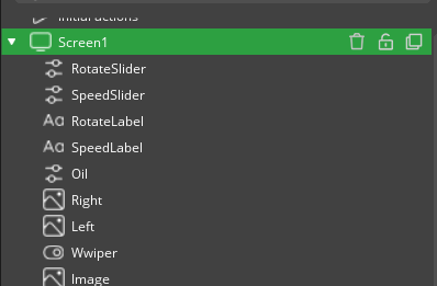

2 Add panels, labels, sliders, and image components, adjust and set their positions according to the diagram hierarchy.
3 Arrange each component in the correct position according to the diagram and add image material to the image components.

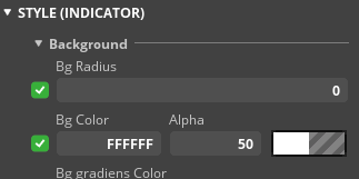

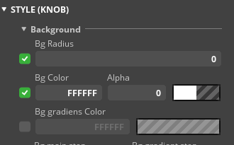

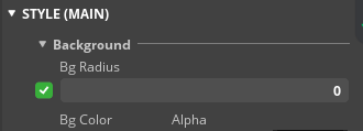

4 Make simple settings for the slider component:
①Set the main background color to transparent.
②Set the indicator and add a background image.

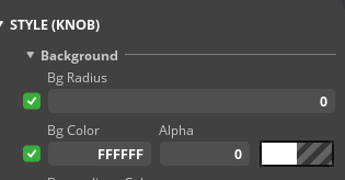

③Finally, set the KNOB.

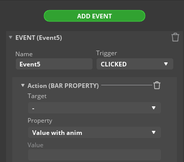

6 Set the two labels separately and change their values according to the values of the two sliders. Add an event in the Slider. Set the two labels the same way.

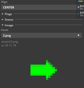

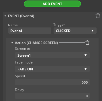

8 Set the left and right turn arrows. Use a transparent image and set the position, then add an event for both images and save them in the program.
9 Finally, set the added switch. Simply add an event.

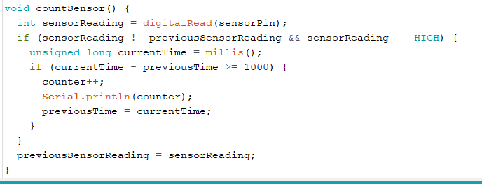

10 The slider slides according to the value of the counting sensor, displaying the RPM and vehicle speed. The data is only simulated and may differ from the actual data.
The counterSensor function checks the value of the counting sensor. The function details are as follows:

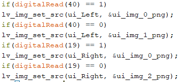

11 The left and right turn program. The turn image is displayed when the left or right touch sensor is triggered, and is not displayed when it is not triggered.

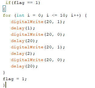

12 Windshield wiper servo control. When flag equals 1, trigger the servo to simulate the windshield wiper. The setting of flag is consistent with lesson 12. When the UI switch is triggered, set the value of flag to 1, otherwise set it to 0.

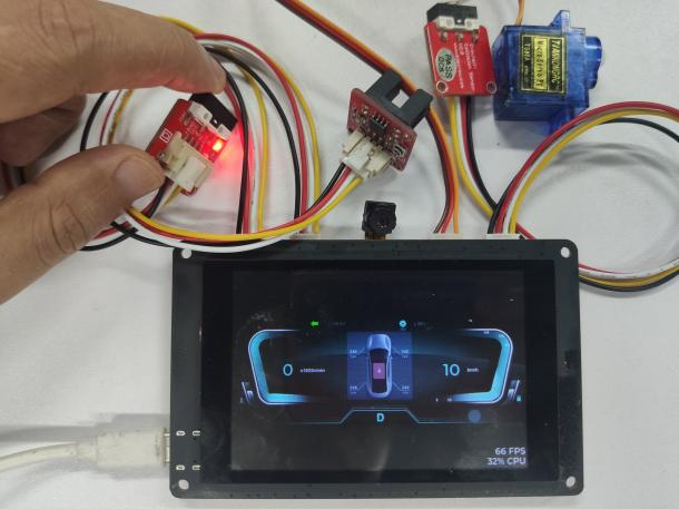

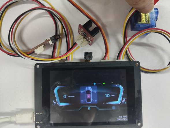

14-23.png Running effect:
After the program is successfully downloaded, check the effect on the screen.
