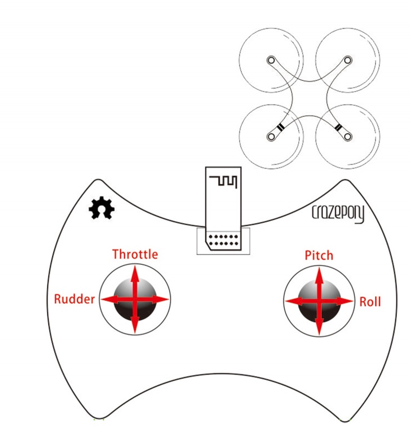

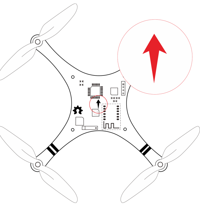

1.Place the Crazepony on a stable ground.The Arrow on the center of the PCB indicate the front.

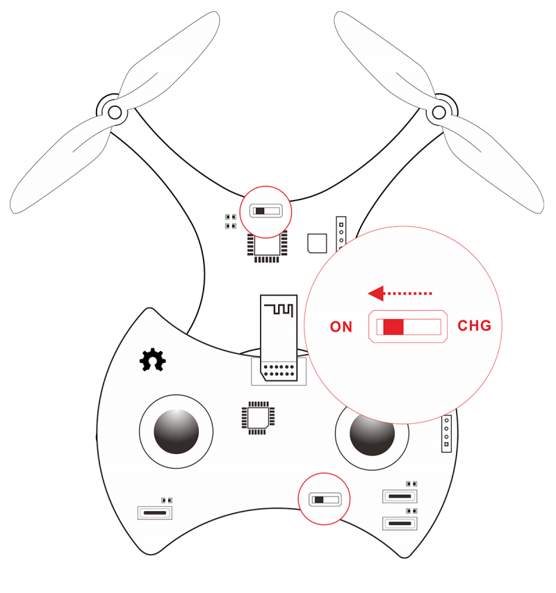

2.Firstly switch on the Crazepony RC, then quadcopter.About 10s later, blue LEDs on M1/M2 flashing,IMU is calibrated.

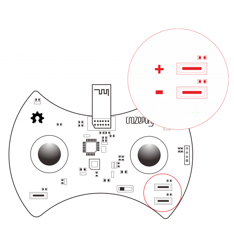

3.Press the "-" button on RC to start IMU calibration.Press the "+" button on RC to start the motors.
4.Push the throttle on the left joystick to take off.Press the "+" button again to stop motors after landing.
