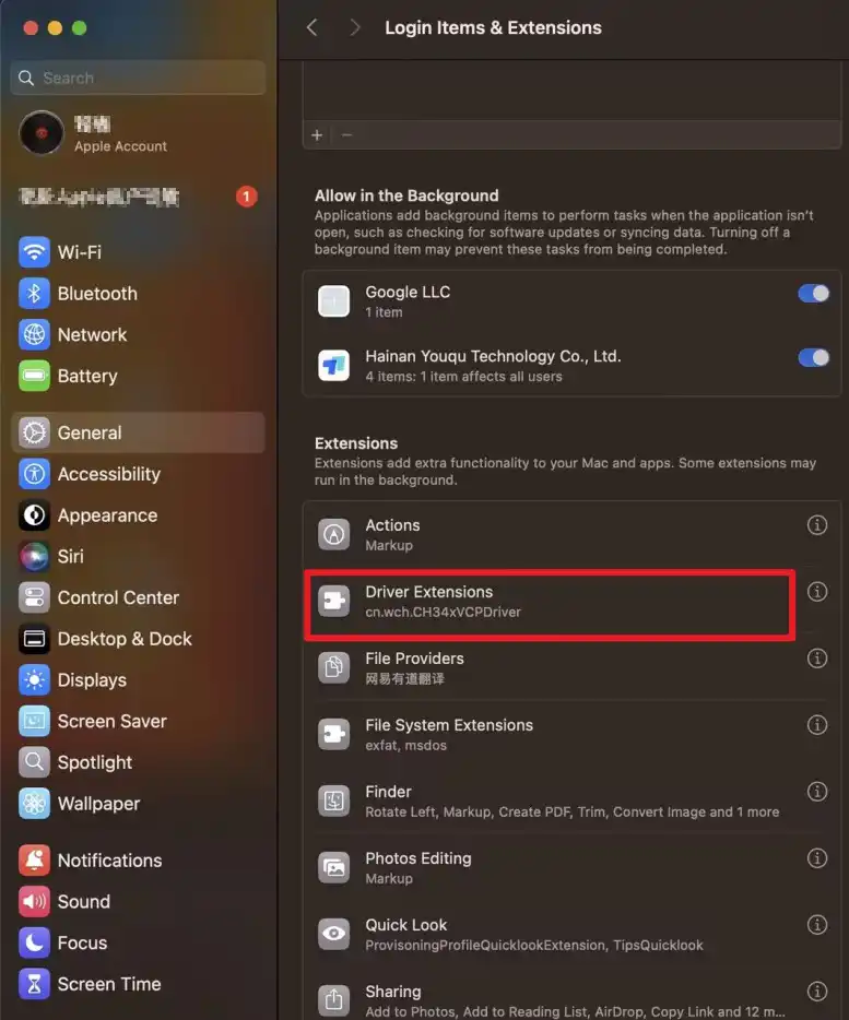

Regarding situations where serial ports remain inaccessible after installing drivers on a Mac, the following settings must be configured on the Mac:
  1. After installing the CH341 serial port driver, navigate to System Preferences.Click Login Items & Extensions.
mac-uart-1
2.Click Driver Extensions.

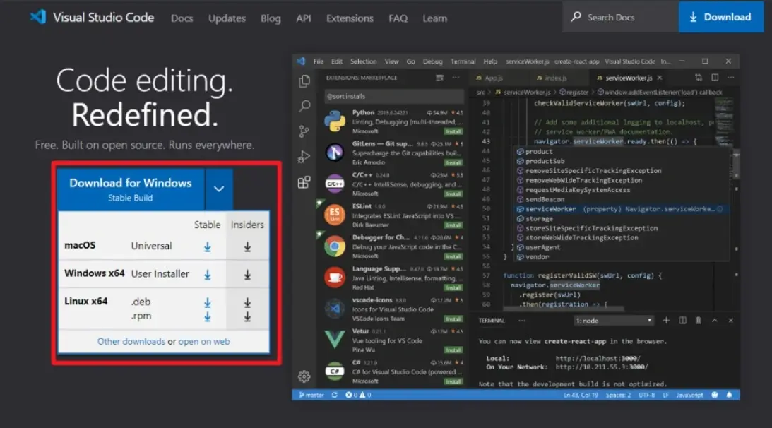

Vs code Installation
(1) First, download Visual Studio Code from https://code.visualstudio.com/. Select the version compatible with your computer's operating system and download it.
P4-idf-1

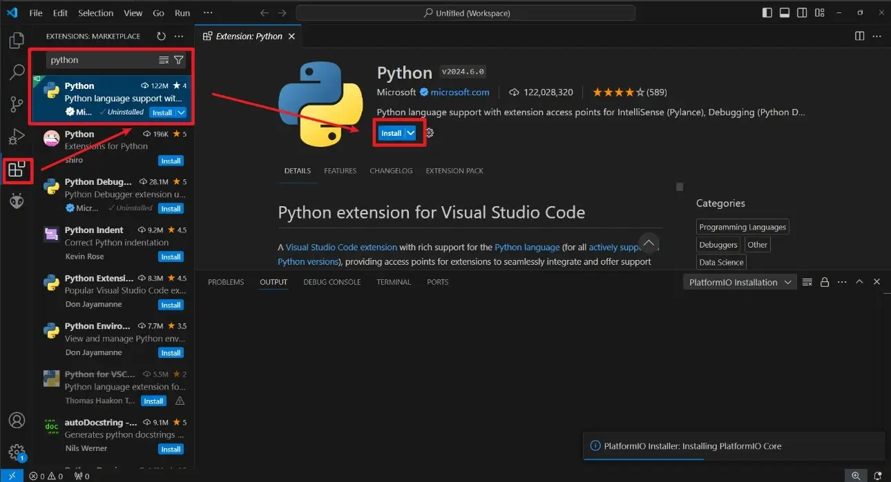

(3)Open Visual Studio Code, click on ‘Extensions’, search for Python, and install it.
P4-idf-6
