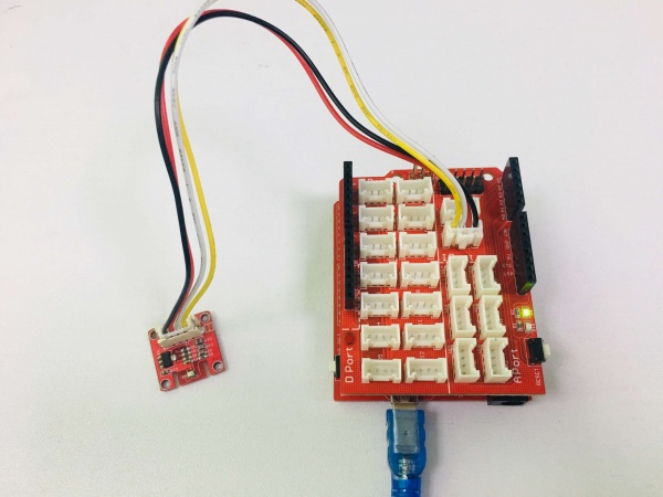

1. Plug it onto the IIC port of Crowtail - Base Shield using a Crowtail cable.
2.Plug the Crowtail - Base Shield onto Arduino.
3. Connect Arduino to PC by using a USB cable.

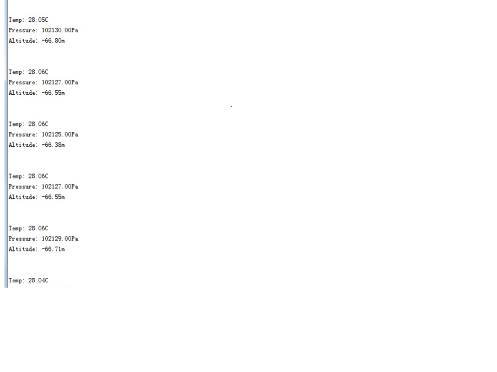

5.When you upload the code complete,you can see the result via the serial port debug window
