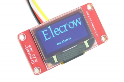

Crowtail- OLED is constructed from 128 x 64 dot matrix OLED module. The display offers high brightness, self-emission, high contrast ratio, slim/thin outline, wide viewing angle, wide temperature range and low power consumption.

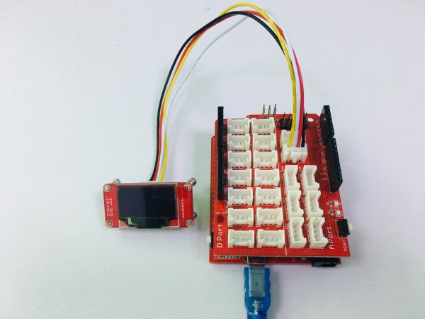

1.Hardware connection
Connect the Crowtail- RGB-LED to I port.
2.Connect the board to PC using USB cable.
3.Download the library OLED library;Unzip it into the libraries file of Arduino IDE by the path: ..\arduino-1.0.1\libraries.
4.Open the code directly by the path:File -> Example ->U8glib->Ele_0_96_12864.

5.Upload the Code,you shoule see the display of OLED.
