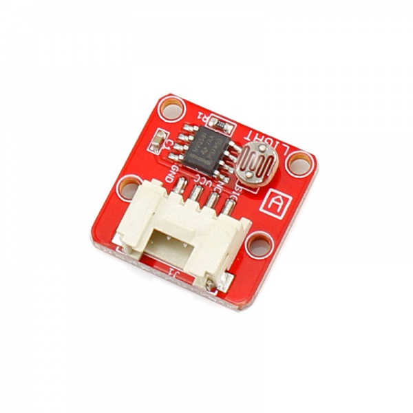

The Crowtail- Light Sensor module incorporates a light dependent resistor (LDR), is a commonly used sensor in a wide variety of applications from DIY projects to industrial automation. Typically, the resistance of the LDR or Photoresistor will decrease when the ambient light intensity increases. This means that the output signal from this module will be HIGH in bright light, and LOW in the dark.

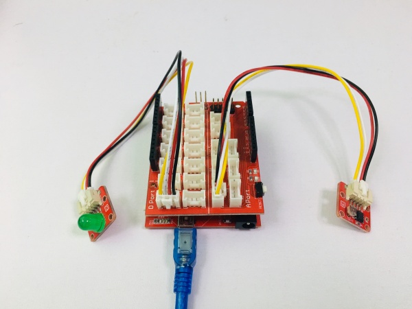

Follow these simple steps to build a Crowtail circuit using the light sensor:
1.Hardware Connection
2.Upload the following sample sketch to make the LED turn ON and OFF based on input from the light sensor:

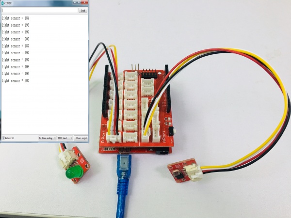

  Serial.print("light sensor = " );
 Serial.println(sensorValue);
 delay(500);

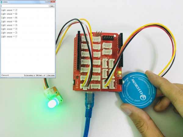

3.When the light value lower than 100,the LED will lights up:
