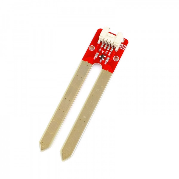

This Moisture Sensor can be used to detect the moisture of soil or your pet plant's water level, let the plants in your garden reach out for human help. It is connected to Analog I/O port.
Model: CT0007MS
Features¶
- Soil moisture sensor based on soil resistivity measurement
 - Easy to use
Specification¶
Dimensions(mm):80.0(L)x20.0(W)x6.8(H)

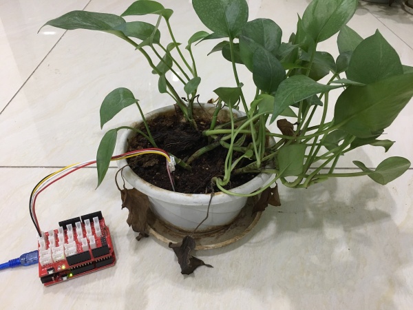

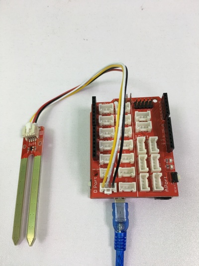

1.Connect this module to one of analog port A0 of Crowtail - Base Shield with the 3 pin Crowtail cable, and then insert the Sensor into the soil or place it anywhere you want.
2.Plug Crowtail - Base Shield into the Arduino/Crowduino and connnect Arduino to PC via a USB cable.
3.The hardware installation as shown below:

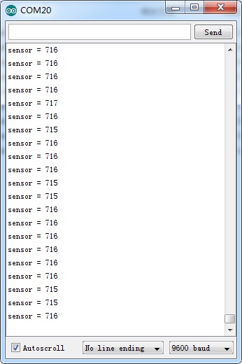

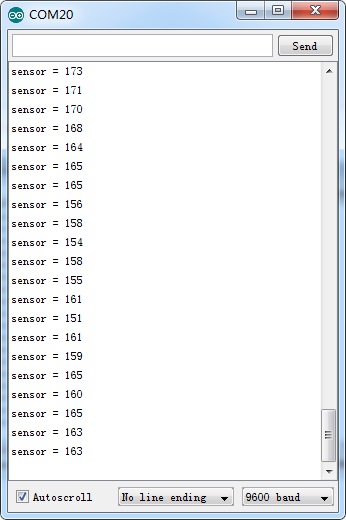

5.The Result in different condition after open the serial monitor:
