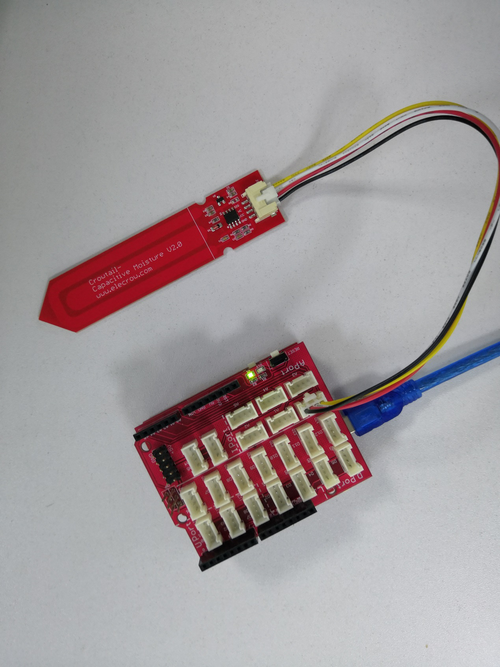

1. Connect this module to one of analog port A0 of Crowtail - Base Shield with the 4 pin Crowtail cable
2. Plug Crowtail - Base Shield into the Arduino/Crowduino and connnect Arduino to PC via a USB cable.
3.The hardware installation as shown below

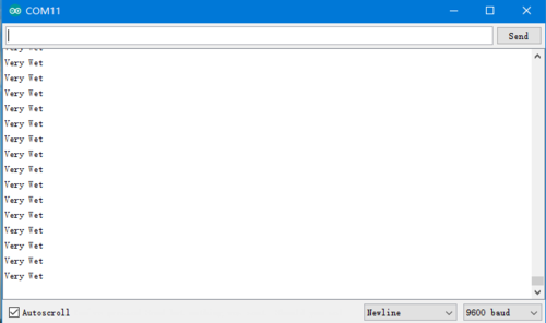

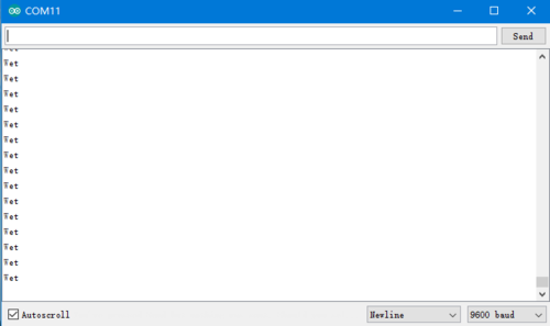

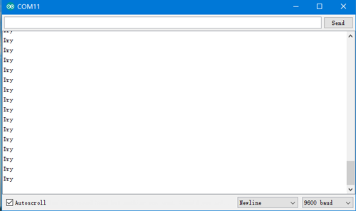

6.The result in different condition after open the serial monitor:
