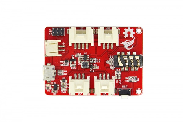

The 32U4 with A7 GPS+GSM/GPRS Board is based on Mega32U4 and A7 GPS+GSM/GPRS module. It can be used to make a call, send text messages and get GPS positioning. Also it has one analog interface, one IIC interface and two digital interface, which you can connect to other expansion modules. It is very easy for you to make a GPS Tracker by using this board.
Features¶
- ATMEGA32U4+A7.
 - Work voltage: 3.3V to 5V.
 - Operating temperature: -30 ℃ to + 80 ℃.

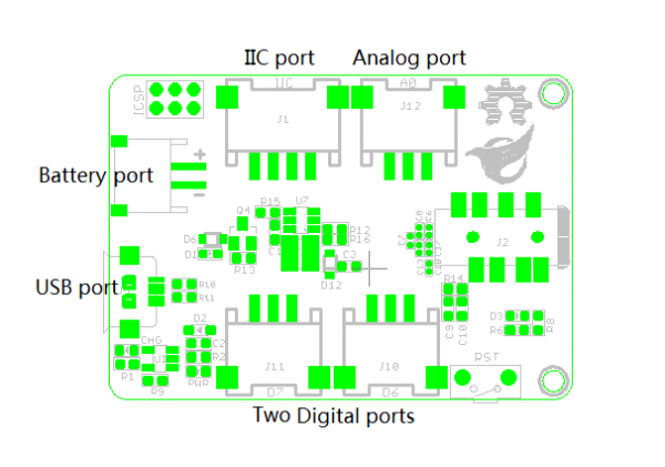

 - Three kinds of interface.
 - Equipped with 3.5mm headphone jack.
 - 3.7V Battery power supply.
 - Standby average current 3ma or less.
 - Support the GSM / GPRS Quad-band, including 850,900,1800,1900MHZ.
 - Support China Mobile and China Unicom's 2G GSM network worldwide.
 - GPRS Class 10.
 - Sensitivity < -105.
 - Support GPS Positioning.
 - Support for voice calls.
 - Support for SMS text messaging.
 - Support GPRS data business, the maximum data rate: download 85.6Kbps, upload 42.8Kbps.
 - Supports standard GSM07.07, 07.05 AT commands and Ai-Thinker extended commands.
 - Supports two serial ports, a serial port to download an AT command port.
 - Support for Global Positioning System.
 - Horizontal positioning accuracy of less than 2.5m.
 - AT command supports the standard AT and TCP / IP command interface.
 - Support digital audio and analog audio support for HR, FR, EFR, AMR speech coding.
 - Support ROHS, FCC, CE, CTA certification.

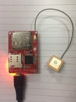

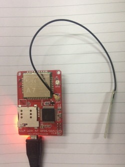

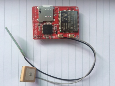

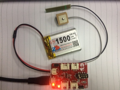

1. Install the antenna.
Two miniature coaxial RF connector is present on the back of the 32U4 with A7 GPRS/GSM/GPS Board to connect with a GSM antenna or a GPS antenna . The connector present on the 32U4 with A7 GPRS/GSM/GPS is called a U.FL connector.The GSM Antenna supplied with the GPRS Shield has an SMA connector (and not an RP-SMA connector) on it.The connection topology is shown in the diagram below:
2. Insert the Micro SIM card into the SIM card holder.
There is a SIM card holder on the back of the board. Both 1.8 volts and 3.0 volts SIM Cards are supported by this board, the SIM card voltage type is automatically detected.
3. Connect the battery.
Because the PC USB port output current is not enough,so you should connedct an 3.7V lithium battery to the battery port.

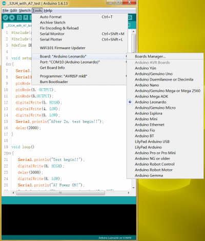

4. Upload the code
Open your Arduino IDE, choose the file, choose the Arduino Leonardo Board. You can refer to this test code and upload it to your board: 32U4_with_A7_test

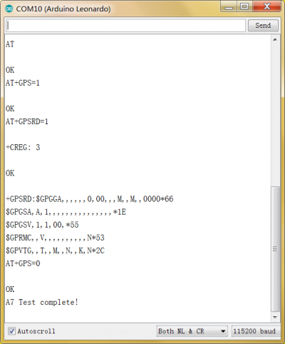

After you complete download the code, open the Serial monitor, you will see some information as bellow:
