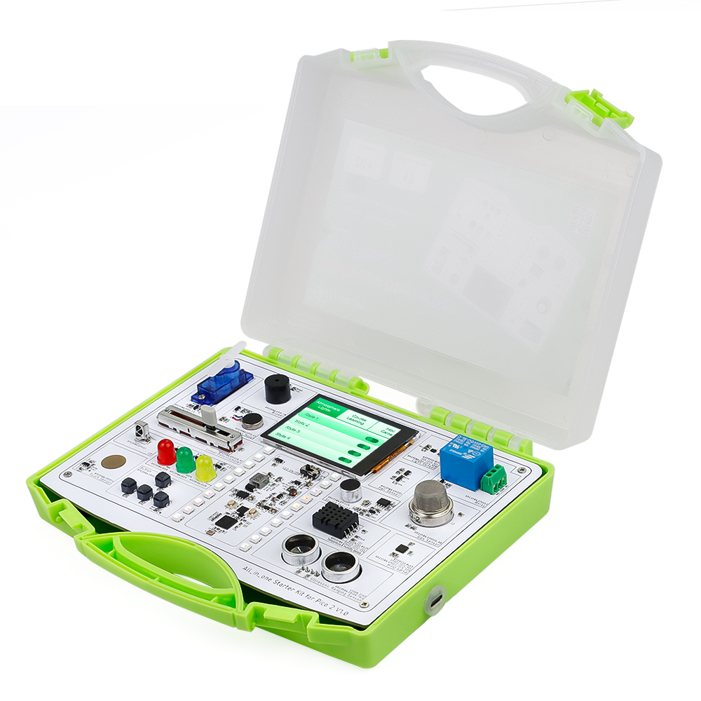

All-in-one Starter Kit for Pico 2 with Common Board design¶
Description¶
The All-in-one Starter Kit for Pico 2 is a perfect starter kit designed for beginners to start the learning journey of Pico 2 in a fun and simple way. The kit integrates 17 sensors with different functions on a single board and is equipped with a 2.4-inch TFT full-color touch screen. It does not require soldering or wiring and is ready to use out of the box and quick to get started. In addition, the kit contains more than 20 creative tutorials from the simplest to the most advanced, which gradually help users familiarize themselves with sensors, exercise logical thinking, and inspire creativity. The portable suitcase is compact and easy to carry, suitable for learning anytime, anywhere. 20 programmable full-color atmosphere lights and built-in mini-games allow seamless switching between learning and entertainment.
Whether students, teachers or hardware enthusiasts, this kit can quickly master the programming basics of Pico 2 and open a new chapter in the creation of smart hardware.
Model SEP0005K
Features¶
- 17 sensors with different functions integrated on a single board, with more than 20 creative tutorials;
- Common sensor board design, no need to solder wires, ready to use out of the box, quick to get started;
- Well-designed portable suitcase, small and exquisite, easy to carry;
- 2.4-inch TFT full-color touch screen;
- 20 full-color atmosphere lights, programmable to add display forms;
- Built-in mini-games that can be played right after booting, allowing seamless switching between learning and entertainment
Specification¶
- Main Processor IC: RP2350A
- Interface: Type-C Interface
- Size: 195*170*46(mm)
- Material:PP(Non-toxic)
- Weight: 340g

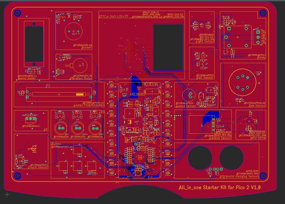

Pin Output:¶
PIN | define | appliance | ||
45 | IOVDD0 | |||
38 | IOVDD1 | |||
30 | IOVDD2 | |||
20 | IOVDD3 | |||
11 | IOVDD4 | |||
1 | IOVDD5 | |||
39 | DVDD0 | |||
23 | DVDD1 | |||
6 | DVDD2 | |||
46 | VREG_AVDD | |||
47 | VREG_PGND | |||
48 | VREG_LX | |||
49 | VREG_VIN | |||
50 | VREG_FB | |||
44 | ADC_VREF | |||
53 | USB_OTP_VDD | Internal USB PHY with OTP power supply 3.3V | ||
54 | QSPI_IOVDD | QSPI power 1.8-3.3V | ||
61 | GND | |||
21 | XIN | |||
22 | XOUT | |||
24 | SWCLK | debugging interface | ||
25 | SWDIO | |||
26 | RESET | Chip ResetTFT Screen Reset | ||
2 | GP0_LED_BK | LED_BK | ||
3 | GP1_PSRAM_CS | PSARM chip select | ||
7 | GP4/I2C0_SDA | TFT screen touch | ||
8 | GP5/I2C0_SCL | |||
4 | GP2/I2C1_SDA | Temperature & Humidity DHT20(0X38) MPU-6050(0x68) LIGHT SENSOR(0x5C) | ||
5 | GP3/I2C1_SCL | |||
9 | GP6_SPI0_CLK_TFT | TFT screen display | ||
10 | GP7_SPI0_MOSI_TFT | |||
27 | GP16_RS_TFT | |||
28 | GP17_SPI0_CS_TFT | |||
36 | GPIO24_TP_RST | |||
37 | GPIO25_TP_INT | |||
40 | GP26_A0_GAS | Smoke Sensor | ||
41 | GP27_A1_KEY | 4*button | ||
42 | GP28_A2_POT | Slide Potentiometers | ||
43 | GP29_A3_SOUND | Sound Sensor Module | ||
55 | QSPI_SD3 | W25Q64 NORFlash & APS6404L PSRAM | ||
56 | QSPI_SCLK | |||
57 | QSPI_SD0 | |||
58 | QSPI_SD2 | |||
59 | QSPI_SD1 | |||
60 | QSPI_SS | |||
51 | USB_D- | Type-c debugging interface for development boards | ||
52 | USB_P+ | |||
12 | GPIO8_US_ECHO | Ultrasonic Module | ||
13 | GPIO9_US_TRIG | |||
14 | GPIO10_BUZZER | BUZZER Module | ||
15 | GPIO11_IR | IR Module | ||
16 | GPIO12_RELAY | RELAY Module | ||
17 | GPIO13_SERVO | SERVO Module | ||
18 | GPIO14_TOUCH | TOUCH Module | ||
19 | GPIO15_VIB | Vibration Motor Module | ||
29 | GPIO18_LED_RED | LED | ||
31 | GPIO19_LED_GREEN | LED | ||
32 | GPIO20_LED_YELLOW | LED | ||
33 | GPIO21_HALL | Hall Sensor Modules | ||
34 | GPIO22_RGB | RGB LED*20 | ||
35 | GPIO23_RGB_EN |

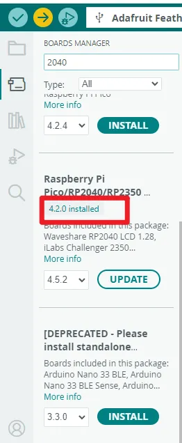

Compile Environment Configuration:¶
Follow this link to install the arduino environment, the arduino ide version can be chosen from the latest。¶
https://www.elecrow.com/wiki/Get_Started_with_Arduino_IDE.html
Our case was tested with version 4.2.0 of the Raspberry Pi Pico/RP2040/RP2350, so it is best to use version 4.2.0 when working with our case.¶

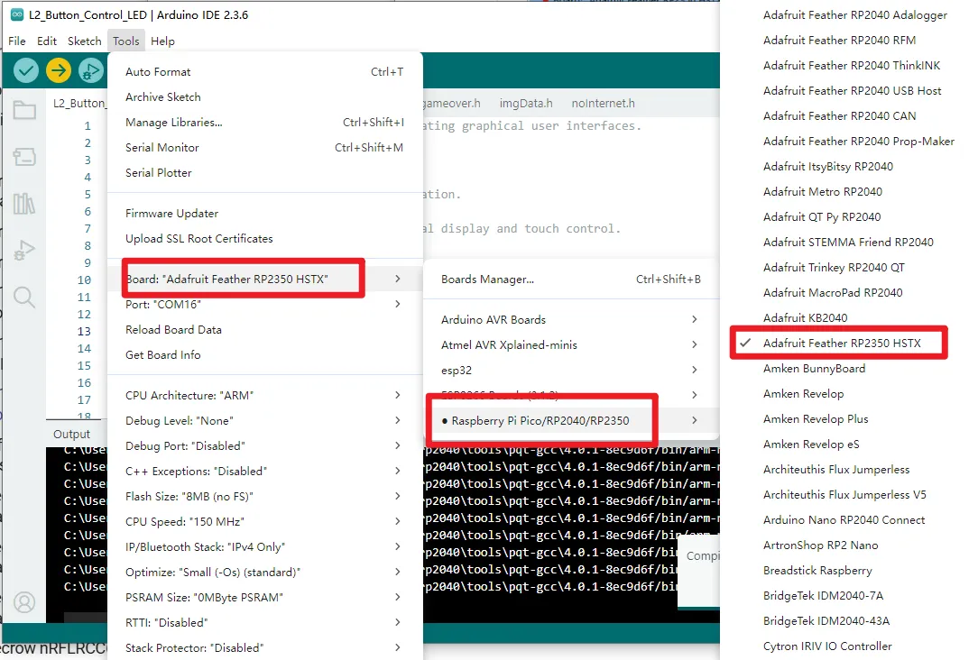

Select Motherboard:¶

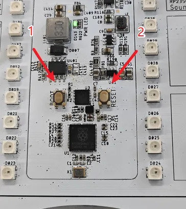

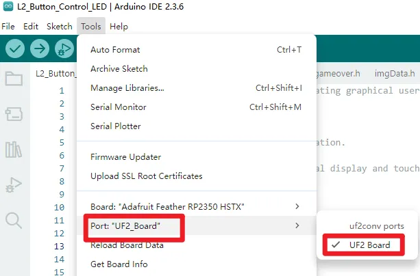

Note: How there is no serial number out, you need to long press the boot key, then short press the reset key and then release it, then release the boot key to force it to enter the burn mode:¶
