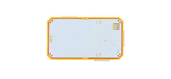

The Crowbits-NFC module (Near Field Communications) uses a highly integrated transceiver module PN532 which handles contactless communication at 13.56MHz. It is designed to use IIC (default) communication protocols. You can read and write a 13.56MHz tag with this module or implement point to point data exchange with two NFC Shields.

- Interface Type: I2C
 - Operating Voltage: 3.3V DC
 - Dimensions: 31.5(L)*24.5(W)*13(H)mm
