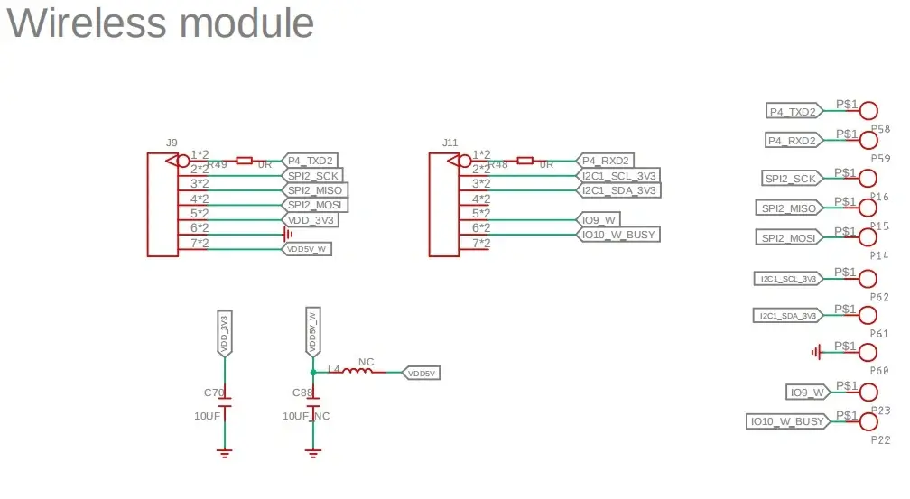

ESP32-P4 and wireless module wiring pins:
Output voltage: 3.3V Output current: 1A max. Use: The power supply communicates with the wireless module.
P4-9-sch-3
Pin connection
#define RADIO_GPIO_CLK 8
#define RADIO_GPIO_MISO 7
#define RADIO_GPIO_MOSI 6
#ifdef CONFIG_BSP_SX1262_ENABLED
#define SX1262_GPIO_BUSY 9
#define SX1262_GPIO_IRQ 53
#define SX1262_GPIO_NRST 54
#define SX1262_GPIO_NSS 10
#ifdef CONFIG_BSP_NRF2401_ENABLED
#define NRF24_GPIO_IRQ 9
#define NRF24_GPIO_CE 53
#define NRF24_GPIO_CS 54

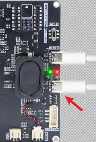

Introduction to UART 0 and USB 2.0:
Program downloads require the use of UART 0.
uart0+usb2.0-1

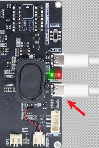

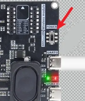

Note: Turn on the switch before use. Slide the POWER switch to the ON position.
uart0+usb2.0-3
If the program utilizes screen functions, power consumption will reach 8-10 watts. If powered solely by the computer's USB port, insufficient power may cause the screen to go black. It is necessary to connect a USB 2.0 port simultaneously for power supply.
uart0+usb2.0-2
If the UART0 connection does not display a serial port number, it may be due to missing serial port drivers. Download the CH341 serial port drivers and retest the connection.

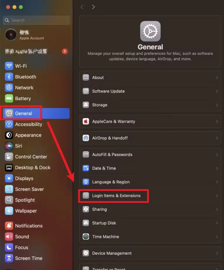

Regarding situations where serial ports remain inaccessible after installing drivers on a Mac, the following settings must be configured on the Mac:
  1. After installing the CH341 serial port driver, navigate to System Preferences.Click Login Items & Extensions.
mac-uart-1
  1. Click Driver Extensions.
mac-uart-2
  1. Click Open, then click Done to save the settings.
