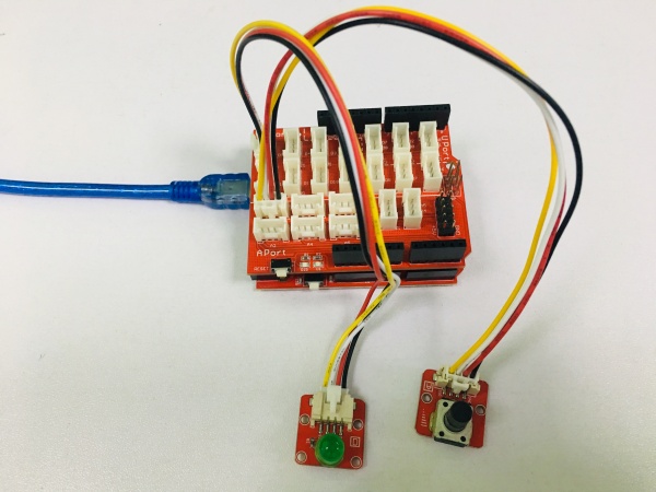

1.Hardware Connection The Rotary angle sensor is connecting to analog port A0 of Crowtail - Base Shield. A LED connecting to D5.

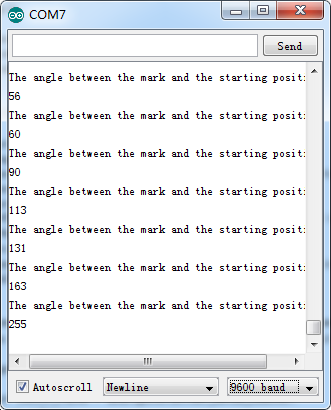

4. open the serial monitor to observe the change of angle data. And pay attention to the LED's brightness.
