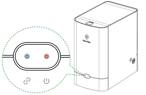

Working Status Indicators
| Status | Indication |
| Solid Blue | Network successfully connected |
| Quick flashing Blue | Network Connecting |
| Slow flashing Blue | Network connection failed |
| Solid Red | Sensor abnormality |
| Quick flashing Red | Water outlet is blocked |
| Slow flashing Red | Water shortage |
| Flashing Red and Blue | Waiting for network configuration |

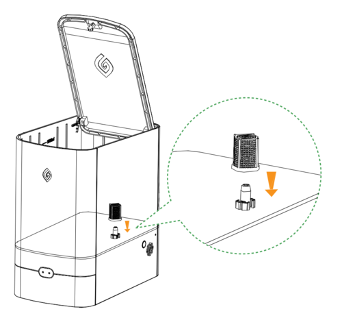

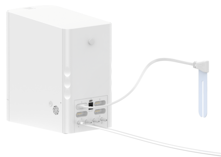

Install the filter, install the filter at the water inlet of the water tank, and insert it vertically as shown in the figure right.

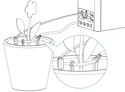

Connect the soil moisture sensor to the GrowCube and insert the other end into the soil. There are four sensor interfaces(Marked A to D) on the GrowCube, and you can connect a sensor to any one of them. For example, when using port a to water plants, connect the sensor to port A of the GrowCube(Pay attention to the buckle position of the sensor connector and device interface). Then insert the soil moisture sensor vertically into the soil, the insertion depth should be more than ⅔ of the sensor, and the sensor insertion position should be as close as possible to the rhizome of the plant.

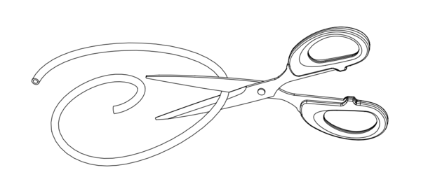

Cut water pipes based on the distance from GrowCube to plants.
Connect the cut water pipe to GrowCube. Note that when you use sensor “A” for the plant,you should use a water outlet “a” at the same time.

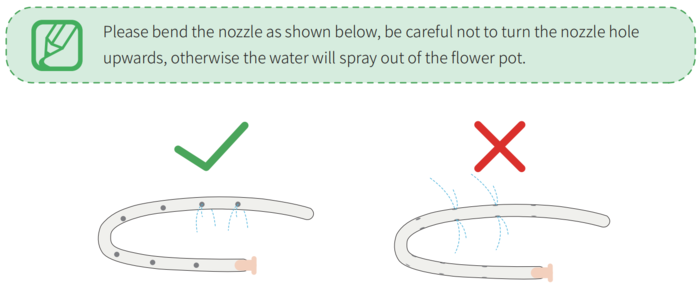

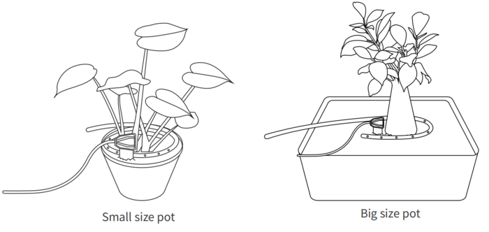

Bend the nozzle to fit the size of the plant disk so that the nozzle can reach the root area of the flower as much as possible.
Fill the GrowCube tank with water, being careful not to exceed the maximum level.

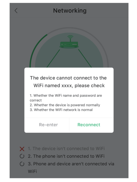

① Whether the device has been connected to the home/office WiFi ,
 ② Whether the phone has also been connected to the corresponding home/office WiFi ,
 ③ Whether the device and the phone have established connections through the home/office WiFi .
 If the first step fails, the interface will pop up as follows, and you can choose to re-enter or reconnect. Re-entering will return to the WiFi Configuration page and re-enter the WiFi name and password. If you choose to reconnect, it will try to connect again using the current saved WiFi name and password.
 If the second step fails, the interface will pop up as follows, you need to disconnect the WiFi connection between the mobile phone and GrowCube and then connect to the current home/office WiFi.
 If the third step fails, the interface will pop up as follows, you can choose to reset or reconnect. Resetting will re-enter the Mode Selection page. Reconnecting is to return to the page and perform three rounds of connection attempts and detection again. If the above three steps are completed, the configuration is successful.

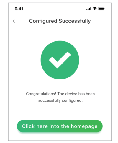

- After the network configuration successfully saved, enter the Configured Successfully page and generate the device name. The name can be renamed according to your preferences. At this time, the blue indicator on the front of GrowCube is solid.
- Click "Click here into the homepage" to enter the Home page of the GrowCube APP and start your smart maintenance journey.

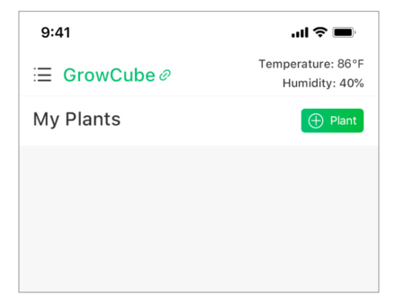

- 1. Add Plants
On the Plants page,click
to add plants. Do not add exceed four plants. ![]()

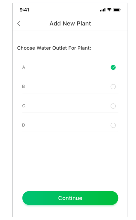

- 2. Choose Water Outlet
According to the soil moisture sensor interface and water outlet used by the added plant, select the corresponding watering outlet in the APP. Note that the soil moisture sensor interface should be paired with the water outlet. In this example, the soil moisture sensor of A is used, so it is necessary to choose a as the plant watering outlet accordingly.

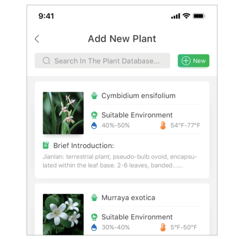

- 3. Choose Plant
Enter "plant name" in the search box, and when you find the plant, click to select it.

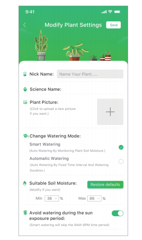

- 4. Choose Watering Mode For Plant
Choose the watering mode according to your need. ![]()
- 5. Save Settings And Start Smart Watering
Give the plant a nice nickname, such as "my beauty" and click Save to start planting. If you choose the smart watering mode, you can also choose whether to avoid watering during the sun exposure period. Turn on the switch and the device will not water from 9AM-6PM every day.

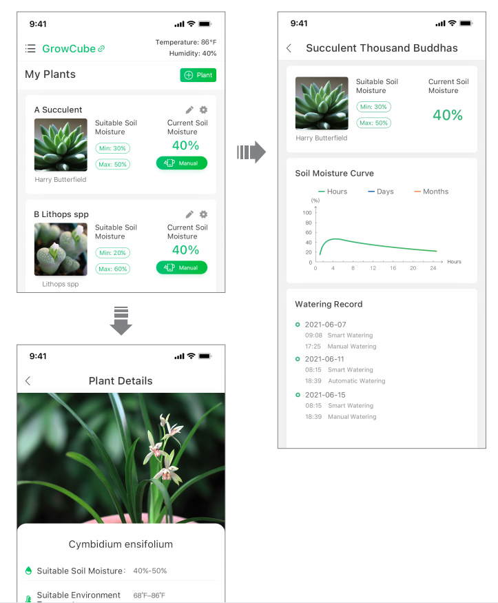

 Back to the Plants page, you can see all the plants being planted. Click on the blank space except for the plant name and plant picture to enter the detailed page of the plant's watering status. Click on the plant name or plant picture to enter the detailed introduction page of the plant.

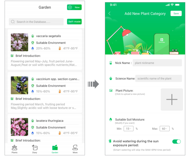

- *6. Add New Category
If the plant is not found in the plant database, please go to the Garden first, and then click to
add a new plant category. Enter the plant nickname, scientific name and take a photo of the plant. After customizing the suitable humidity range, click "Save". Go back to the Plants page
and click to enter Add Plant page. You can find the plant in the
 list. After selecting it, click "Save" to add the plant successfully.
