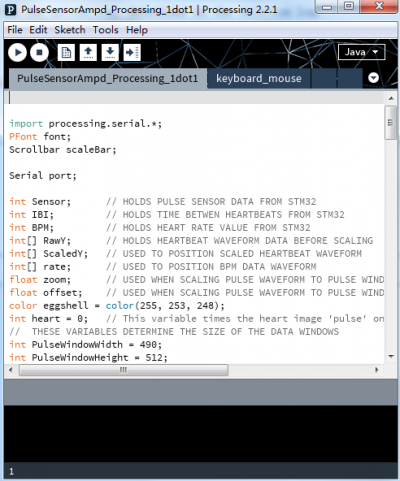

3.Download the upper computer software processing.Unzip it,and open the processing.exe,then file—open,you should download the file:processing_code.Unzip it and open the file:PulseSensorAmpd_Processing_1dot1.pde

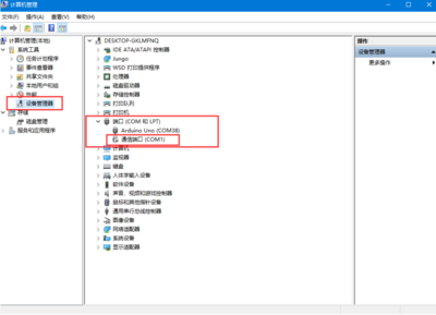

4.Open the device manager of the computer and check whether there's a port named COM1. If there is a COM1 port, please disable it;

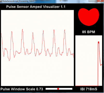

5.Run the Processing software. Put you finger on the pulse sensor area of the heart shape.You will see that your heart rate and heart rate waveform(electrocardiogram)
