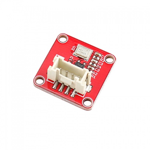

The Crowtail- MEMS Microphone is a simple and easy-to-use microphone for a variety of sound-sensing projects. The on-board mic is an ADMP401, which is a low-power, omnidirectional microphone with an analog output. It works for both near and long-range uses and is particularly good for portable applications due to its low power consumption. The amplifier’s AUD output will float at one half Vcc when no sound is being picked up. The amplifier produces a peak-to-peak output of about 200mV when the microphone is held at arms length and is being talked into at normal conversational volume levels. So the AUD output can easily be connected to the ADC of a micro.
Model: CRT00238M
Features¶
Low-power, omnidirectional microphone
Both near and long-range uses
Mic: ADMP401
volatog:5v
current: 250 μA.

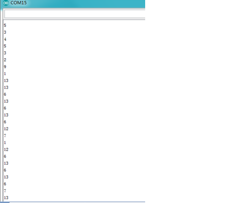

Upload the code and open the serial monitor. You an observe the data is changing when you making the sound on the Microphone.
