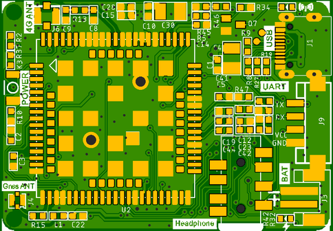

| Name | Interface/Function Definition |
| USB-C | USB-C interface, used for the power supply of the development board and the communication interface between the PC and the development board. |
| UART | None |
| BAT | Battery charging interface |

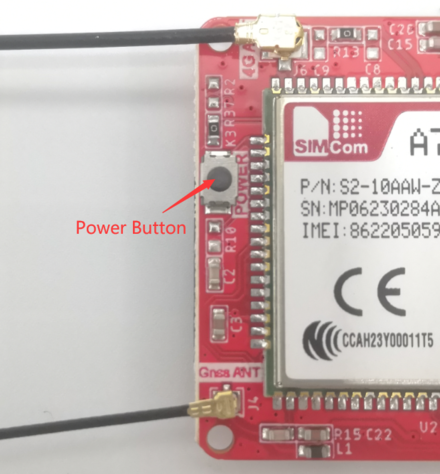

| POWER | Power button. It needs to be pressed for 1 second to let the development board enter the working state. |
| SIM Card Slot | None |
| 4G ANT | None |
| GNSS ANT | None |

1. Connect Crowtail 4G SIM-A7670E to the computer, and press and hold the onboard power button for 1 second. After the network indicator lights up, open the device manager and check whether the driver of Crowtail_4G SIM-A7670E is installed.

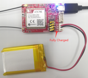

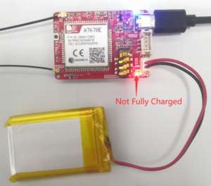

As shown in the figure below, connect the lithium battery to the BAT port of the Crowtail_4G module, and at the same time plug the USB end into a 5V power supply, and observe whether the charging indicator light is red. If the red light is normally on, it means that it is charging. Check whether the battery is correctly inserted into the BAT socket; the red light will turn off automatically after charging is completed.
