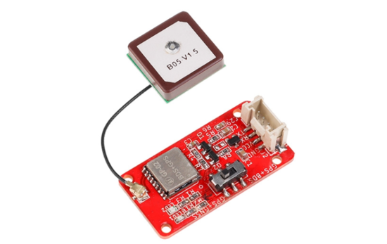

The Crowtail - GP02 module is a cost-effective and field programmable gadget. The high-performance BDS/GNSS multi-mode satellite navigation receiver SOC module, integrates RF front-end, digital baseband processor, 32-bit RISC CPU, power management and active antenna detection and protection functions. It supports a variety of satellite navigation systems, including China's Beidou satellite navigation system BDS, the United States' GPS, and Russia's GLONASS, and can realize multi system joint positioning. Model: CRT01140G
Features¶
- Field programmable
 - With 32-bit RISC CPU
 - Supports BDS, GPS, GLONASS
 - Low power consumption
 - High sensitivity and high-precision
 - Can switch between GPS+BDS and GPS+GNSS modes
 - Outdoor positioning
 - Crowtail Indicates the compatible interface
Specification¶
- Operating voltage: DC 2.7V ~ 3.6V
 - Default baud rate: 9600
 - Interface type: UART
 - Navigation Sensitivity: -160dbm
 - Positioning accuracy: <2m(1σ)
 - BDS/GPS dual mode continuous operation power consumption: 23mA
 - Size(mm):40.0(L)x20.0(W)x9.7(H)
 - Time to first start: Cold start: 32s ;Warm start: <1s; Hot start: <1s

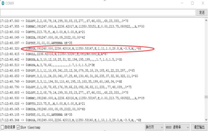

 STEP5 After the program is burned, open the serial monitor of Arduino IDE. Select 9600 baud rate, and the monitor will display the data returned by the GPS module. ![]()
Data analysis
$GNGGA,(1),(2),(3),(4),(5),(6),(7),(8),(9),M,(11),(12)*HH(CR)(LF)
(1)UTC time,format: hhmmss.ss;
(2)Latitude, format: ddmm.mmmmm;
(3)Latitude hemisphere, N or S;
(4)Longitude, format: dddmm.mmmmm;
(5)Longitude hemisphere, E or W;
(6)GPS status, 0=no positioning, 1=non differential positioning, 2=differential positioning;
(7)Number of satellites in use for positioning (00~12)
(8)HDOP horizontal accuracy factor(0.5~99.9)
(9)Altitude(-9999.9~9999.9 meters)
(10)Geoid height(-9999.9~9999.9 meters)
(11)Differential time (seconds since the last time differential signal was received, non differential positioning, this item is blank)
(12) Differential reference base station label (0000 to 1023, the first 0 will also be transmitted, non differential positioning, this item is blank)
GPVTG ground speed information
$GPVTG,<1>,T,<2>,M,<3>,N,<4>,K,<5>*hh<1> Ground heading with due north as reference datum (000~359 degrees, the previous 0 will also be transmitted)
<2> Ground heading with magnetic north as reference (000~359 degrees, the previous 0 will also be transmitted)
<3> Ground speed (000.0-999.9 knots, the previous 0 will also be transmitted)
<4> Ground speed 0000.0 - 1851.8 km/h, the previous 0 will also be transmitted)
<5> Mode indication (only NMEA0183 version 3.00 output, A=autonomous positioning, D=differential, E=estimation, N=invalid data
GPGSV visual satellite status
Standard format: $GPGSV, (1), (2), (3), (4), (5), (6), (7),...) 5), (6), (7)*hh(CR)(LF)(1) Total number of GSV statement messages; 2;
(2) Current GSV full stop: 1;
(3) Total number of visible satellites: 08;
(4) PRN code (pseudorandom noise code) can also be considered as satellite number
(5) Elevation (00~90 degrees): 33 degrees;
(6) Azimuth (000~359 degrees): 240 degrees;
(7) Signal to noise ratio (00~99dB): 45dB (followed by the information of satellites 10, 16 and 17);
Sum check field;
hhChecksum: 78;
