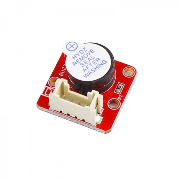

The buzzer module is for making sound in your project. It sounds when activated by a logic HIGH signal. Connect the buzzer to any of the D(digital) ports of Crowtail- Base Shiled, you can easily make it sounds with setting the related ports to logic HIHG. The buzzer module can be also connected to an analog pluse-width modulation(PWM) output to generate various of tones.
Model: CT0003BU
  • Easy to use piezoelectric buzzer
  • Standard 3-pin Crowtail Cables
  • Operating Voltage: 5V
  • Sound Output: ≥85dB
  • Resonant Frequency: 2300±300Hz
  • Dimensions(mm):20.0(L)x20.0(W)x9.8(H)

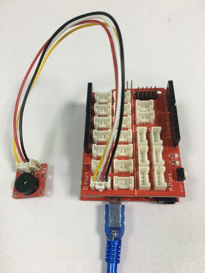

1.Hardware connection Use the Crowtail - Base Shield and connect the Crowtail - Buzzer module to the shield using a designated Crowtail Interface as shown below:
