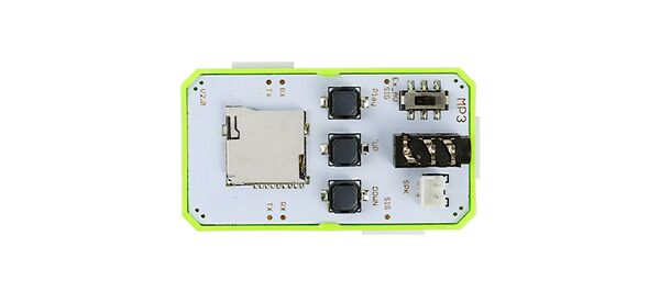

MP3 is a tiny-size and compact audio module. This module also supports general file systems like FAT16 and FAT32.

1.Playing music¶
1)You also need a power module, such as Crowbits-Power Supply; A SD card containing songs in mp3 format; A 2PIn interface speaker.
2)Insert the SD card into the holder and connect the speaker to the “Speaker seat".
3)Turn the toggle switch on the Crowbits-MP3 board to the "Audio" position.
4)The connection mode is shown in the figure.
5)Turn on the power.
You could press the “PLAY” button on the Crowbits-MP3 board, which can play and pause songs.
You could press the “UP” button on the Crowbits-MP3 board, which can switch to the next song.
You could press the “DOWN” button on the Crowbits-MP3 board, which can switch to the previous song.
You could long-press the "UP" button on the Crowbits-MP3 board, which can increase the volume.
You could long-press the "DOWN" button on the Crowbits-MP3 board, which can lower the volume.
