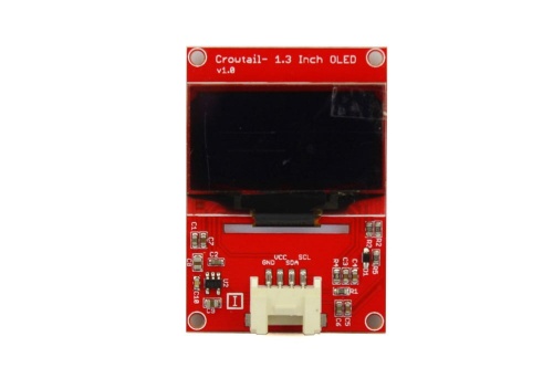

Crowtail- OLED is constructed from 128 x 64 dot matrix OLED module. The display offers high brightness, self-emission, high contrast ratio, slim/thin outline, wide viewing angle, wide temperature range and low power consumption.
Model: CRT01112O
Features¶
Connection Mode:I(IIC)
Voltage: 5V
Display Color:Blue/Black
Resolution:128x64
Interface:I2C
Wide range of working temperature: -20°C~70°C
Dimensions(mm):50.0(L)x35.0(W)x6.8(H)
