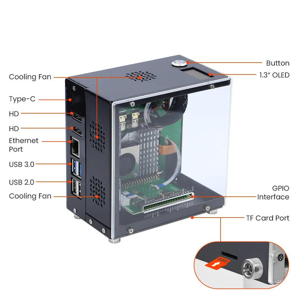

This Mini PC case is a versatile, DIY enclosure solution designed for Raspberry Pi 5 and Jetson Orin Nano single-board computers. The design concept of this chassis shell is to provide users with an integrated, high-performance, and easy-to-expand hardware platform.
Specification¶
Compatible Device | Raspberry Pi 5/Jetson Nano(Optional) |
Screen | 1.3” OLED |

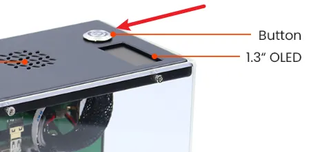

Power Button | Yes |
SSD Support Type(Raspberry Pi ) | Solid state 2230,2242,2260,2280 |
Material | Aluminum alloy + acrylic |
Power Supply(Raspberry Pi) | 5V 5A |
Power Supply(Jetson Nano) | 12V 2A |
Fan | 3x Cooling Fans |
Dimension | 120*120*72mm |

Press Power to turn on the device:

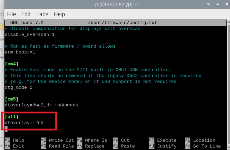

Modify the contents of config.txt¶
sudo nano /boot/firmware/config.txt Add "dtoverlay=i2c0" to the last line of config.txt, save it.
sudo nano /boot/firmware/config.txt Add "dtoverlay=i2c0" to the last line of config.txt, save it, and then restart the system.
Then restart the system.

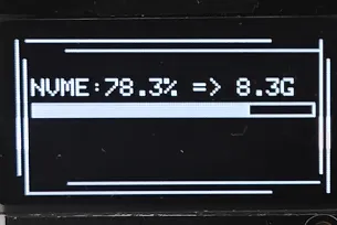

You can see different statuses about your computer on oled. It shows time, temperature, CPU and memory utilization.
