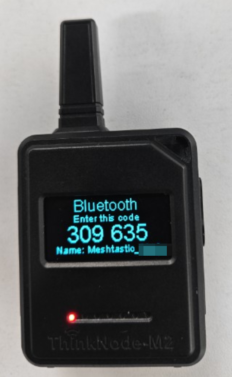

Elecrow ThinkNode-M2 is a high-performance LoRa signal transceiver. It uses the ESP32-S3 module as the main processor and supports Bluetooth. Users can easily configure and monitor the device through their mobile phones. M2 is pre-installed with Meshtastic firmware and equipped with an SX1262 wireless chip, which can efficiently send and receive LoRa signals to ensure the reliability and stability of communication. In addition, M2 is perfectly compatible with the official Meshtastic App. Users can use the App to implement parameter configuration, message communication, map and location sharing, network status monitoring, data recording and export, and custom settings.
The built-in 1**.3-inch OLED display** can display data and device status in real-time, which is convenient for users to view at any time. Built-in 1000mAh rechargeable battery supports long-term outdoor use. The LoRa antenna supports multiple frequency options to optimize communication performance further. The device adopts a modular design to facilitate embedded integration and custom development.

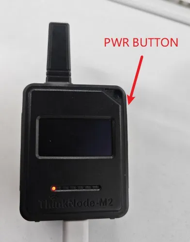

PWR indicator function¶
| Serial No. | Name | Signal | Master Signal | Color | Description | |
| 1 | Power indicator | PWR | IO1_LEDIO6CHGLED | IO1 | red | Ø Device powered on, indicator light is always on;  Ø With lithium battery charging, indicator light (fast blinking); charging is complete, indicator light is always on; Ø Low battery slow blinking; Ø Buzzer open alarm, indicator light blinking  |
Interface/Keypad Functions¶
| Serial No. | Name | Signal | Master Signal | Functions | |
| 1 | PWR Button | PWR | P3.3_IO4_POWER | IO4 | Short press to turn on/long press 3s to turn off power on, short press to rest the screen |

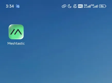

First go to the app store to download and install the Meshtastic APP

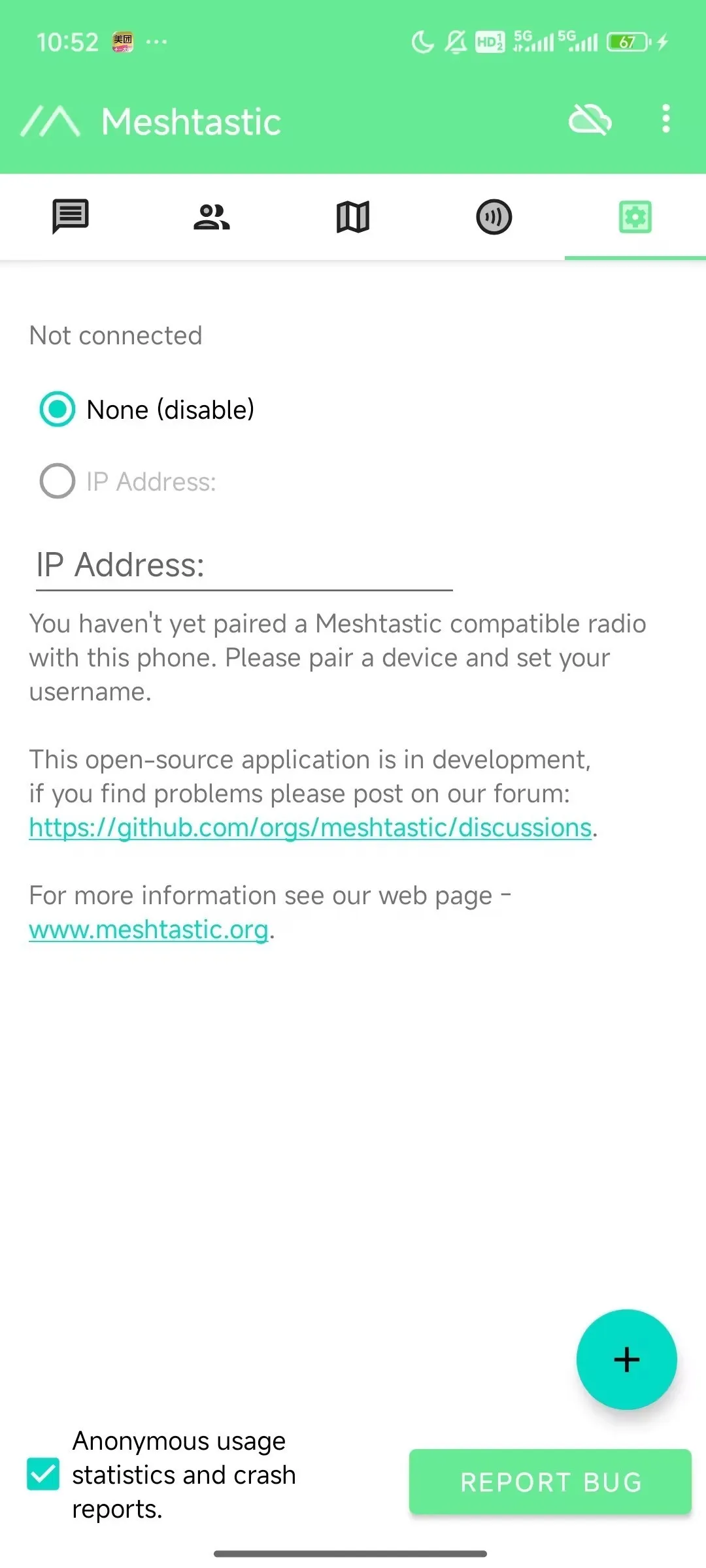

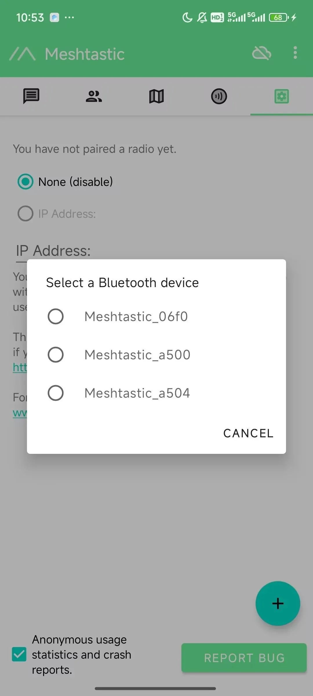

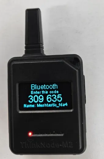

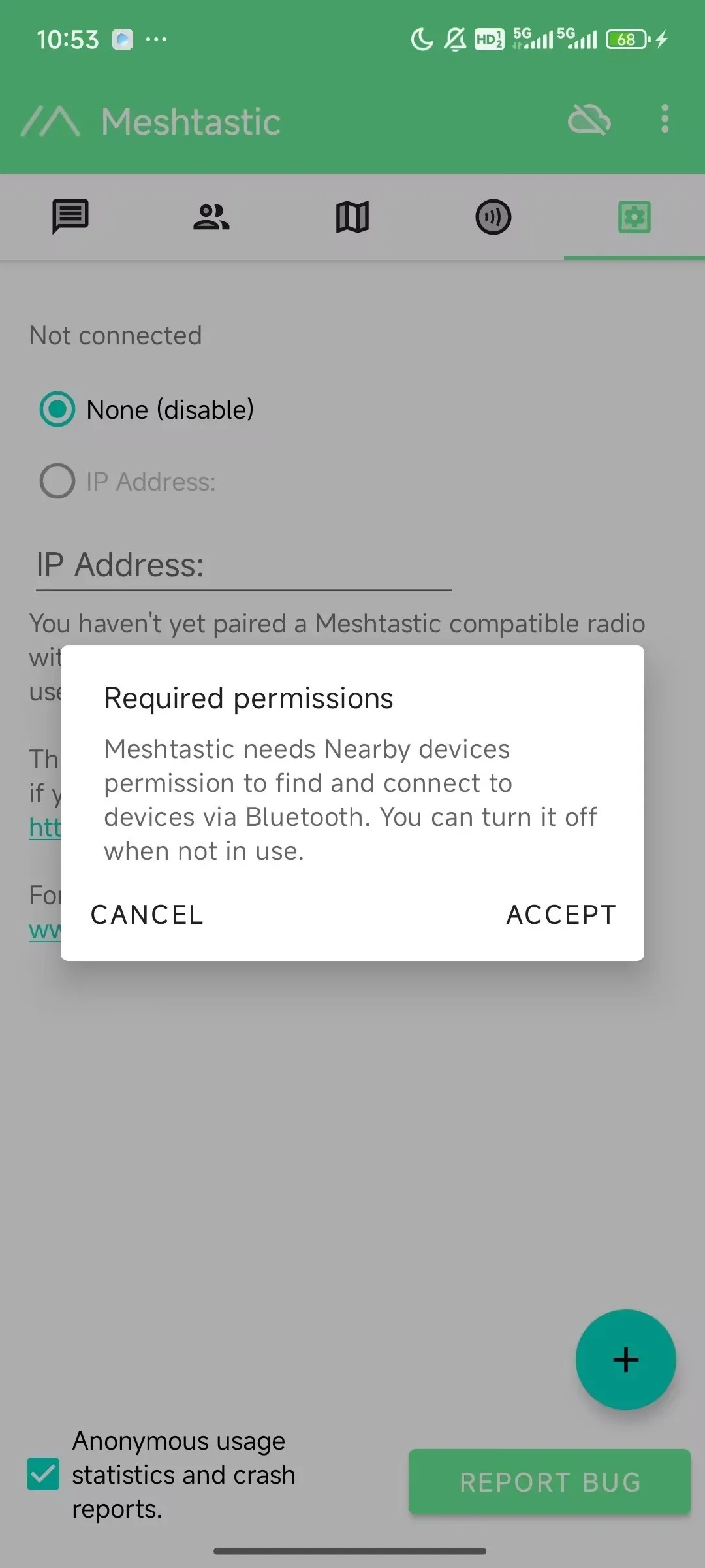

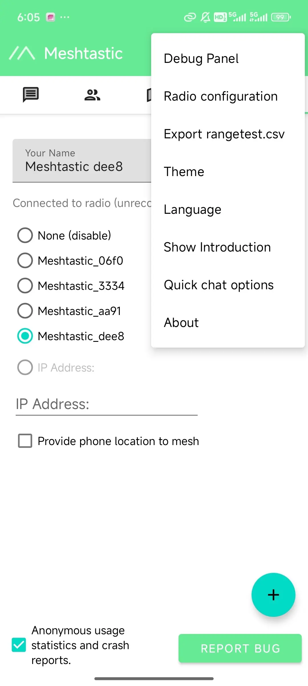

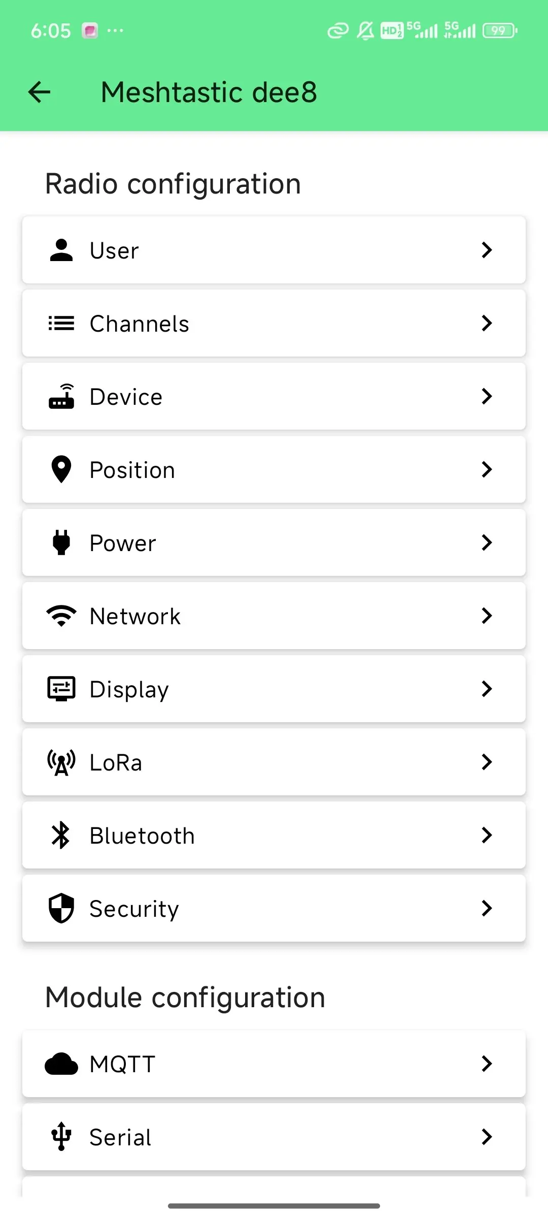

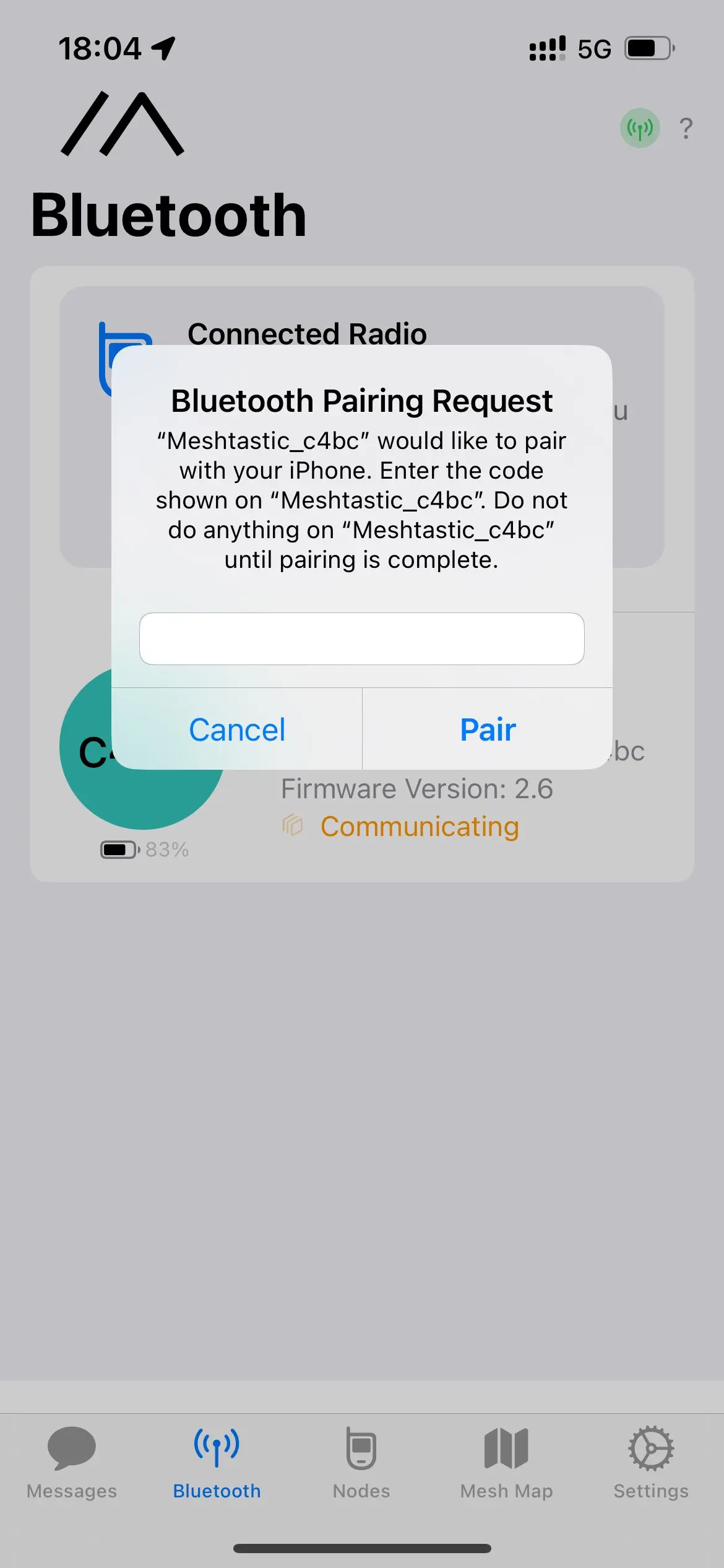

After opening the app, select the top far right and click on Configuration, click on the + in the bottom right corner to find the Meshtastic Bluetooth device.
2)When the Meshtastic_xxxx device is searched, tap to enter pairing mode.

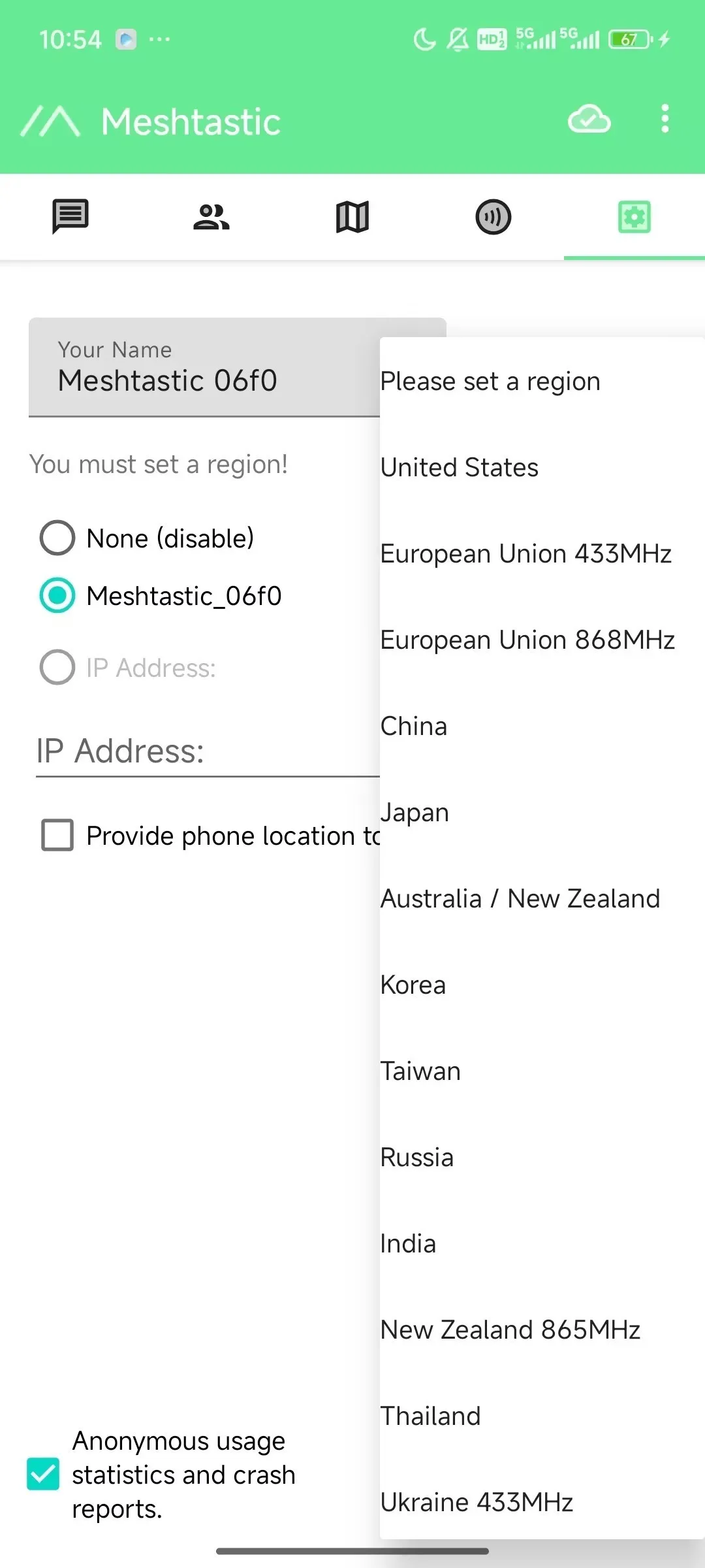

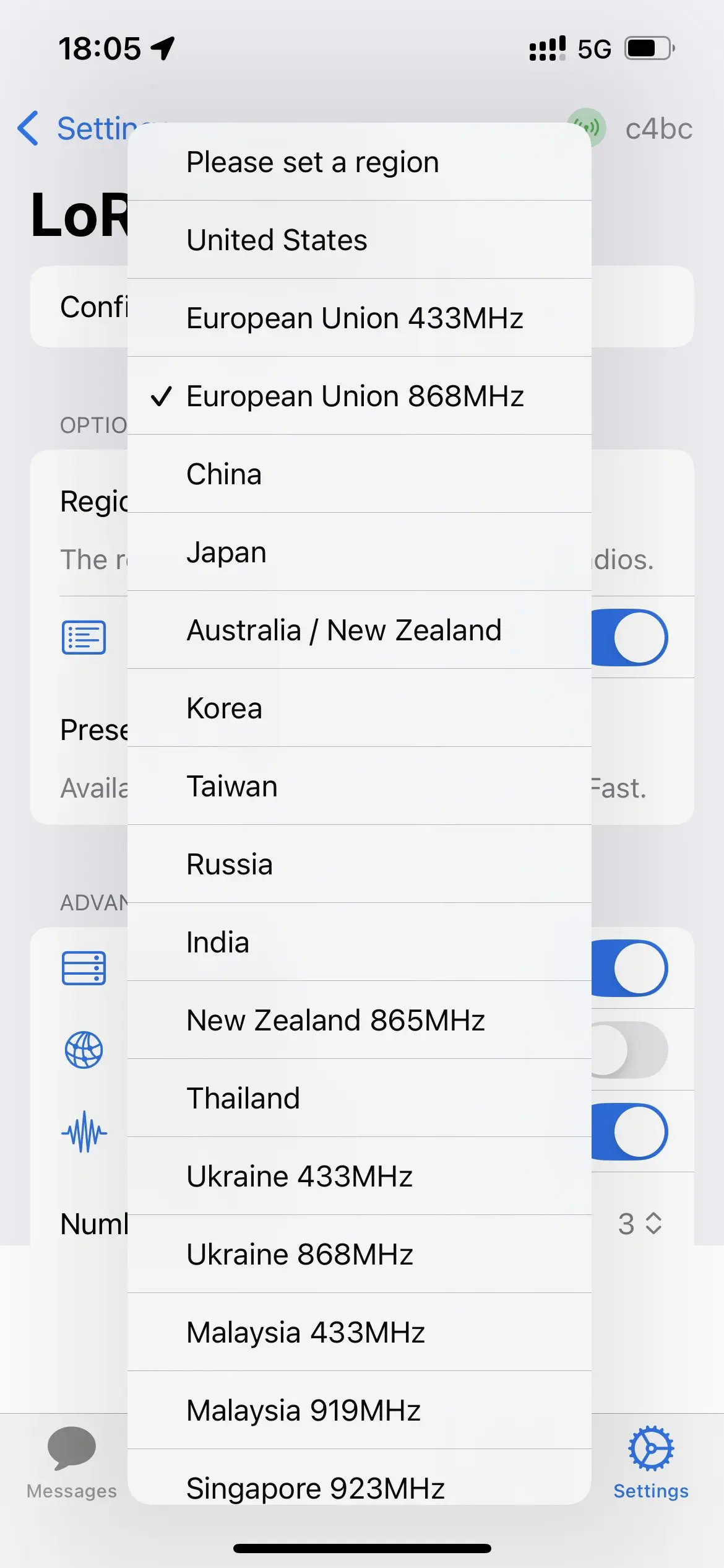

3)After successful Bluetooth pairing, you need to select a new region at the region again.

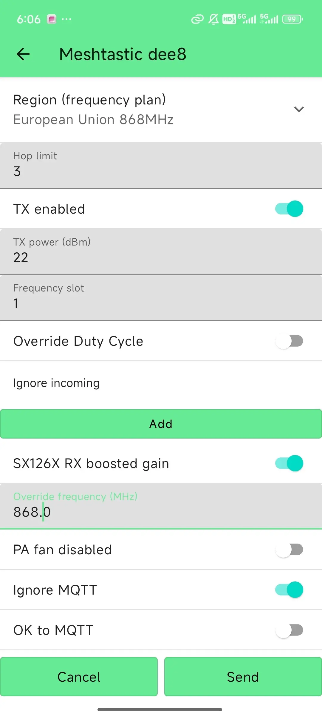

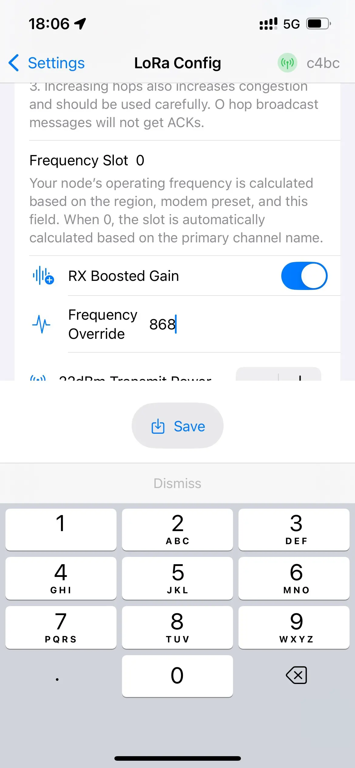

4) Set lora frequency, click on the upper right corner of the three points, click on “Radio configurtion”, and then click on “Lora”, scroll down to the ‘Add’ column, in the “Override frequency (Mhz)” at the corresponding frequency written.

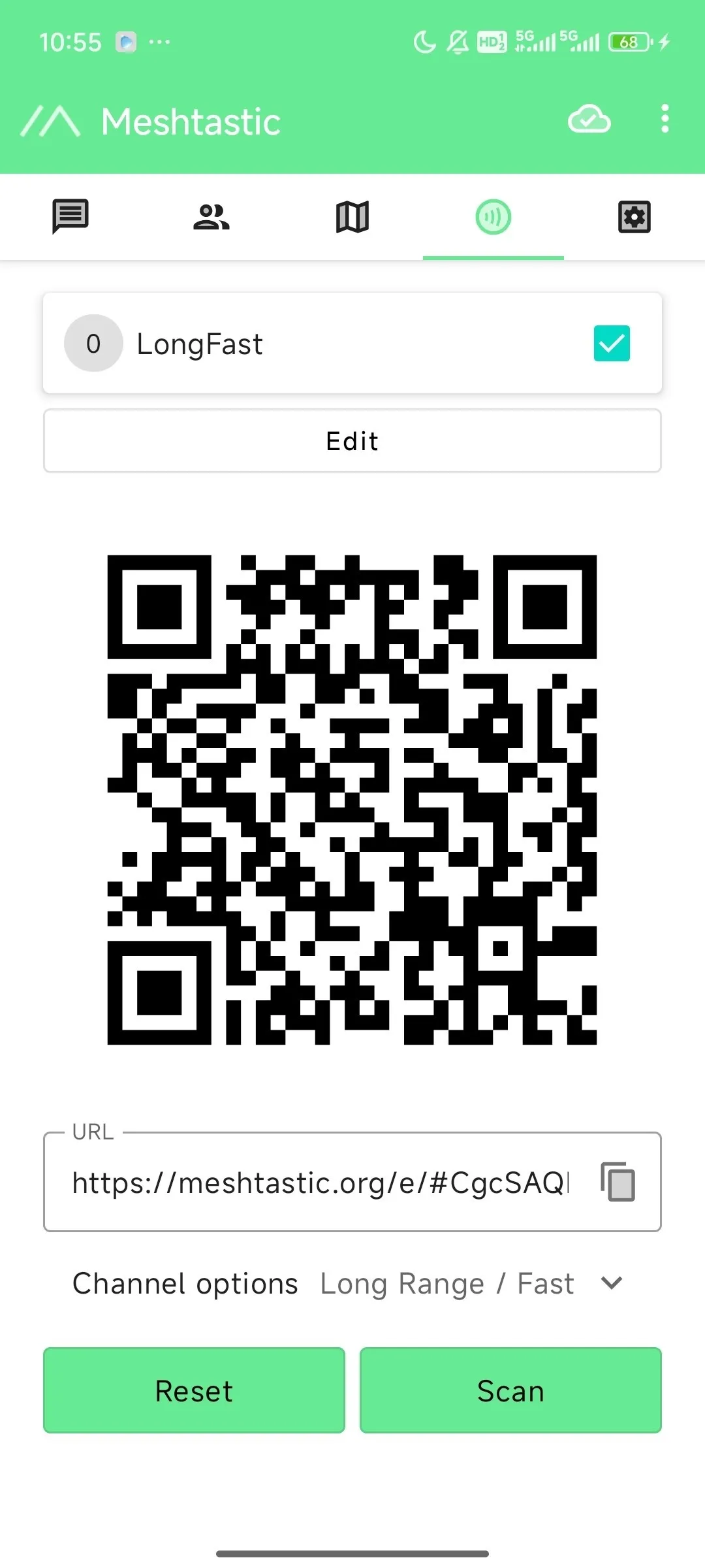

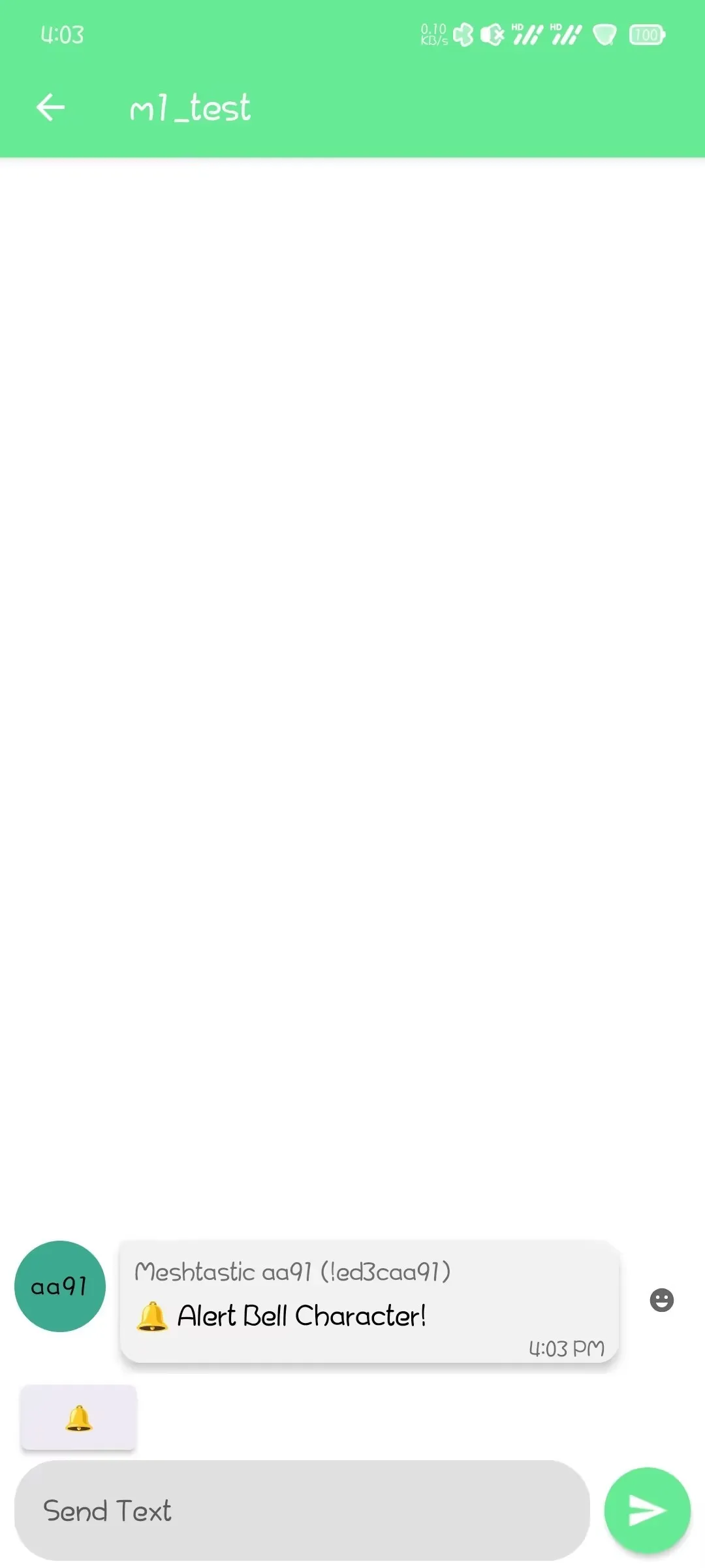

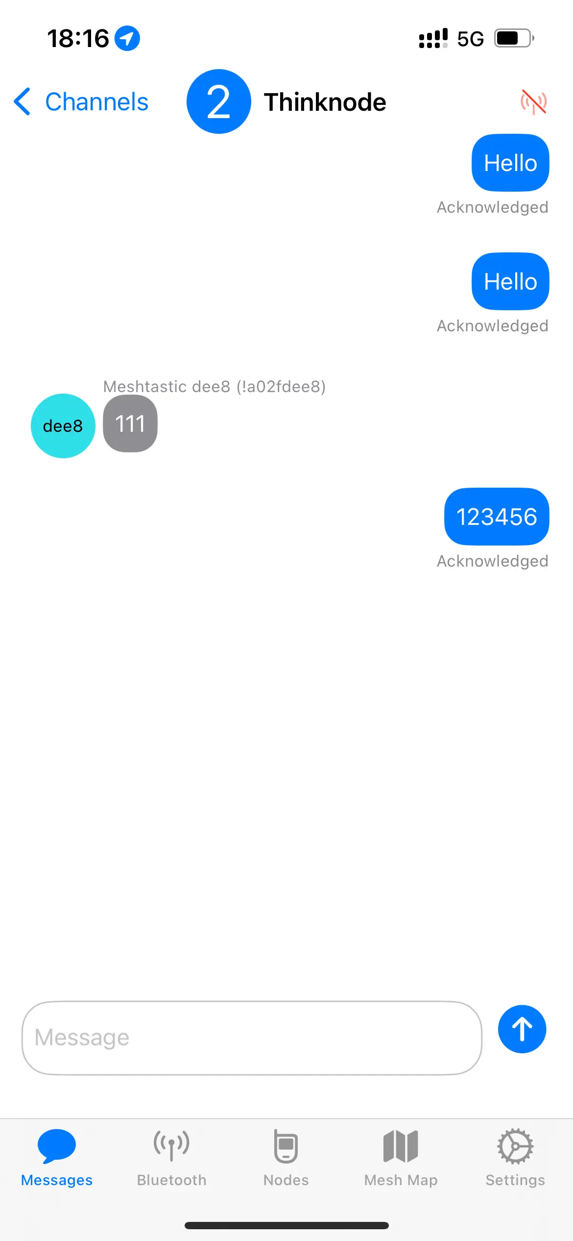

5)If two devices want to communicate, they need to join to the same channel, this time you need to select the fourth of the five options above, the other end of the phone needs to join to the same channel by scanning the code or entering the link, the channel can be customized name and so on.

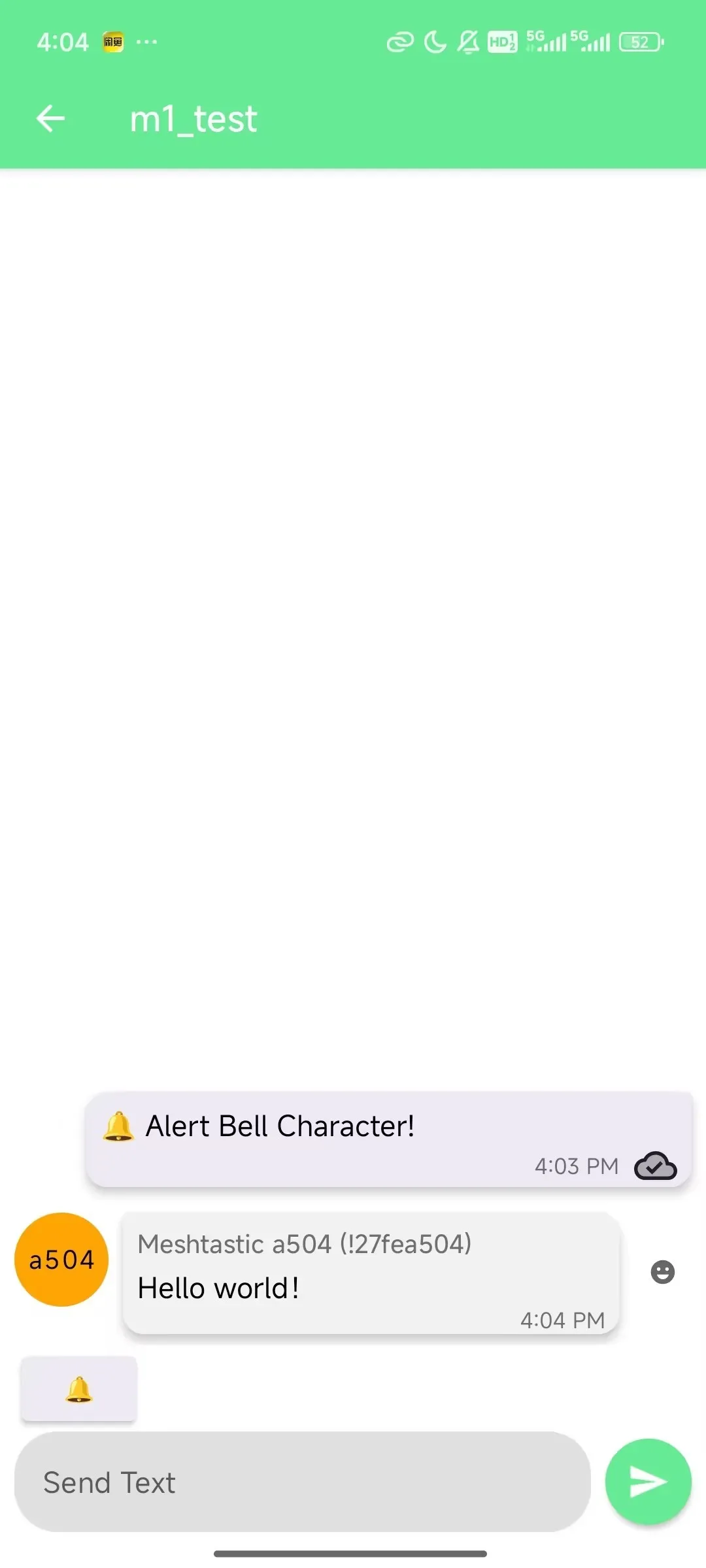

6)After joining, the two devices can now chat in the first screen by selecting Group Chat.
Mutual Messaging Interface.

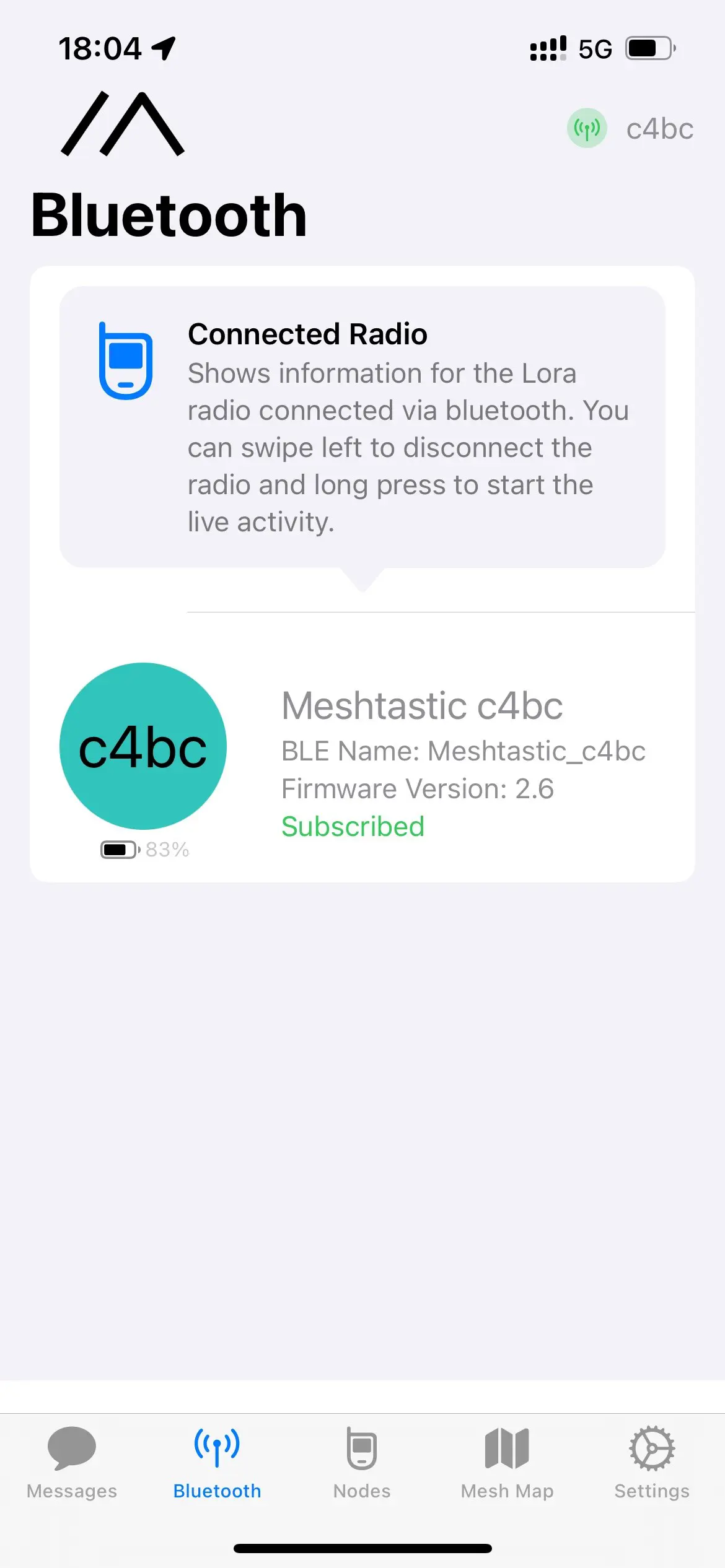

1)Open the app, tap Bluetooth on the home page and see the device you want to connect. Click on Pairing.

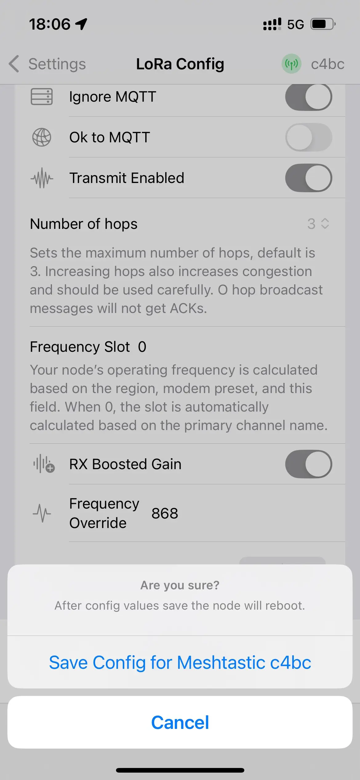

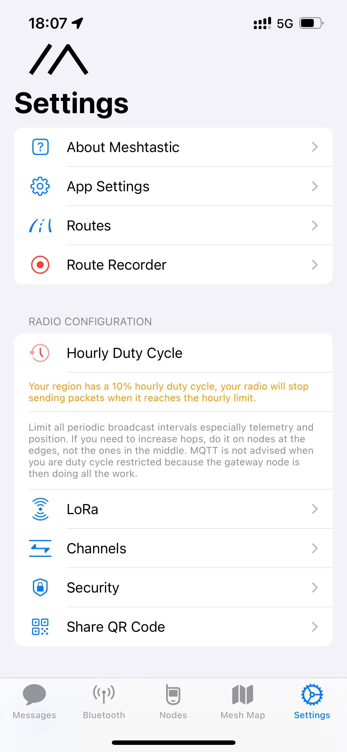

3)After successful Bluetooth pairing, You need to go to Settings and click on Lora Settings.
4) Set lora Region. and then scroll down to set the frequency. consistent with the previous settings for the region. Finally, check ignore MQTT and save.
5)Go to the information page, select a channel and a QR code will appear, use another device to scan this QR code to enter.
6)Join and start sending or receiving messages.

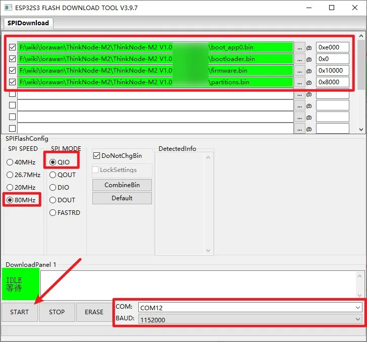

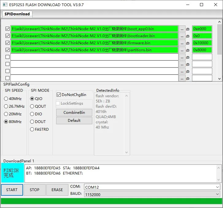

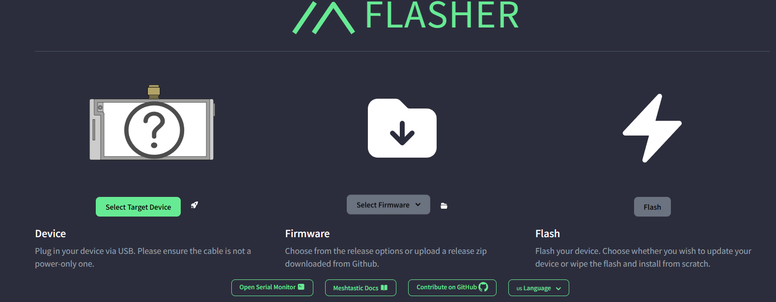

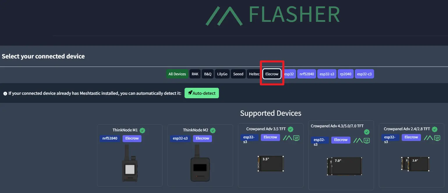

Burning Firmware¶
ClickMeshtastic firmware

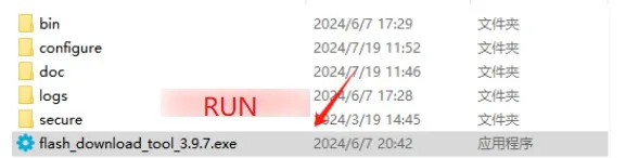

1, Select the corresponding firmware.
2, follow the steps to download the firmware.
