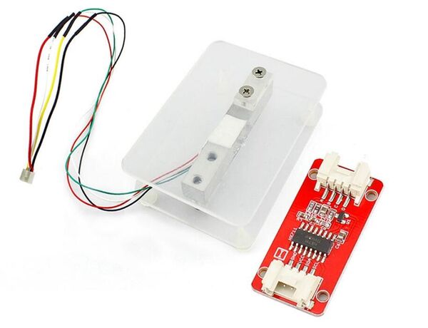

This is a crowtail series of load cell kits, by using it, you can DIY their own electronic scales, and it is compatible with Arduino, it is also very convenient to use, in your Arduino project, and it can serve as a good Own role. It uses the HX711 amplifier, HX711 is a precision 24-bit analog-to-digital converter (ADC) designed for weighING scales and industrial control applications to interface directly with a bridge sensor and the measurement range of weight sensor is 0-3000g
Model: CRT94077W
Features¶
- Crowtail interface
- Low standby current
- High accuracy
Specifications¶
Item | Value |
Working Voltage | DC 5V |
Working Current | 400mA |
Standby current | 200uA |
Operation temperature range | -40℃ to +85℃ |
Weight sensor capacity | 3kg |
Dimensions(mm) | 40.0(L)x20.0(W)x6.8(H) |

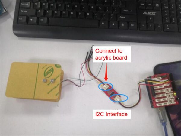

STEP2 Plug Crowtail-Base Shield into Crowduino Uno;
STEP3 Set Crowtail-Weight Sensor to I²C port of Crowtail-Base Shield;
STEP4 Plug acrylic board to ABCD interface of Crowtail-Weight Sensor;
STEP5 Connect Crowduino Uno to PC via a Mini USB cable.
NOTE |
If we don't have Crowtail Base Shield, We also can directly connect this module to Crowduino Uno as below. |
Crowduino Uno | Weight Sensor |
A4(J7) | SDA |
A5(J7) | SCL |
5V | VCC |
GND | GND |

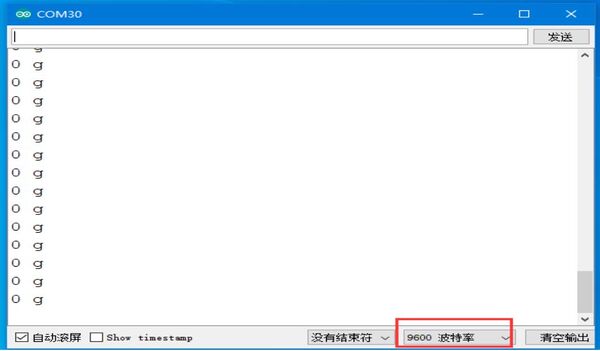

STEP6 After the program is burned, open the serial port monitor of Arduino IDE, set baud rate to 9600, and put no weight on the acrylic board, then the serial port print will be 0G, as shown in the figure:

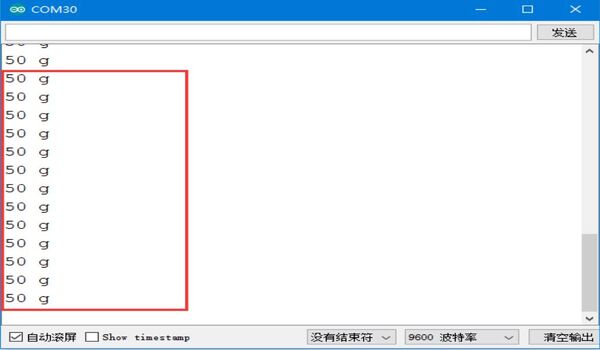

STEP7 Put the weight on the acrylic plate, and the serial port will print the corresponding weight. For example, if I put a 50g weight, the serial port will print 50g, and the serial port print value is consistent with the actual value, as shown in the figure:
