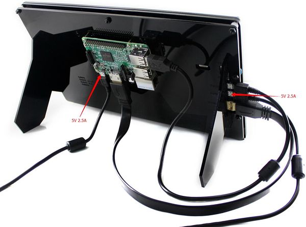

 Step 7: Connect the HDMI port of the LCD to the HDMI port on your Pi with a HDMI cable.
 Step 8: Connect the Touch port of the LCD to one of the USB ports on your Pi.
 Step 9: Connect the Power Only Port of the LCD to 5V 2.5A power adapter with a Type A to micro USB cable.
 Step 10: Turn on the “backlight” switch on the back of the LCD.
