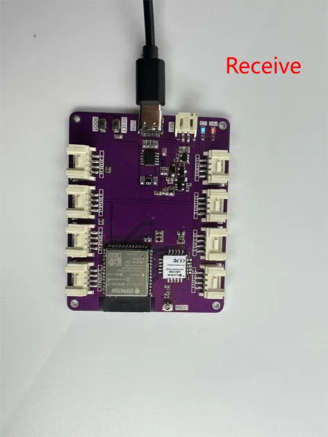

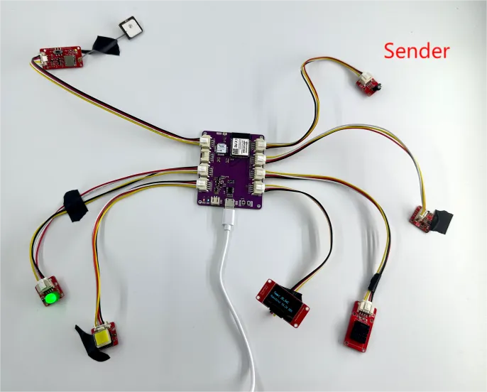

As shown in the figure below, we are using the LRCC68 module with each interface connected to a sensor. This setup allows us to collect data from each sensor and transmit the data to another LRCC68 module using LoRa technology. Finally, the received data can be viewed through the serial port.

Bulb: Connected to the LRCC68 module's GPIO_D interface, which corresponds to pin 12
Button: Connected to the LRCC68 module's GPIO_D interface, which corresponds to pin 14
DHT20 Temperature and Humidity Sensor: Connected to the LRCC68 module's I2C interface, which corresponds to pins 40 and 41
Accelerometer: Also connected to the LRCC68 module's I2C interface, pins 40 and 41
u8g2 Display: Connected to the LRCC68 module's I2C interface, pins 38 and 39
IR Receiver: Connected to the LRCC68 module's UART interface, which corresponds to pins 19 and 20
GPS Module: Connected to the LRCC68 module's GPIO_A interface, which corresponds to pins 15 and 16

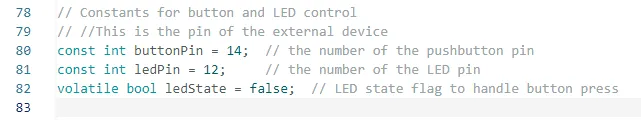

First, define the pins for the two interfaces.

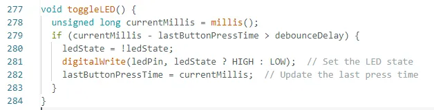

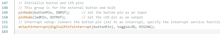

Then, in the setup function, configure the pins as input or output and set the interrupt condition. Interrupt configuration: connect the button pin (14) to an interrupt, assign the interrupt service routine to toggle the LED, and set the trigger condition to rising edge (i.e., when the button is pressed).
And then, set the logic for turning the bulb on and off.

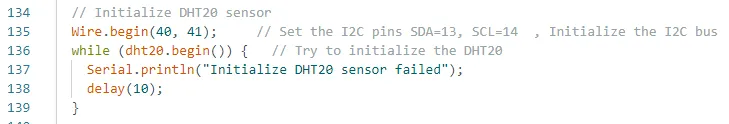

DHT20 Temperature and Humidity Sensor¶
Initialize the libraries and variables to be used first.
Then initialize the temperature and humidity sensor in setup.

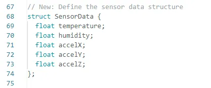

The structure defined here contains the values for temperature, humidity, and acceleration in three directions.
 The purpose is to later transmit all this data together to another LRCC68 module.

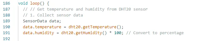

Next, in the loop function, retrieve the temperature and humidity values and store them in the temperature and humidity variables within the structure.

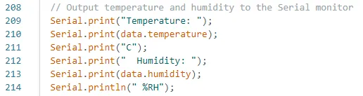

After retrieving the temperature and humidity values, you can print them to the serial monitor to check the values.

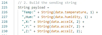

Then, combine them into the payload variable for easier transmission together.

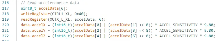

Accelerometer¶

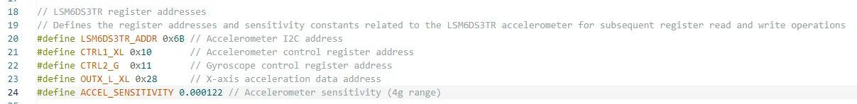

First, according to the technical manual of the LSM6DS3 accelerometer, explain and define its relevant registers.
Since both the accelerometer and the temperature and humidity sensor use the I2C protocol, their pins have already been initialized.
Then, in the loop function, repeatedly retrieve the acceleration values in all three directions.
The writeRegister and readRegister functions are custom functions we’ve written.
 (You can refer to the code for more details, as the comments provided are quite detailed.)
writeRegister: Writes data to a register
readRegister: Reads data from a register

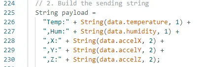

After obtaining the acceleration data, combine it into the payload variable for easier transmission together.
Finally, transmit the data to another LRCC68 module.

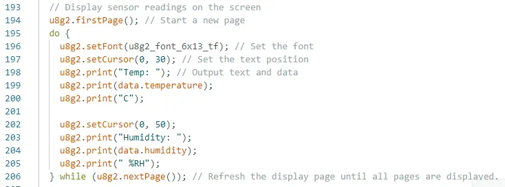

In this experiment, we also added a display to show the temperature and humidity values.
 At the beginning of the code, the display configuration is initialized.
 Although the display also uses the I2C interface, here we are using software-based I2C.
And in the setup function, initialize the display.
Then, in the loop function, set up the display and continuously update the displayed values.

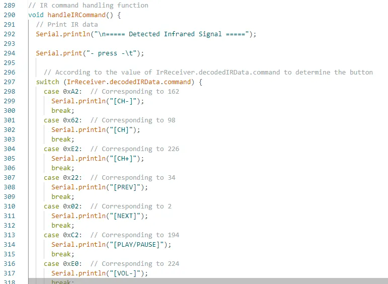

In the loop function, continuously process and receive the infrared signals sent by the remote control.
You can specifically map the key values represented by the infrared remote control buttons.

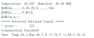

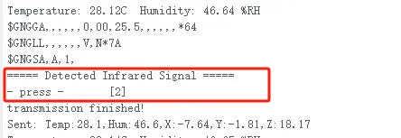

Here, I pressed the key value "2" on the infrared remote control.

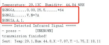

 After receiving the infrared signal, the corresponding information will be displayed in the serial monitor as shown below.

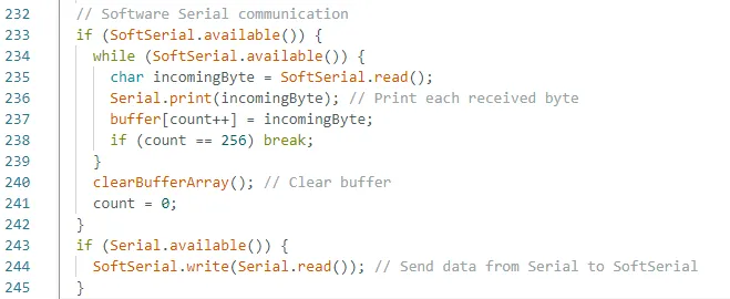

In this while loop, as long as there is available data on the software serial, the loop body will continuously execute. The SoftSerial.read() function reads a byte of data from the software serial and stores it in the incomingByte variable. Then, the received byte is printed to the hardware serial (usually connected to a computer for debugging and data monitoring) using Serial.print(incomingByte). Next, the received byte is stored in the buffer array, and the count variable is incremented to track the number of bytes stored. When count reaches 256, the loop exits to prevent an array overflow.
As you can see here, we haven't processed the received GPS signals. If you're interested, you can explore it further to obtain the desired latitude and longitude information.

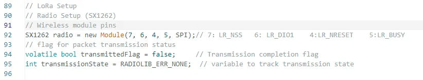

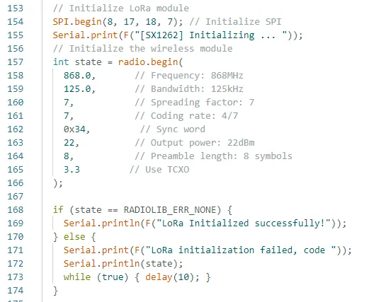

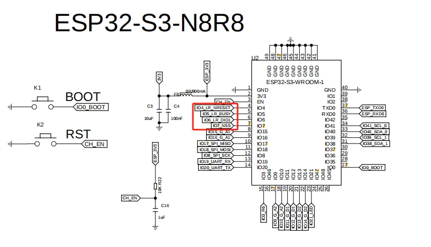

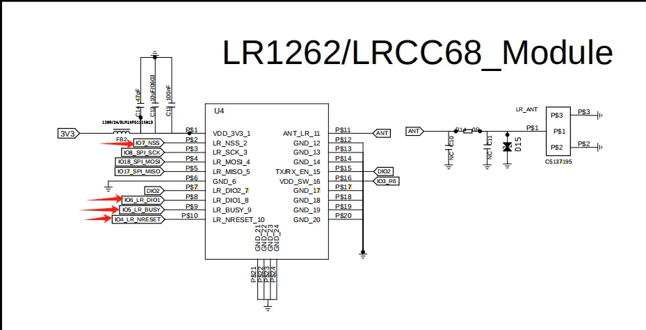

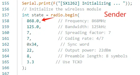

First, initialize the pins for the LoRa module.
You can open the schematic diagram we provided.
In our schematic diagram, you can identify the pins required for the LoRa module based on the ESP32-S3 chip's pins.

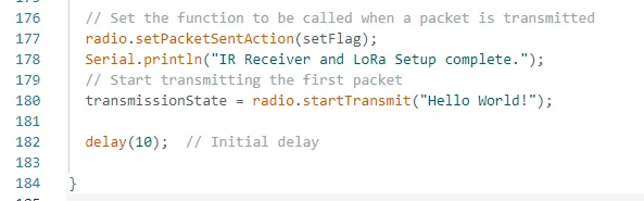

In the setup function, configure the relevant settings for the LoRa module.

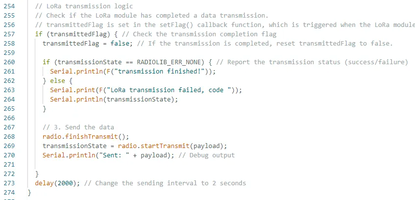

Finally, in the loop function, repeatedly send the data collected from the sensors.

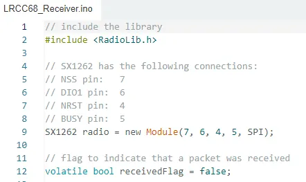

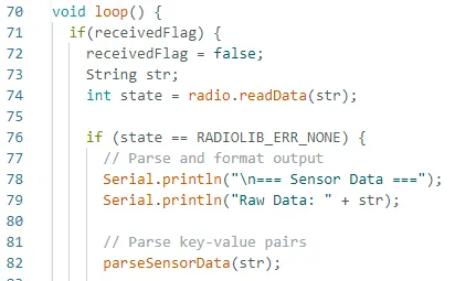

The receiver also starts by initializing the pins for the LoRa module.
Next, the most important thing is that the frequency band must match the one used by the transmitter.

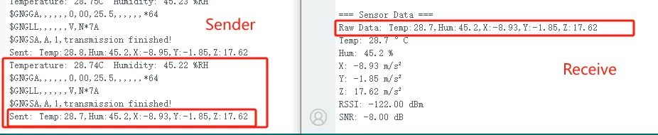

Next, the data sent by the transmitter needs to be parsed.
The parseSensorData function is a parsing function I wrote. I won't go into detail here, but its purpose is to parse the data that was packaged and sent over.

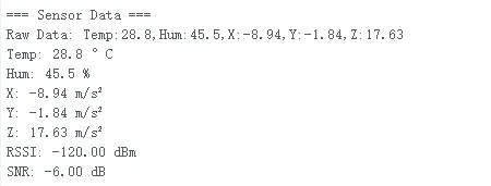

You can compare the sent message with the received information.
Perfect! The LoRa module successfully transmitted the data!
