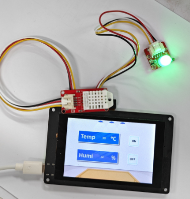

The example tutorial is an environmental monitoring project, demonstrate how to create a UI and use a Humidity&Temperature sensor to obtain the environment temperature and humidity and display it on the screen; and how to control the LED on and off by the buttons on the screen.

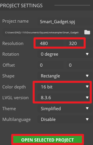

Open the SquareLine Studio and create a project. Select "Arduino"->"Arduino with TFT_eSPI".
Note:

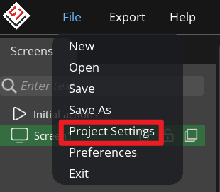

Set the name of the project, set the screen resolution to 480*320, set the color depth to 16bit, and keep other default settings. After setting, click CREATE to create the project.

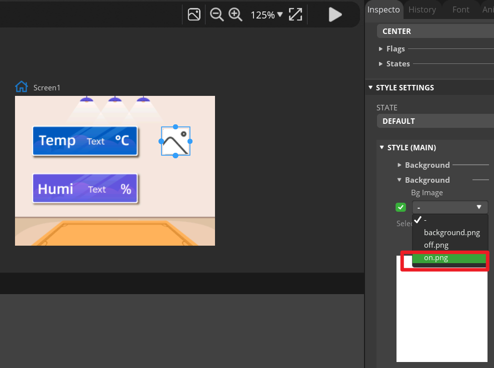

Add background.

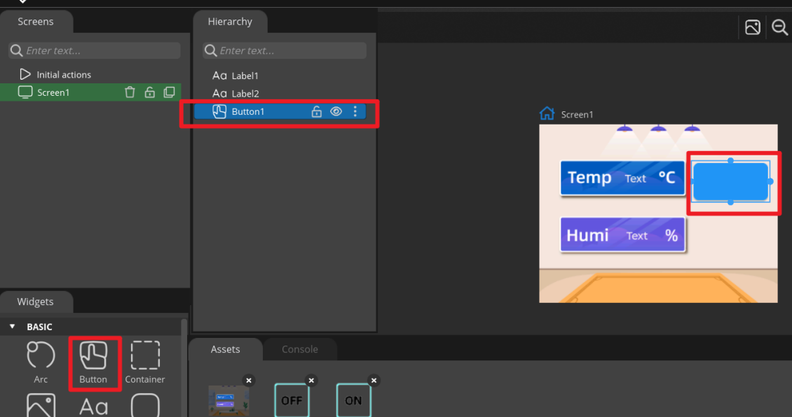

Add Label widget to display temperature and humidity.
Add events to buttons.

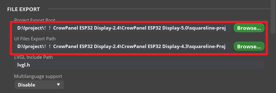

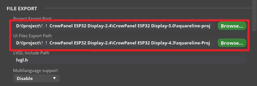

Export UI files.
Then click "APPLY CHANGES".

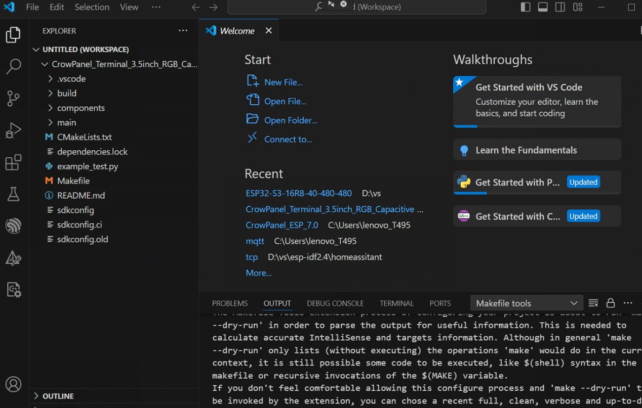

Please click the card below to learn how to install ESP-IDF. Create a blank project according to the "Get Started with ESP-IDF".
You can click
to download the complete project we provided. This project can be used directly. You can also create the project by following the tutorial.

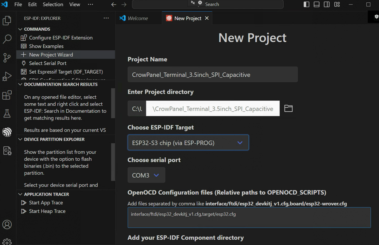

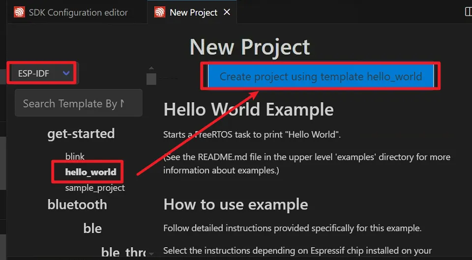

Create New Project¶

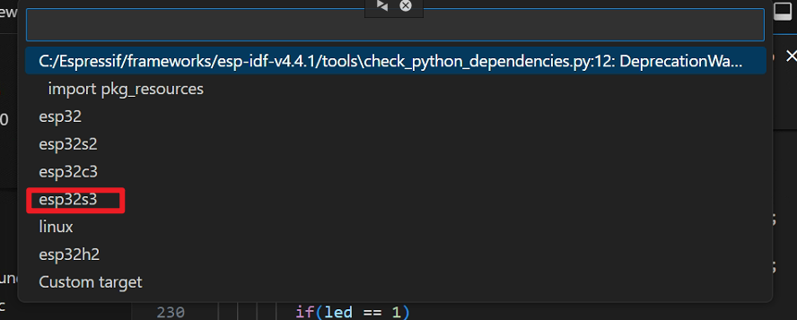

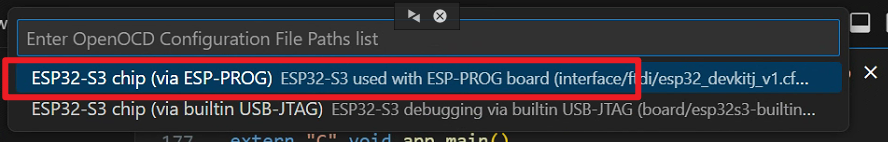

Create a new project according to the "Get Started with ESP-IDF". Choose "ESP320S3 chip(via ESP-PROG)" as ESP-IDF Target.

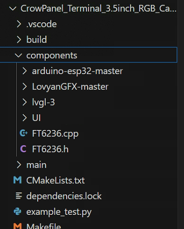

Add Libraries¶

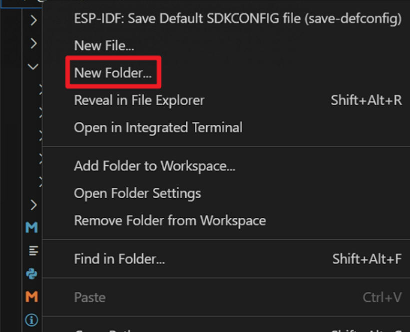

Create a new folder and name the folder 'components'. Add the libraries we provided to this folder.
Please click
to download the libraries we provided.

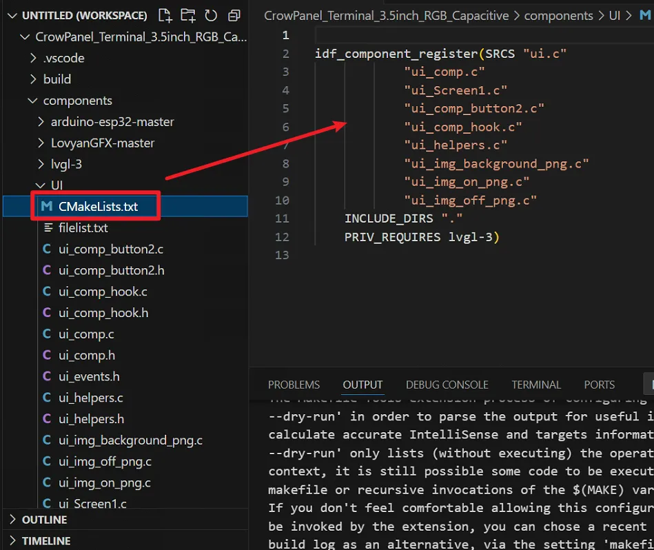

Configuring the UI File¶

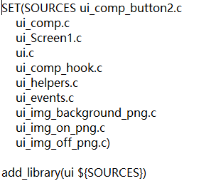

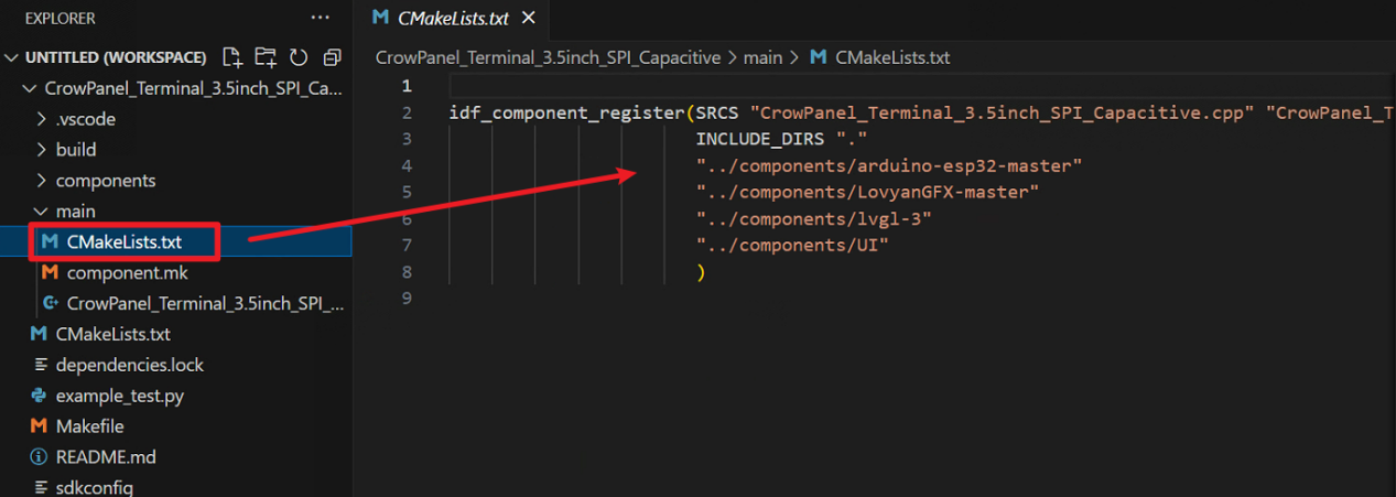

Modify CMakeLists.txt
Change from:
to:
idf_component_register(SRCS "ui.c"
"ui_comp.c"
"ui_Screen1.c"
"ui_comp_button2.c"
"ui_comp_hook.c"
"ui_helpers.c"
"ui_img_background_png.c"
"ui_img_on_png.c"
"ui_img_off_png.c"
INCLUDE_DIRS "."
PRIV_REQUIRES lvgl-3)

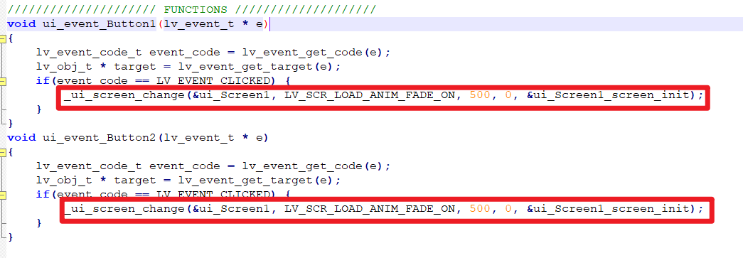

Modify the button event code.

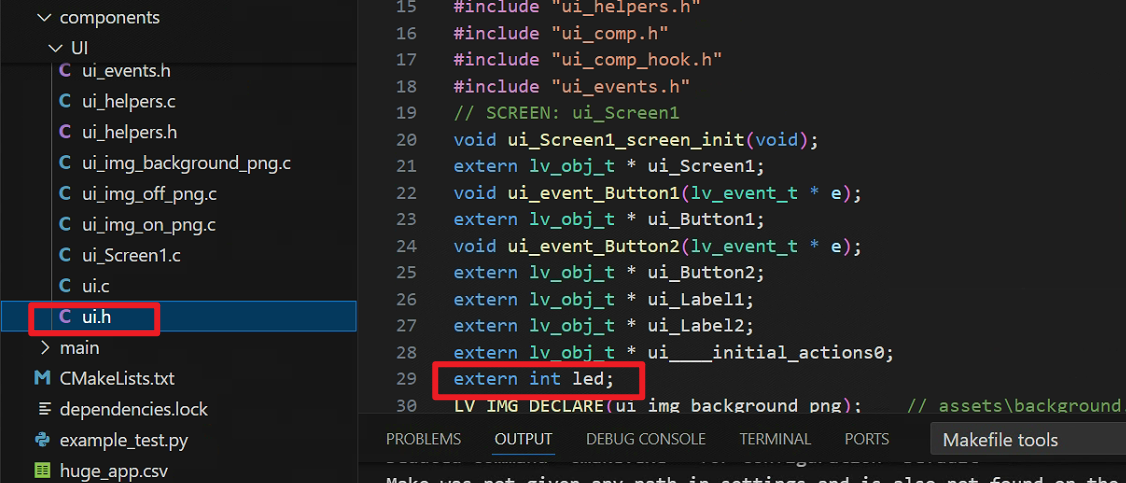

First, define a extern int led; in the ui.h file to store the status of the LED. The value of this variable is judged to control the on and off of the LED.
- When button 1 (ON button) is pressed, set the LED value to 1.
- When button 2 (OFF button) is pressed, set the LED value to 0.

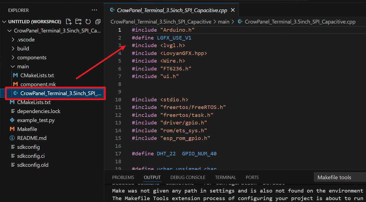

Setup main file¶
The CMakeList.txt file contains the Settings for the library. All required libraries should be included by directory address.
The main program is written in the .cpp file

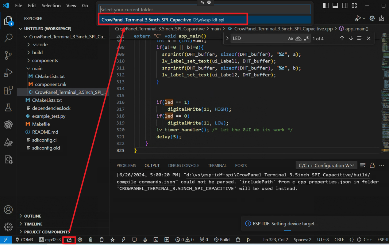

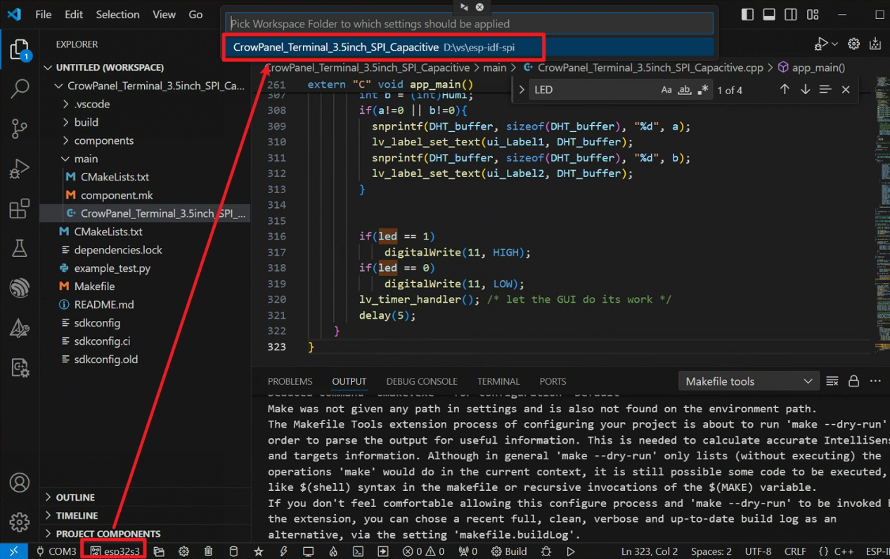

Confirm the path

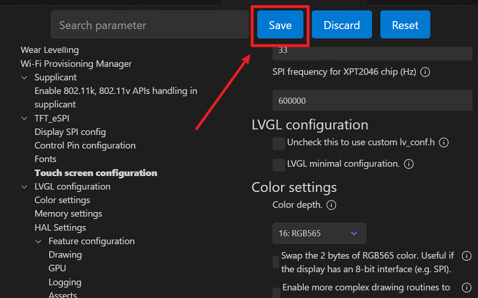

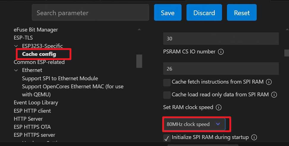

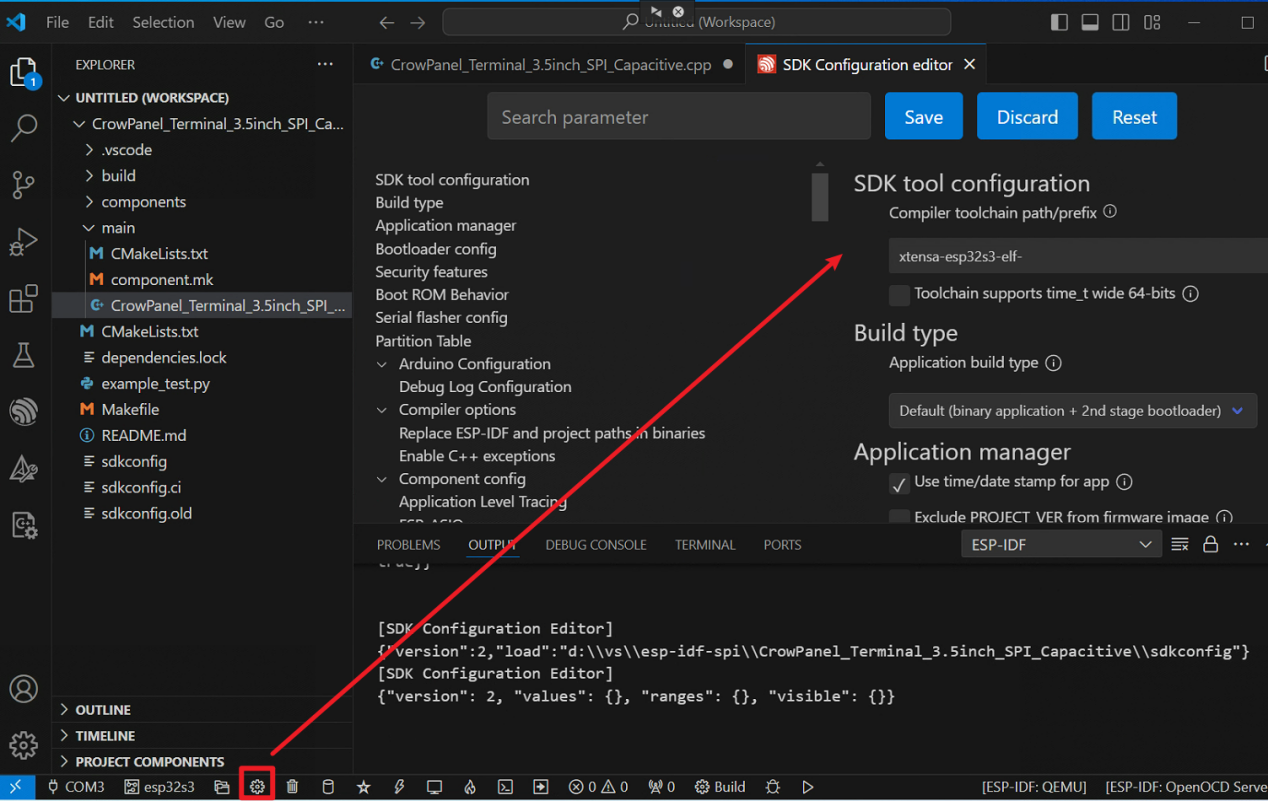

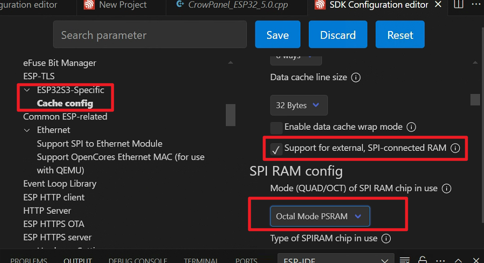

SDK Configuration¶

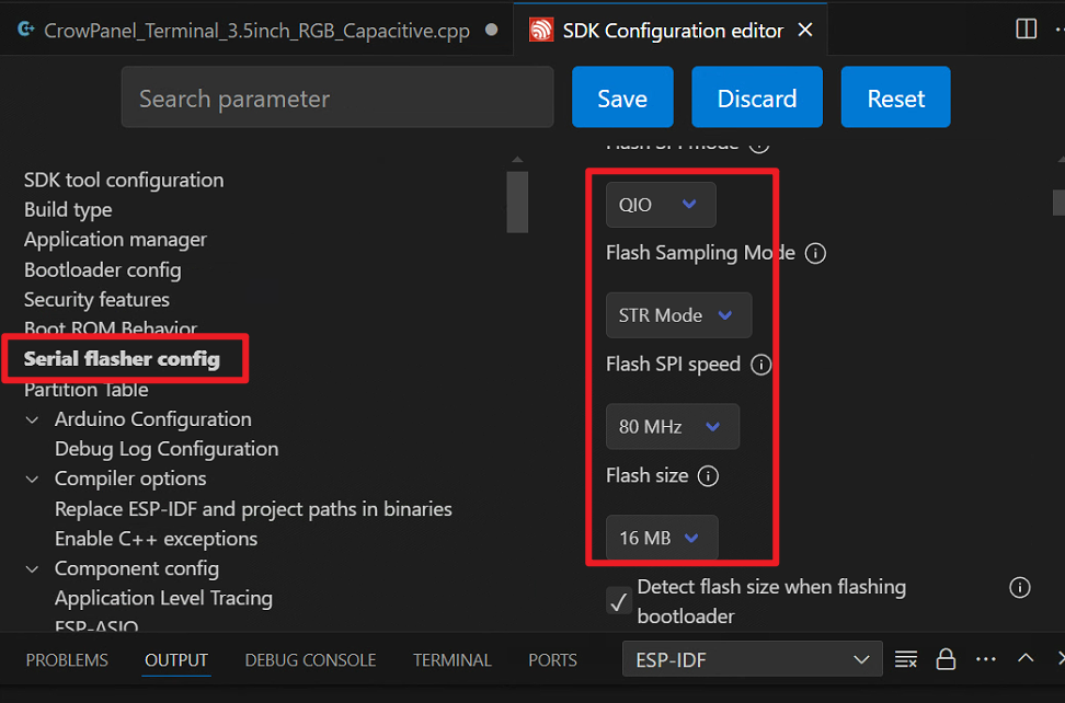

Serial flash config:
ESP32SE-Specific→Cache config:

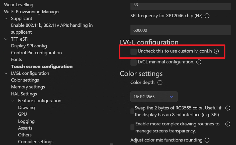

LVGL Configuration: Uncheck the "Uncheck this to use custom lv_conf.h"
Save the setting

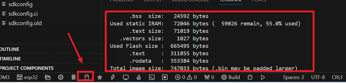

Compile and upload the code¶
Click Compile and the compilation is successful.

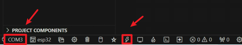

Click the download button to download the program (confirm the serial port and select UART mode to download)
