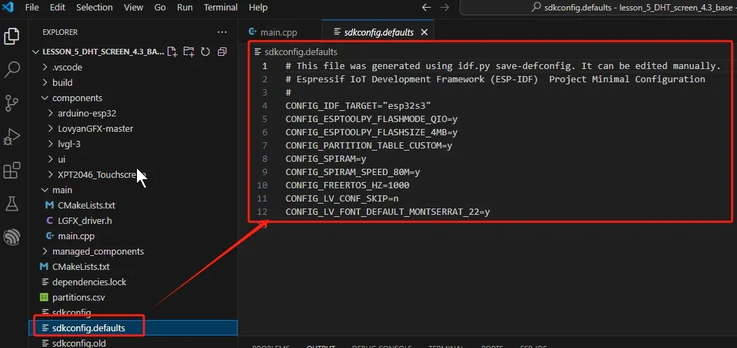

  • Configure ESP32-S3, 4 MB Flash, custom partitions, and QSPI PSRAM using the provided sdkconfig.

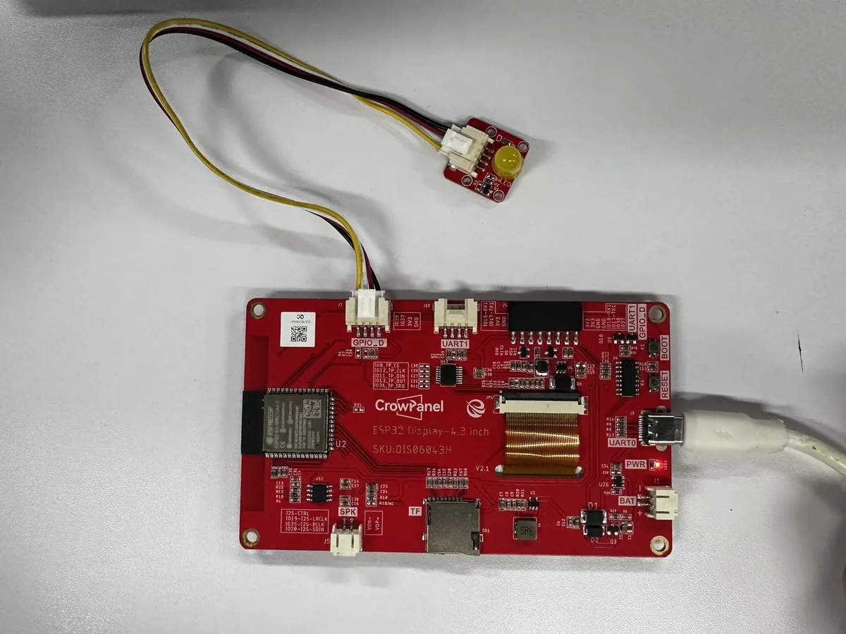

3. What You Will Need
  • One ESP32-S3 4.3-inch HMI development board with a 480 × 272 LCD and an XPT2046 touch controller.
  • One USB data cable that supports data transfer.
  • One LED module connected to GPIO38.

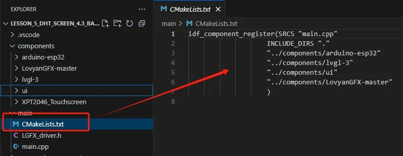

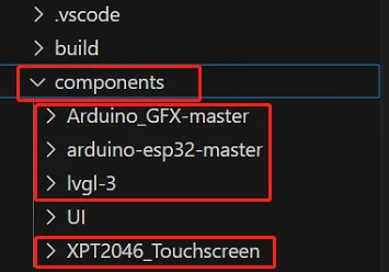

  • The complete LVGL_IDF project, including main, components/UI, components/lvgl-3, components/Arduino_GFX-master, components/XPT2046_Touchscreen, and managed_components.
  • The project pins espressif/arduino-esp32 to 3.3.8; do not update dependencies.lock before building.

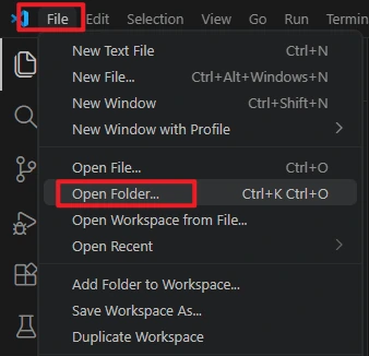

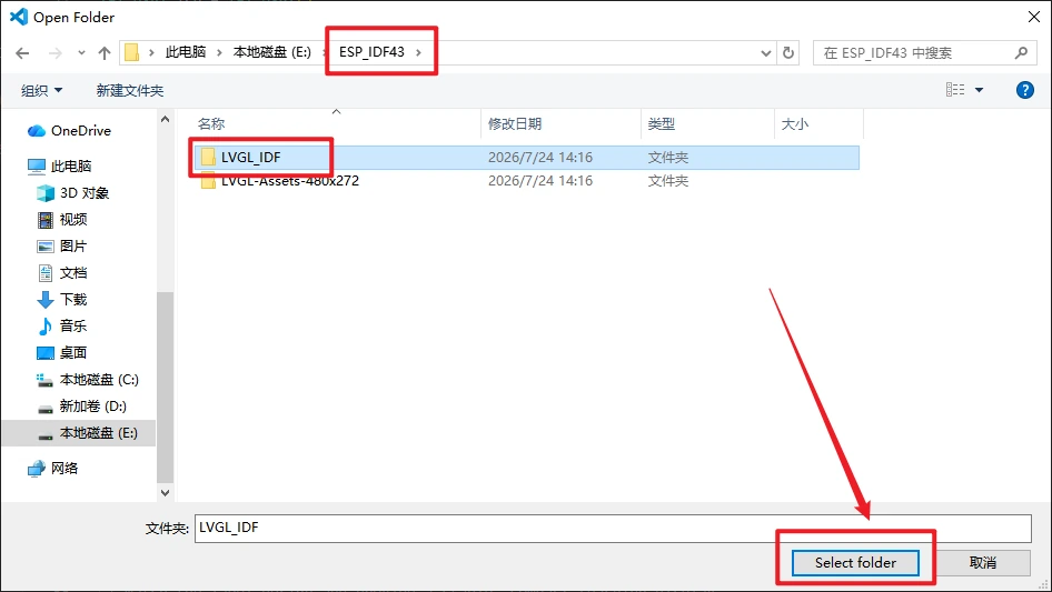

In VS Code, select File > Open Folder to open the project folder.

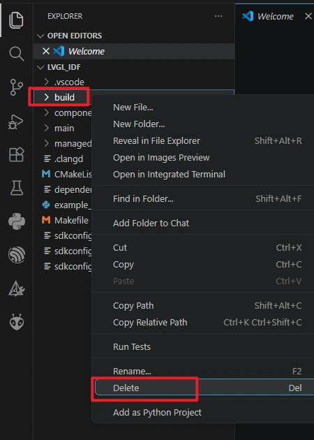

Run the Build -> Delete command to completely clear the build cache and path files left behind by the old project, avoiding compilation conflicts.

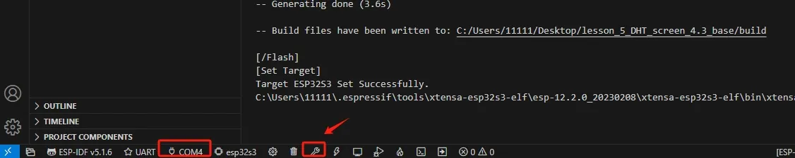

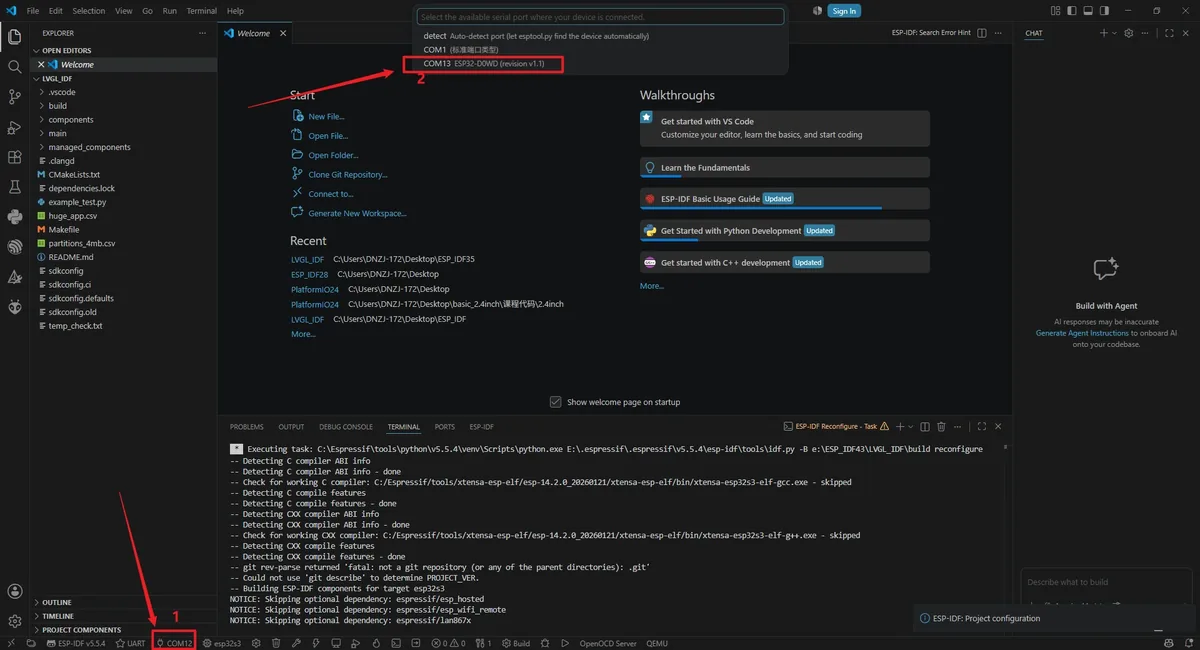

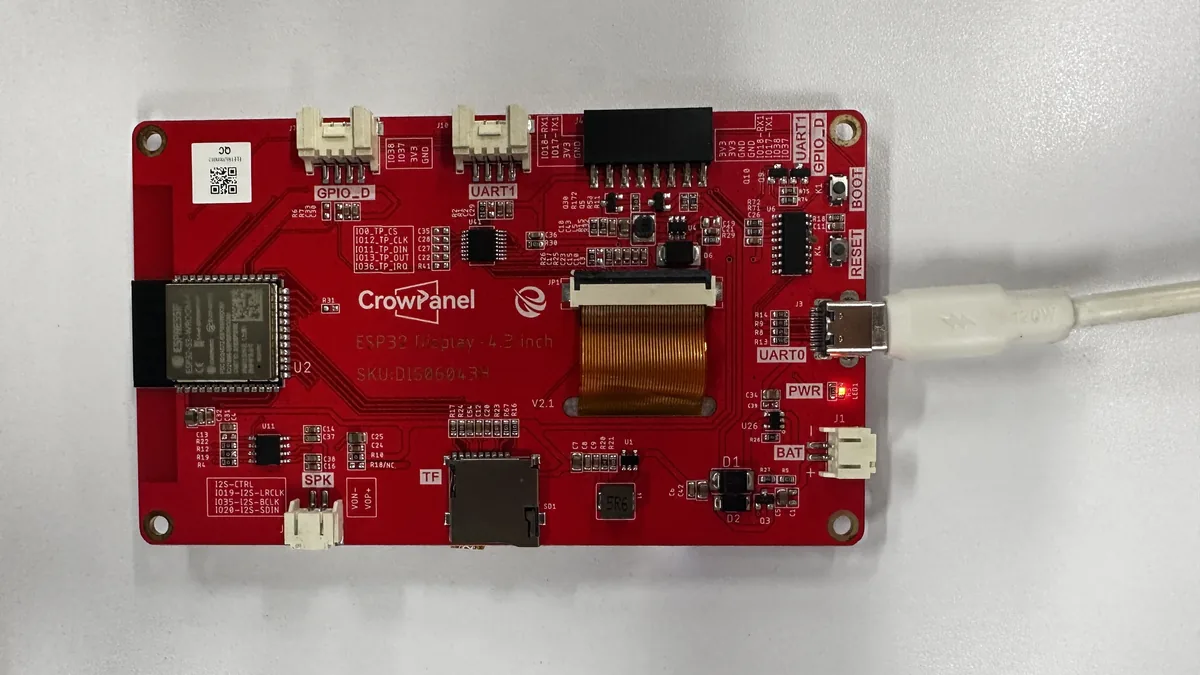

Connect the board with the USB data cable, click the port name in the status bar, and select the COM port that the board actually appears on. The port number varies by computer; if unsure, unplug the board and observe which port disappears from the list.
IMG_7918
image-20260724142130522

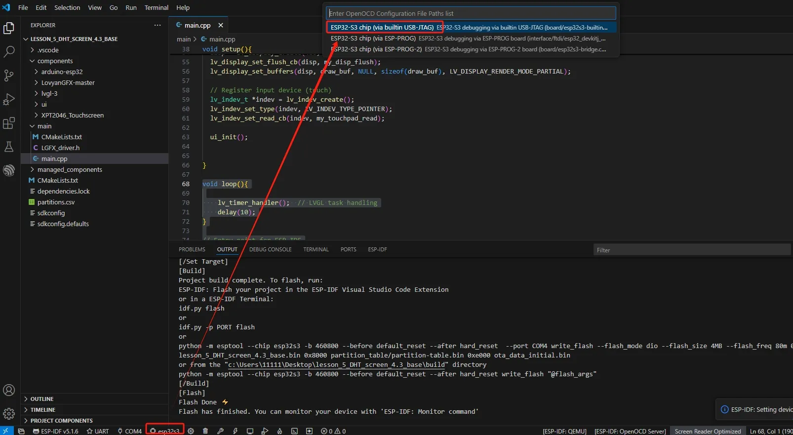

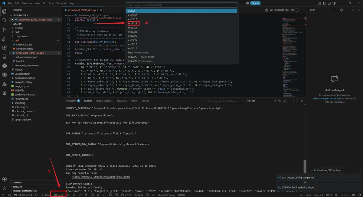

Click the chip icon in the VS Code status bar, run ESP-IDF: Set Espressif Device Target, and select esp32s3 to set the target chip.
image-20260724142708533

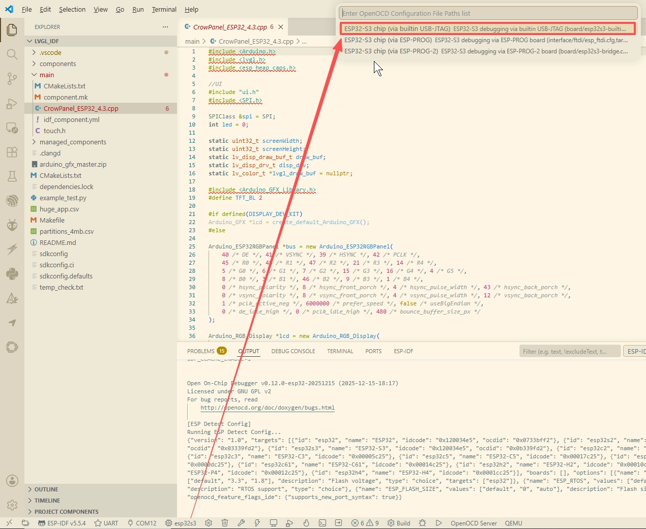

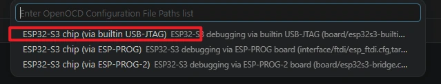

For the OpenOCD configuration, select ESP32-S3 chip (via builtin USB-JTAG) to prevent the plugin from repeatedly prompting that the configuration is missing.
image-20260724142816518

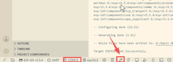

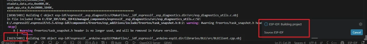

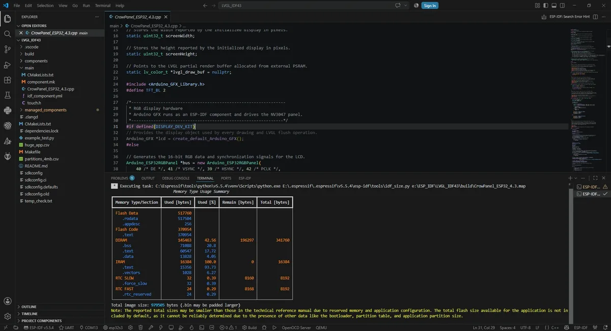

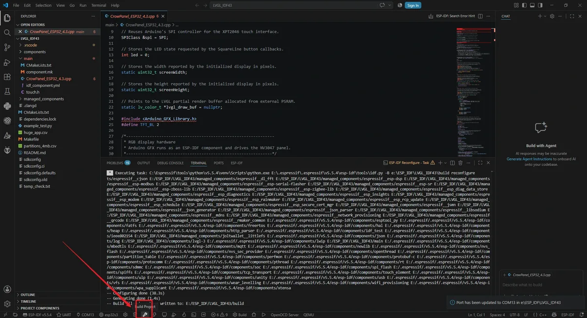

Click the Build (wrench) button in the status bar, or run idf.py build in the terminal. The first build takes a long time; the bottom-right corner should then show that the project build is complete.
image-20260724143345391
image-20260724143600729
image-20260724144114961

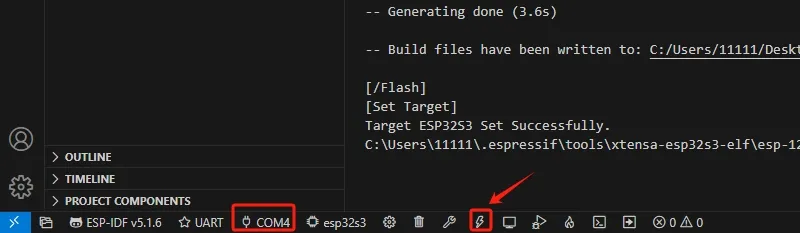

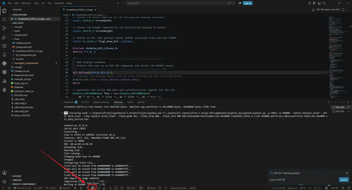

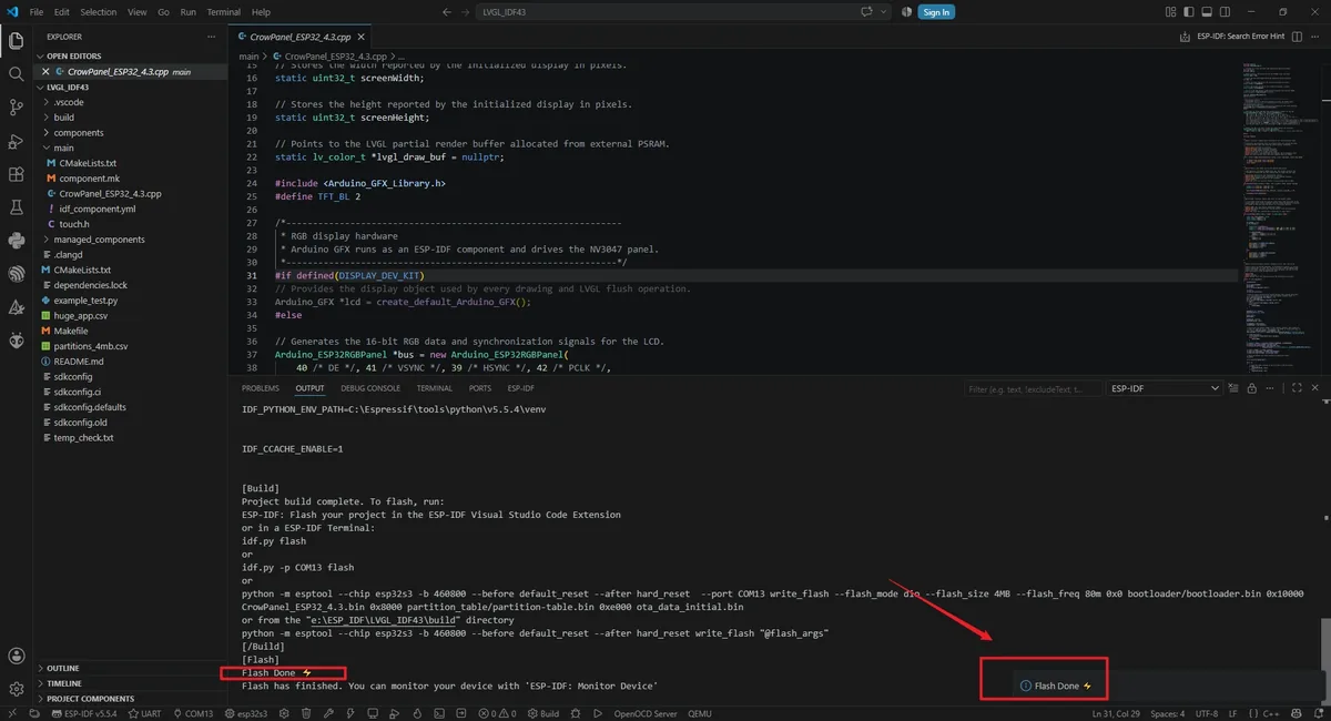

Confirm that the flash method in the status bar is UART, then click the lightning-shaped Flash button; you can also run idf.py -p COMx flash, replacing COMx with the actual port. The board resets automatically after writing finishes.
image-20260724144216673
image-20260724144251461

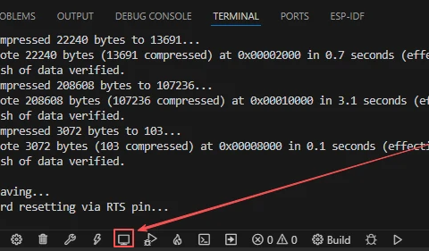

After uploading the code, click the Monitor button to open the serial port monitor; the baud rate is set to 115200 by default. After the monitor is opened, it should first display the ESP-IDF startup information, and then continuously print the serial port printing information set in your code.

Keep the board powered off and verify that the LCD and touch cables are secured. If using an external LED, connect it to the connector labeled GPIO_D, whose signal line corresponds to GPIO 38; after confirming orientation and power pins, connect the board to the computer with a USB-C cable that supports data transfer.
IMG_7921

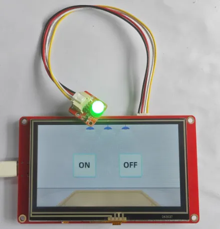

After flashing, press the reset button. The LCD backlight should turn on, and the screen should fully display the background and the two image buttons, ON and OFF; there must be no garbage display, misalignment, white blocks, or missing areas.
IMG_7922

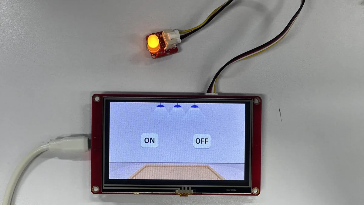

Tap the ON image button with a finger; do not use sharp or conductive objects. The GPIO 38 LED should light up.
IMG_7919
Tap the OFF image button; the GPIO 38 LED should turn off.

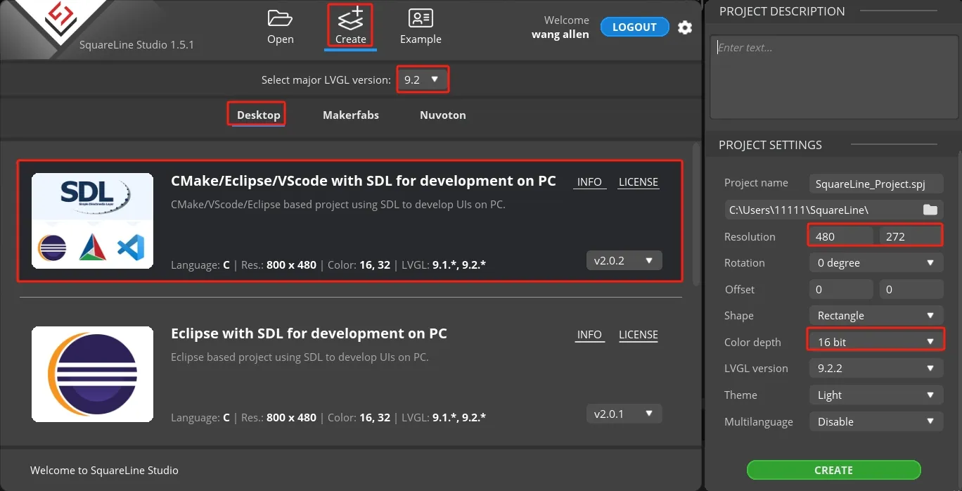

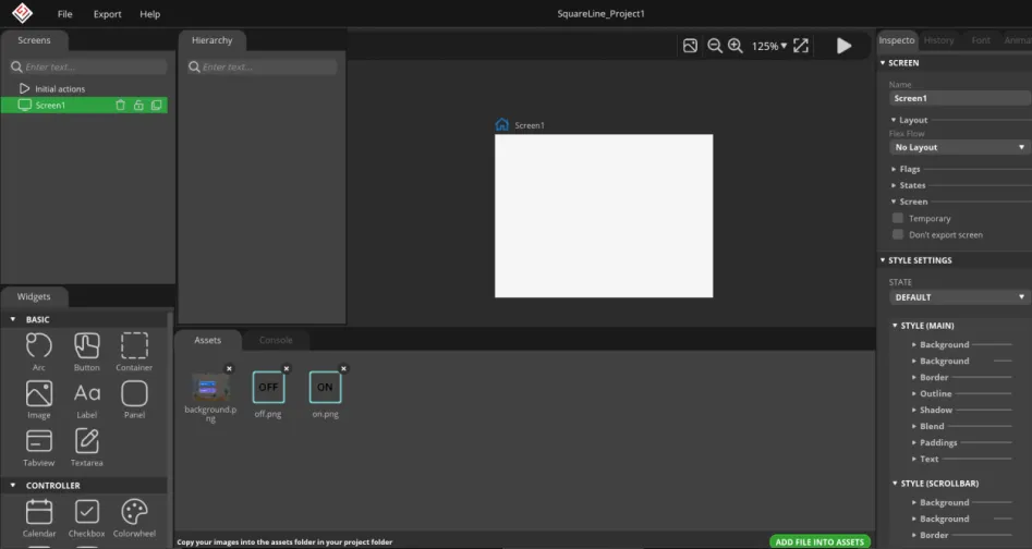

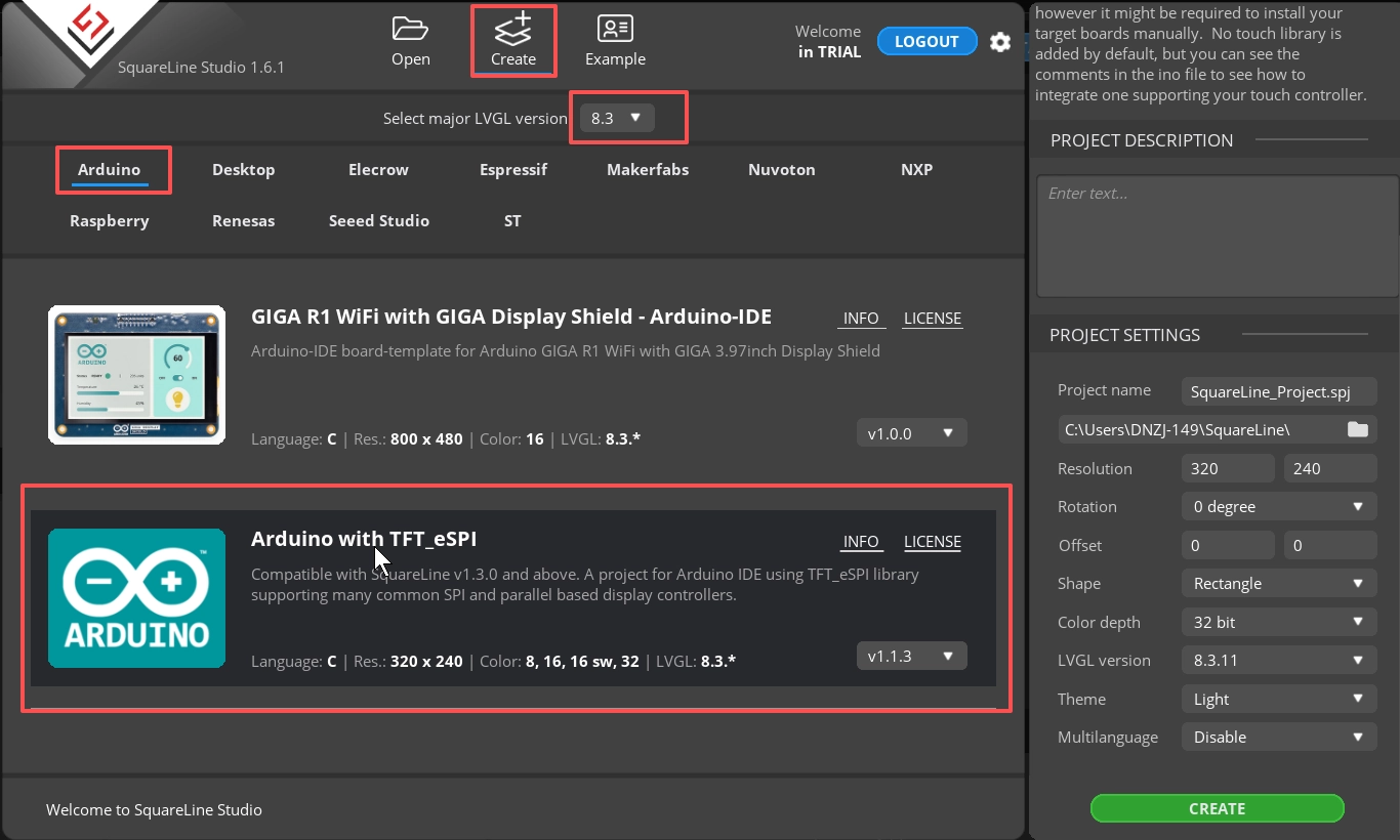

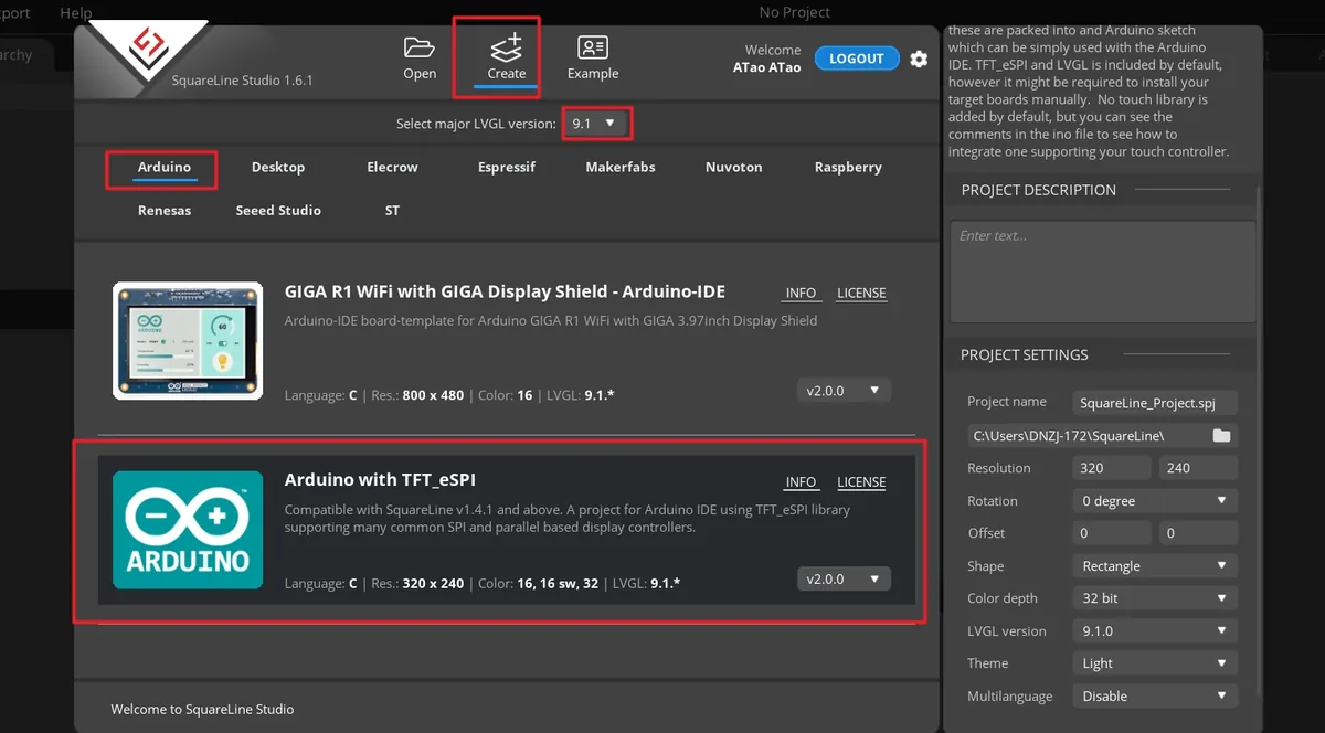

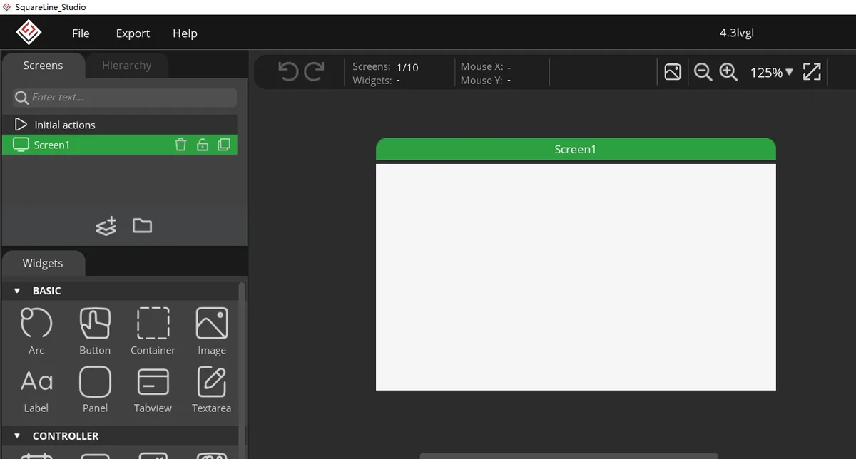

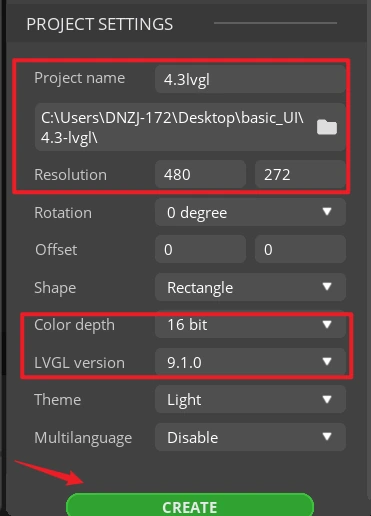

Launch SquareLine Studio 1.6.1, click Create, and select the Arduino with TFT_eSPI template for the Arduino platform. This template generates the UI file framework suited to Arduino and TFT_eSPI projects.
Note: When the Arduino framework is selected, SquareLine Studio shows only Arduino with TFT_eSPI. It generates template code for TFT_eSPI, but SquareLine Studio also supports other graphics libraries; when switching to other hardware, you must modify the display code according to the actual library.
image-20260723120743602

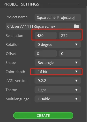

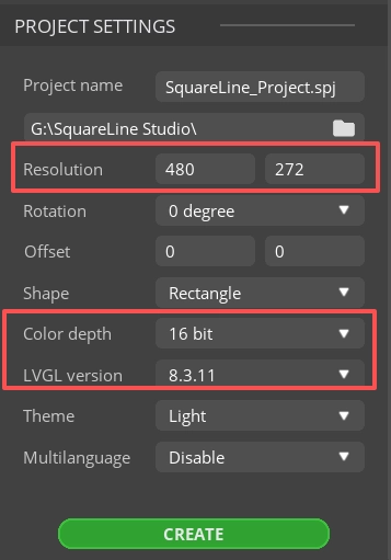

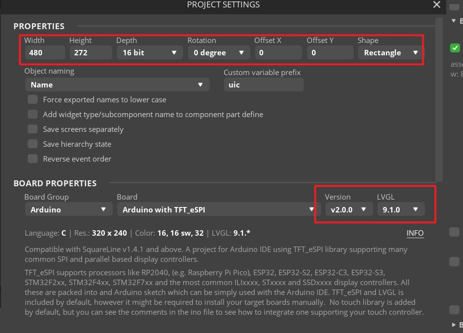

Enter the project name SquareLine_Project, set the resolution to width 480 and height 272, set the color depth to 16 bit, set the LVGL version to 9.1.0, then click CREATE.
image-20260723120937204
Note: 16 bit color depth can represent 65,536 colors, using the RGB 5:6:5 pixel representation. Keep it consistent with the project's color configuration.
After the project opens, select Screen1 in Screens on the left.
image-20260723121827473

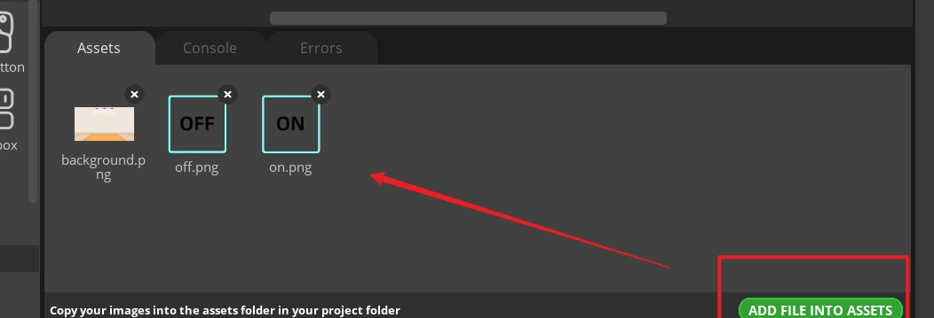

In the Assets area, click ADD FILE TO ASSETS and import the provided background.png, on.png, and off.png. After import, three thumbnails should appear.

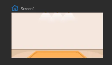

Select Screen1, expand STYLE SETTINGS > STYLE (MAIN) > Background on the right, and enable the background image setting. Enable Screen1 background image
In Bg Image, select background and disable unneeded page scrolling. The background should fully cover the 480 × 272 canvas. image-20260723122145602

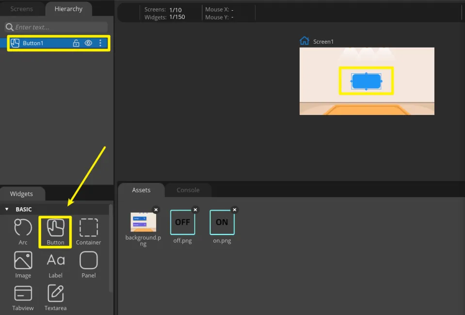

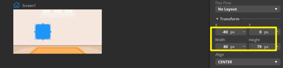

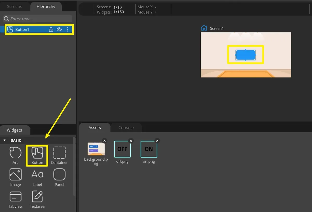

In Widgets on the left, click Button to add Button1 to Screen1, then move the button to the ON area on the left side of the screen. Add Button1
Select Button1 and set its position and size in Transform. Set Button1 position and size

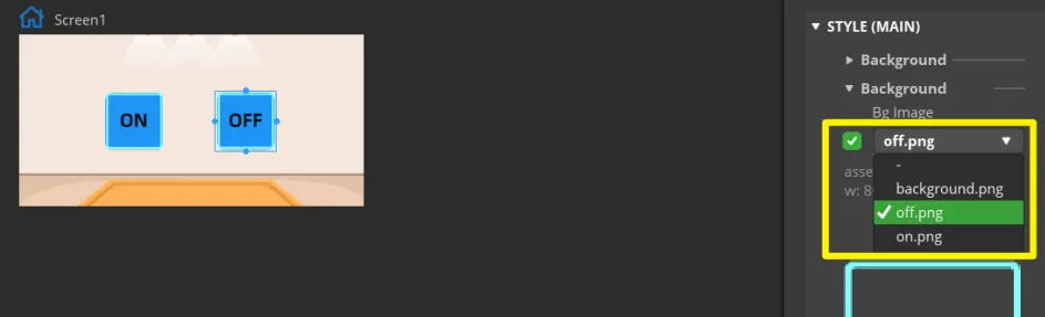

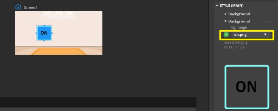

Expand Button1's STYLE (MAIN) > Background and select on.png. The ON icon should appear on the canvas without stretching or cropping. Set ON button background

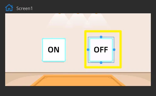

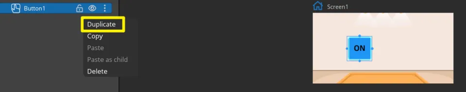

Duplicate Button1 to get Button2 and move it to the OFF area on the right. Duplicating preserves the same size and base style. Duplicate and move Button2
In Button2's background setting, select off.png and confirm that the ON and OFF images are on the left and right sides of the screen respectively. Set OFF button background

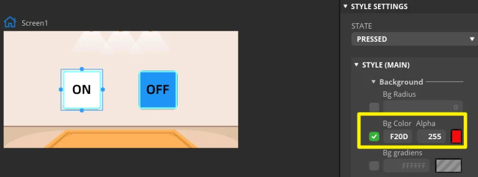

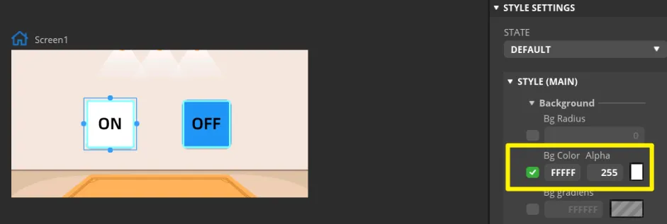

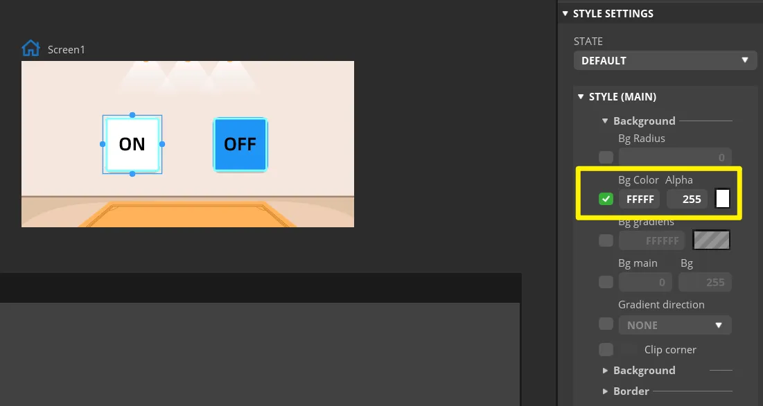

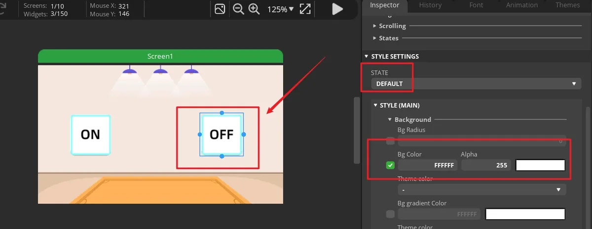

Select the button, check the DEFAULT state in STATE, and set the displayed background color to white. Check button Default state
Switch to the PRESSED state, set a recognizable press feedback, and set the displayed background color to red. Set button Pressed state
Set the same parameters for the "off" button.

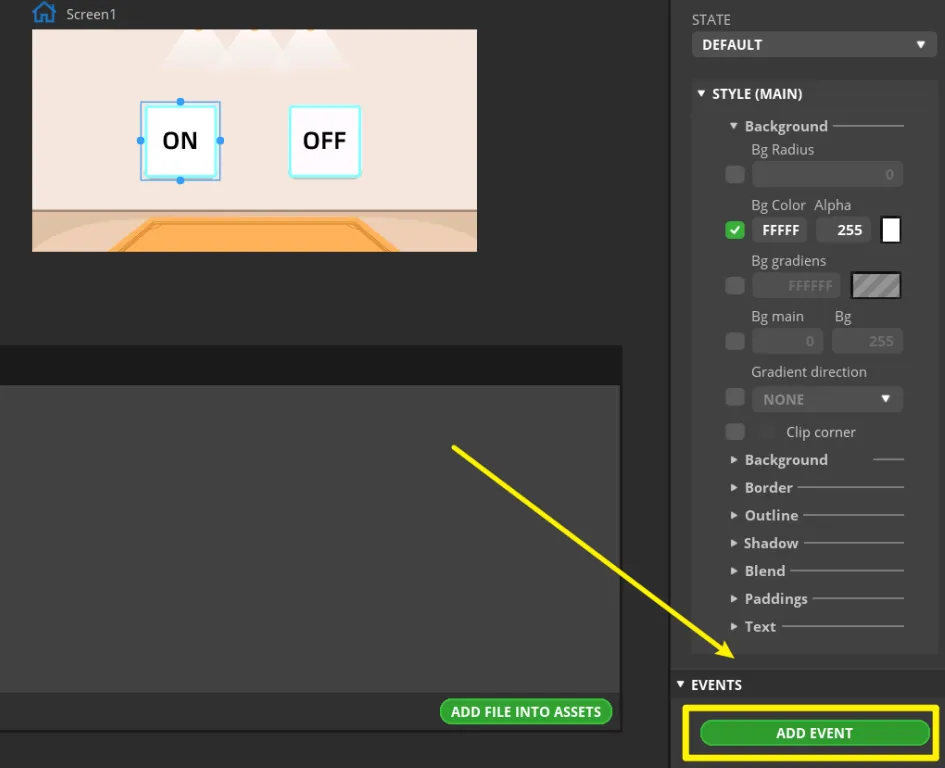

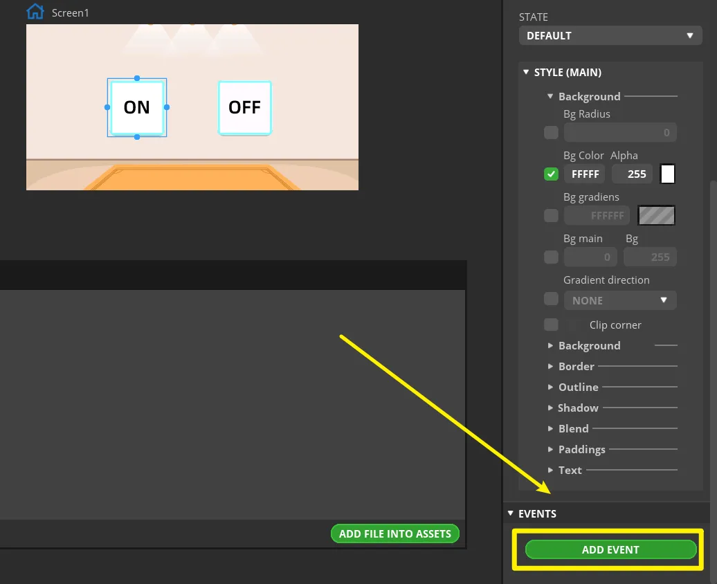

Note: Because the buttons can control the on/off state of the LED, we can add any events here to handle button events. When the UI files are exported, these events are used as code scaffolding. Later, we will modify the button event code to control the LED on/off state.
Select Button1, open the EVENTS panel and click ADD EVENT to create the first button event. Add event for Button1
Select "CLICKED" as the trigger condition, and choose the trigger event in "Action". The generated program will later be modified to implement the LED control function.

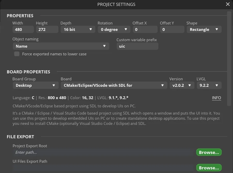

Open File > Project Settings, then configure the relevant settings for the exported files.
Open SquareLine Project Settings
image-20260723144632233

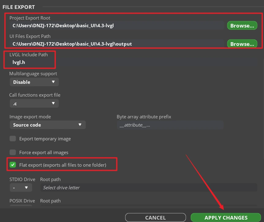

Set the export directory to an easily accessible path consisting of English characters only, create a new output folder, fill in and confirm that the LVGL Include Path is lvgl.h, then click APPLY CHANGES after confirmation.
image-20260723192032527
image-20260723140952851
Tip: After selecting Flat export, all output files will be placed in the same folder, and the program will not need to modify file paths anymore. If Flat export is not selected, files will be scattered across different folders, and the compiler may fail to recognize them automatically, usually requiring manual path changes; therefore, it is recommended to keep it checked.
Click Export > Export UI Files. Wait for the export to complete. Once the export is finished, ui.c, ui.h, ui_Screen1.c, the event files, helper files, and image array files should appear in the target directory.

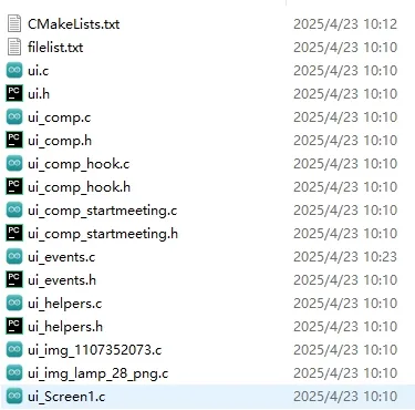

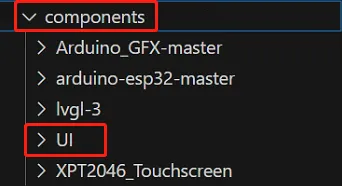

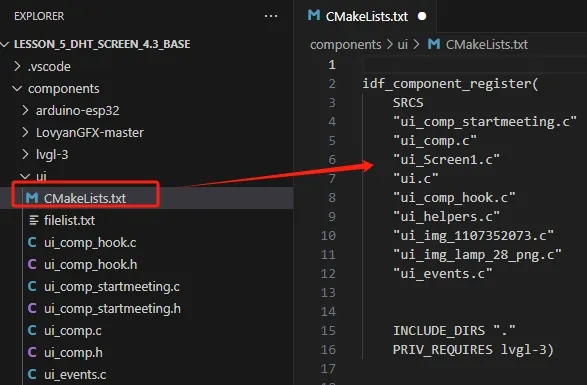

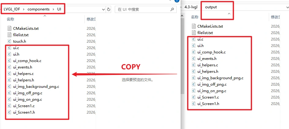

Copy all exported UI files (the .c and .h files) into the UI folder under the project's Components directory, replacing them with the LVGL 9.1 version. Make sure components/UI/CMakeLists.txt includes all these files in the compilation.

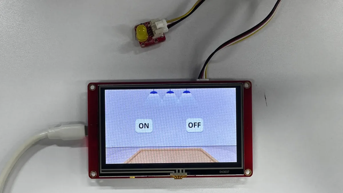

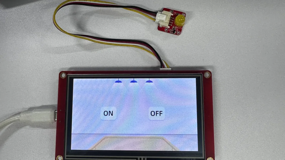

8. Observed Behavior
After the program resets, the serial port first outputs startup information, then the LCD backlight turns on and display initialization is completed. Once running stably, the screen shows the full background and the two image buttons. While a finger is pressed on the screen, the serial port continuously outputs the mapped x and y coordinates; clicking the left ON button lights the GPIO 38 indicator, and clicking the right OFF button turns the indicator off.
ON -> LED on.
IMG_7919
OFF -> LED off.
