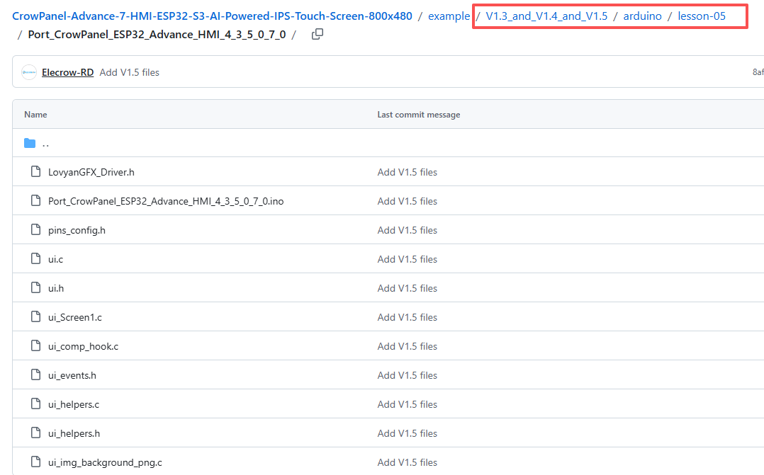

Click on the link below to download the code for this lesson:
CrowPanel-Advance-7-HMI-ESP32-S3-AI-Powered-IPS-Touch-Screen-800x480/example/V1.3/example_code_arduino_7.0/lesson-05 at master · Elecrow-RD/CrowPanel-Advance-7-HMI-ESP32-S3-AI-Powered-IPS-Touch-Screen-800x480 · GitHub
