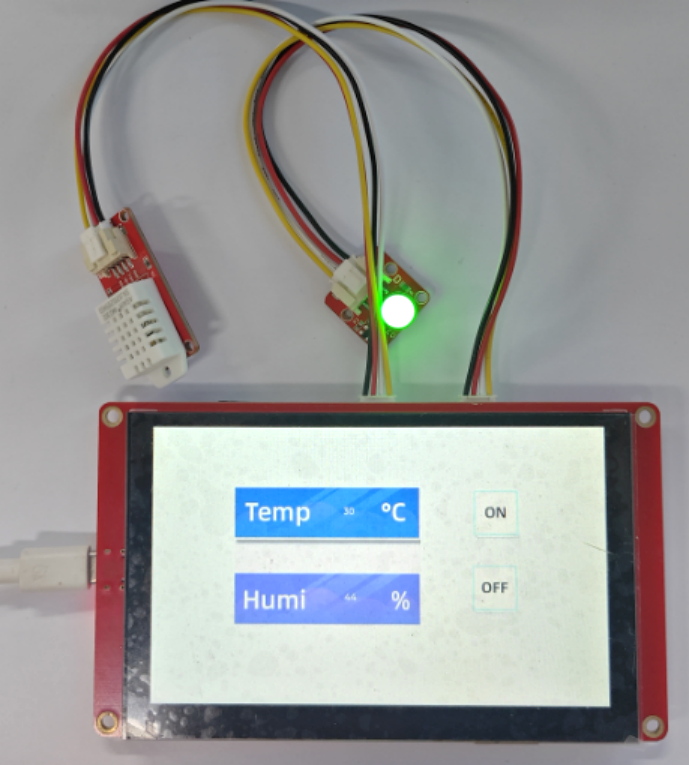

The example tutorial is an environmental monitoring project, demonstrate how to create a UI and use a sensor to obtain the environment temperature and humidity and display it on the screen; and how to control the LED on and off by the buttons on the screen.
In this tutorial, we will show you how to design the UI with SquareLine Studio, and show you how to upload the code with Thonny IDE.

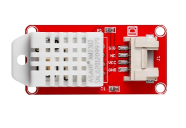

CrowPanel ESP32 7.0'' HMI | Crowtail-AM2302 | Crowtail-LED | Crowtail Cable |

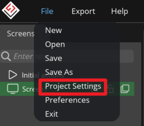

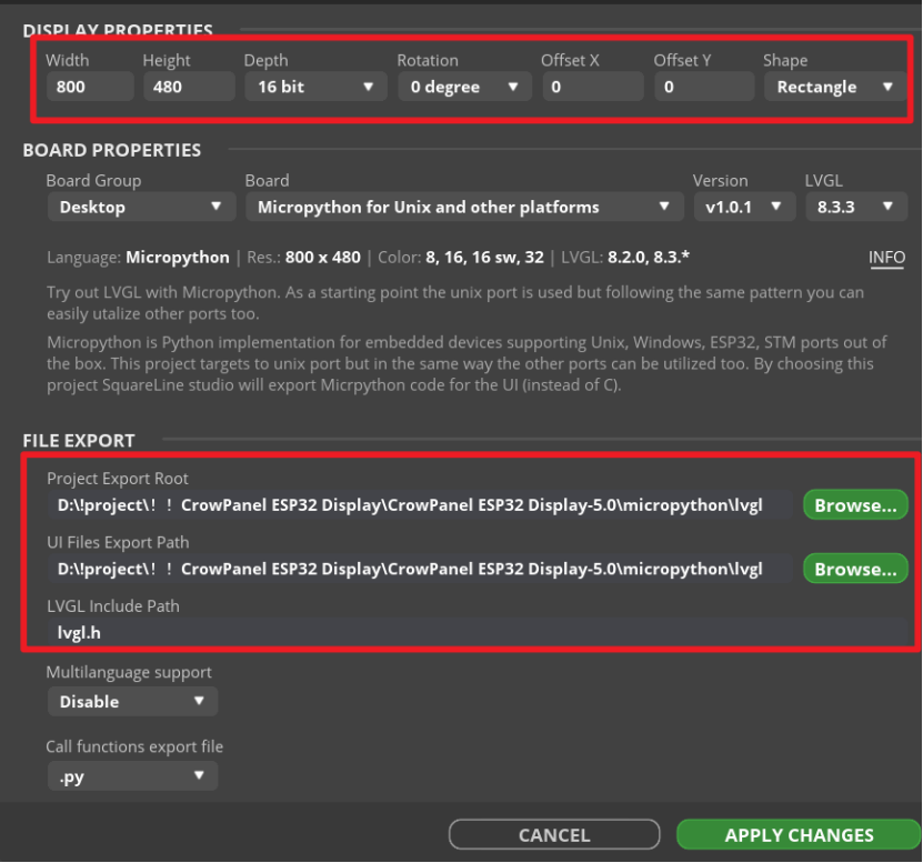

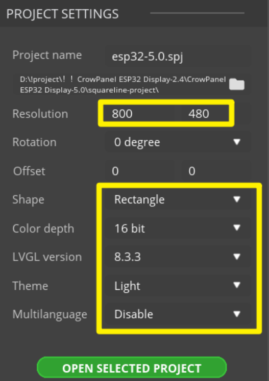

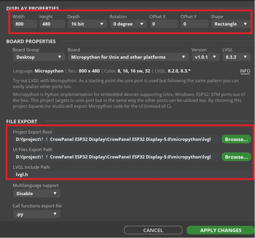

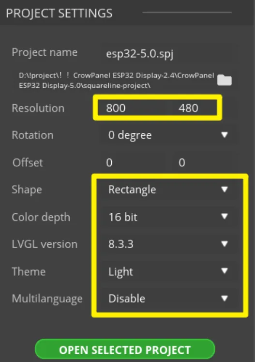

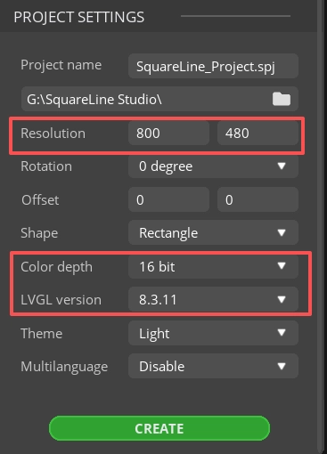

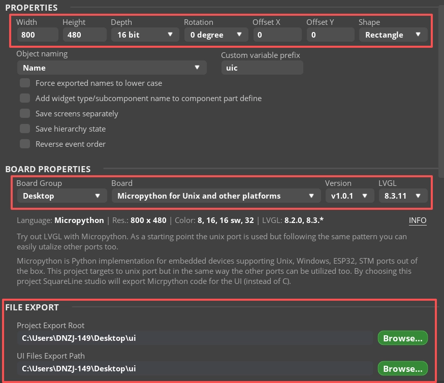

Open the SquareLine Studio and create a project. Select "Desktop"->"Micropython for Unix and other platform".
Set the name of the project, set the screen resolution to 800*480, set the color depth to 16bit, and keep other default settings. After setting, click CREATE to create the project.

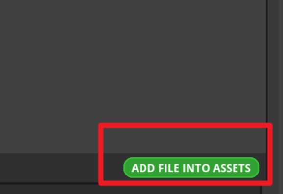

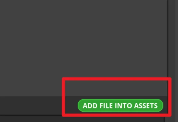

Please click
to download the custom images used in this tutorial.

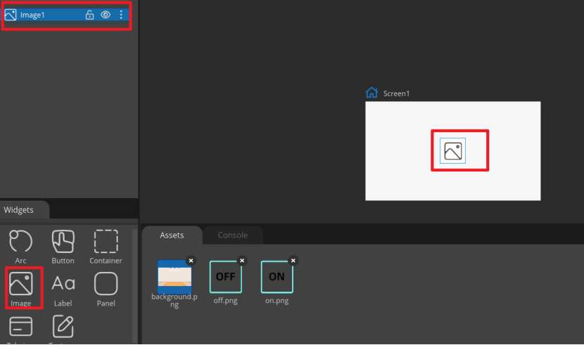

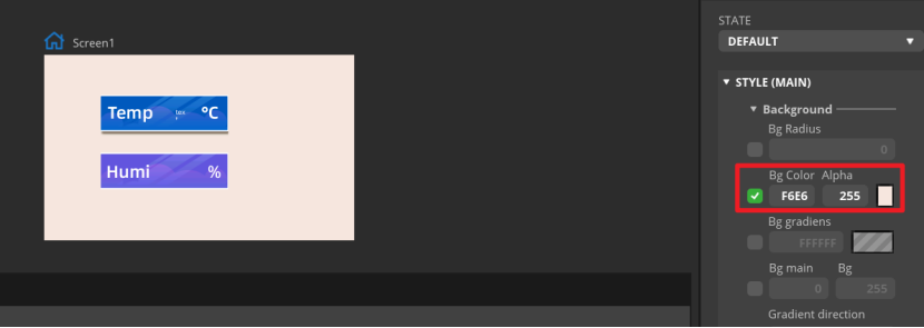

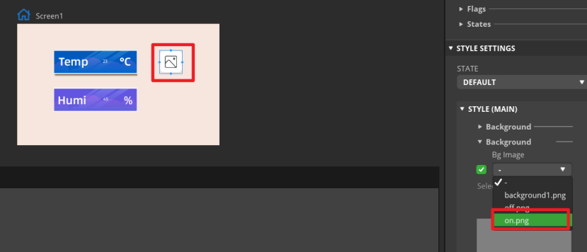

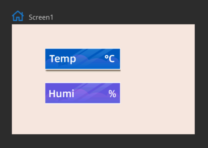

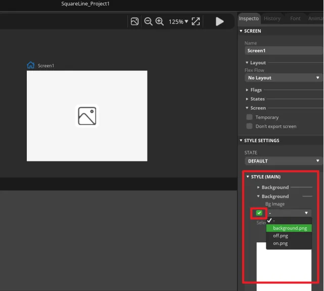

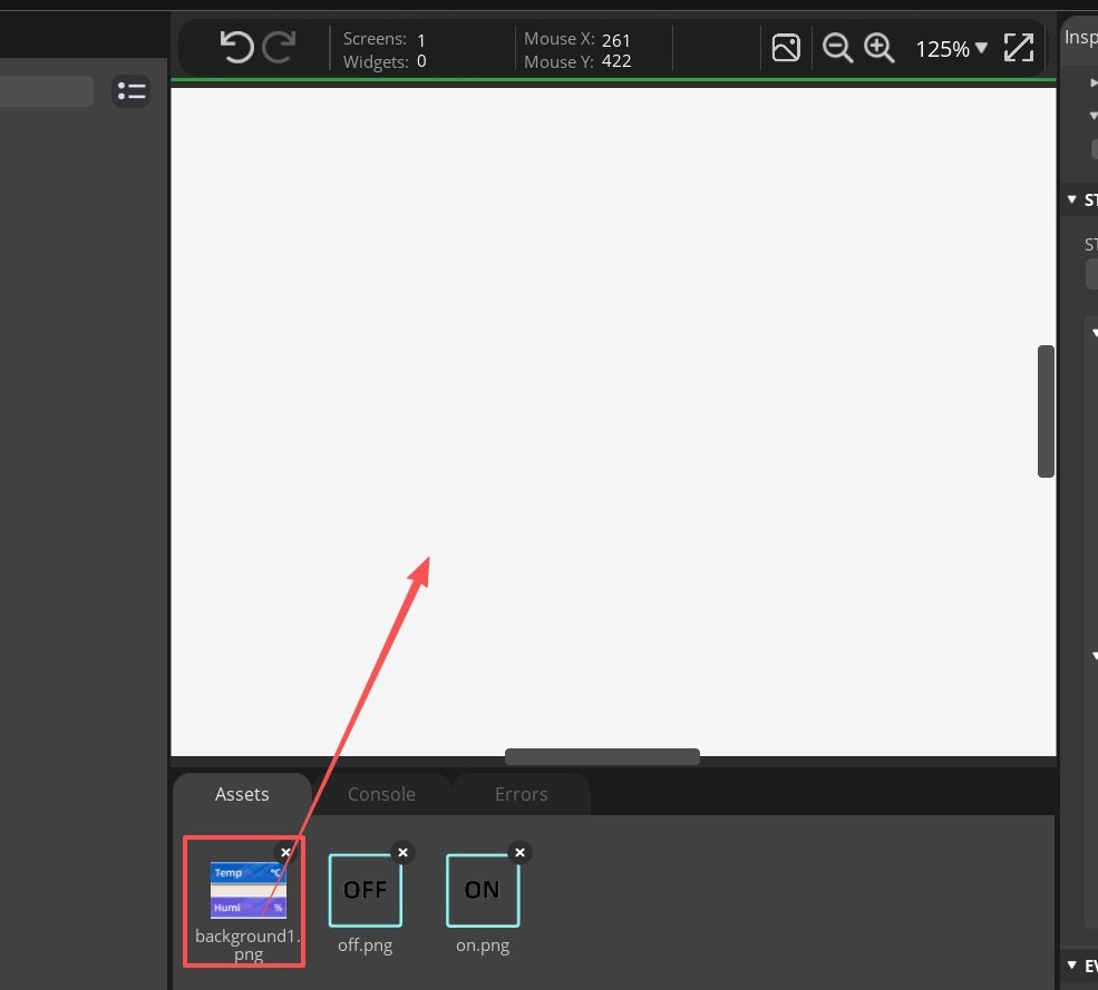

Add background.

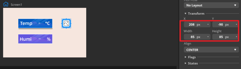

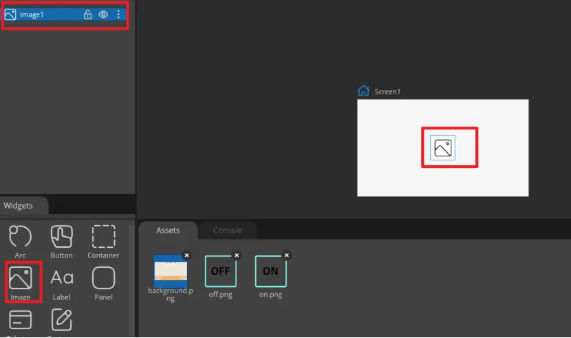

Click "Image" to add the image widgets.

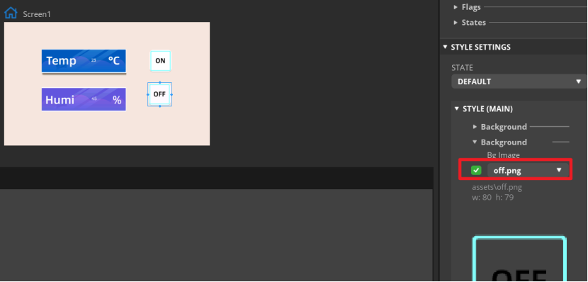

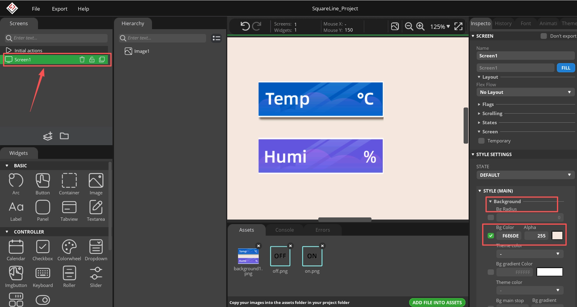

Find "Inspector"->"STYLE SETTING", click to expand "STYLE(MAIN)", then click the 2nd "Background". Check the "Bg Image" and select a background picture.
Adjust the position of the image.
Note: Because it requires a large amount of memory when running in Thonny IDE, the UI background resolution of this tutorial is small and not full screen, so it is necessary to modify the background to the same color as the image.

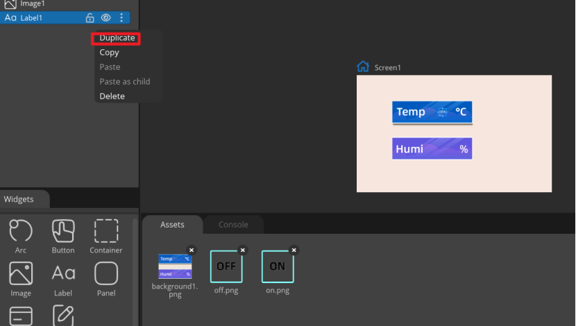

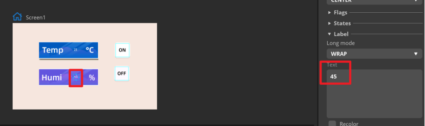

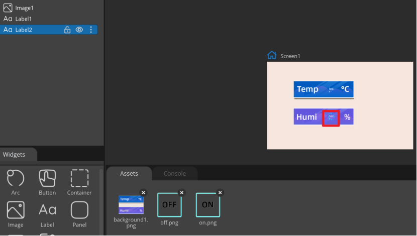

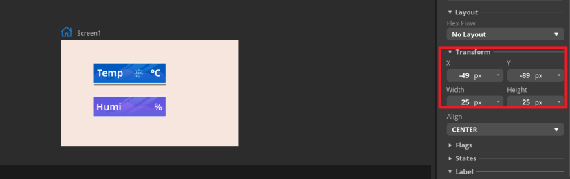

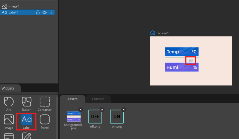

Add Label widget to show temperature and humidity value
The content, position and size of the label can be adjusted by dragging the mouse. You can also directly enter numbers in the Inspector→LABEL→Transform to adjust. You can set the font color and other attributes in STYLE SETTING→STYLE(MAIN).
You can set the color and other attributes of the font in STYLE SETTING ->STYLE (MAIN).
Duplicate a Label2 to show humidity value.
Adjust the position.
You can change the text of the label to set a default value.

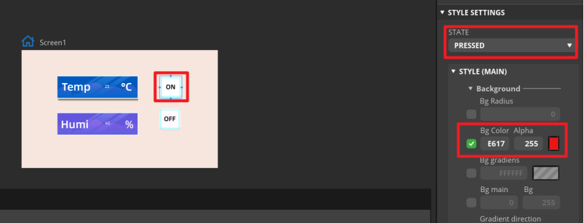

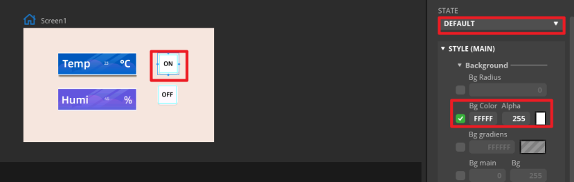

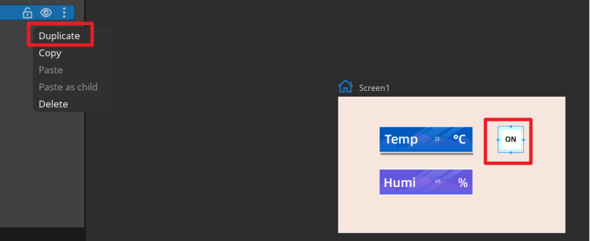

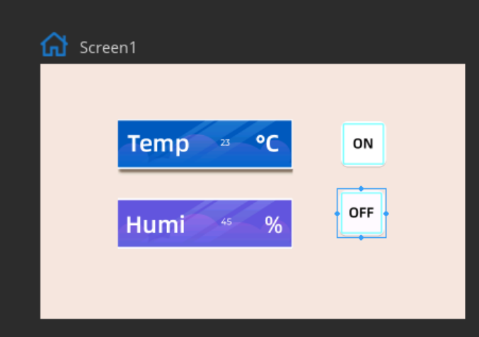

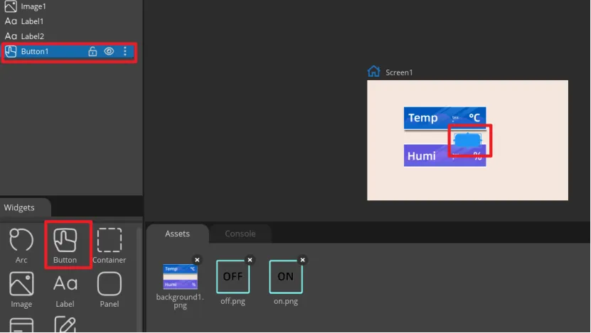

Duplicate a Button2 for "OFF".

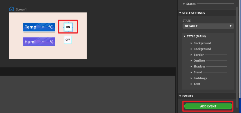

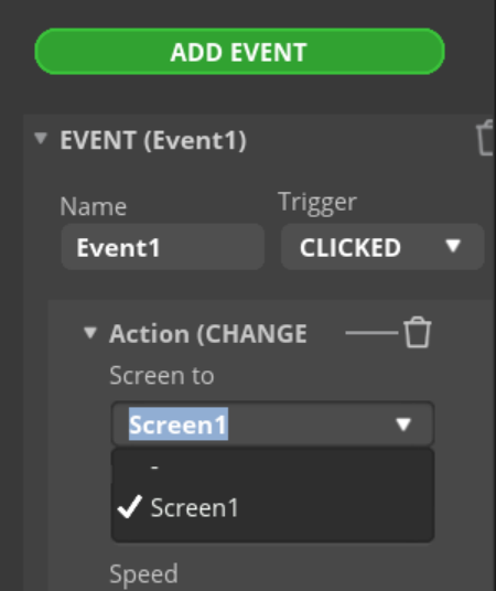

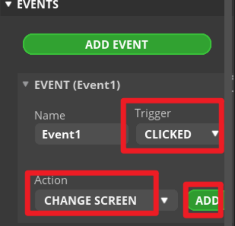

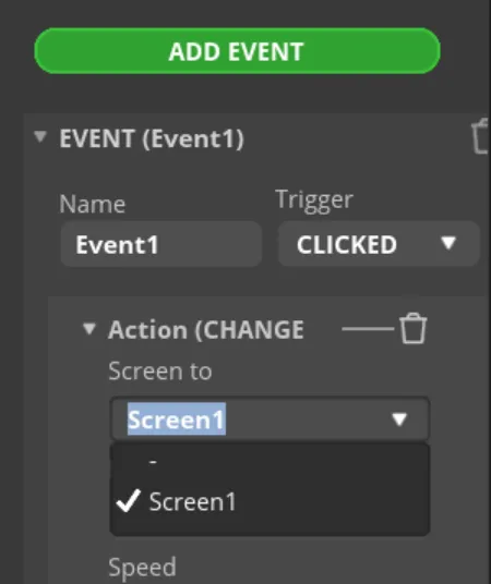

Add events to buttons.

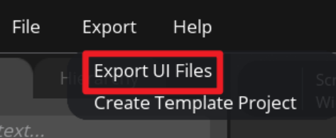

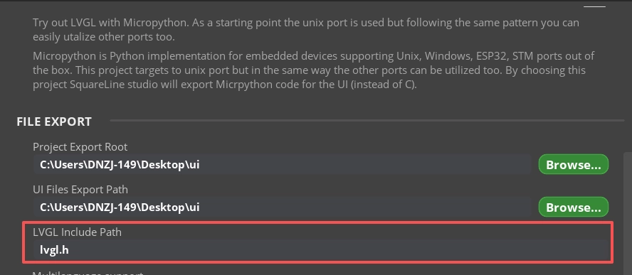

Export UI files.
Then click "APPLY CHANGES".

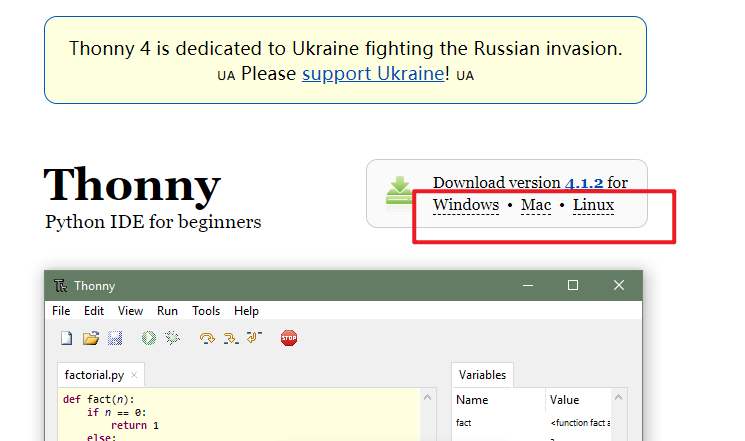

Download Thonny IDE¶
Go to the website https://thonny.org/ and download the corresponding software version (here we take the Windows version as an example)
Double-click the downloaded exe file to install the software.

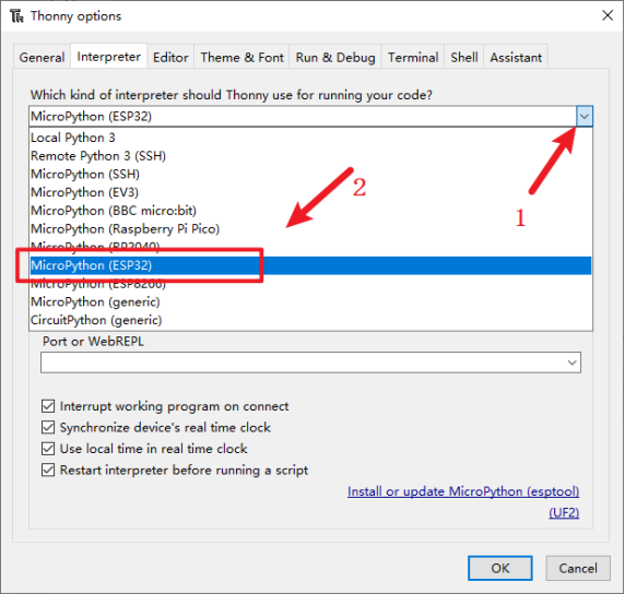

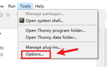

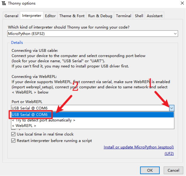

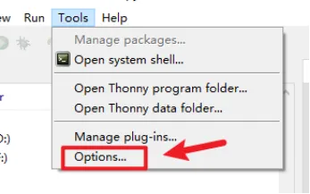

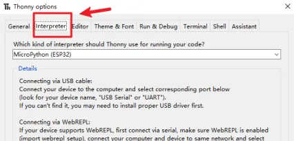

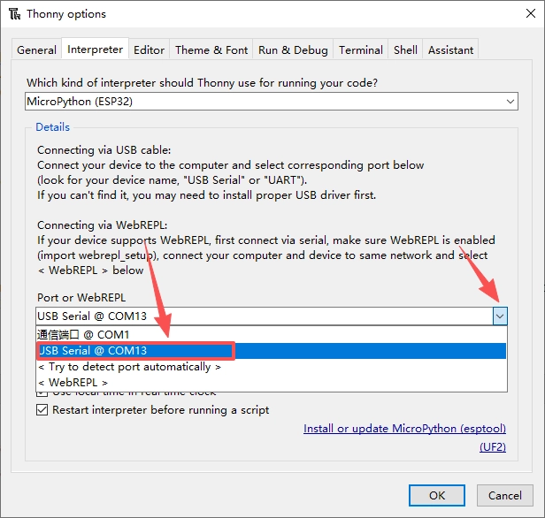

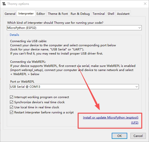

Open Thonny IDE and click "Tools"->"Options"->"Interpreter".

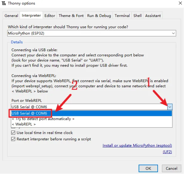

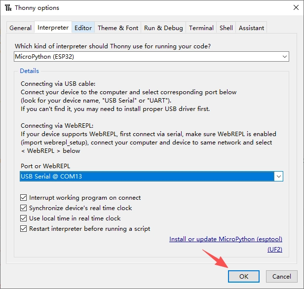

Select "MicroPython(ESP32)" for interpreter.
Select the corresponding serial port(or Try to detect port automatically).

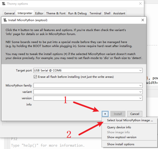

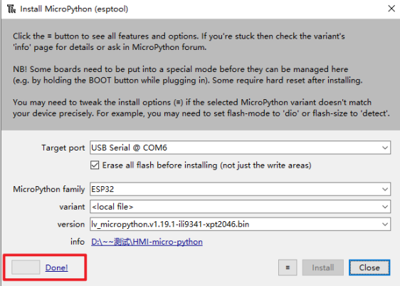

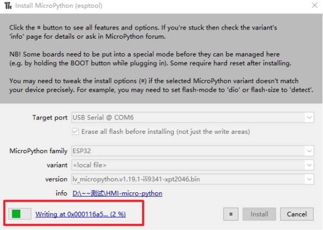

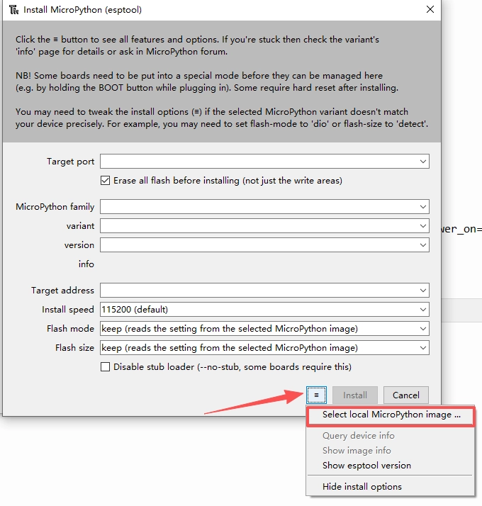

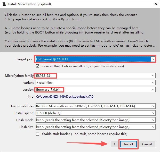

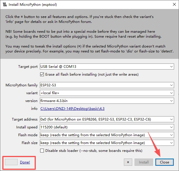

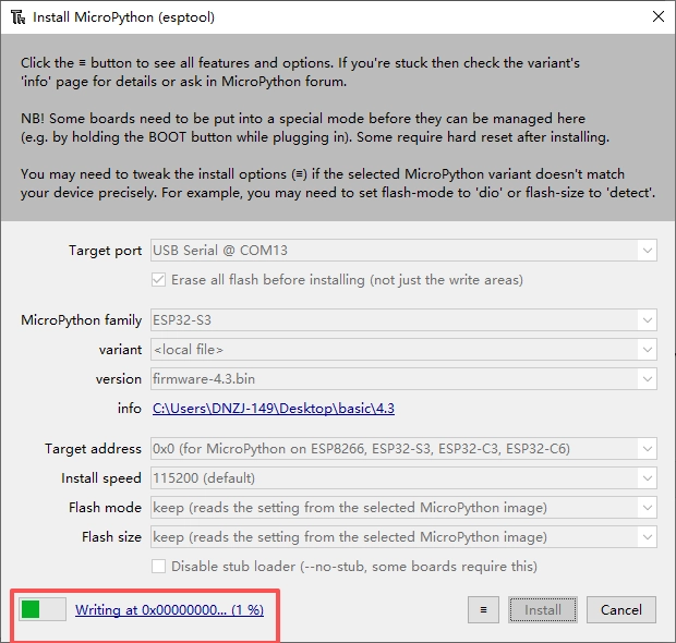

Click "Install or update MicroPython (esptool)"
Click the icon with 3 lines, and click "select local MicroPython image...".Select the "firmware-7.0-A.bin" and install.
Please click
to download the bin file.
Waiting for downloading...

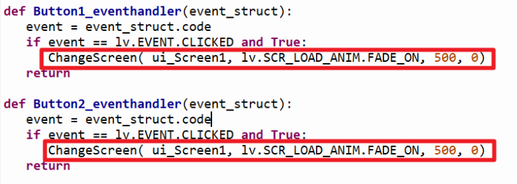

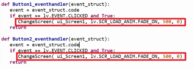

This part copies the code of ui.py generated by Squareline Studio. We need to modify the part that control the button.
Modify from
to
def Button1_eventhandler(event_struct):
event = event_struct.code
if event == lv.EVENT.CLICKED and True:
pin38.value(1)
return
def Button2_eventhandler(event_struct):
pin38.value(0)
return

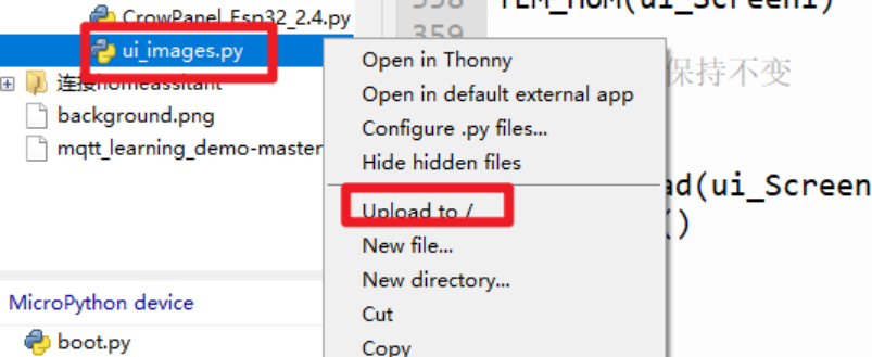

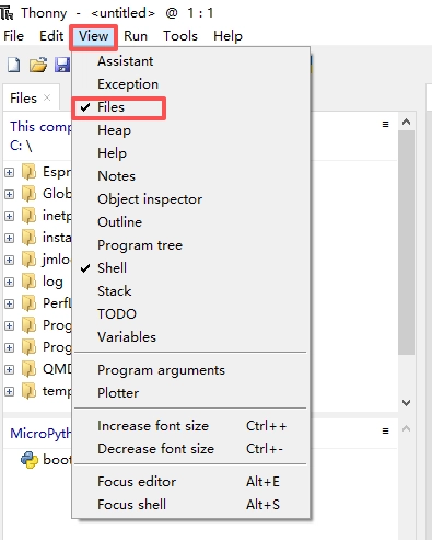

Upload the libraries¶

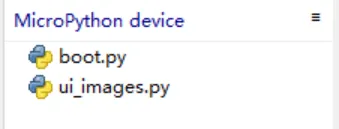

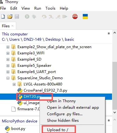

ui_image.py

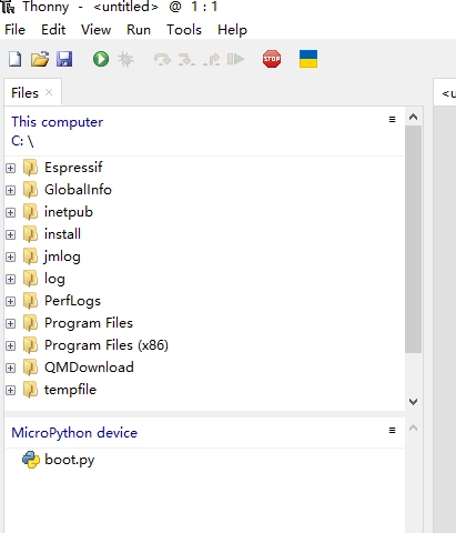

In the upper left corner of the thonny, enter the path where ui_image.py is located, right-click ui_image.py, and click Upload to/
ui_image.py is added to MicroPython device successfully.

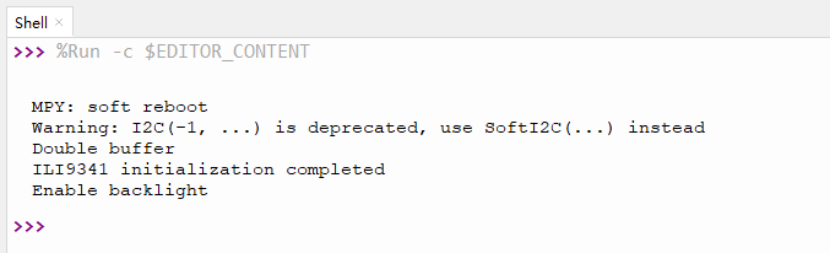

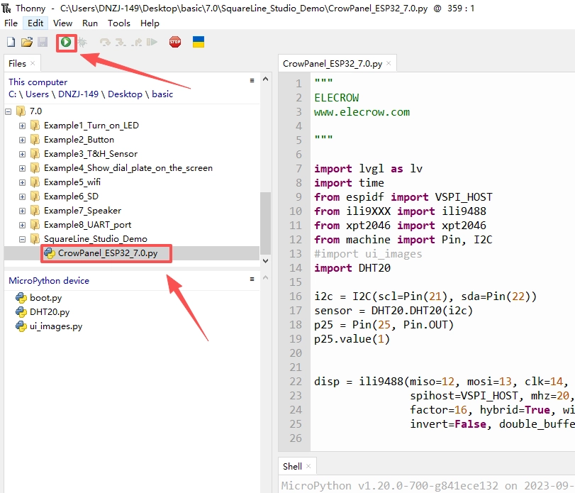

Click the "run" icon to run and upload the CrowPanel_ESP32_7.0.py.
Successfully uploaded.

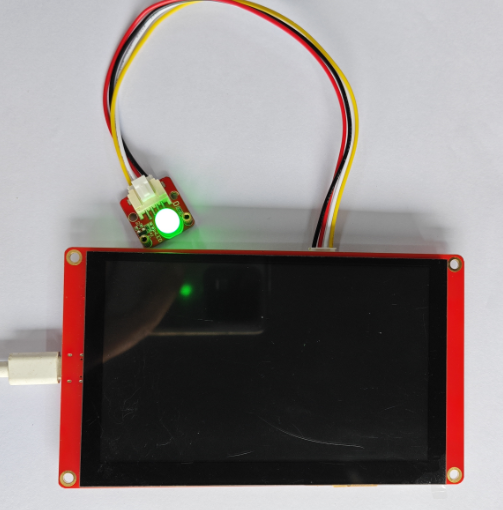

Example 1 Turn on/off the LED automatically in a loop¶
- Connect an LED module to the D port(pin38)
- Open and upload the led.py.
- The LED will turn on and off in a loop.

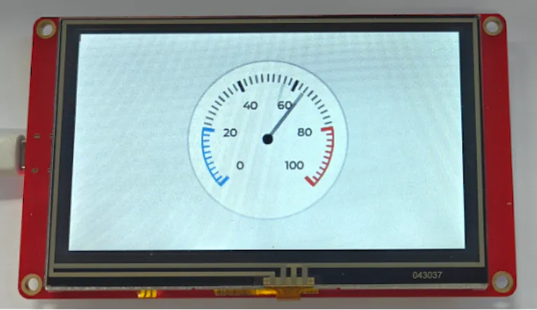

Example 3 Show dial plate on the screen¶
Upload the biaopan-7.0.py to the module, there will be a dial plate show on the screen.

MyWidget(scr)
# 4. Displays the contents of the screen object
lv.scr_load(scr)

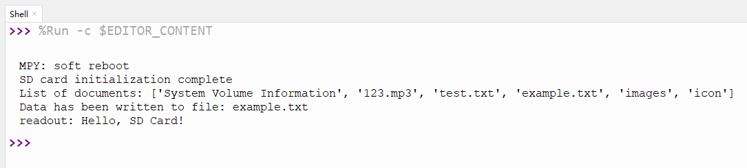

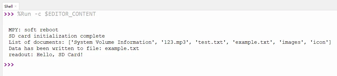

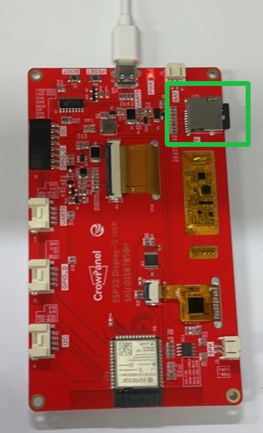

Example 5 Initialize SD card¶
Upload the sd.py to ESP32 HMI
import machine
import os
import sdcard
import uos
# SD Card Initialization
def init_sd():
# Creating SPI Objects
spi = machine.SPI(2, baudrate=1000000, polarity=0, phase=0, sck=machine.Pin(12), mosi=machine.Pin(11), miso=machine.Pin(13))
cs = machine.Pin(10, machine.Pin.OUT)
sd = sdcard.SDCard(spi, cs)
vfs = uos.VfsFat(sd)
uos.mount(vfs, "/sd")
print("SD card initialization complete")
print("List of documents:", os.listdir("/sd"))
# write to a file
def write_file(filename, data):
with open("/sd/" + filename, "w") as file:
file.write(data)
print("Data has been written to file:", filename)
# Read file
def read_file(filename):
with open("/sd/" + filename, "r") as file:
data = file.read()
print("readout:", data)
return data
# Example: Initialize SD card and read/write files
def main():
init_sd()
filename = "example.txt"
data = "Hello, SD Card!"
read_file(filename)
if __name__ == "__main__":
main()
