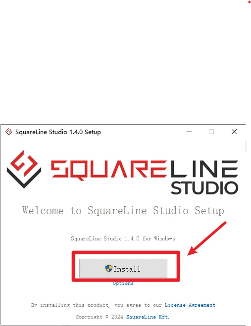

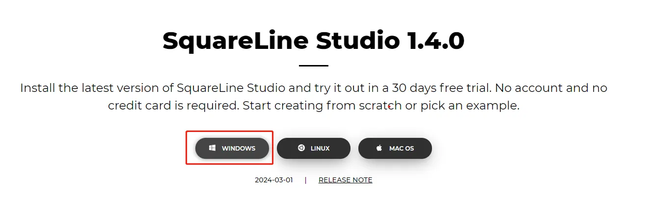

2.Install SquareLine Studio
2.1 Installation Guide
3
Download the version 1.4.0
4
5

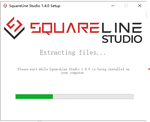

Click install.
6
Wait for installation.
7

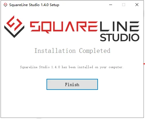

Installation finish.
8

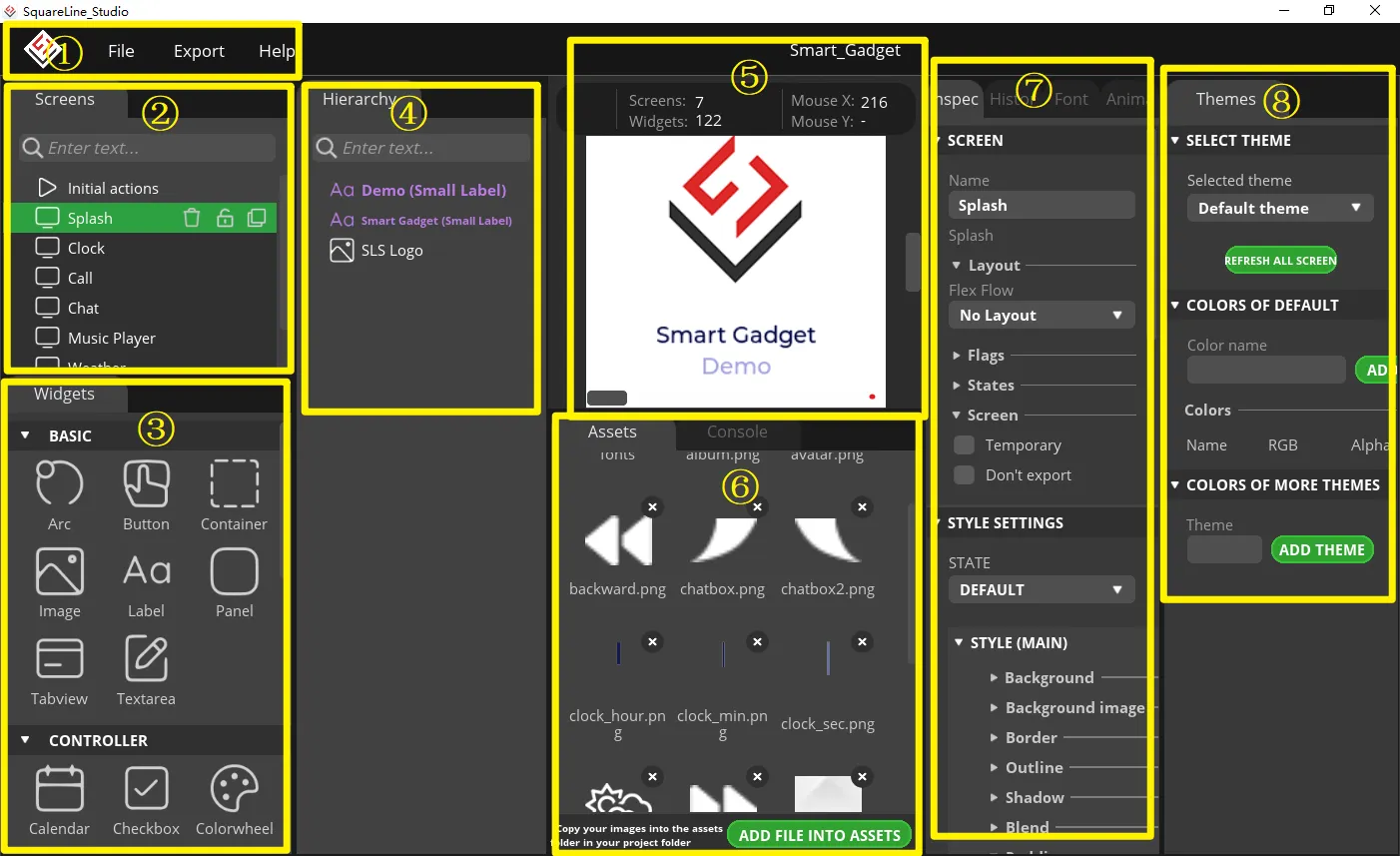

2.2 Software Function Introduction

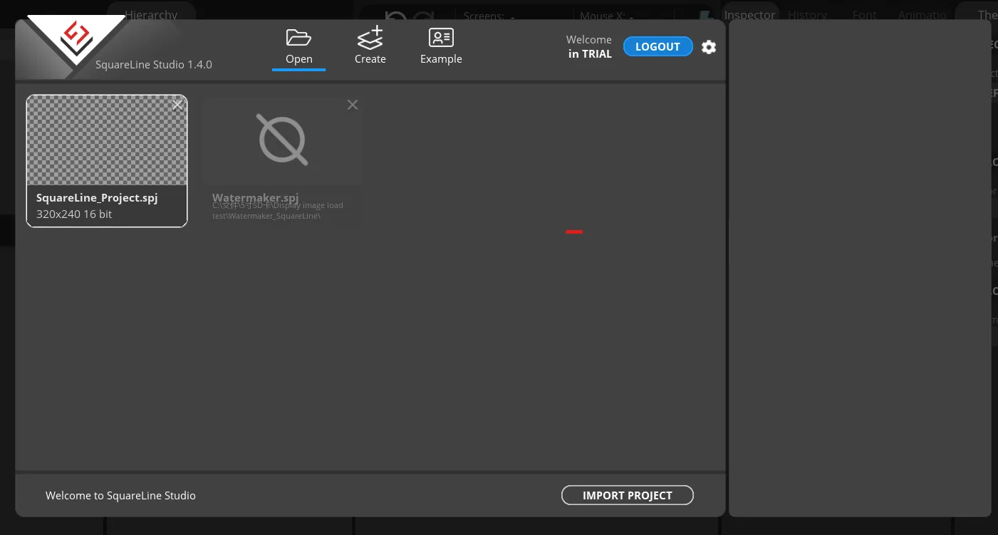

Open the software
10
11
12
13
Note: Please select the corresponding resolution and color depth according to the screen specifications.
14
②Screen bar, the project screen will be listed here.
③Widget area, all widgets are here and can be selected and used according to project needs.
④Hierarchy area, it will show every widget used in each screen.
⑤This area shows the actual display effect, you can adjust the widgets or screen here.
⑥Material column, the added materials are displayed here.
⑦Setting bar, where you can make basic settings for each part, including the basic attributes and trigger operations of the part.
⑧Theme bar, different themes can be set.

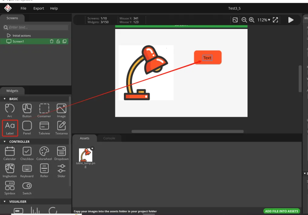

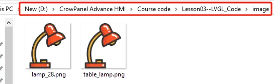

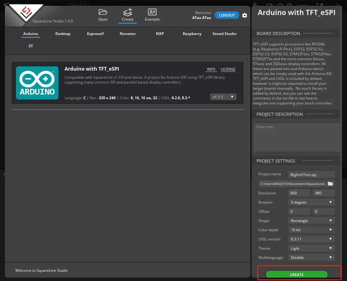

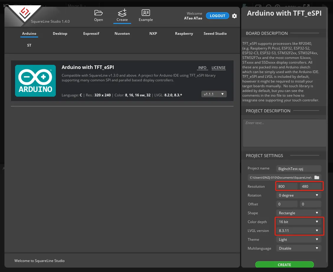

3 Use SquareLine Studio to create UI control interfaces
15
16
Here, I take a 5.0-inch screen as an example. After determining the resolution, I fill it in
17
18
19
20
Table_1amp image sizes are available for 3.5-inch, 4.3-inch, 5.0-inch, and 7-inch screens.
21
22
23
24
25
26
27
28
29
30
31
32
33

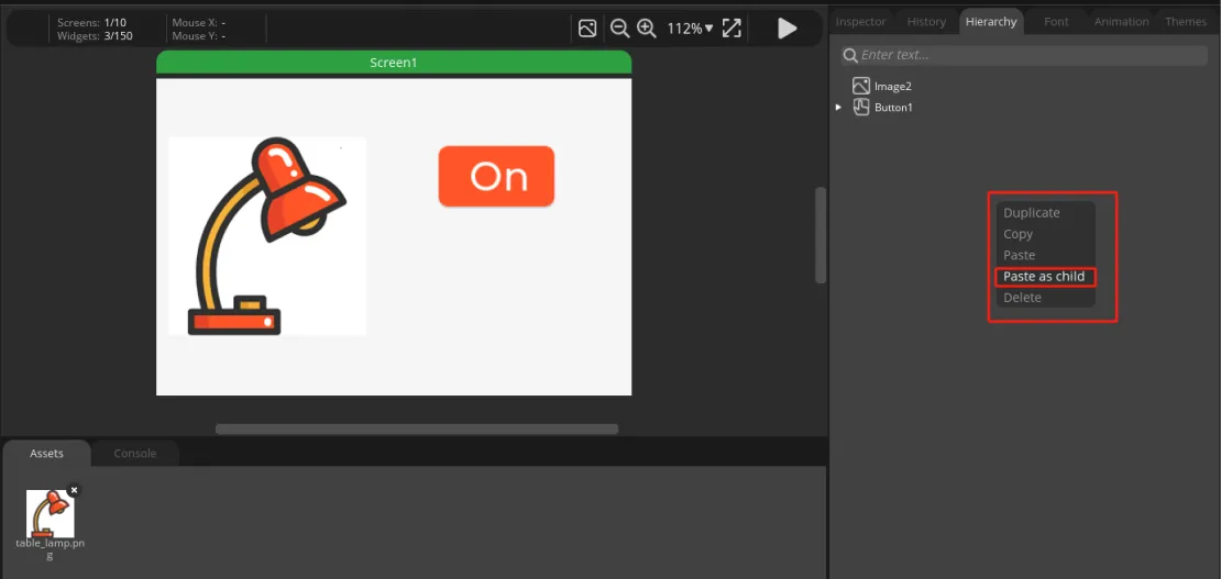

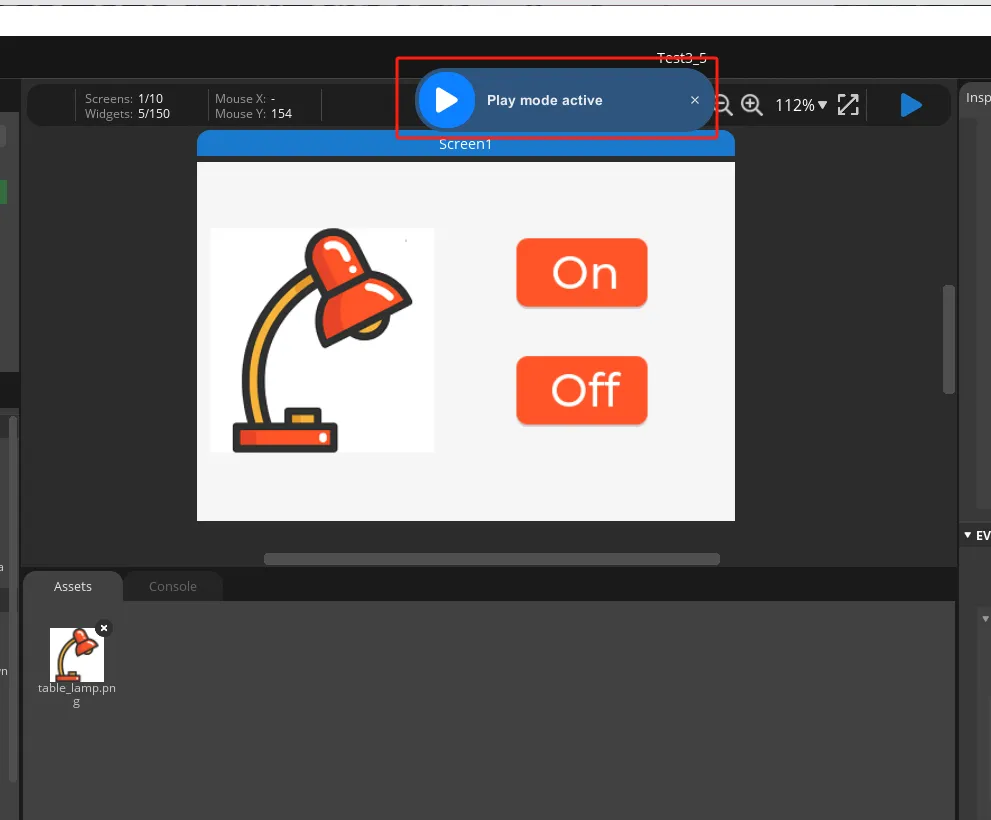

4 Add functions to the buttons to enable them to turn on and off lights
Select 'event' to add in the right sidebar
34
35
After selecting, click ADD.
36
37
After adding, run
38
39

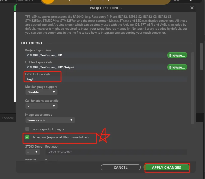

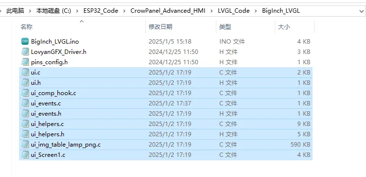

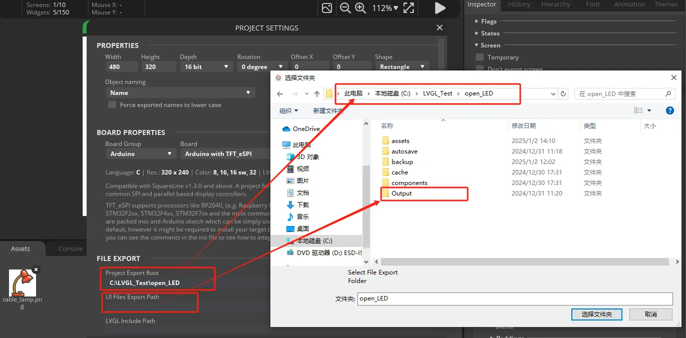

5 UI interface design completed, exporting UI files for easy use in subsequent code
Click on Project Setting
40
Set export path
41
42

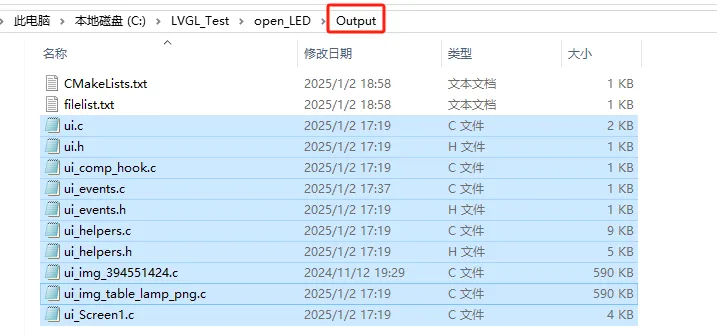

Complete the setup and export file
43

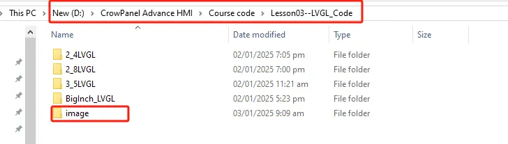

Copy and paste the exported code into the code folder we need to open
44
45

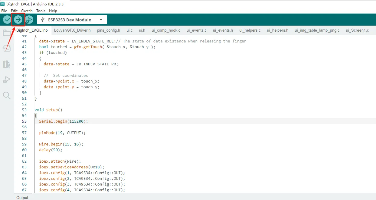

Then double-click BigInch_LVGL.ino and open it using Arduino IDE

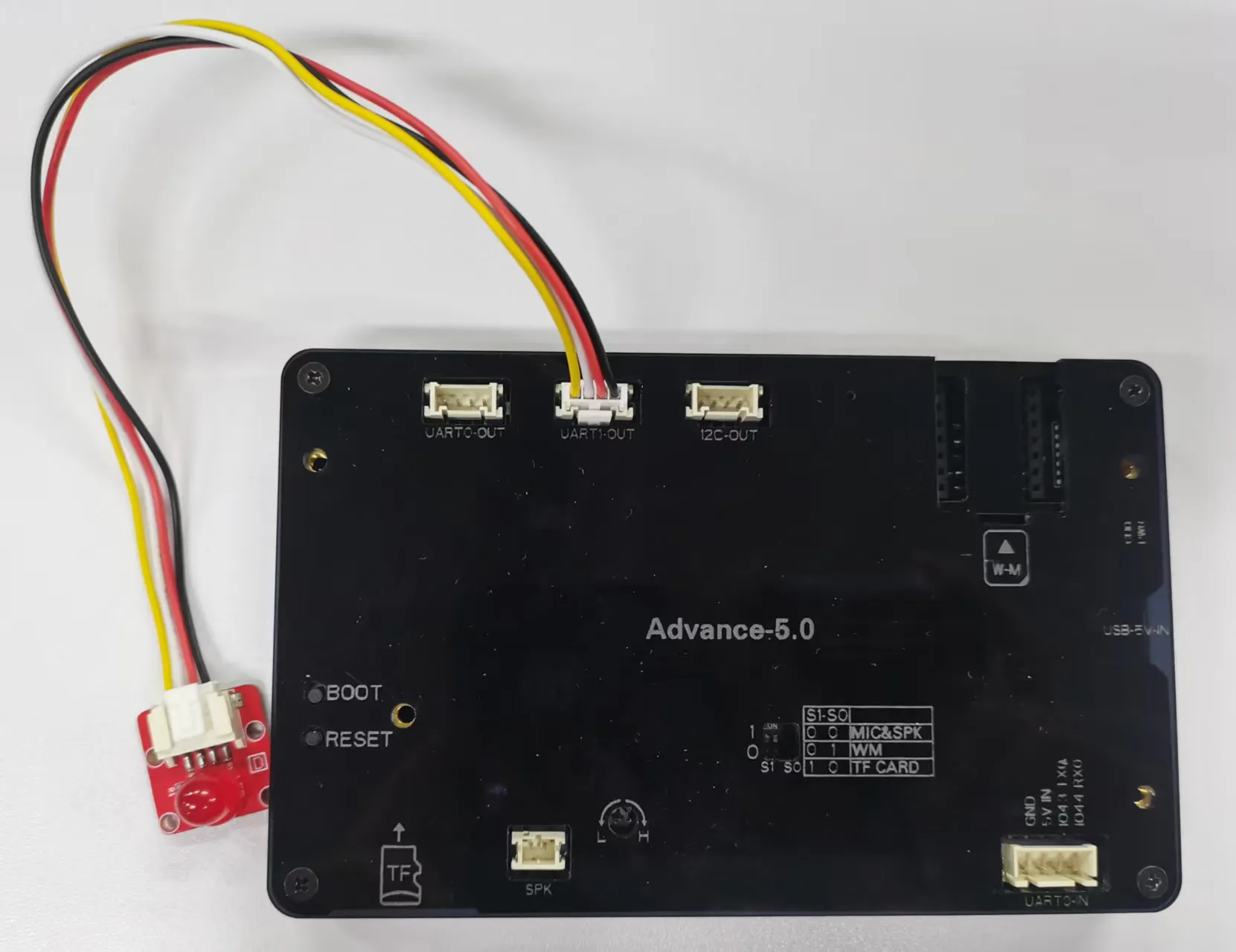

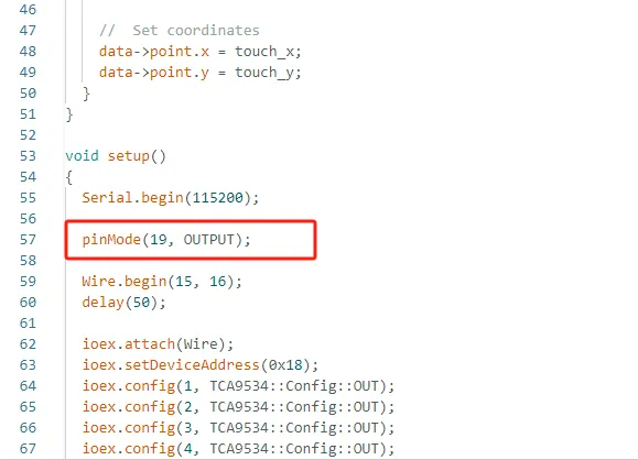

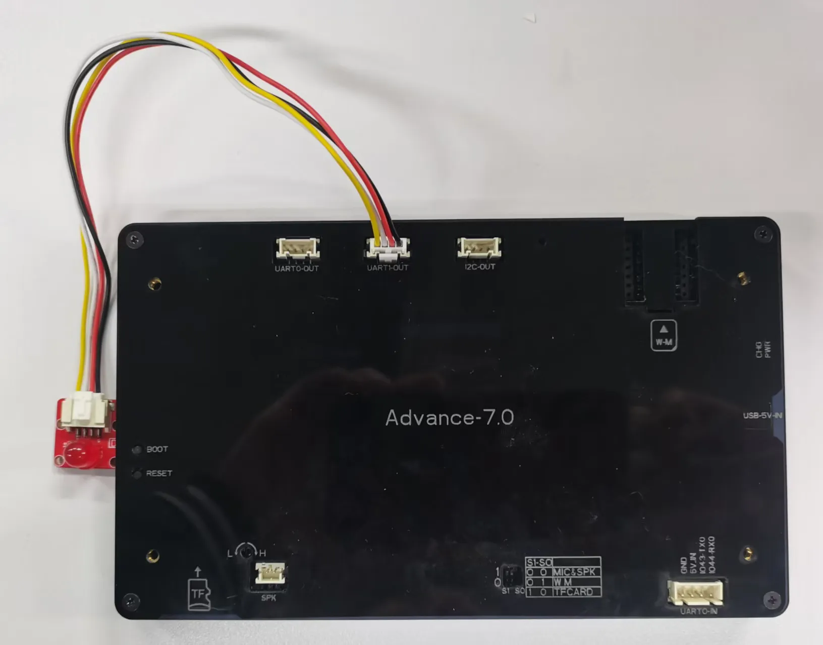

6 Connect the light bulb and add code to control the light bulb to turn on and off

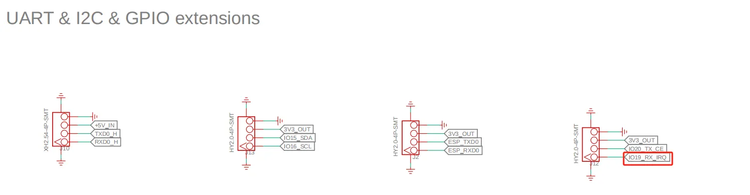

Connect the light bulb at the UART1 interface
46

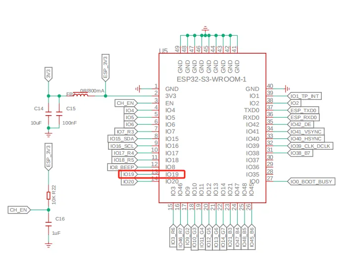

Observing the schematic diagram of this size, it is known that the pin for UART1 to control the light bulb to turn on and off is 19
47
48
A large-sized screen requires setting 19 pins as the output mode.
(Due to the fact that pin 19 in the circuit of large-sized products controls both the wireless module and the UART1 interface, it is necessary to switch the mode to 0 1)
49
49-1

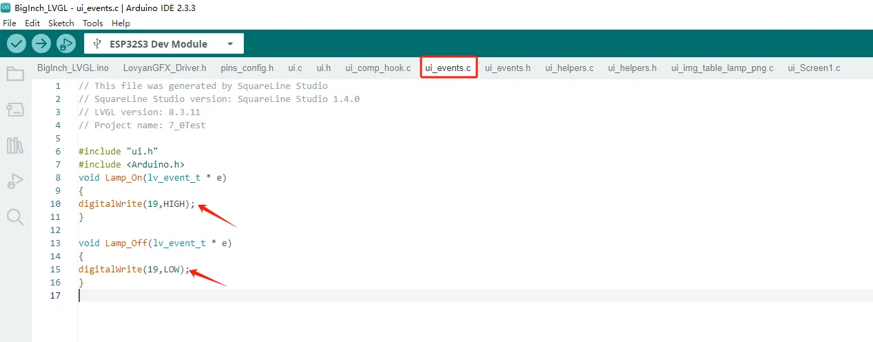

And add the function of turning on and off the light bulb in the ui_ event. c file.
(When the On button is clicked, the light is on; when the Off button is clicked, the light is off)
50

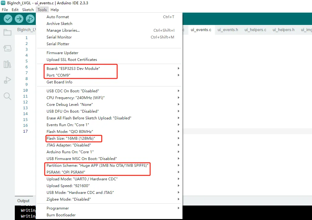

7 Configure the code running environment and upload the code
(!! Before uploading the code, please use different library files according to the size you are using. You can review the content of Lesson 2)
(For large-sized screens of 4.3 inches, 5.0 inches, and 7.0 inches, be sure to switch the mode to 0 1 state before uploading the code, because the pins of UART1 and W-M mode are both used in 0 1 mode, so that you can use the pins of UART1)
51
52

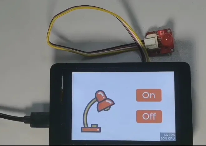

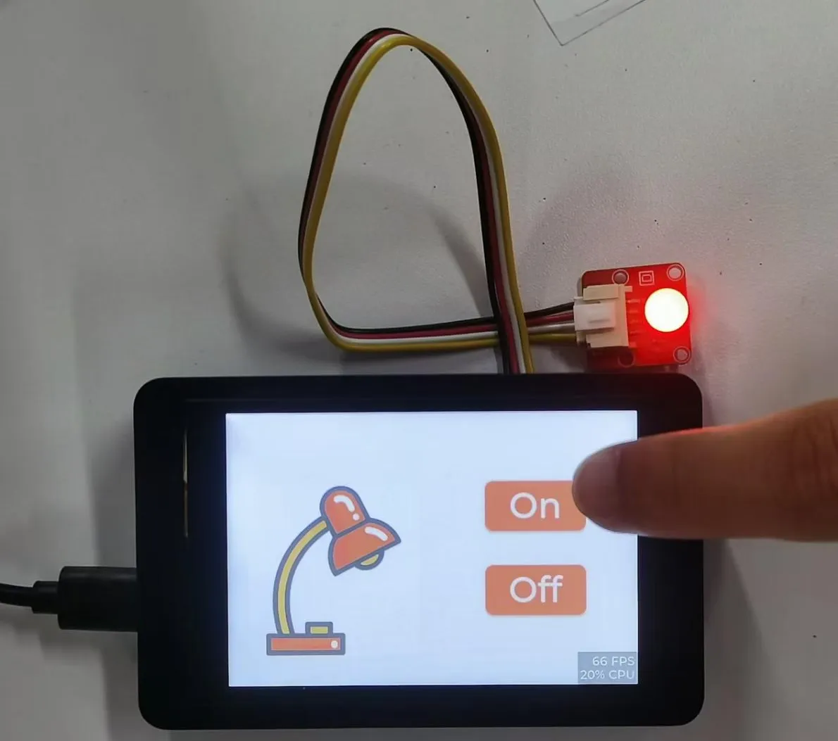

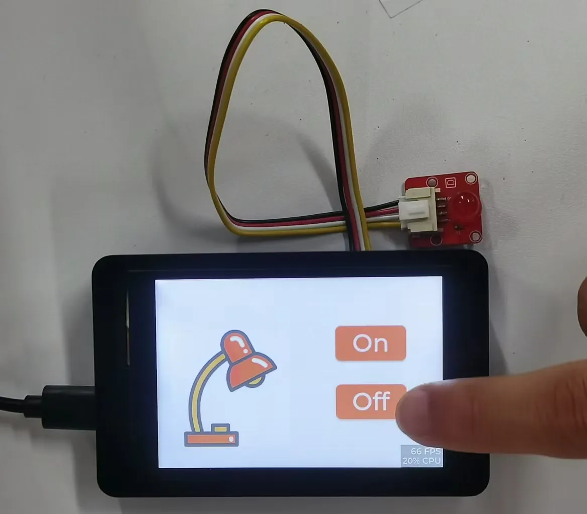

So you can see the UI interface you just designed
53
You can click the On and Off buttons to control the on/off of the lights
54
