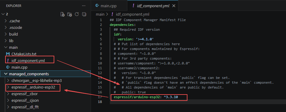

This project is developed and run on ESP-IDF version 5.5.4.
First, you need to specify the version of the arduino-esp32 component in the idf_component.yml file under the main folder. In this project, version 3.3.10 is used to ensure compatibility with ESP-IDF 5.5.4. After the configuration is completed, the ESP-IDF build system will automatically download and integrate the specified Arduino framework version during the first compilation.
This setup allows the project to combine the ESP-IDF development environment with the Arduino programming interface, enabling the use of Arduino-style APIs within an ESP-IDF-based project.
image-20260622180616854

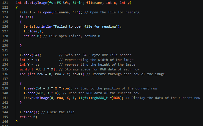

This section implements the logic for reading 24-bit uncompressed BMP images from the SD card and drawing them onto the screen. The input parameters are the file system, the image path, and the width and height of the image. The image file is opened in read-only mode. If the opening fails, it returns directly. The first 54 bytes of the BMP file are the file header and information header. The header is skipped using seek and the pixel data starting position is directly jumped to. A single-row RGB888 cache is created, and the image pixel data is read row by row. The LovyanGFX single-row pixel push interface is called to render it onto the corresponding row of the screen. After the entire image is rendered, the file handle is closed and a return value of 0 indicates that the drawing is complete.
image-20260623170857384
