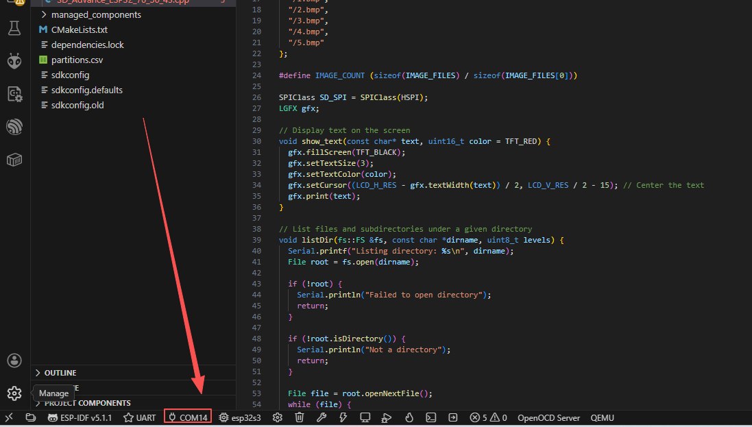

After Connecting the Device, Select the Serial Port
IDF-18

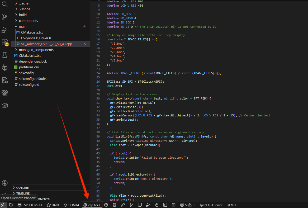

Set the Main Control Chip to: ESP32-S3
IDF-19

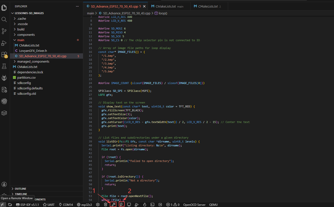

Click "Build Project". Once the compilation is complete, click "Flash Device".
IDF-20
