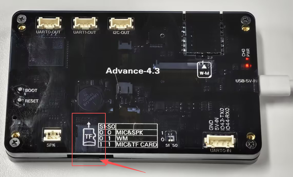

3 Insert the SD card containing this saved image into your CrowPanel ESP32 Advance HMI
Insert the SD card into the TF card slot, provided that you have already placed the correct pictures inside it.
IDF-15
(2.4-inch,2.8-inch,3.5-inch products can be directly inserted for use)

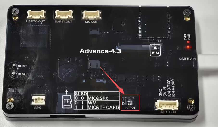

IDF-16
(After inserting the SD card, turn the function switch to 1 1 mode (TF Card mode) for 7.0-inch, 5.0-inch and 4.3-inch.)

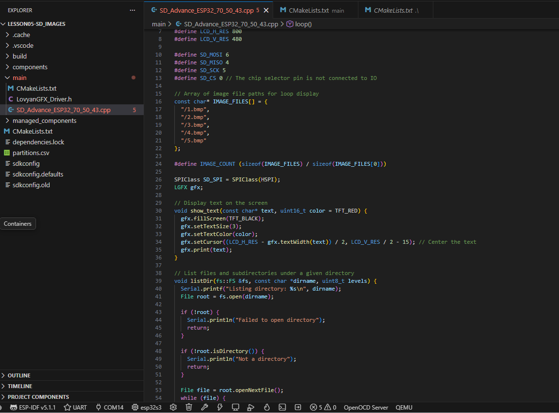

4 Open the code we provide
Code download link:
CrowPanel-Advance-5-HMI-ESP32-S3-AI-Powered-IPS-Touch-Screen-800x480/example/V1.2/IDF_Code/Lesson05-SD_images at master · Elecrow-RD/CrowPanel-Advance-5-HMI-ESP32-S3-AI-Powered-IPS-Touch-Screen-800x480
Download it to the Desktop and Open it with VS Code
IDF-17

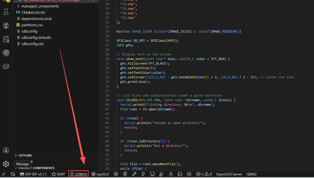

After Connecting the Device, Select the Serial Port
IDF-18

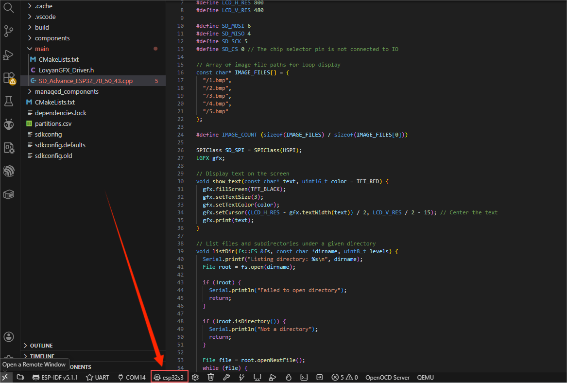

Set the Main Control Chip to: ESP32-S3
IDF-19

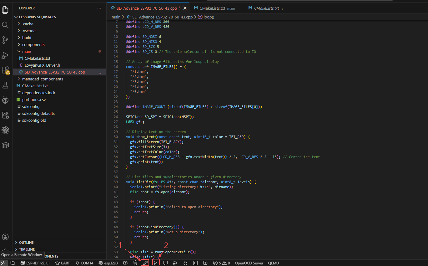

Click "Build Project". Once the compilation is complete, click "Flash Device".
IDF-20

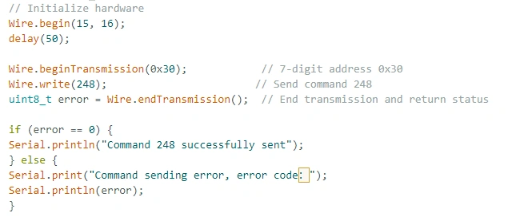

In terms of hardware, we use a microcontroller (STC8H1K28) to control the screen backlight, speaker on/off, and buzzer.
(However, there are other function interfaces that need to be written in the specific code, and you can refer to the complete code provided later.)
Explanation:
  • 0x30 is the I2C address of the microcontroller (STC8H1K28).
  • 0x5D is the I2C address of the touch IC (GT911).
  • sendI2CCommand(0) means sending command 0 to the microcontroller (address 0x30) to instruct it to set the screen brightness to maximum.
For 0 mentioned above, you can replace it with the following values:
  • 0 is the brightest backlight.
  • 0 to 245: The screen brightness will gradually increase to the minimum value
  • 245 represents turning off the screen light
Additional notes:
You can also control the following functions by sending other instructions to the microcontroller:
  • It means sending the 248 command to the microcontroller (0x30) to instruct the speaker to turn on.
  • It means sending the 249 command to the microcontroller (0x30) to instruct the speaker to turn off.
  • You can also send command 246 to control the buzzer to turn on, and send command 247 to control the buzzer to turn off.
By writing the instruction 0x10 to the address 0x30 of the microcontroller, it is used to control the microcontroller.
