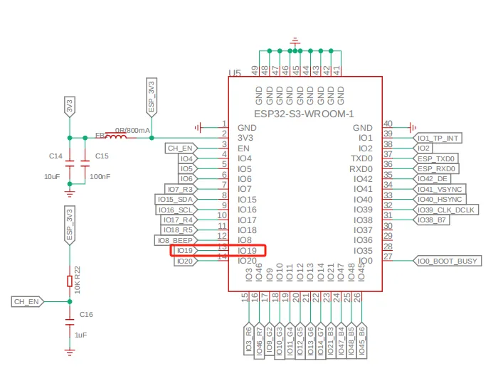

Connect the light bulb at the UART1 interface
46
Observing the schematic diagram of this size, it is known that the pin for UART1 to control the light bulb to turn on and off is 19
47
48
A large-sized screen requires setting 19 pins as the output mode.
(Due to the fact that pin 19 in the circuit of large-sized products controls both the wireless module and the UART1 interface, it is necessary to switch the mode to 0 1)

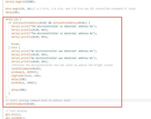

  Serial.begin(115200);
  pinMode(19, OUTPUT);
  Wire.begin(15, 16);
  delay(50);
while (1) {
    if (i2cScanForAddress(0x30) && i2cScanForAddress(0x5D)) {
      Serial.print("The microcontroller is detected: address 0x");
      Serial.println(0x30, HEX);
      Serial.println(0x5D, HEX);
      break;
    } else {
      Serial.print("No microcontroller was detected: address 0x");
      //Prevent the microcontroller did not start to adjust the bright screen
      sendI2CCommand(0x19);
      pinMode(1, OUTPUT);
      digitalWrite(1, LOW);
      //ioex.output(2, TCA9534::Level::L);
      //ioex.output(2, TCA9534::Level::H);
      delay(120);
      pinMode(1, INPUT);
      delay(100);
  //Start sending command 0x10 to address 0x30
  sendI2CCommand(0x10);

In terms of hardware, we use a microcontroller (STC8H1K28) to control the screen backlight and the mute function of the speaker.
advance-1.2-new
(However, there are other function interfaces that need to be written in the specific code, and you can refer to the complete code provided later.)
Explanation:
  • 0x30 is the I2C address of the microcontroller (STC8H1K28).
  • 0x5D is the I2C address of the touch IC (GT911).
  • sendI2CCommand(0x10) means sending the 0x10 command to the microcontroller (0x30) to instruct the microcontroller to set the screen brightness to maximum.
