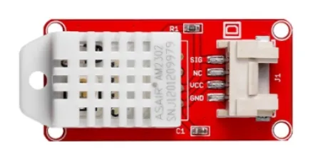

ESP32 Terminal RGB Crowtail-AM2302 Crowtail-LED
CrowPanel-ESP32-Content-T-RGB1 AM2302 CROWTAIL-LED

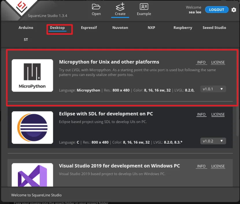

  1. Open the SquareLine Studio and create a project. Select "Desktop"->"Micropython for Unix and other platform".

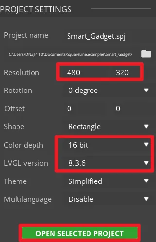

  2. Set the name of the project, set the screen resolution to 480*320, set the color depth to 16bit, and keep other default settings. After setting, click CREATE to create the project.
    SLS-UI-2
    • 16-bit color depth: can represent 65,536 colors through RGB 5:6:5 sub-pixel representation, that is, each RGB channel occupies 5 bits and 1 bit (a total of 16 bits) to represent colors.

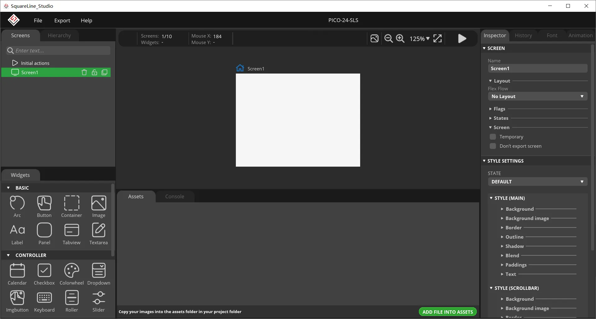

  3. After creation, enter the following interface with a blank background.
    SLS-UI-3

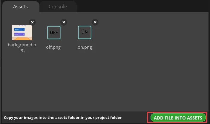

  4. In the "Assets" area, click "ADD FILE TO ASSETS" to add custom images or icons.
    Please click download to download the custom images used in this tutorial.
    SLS-UI-4
    Note:
    Images only support PNG format. The pixels of the image need to be smaller than the pixel size of the screen used in your project. The size of each image should not exceed 100k, preferably within 30k, to provide a smooth display effect.

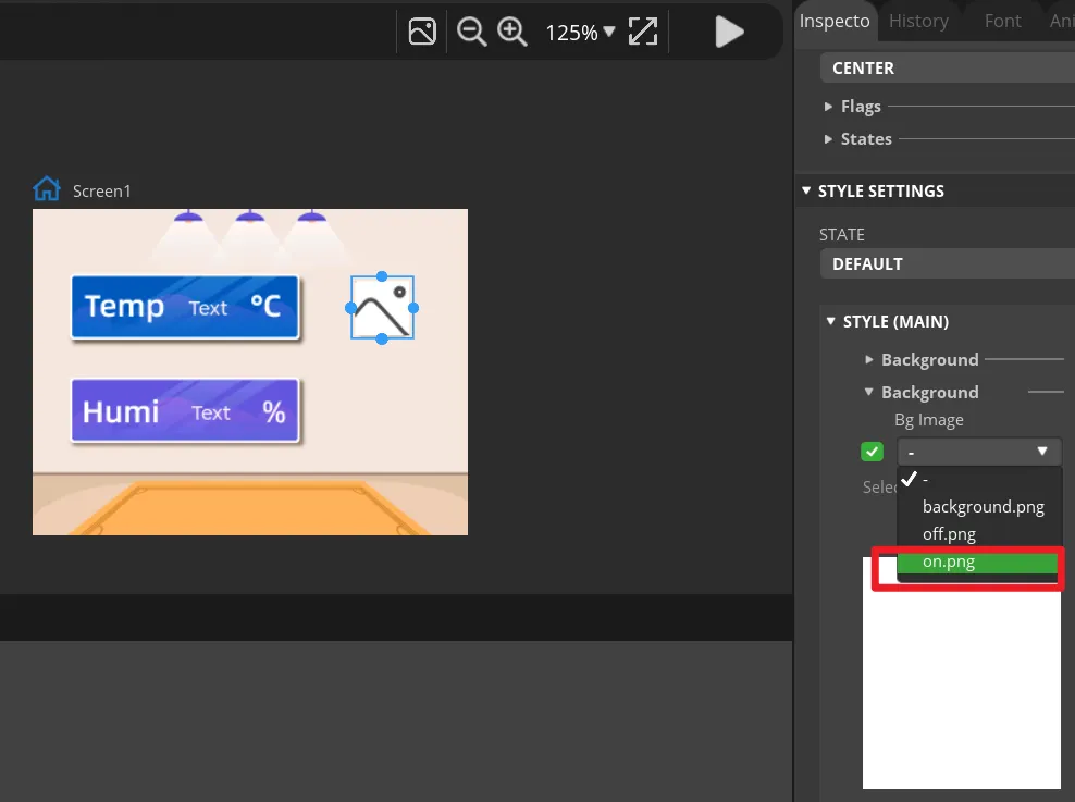

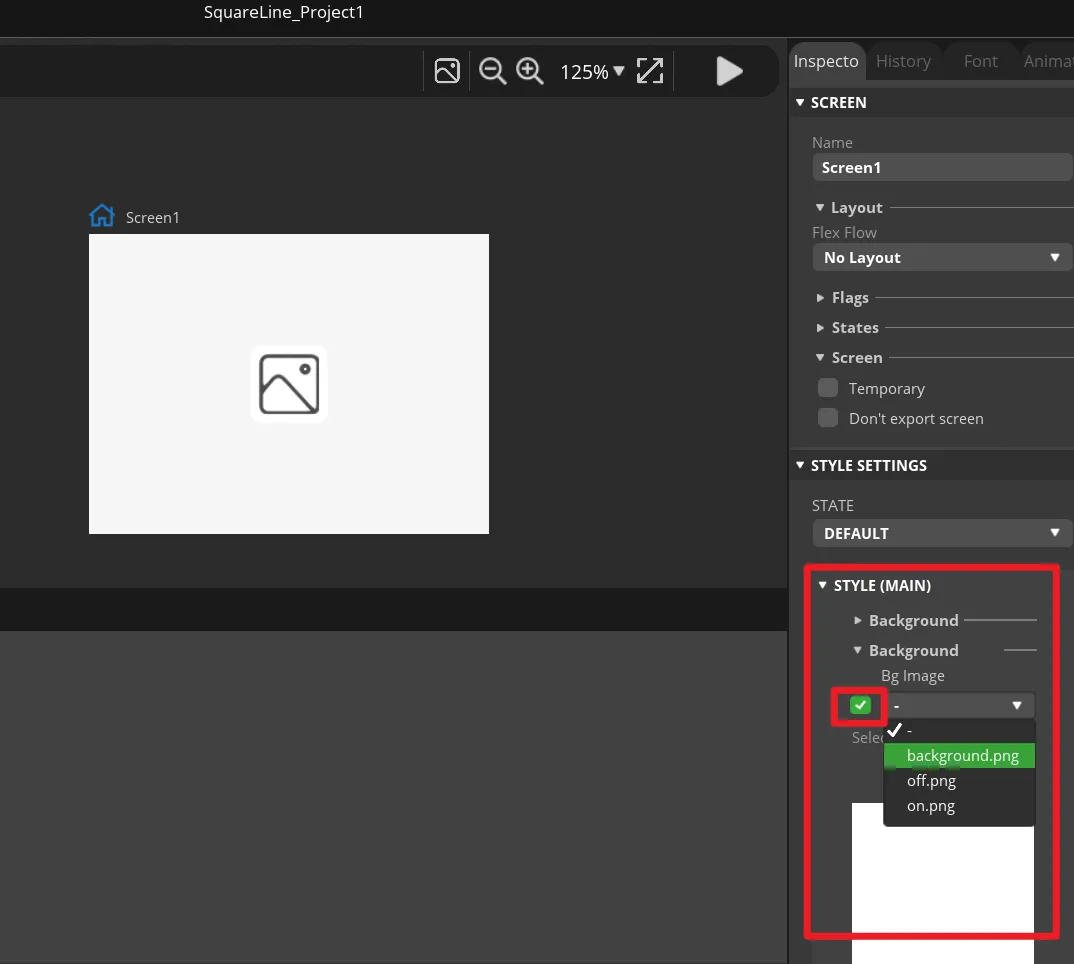

  5. Add background.
    Find "Inspector"->"STYLE SETTING", click to expand "STYLE(MAIN)", then click the 2nd "Background". Check the "Bg Image" and select the background image.

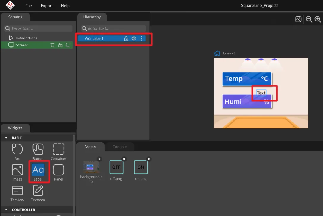

  6. Add Label widget to display temperature and humidity.
    Click "Label" in the "Widgets" area, and "Label1" will be added to the current Screen.
    SLS-UI-7

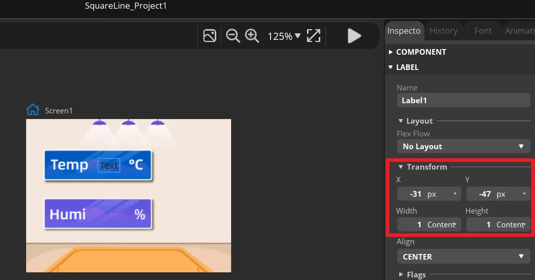

    The position and size of the label can be adjusted by dragging the mouse. You can also directly enter numbers in the Inspector→LABEL→Transform to adjust.
    SLS-UI-8

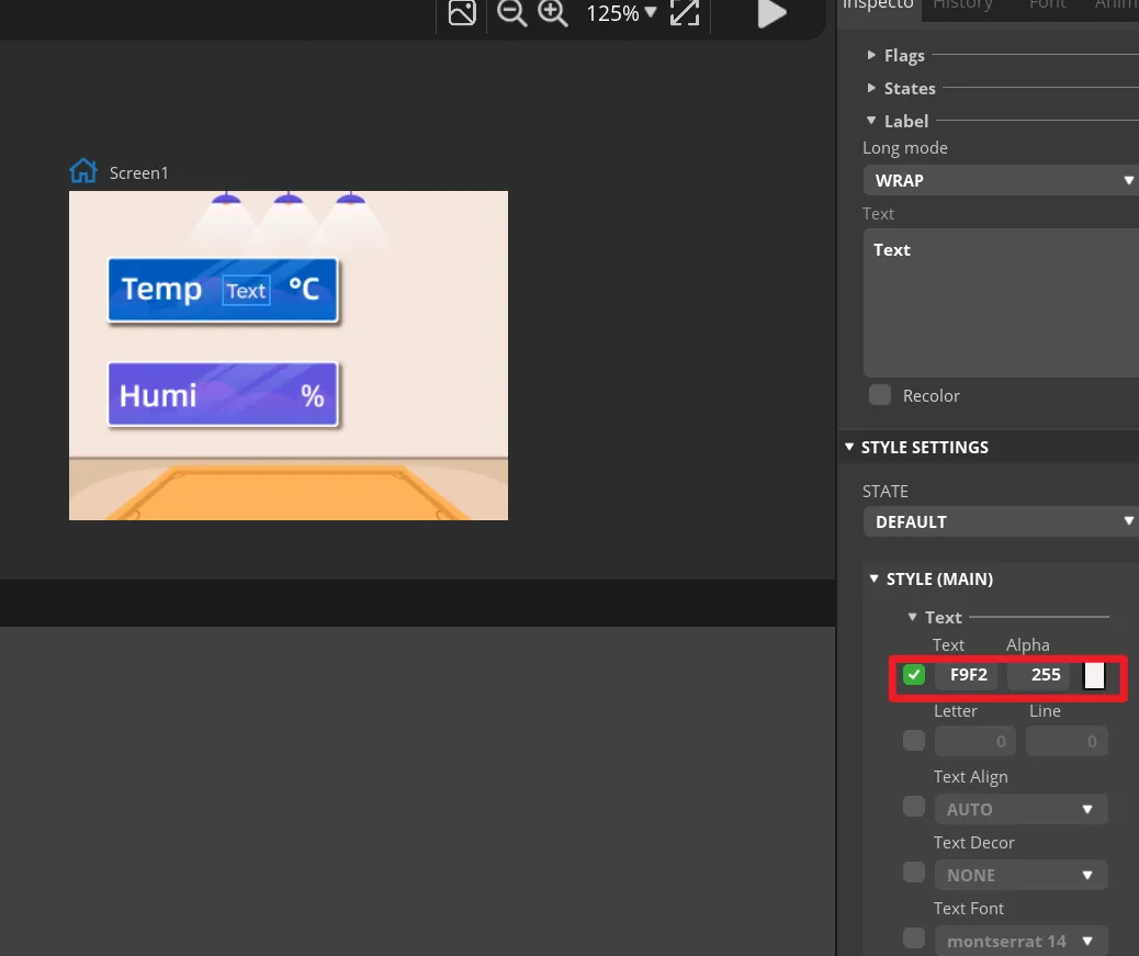

    You can set the font color and other attributes in STYLE SETTING→STYLE(MAIN).
    SLS-UI-9

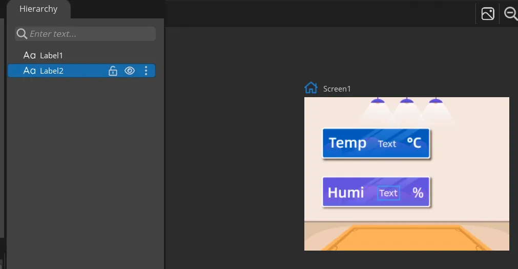

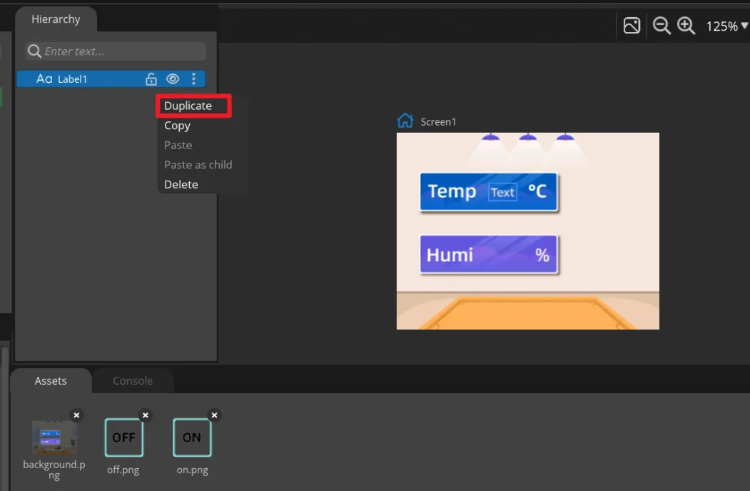

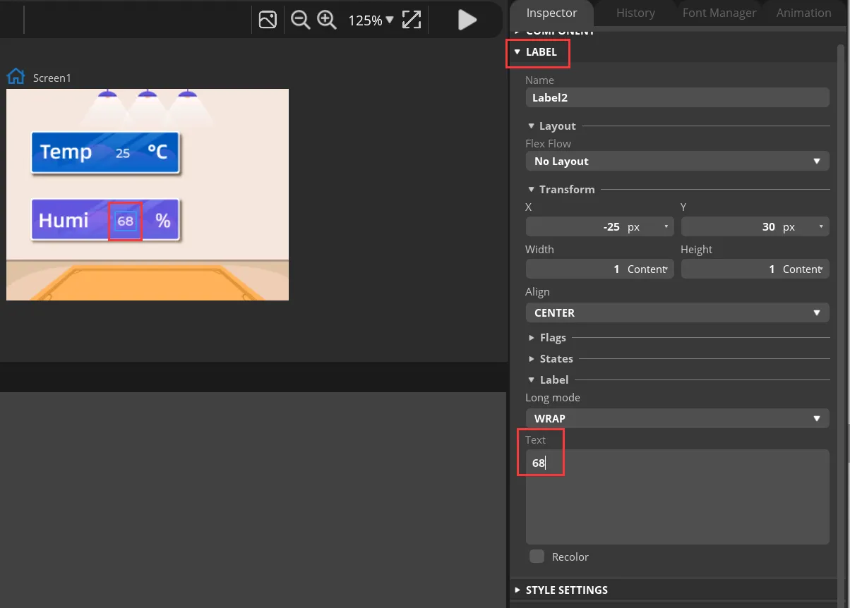

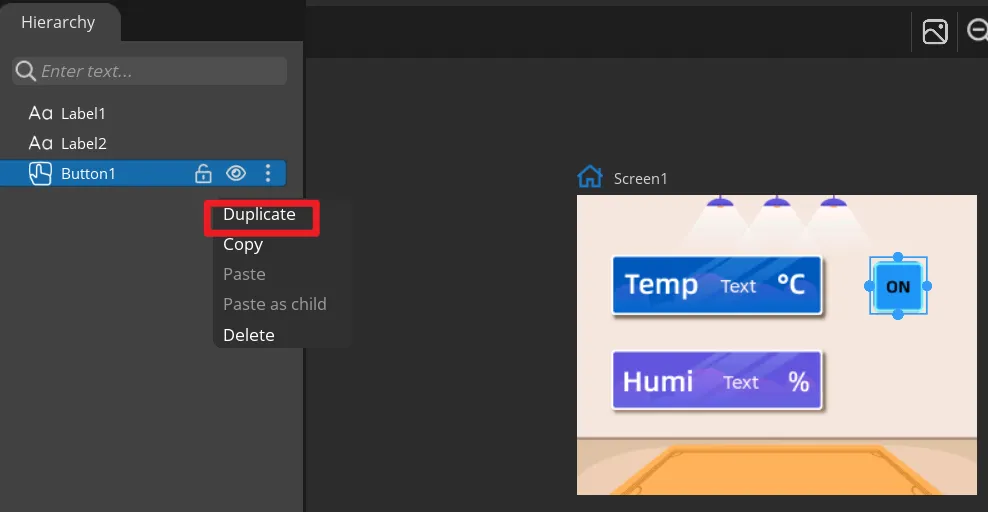

    Add a Label2 to display the humidity value in the same way. You can also directly right-click the Label1 to duplicate it.
    SLS-UI-10
    Then set different positions for the Label2.
    SLS-UI-11
    Modify the text content to display a default value.
    SLS-UI-18

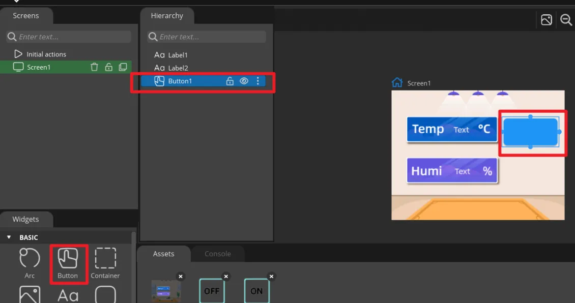

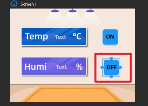

  7. Add Button widget to control the LED.
    Click "Button" in the "Widgets" area, and "Button1" will be added to the current Screen.
    SLS-UI-12

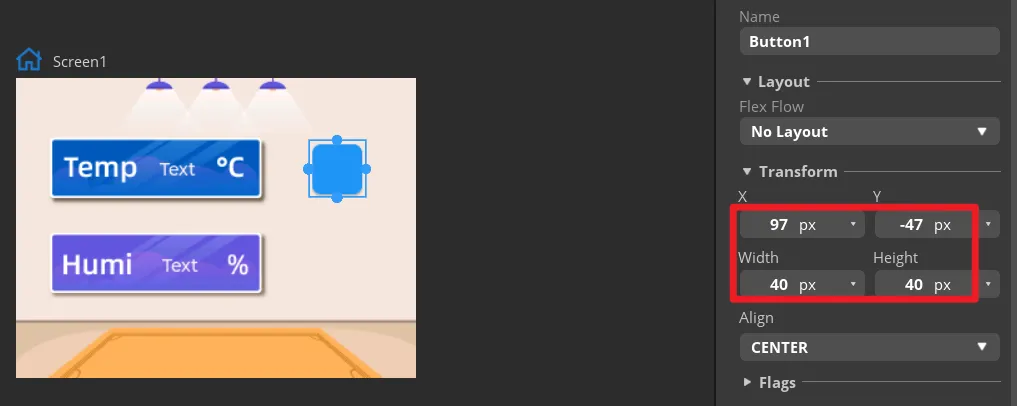

    The position and size of the label can be adjusted by dragging the mouse. You can also directly enter numbers in the Inspector→BUTTON→Transform to adjust.
    SLS-UI-13

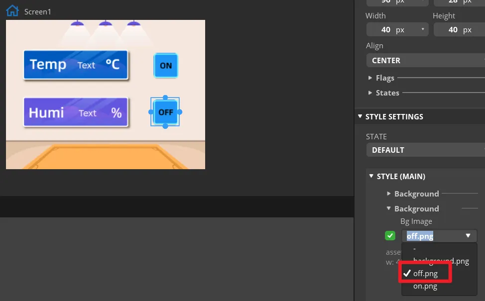

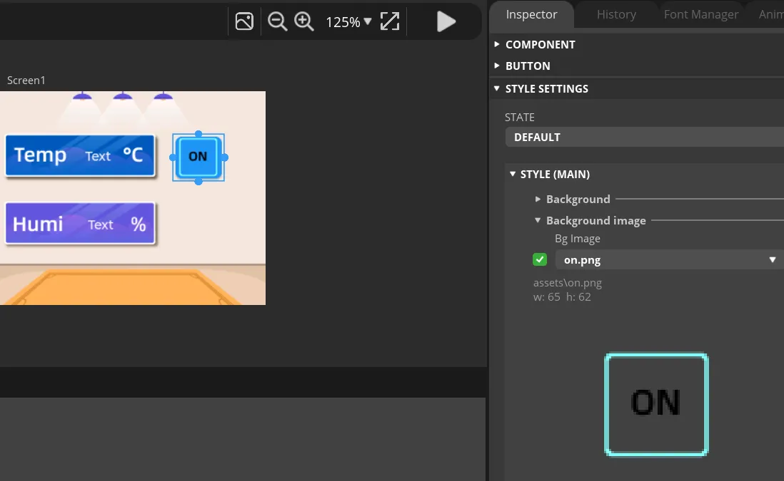

    Add an identification symbol to the button. The button in this tutorial controls the LED switch, so you only need to mark the button "on" and "off". You can add LABEL widgets or add a background images to the button. This tutorial will demonstrate how to add a background image to a button.
    Click the Button1, then find Inspector->STYLE SETTINGS ->STYLE(MAIN) ->Background, and select the image.
    SLS-UI-14
    SLS-UI-15
    In the same way, duplicate a Button widget. And drag it to the corresponding position to modify different background image.
    SLS-UI-16
    SLS-UI-17

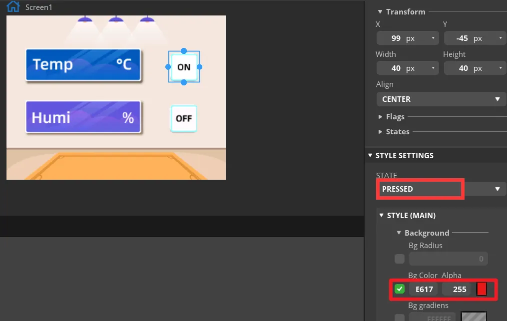

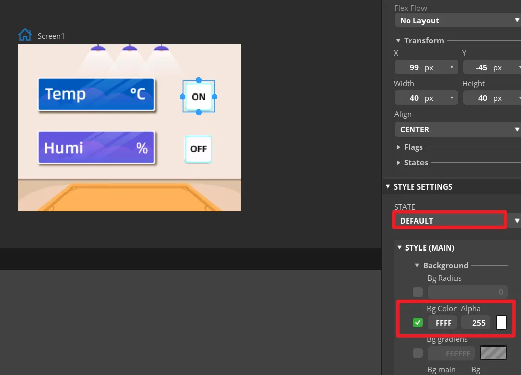

    Set the status of the button to identify different states.
    In "Inspector"->"STYLE SETTINGS"->"STATE", set display white background color by DEFAULT and red when on the PRESSED state.
    SLS-UI-19
    SLS-UI-20
    Make the same settings for the "OFF" button.

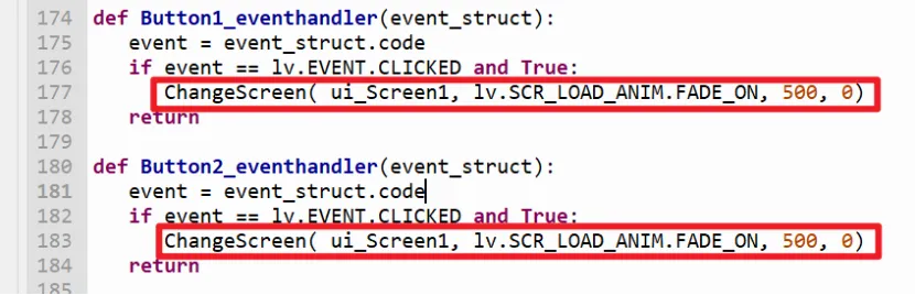

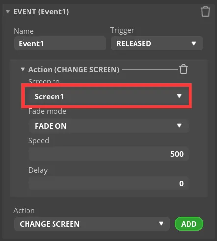

  8. Add events to buttons.
    Note: Because the button controls the on and off of the LED, we can add any event here to generate the code framework for the button event when exporting the UI file. We will modify the code of the button event to control the LED latter.
    Select the button and click "ADD EVENT".
    SLS-UI-21

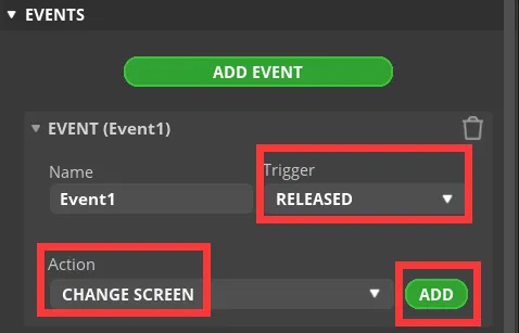

    Select "released" as the trigger condition, select a trigger event in "Action". It will be modified in the generated program to achieve the LED control function.
    SLS-UI-22
    Complete the event. Here I choose to change the screen, and the screen to be switched is Screen1.
    SLS-UI-23
    Add event to Button2 (OFF) in the same way.
    SLS-UI-24

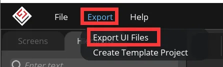

  9. Export UI files.

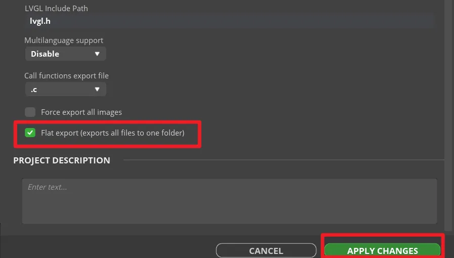

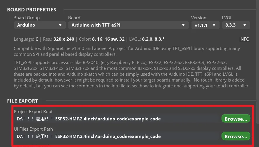

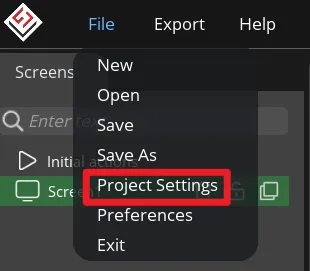

    Click "File" -> "Project Settings" and make settings for the exported file.
    SLS-UI-25
    Set the export path of the file (set the path according to your own file).
    SLS-UI-26
    Fill in lvgl.h in LVGL Include Path. Check "Flat export(exports all files to one folder )".
    Then click "APPLY CHANGES".
    Tips: After selecting the flat export, the output files will be in the same folder, so that the output code does not need to modify the path in the program. If not, the output files will be classified and placed in different folders. The compiler may not be able to recognize different paths, which will cause some trouble. In this case, the user needs to modify it manually, so it is recommended to select all files to be output to the same folder.
    SLS-UI-27
    Export UI files. The exported files will be in the path we set earlier.
    SLS-UI-28
    SLS-UI-29

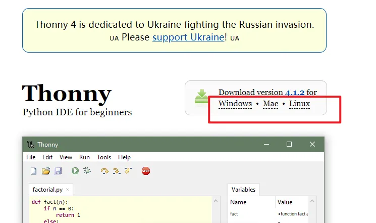

Download Thonny IDE

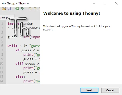

  1. Go to the website https://thonny.org/ and download the corresponding software version (here we take the Windows version as an example)
    Thonny-1
  2. Double-click the downloaded exe file to install the software.
    Thonny-2

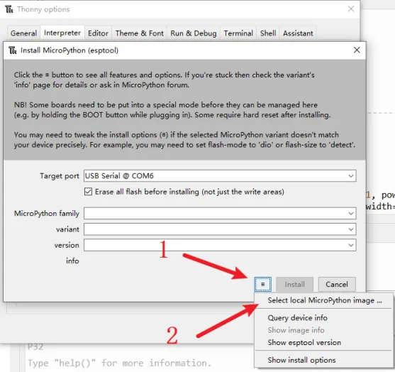

Upload firmware

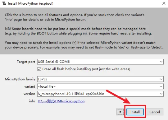

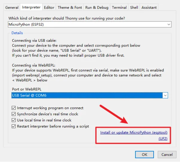

  1. Connect the CrowPanel ESP32 HMI with your computer.

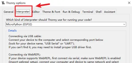

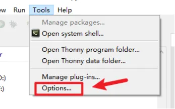

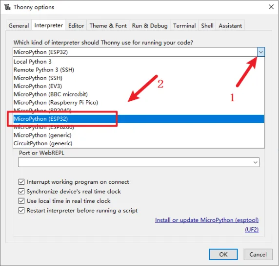

  2. Open Thonny IDE and click "Tools"->"Options"->"Interpreter".
  3. Select "MicroPython(ESP32)" for interpreter.

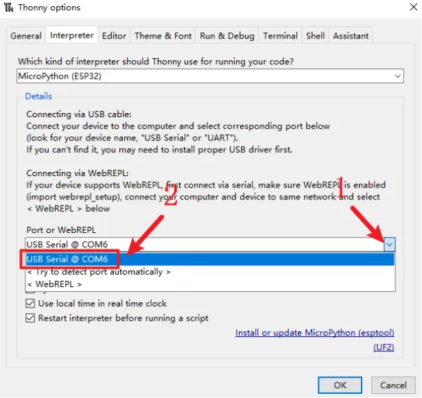

  4. Select the corresponding serial port(or Try to detect port automatically).

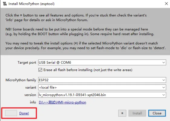

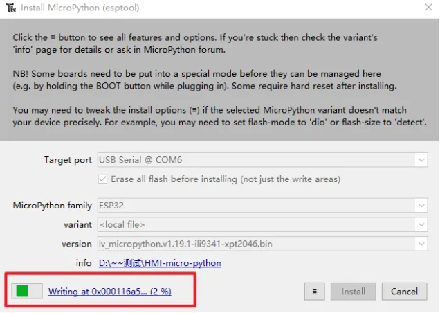

  5. Click "Install or update MicroPython (esptool)"
  6. Click the icon with 3 lines, and click "select local MicroPython image...".Select the "lv_micropython.v1.19.1-ili9341-xpt2046.bin" and install.
    Please click download to download the bin file.
  7. Waiting for downloading...

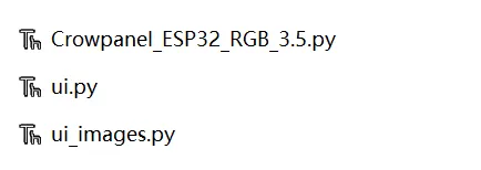

Please click download to download the code file and libraries.
code
  • The main code is "CrowPanel_ESP32_RGB_3.5.py"
  • The "ui_image.py" is the libraries
  • The ui.by is exported from Squaline Studio and needs to be copied into the main program

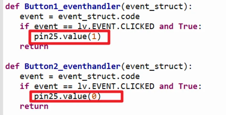

This part copies the code of ui.py generated by Squareline Studio. We need to modify the part that control the button.
From
button-1
to
button-2

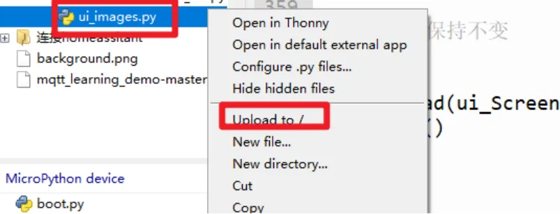

Upload the libraries
ui_image
  1. In the upper left corner of the thonny, enter the path where DHT20.py is located, right-click DHR20.py, and click Upload to/
  2. Waiting for uploading
  3. The DHT20.py will be added to the MicroPython device column.

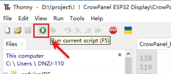

Click the "run" icon to run the main code.

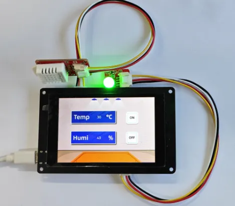

Successfully uploaded.

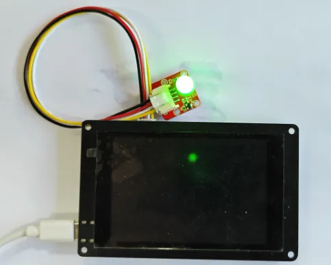

Example 1 LED Blinking
  • Plug the LED module to GPIO-D Port
  • Upload the led.py to board
  • The LED will blink

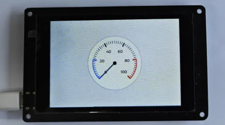

Example 3 Show the dial plate on the screen
  • Upload the biaopan-3.5.py to the board
    biaopan

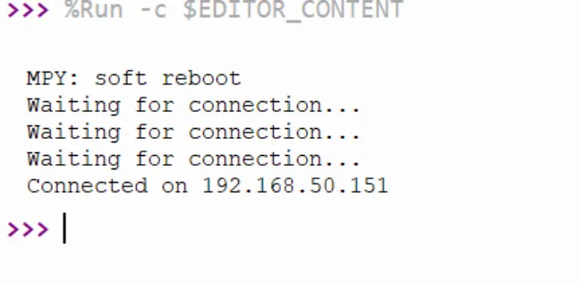

    Connect-wifi

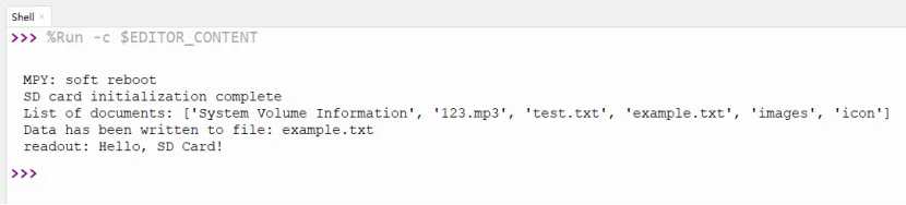

Example 5 Initialize SD card
  • Insert the SD card to the card slot
  • Upload the sd.py
    SDCARD

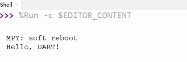

Example 7 Serial port initialization
  • Upload uart.py
    uart
