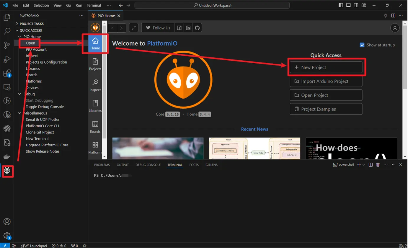

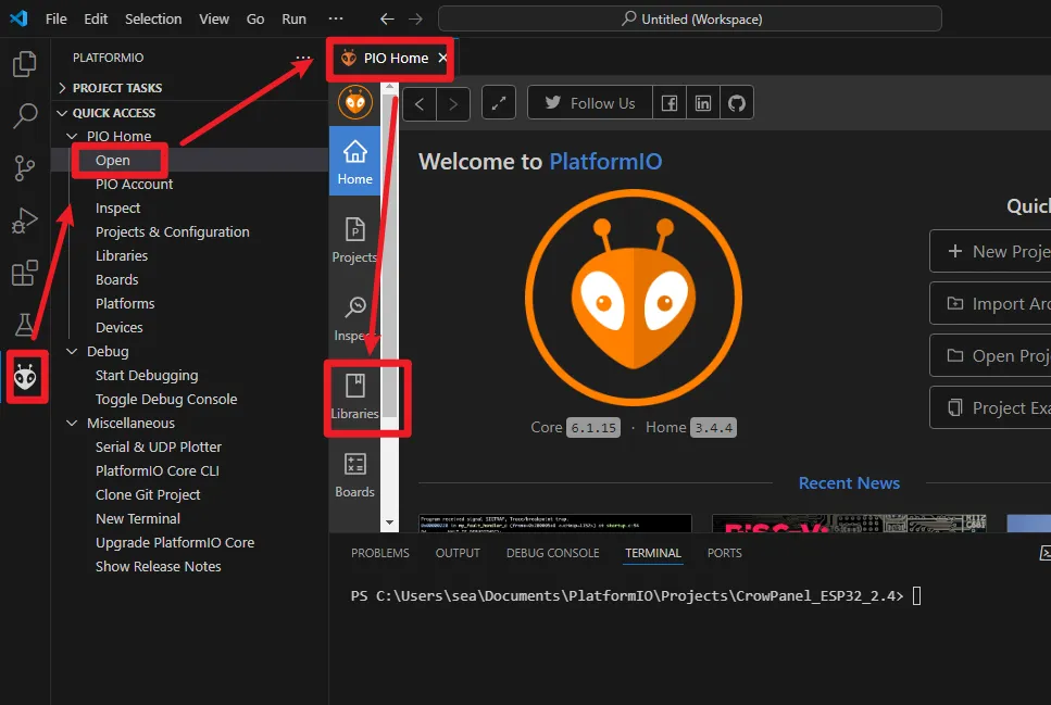

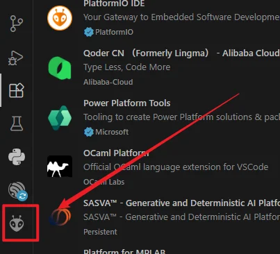

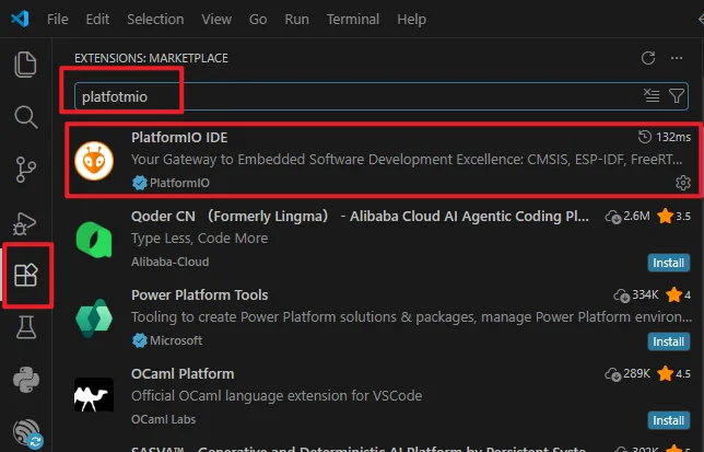

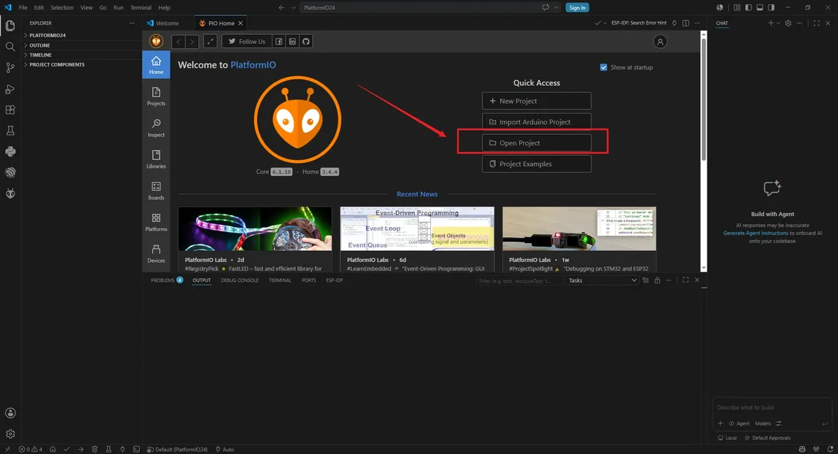

Open VS Code, search for and install PlatformIO IDE in Extensions.
image-20260723154828563
After installation, restart VS Code; the PlatformIO icon should appear on the left side. Click the icon to enter the PIO Home main page.
image-20260723154858011
In the PIO Home Quick Access area, click Open Project.
image-20260723154324820

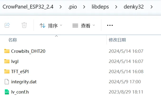

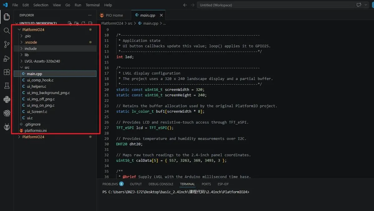

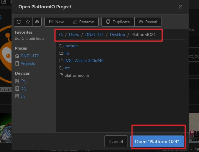

Browse to the path in the popup, select the project root folder PlatformIO24 (the folder must contain platformio.ini), and click the blue button Open "PlatformIO24".
Open PlatformIO Project

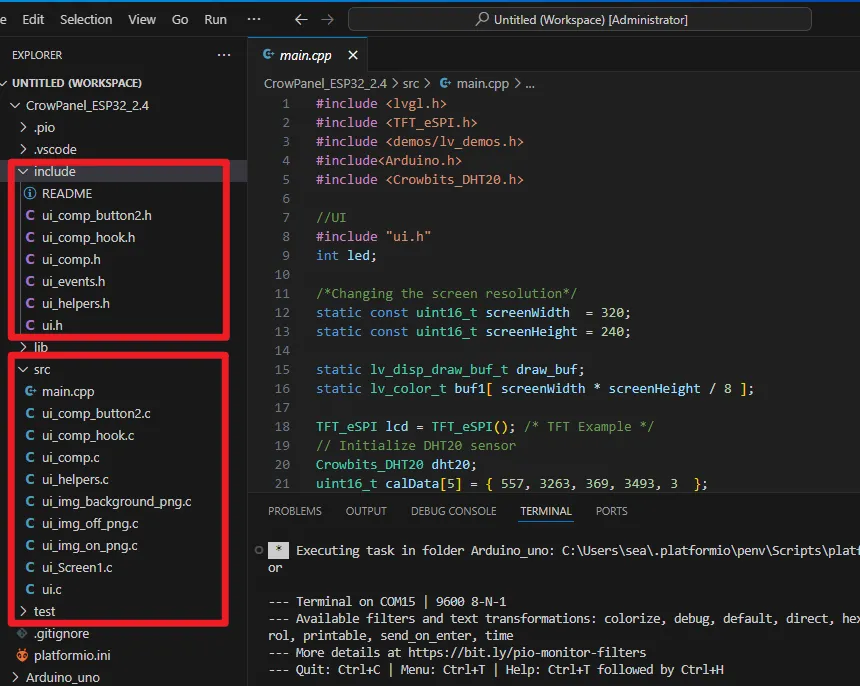

The project loads in the left-side Explorer

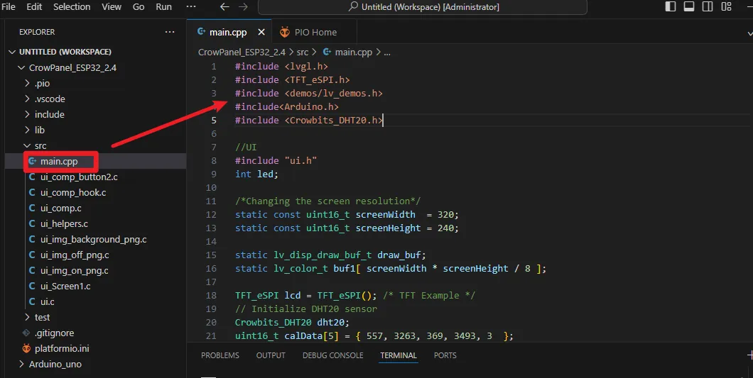

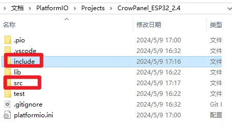

src/main.cpp: main program code
platformio.ini: platform configuration file
include and lib are dependency library directories

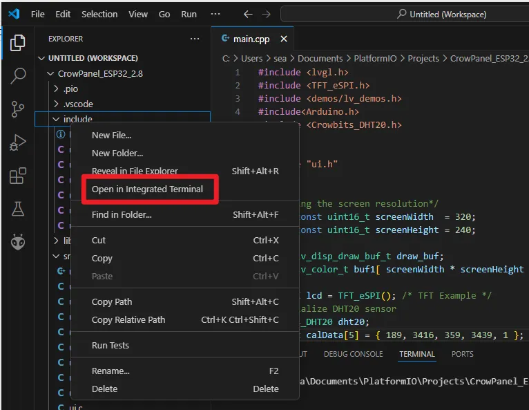

Open main.cpp to review the project code.

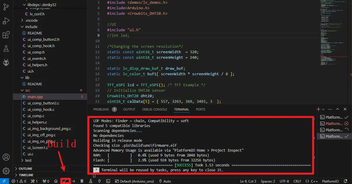

Platform flashing project software process steps

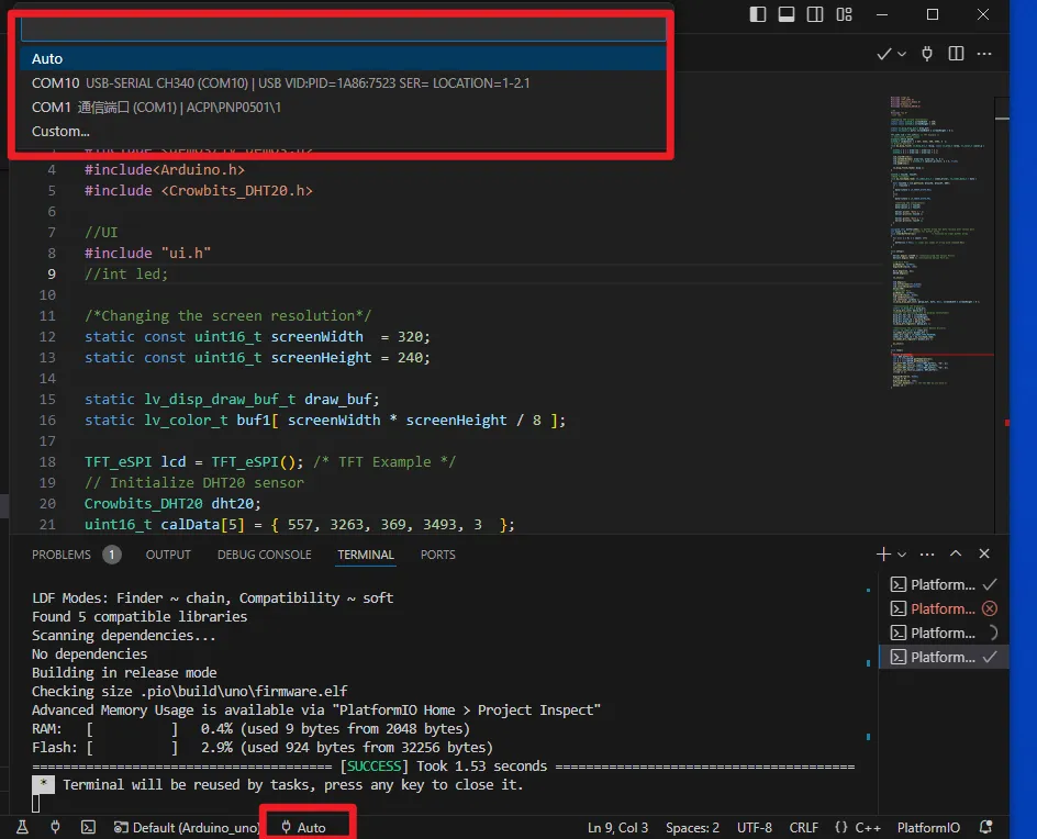

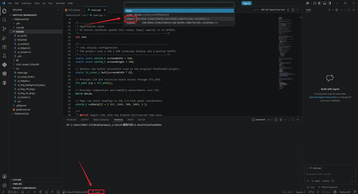

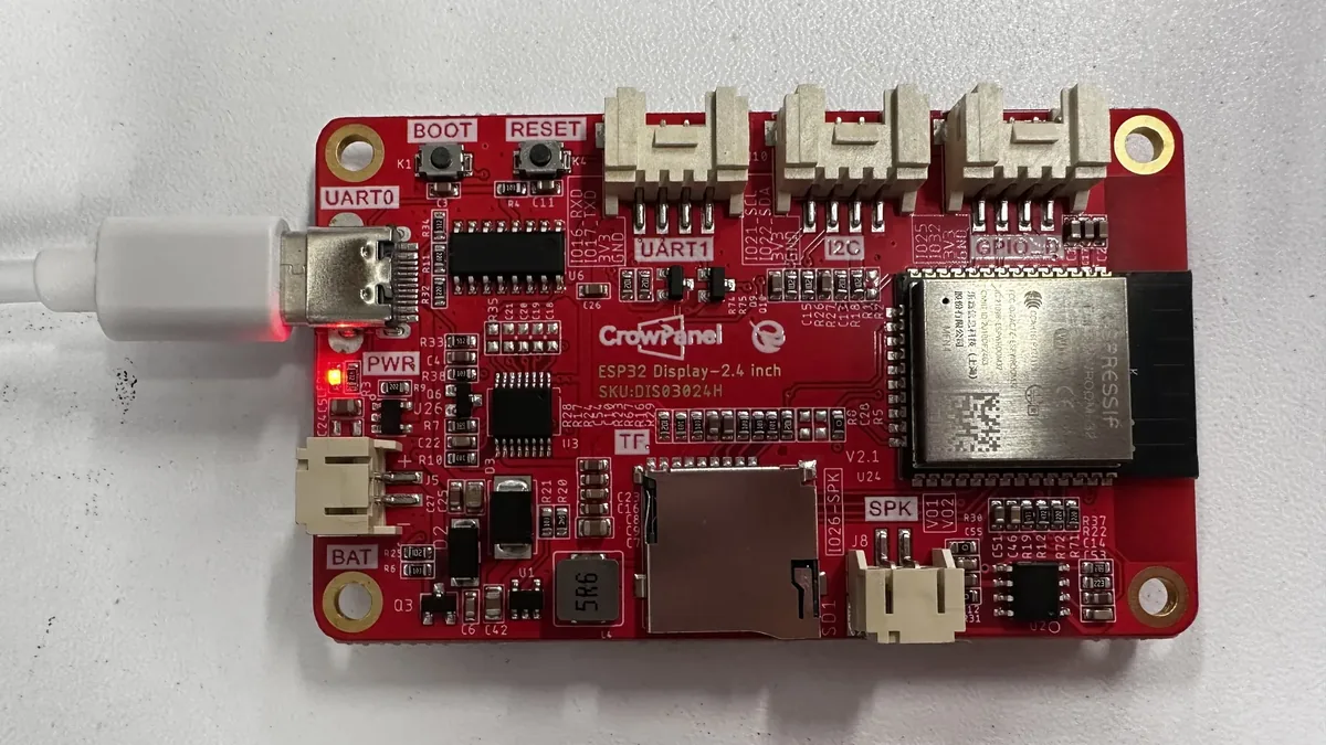

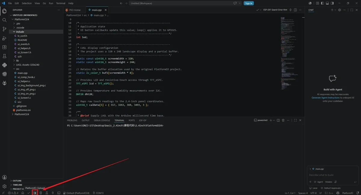

Connect the CrowPanel development board to a USB port on your computer using a USB data cable.
08
Select the device serial port: Check the bottom status bar of VS Code; the dropdown box on the left defaults to Auto. Click the dropdown and select the serial port corresponding to the development board (example: COM13). Platform flashing project software process steps (1)

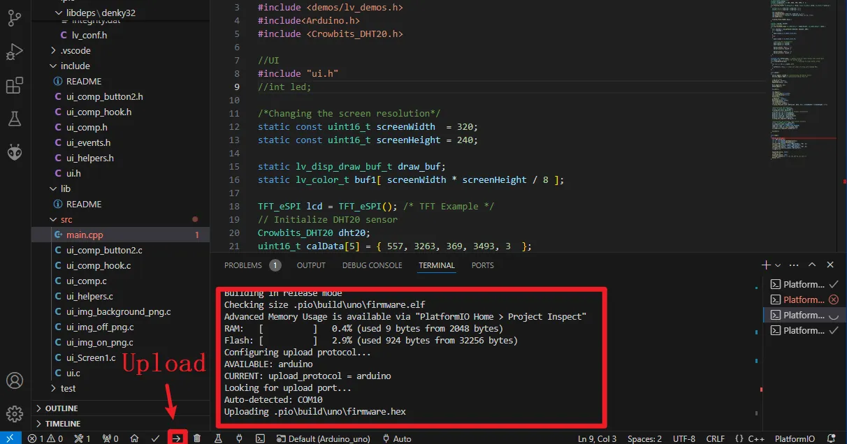

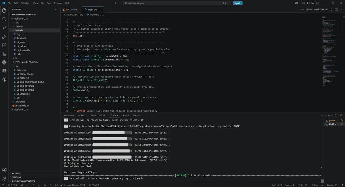

Click the right-arrow icon (PlatformIO: Upload) on the bottom status bar of VS Code. Wait for the compile and upload process to run automatically.
Platform flashing project software process steps (2)
Platform flashing project software process steps (3)

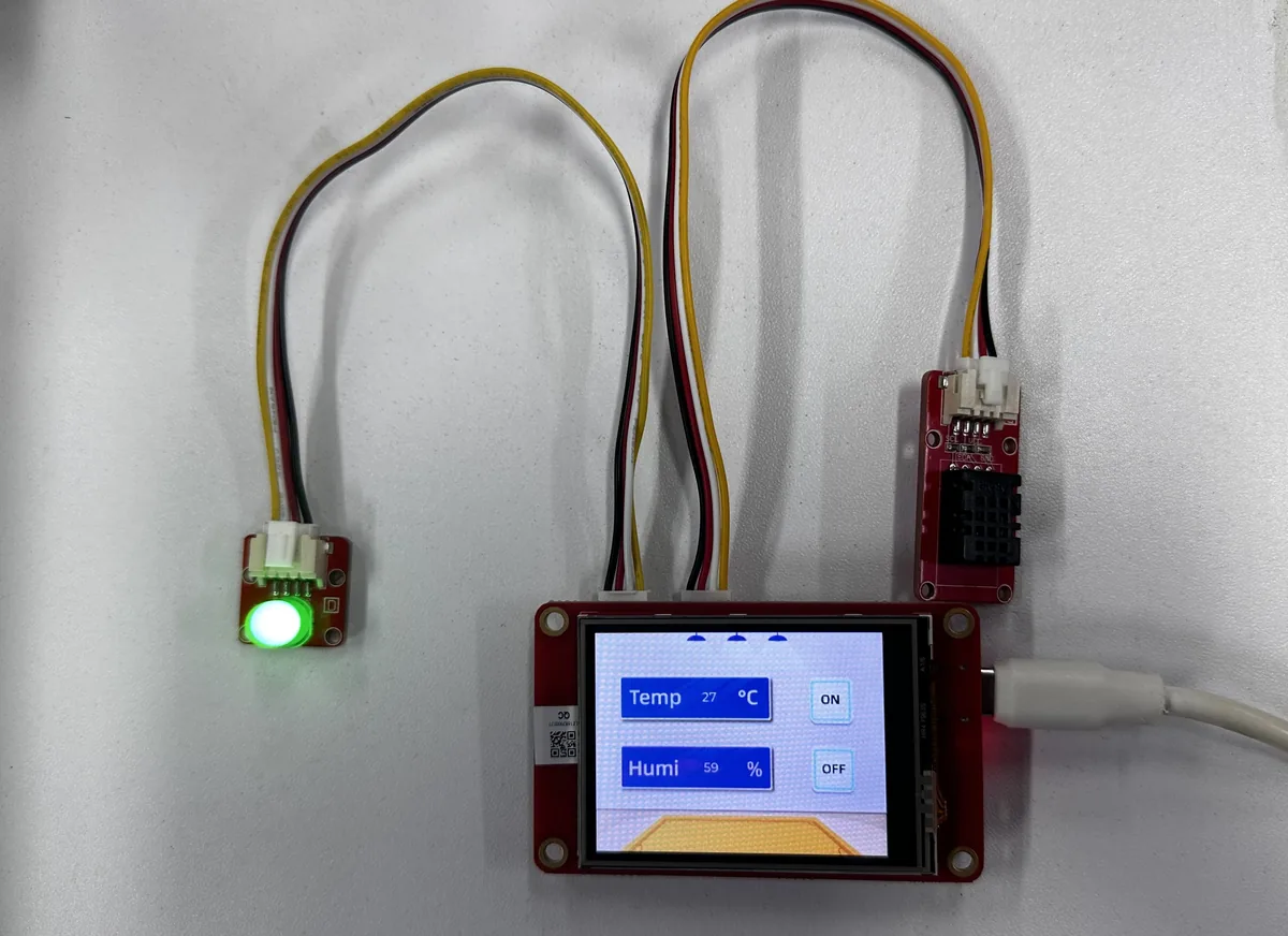

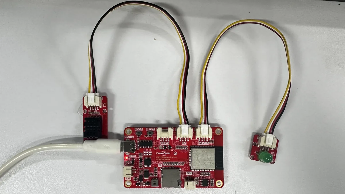

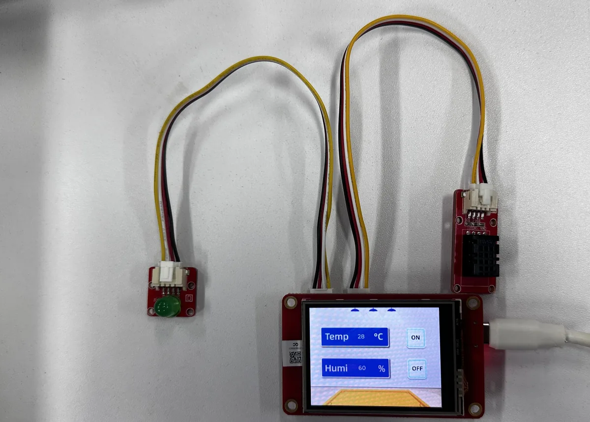

Wire the connections as shown in the diagram:
  • DHT20 temperature and humidity sensor → board I2C interface
  • LED module → board GPIO_D interface
IMG_7931
It displays real-time temperature and humidity (data collected by the DHT20) and provides ON/OFF buttons to turn the external LED on/off.
Platform flashing project software process steps (4)
ON → LED on
OFF → LED off

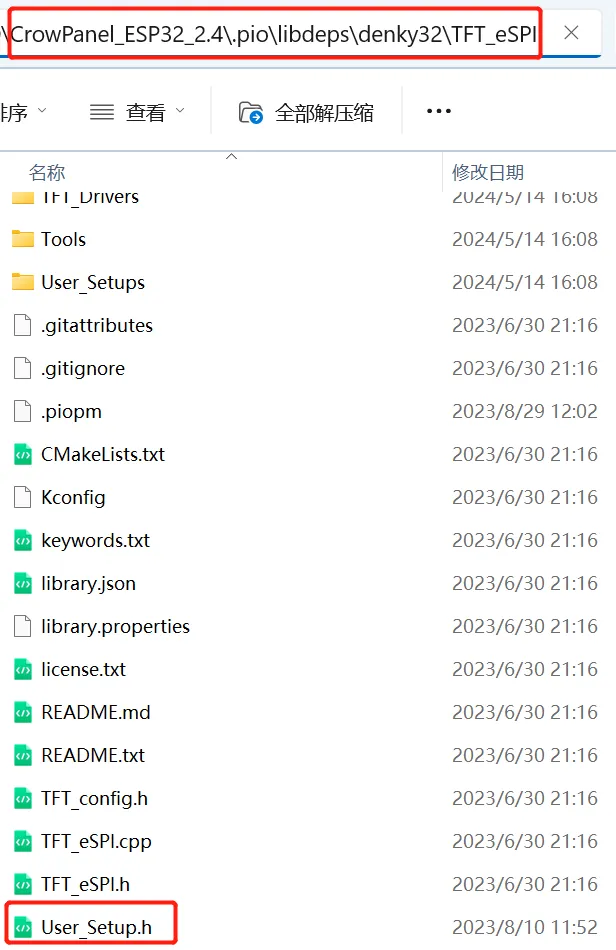

    -DLV_CONF_INCLUDE_SIMPLE
    -Iinclude

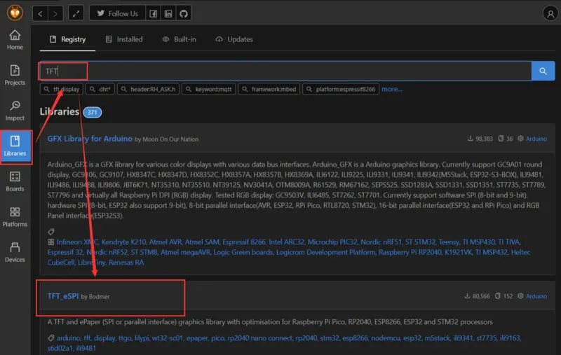

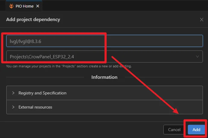

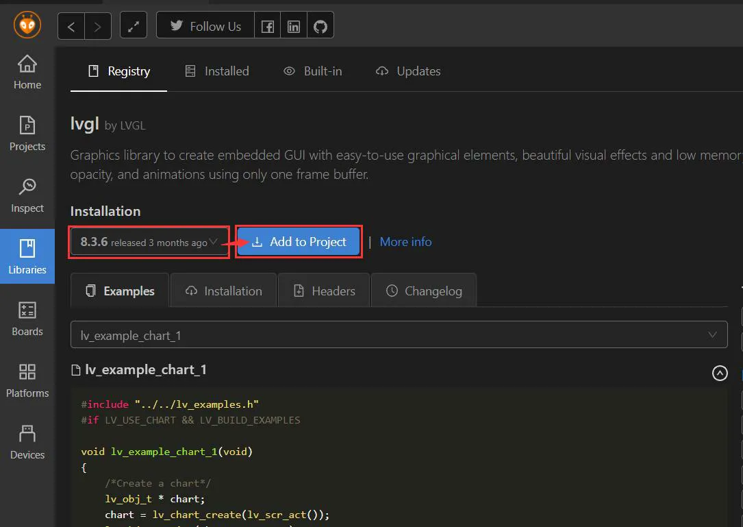

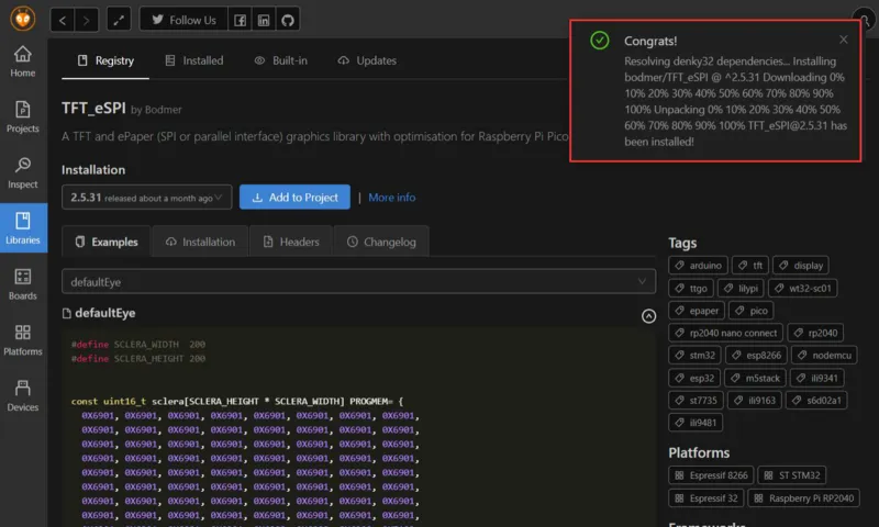

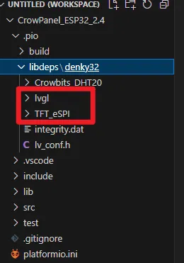

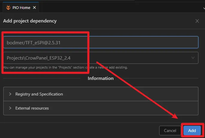

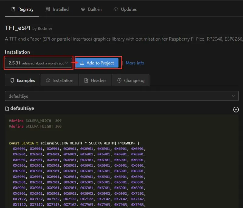

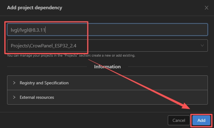

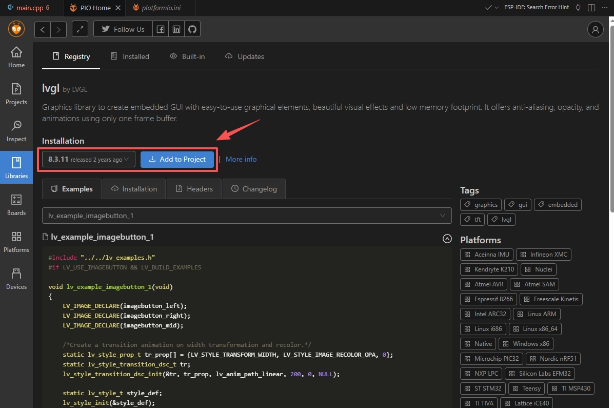

; Lock the library versions verified by this course project.
lib_deps =
    lvgl/lvgl@9.1.0
    bodmer/TFT_eSPI@2.5.31

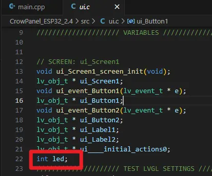

6.7 Button Events and GPIO25
// SquareLine calls this handler when the ON button receives an event.
void ui_event_Button1(lv_event_t * e)
    lv_event_code_t event_code = lv_event_get_code(e);
    if(event_code == LV_EVENT_CLICKED) {
        led = 1;
// The OFF button uses a separate handler and clears the shared state.
void ui_event_Button2(lv_event_t * e)
        led = 0;
// loop() converts the UI state into the physical GPIO25 output.
if(led == 1) {
    digitalWrite(25, HIGH);
if(led == 0) {
    digitalWrite(25, LOW);
When it runs and what it does: The two event checks are located in ui_Screen1.c; after LVGL detects a button click, it modifies the global variable led; loop() then reads this variable and sets GPIO25. This way, UI events only record the target state, while hardware control is centralized in the main loop.
Key parameters: LV_EVENT_CLICKED represents a single, complete click event; led = 1 corresponds to a high level on GPIO25, and led = 0 corresponds to a low level. setup() has already configured this pin as an output via pinMode(25, OUTPUT), and the LED is turned off by default at startup.
Expected behavior and effect of modifications: After clicking ON, the LED lights up; after clicking OFF, the LED turns off. Swapping the two assignments will cause the button functions to be reversed; removing the LV_EVENT_CLICKED check may allow other events to modify the state as well; after removing the digitalWrite() call from the main loop, the on-screen button still provides visual feedback, but the LED no longer changes.
Key points for troubleshooting: When a button has no visual response, check the touch callback; when a button responds but the LED does not change, check extern int led, the event function, the GPIO25 wiring, and the LED's active level. You can also observe the led value output over the serial port to distinguish between UI event issues and hardware output issues.

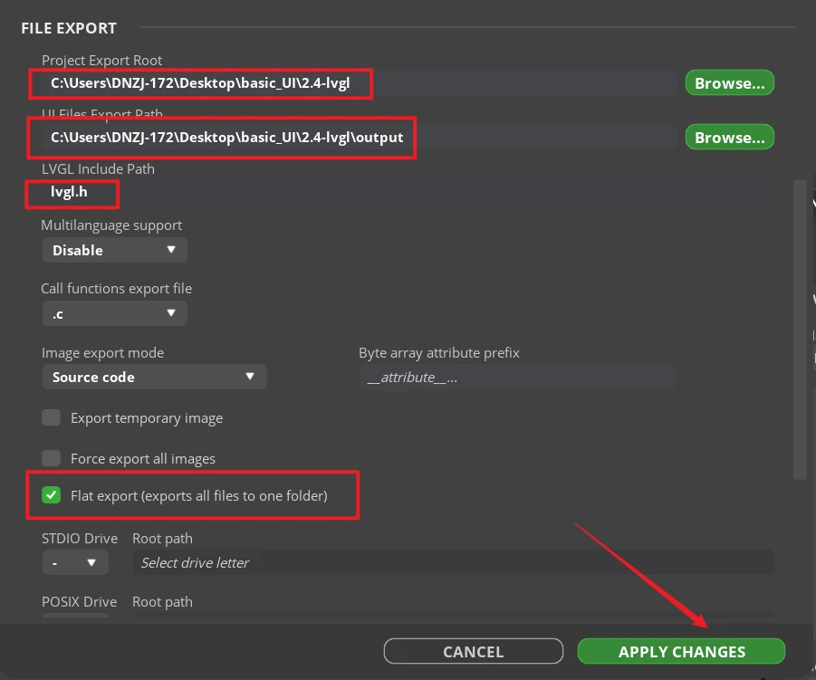

7. UI Asset Creation and Integration
This section uses SquareLine Studio 1.6.1 to demonstrate the UI creation process again. The course already provides the exported UI files; beginners can first read this section to understand the workflow, then directly use the files in the project to complete the build. When creating a new project, you must select LVGL 9.1.0;
How to download SquareLine Studio:https://www.elecrow.com/wiki/Create_LVGL_UI_with_SquareLine_Studio.html

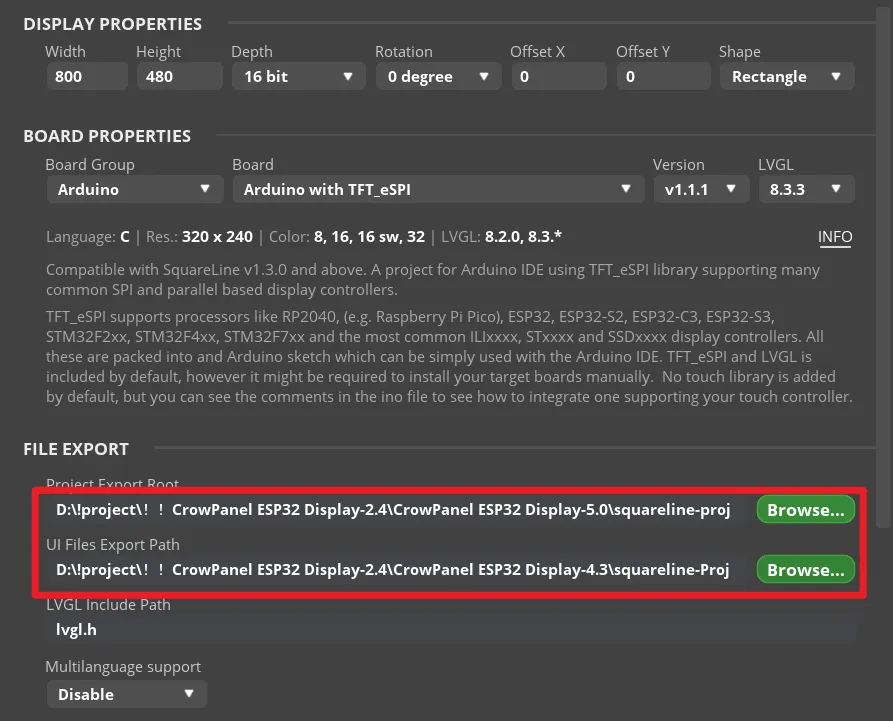

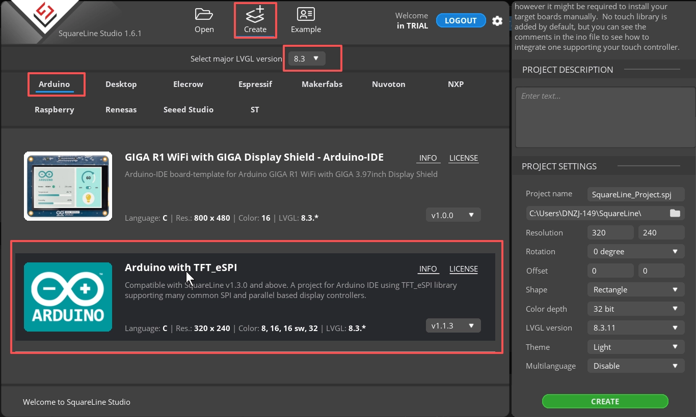

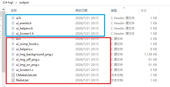

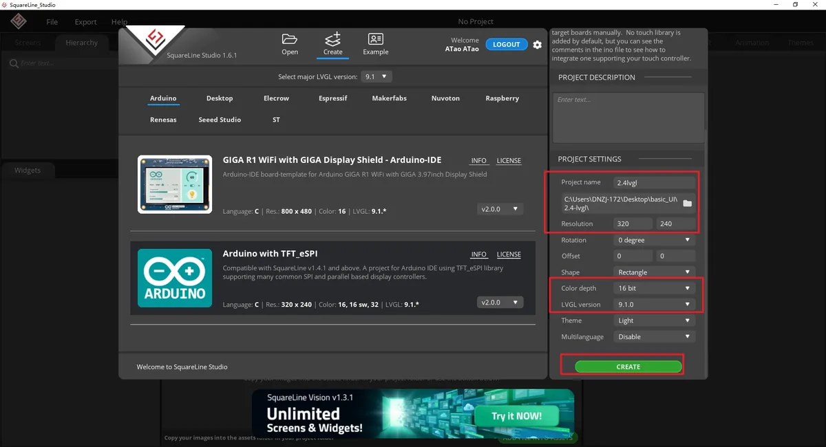

Launch SquareLine Studio 1.6.1, click Create, and select the Arduino with TFT_eSPI template for the Arduino platform. This template generates the UI file framework suitable for Arduino and TFT_eSPI projects.
Note: When the Arduino framework is selected, SquareLine Studio displays only the Arduino with TFT_eSPI option. It generates template code suitable for TFT_eSPI, but SquareLine Studio also supports other graphics libraries; when switching to other hardware, you need to modify the display code according to the actual library.
19

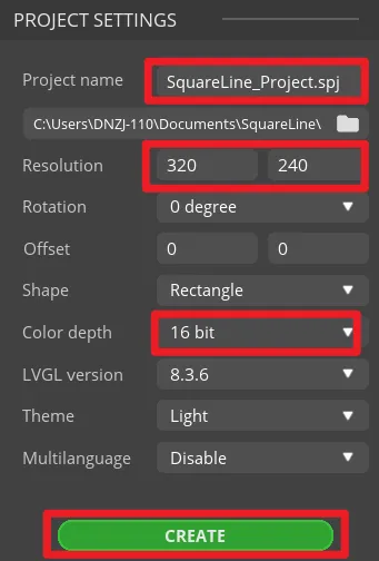

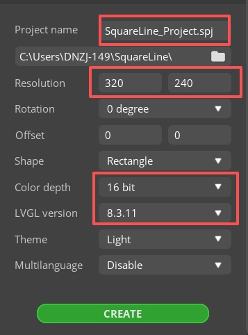

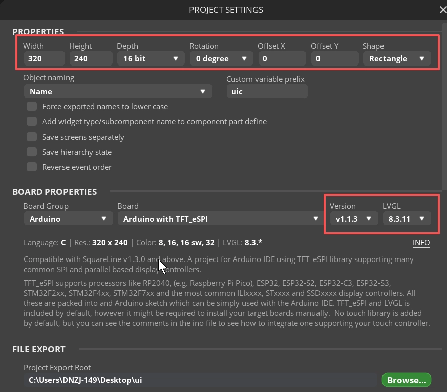

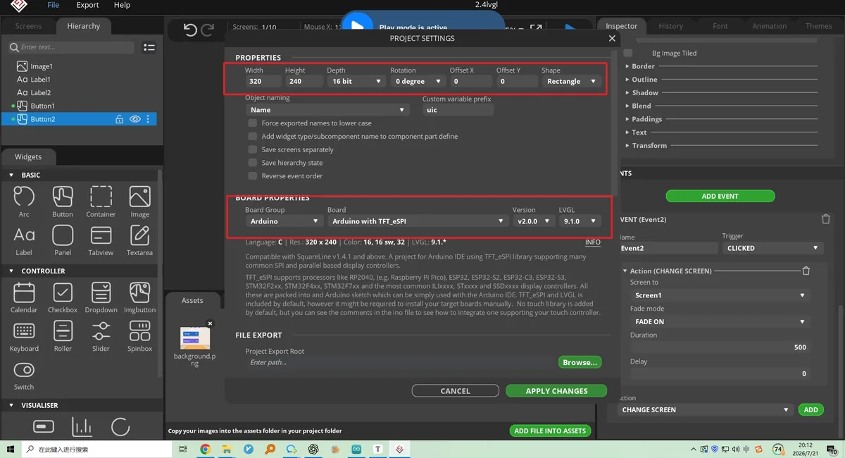

Enter the project name, set the LVGL version to 9.1.0, the resolution to width 320 and height 240, and the color depth to 16 bit, then click CREATE. After creation, the canvas should be in landscape orientation at 320×240.
20
  • Note: A 16 bit color depth can represent 65,536 colors using an RGB 5:6:5 pixel format. Keep it consistent with the project's color configuration.
After the project opens, select Screen1 in the Screens panel on the left, and confirm that the central canvas is blank and the Inspector on the right shows the Screen properties. All subsequent widgets are added to this page.
21

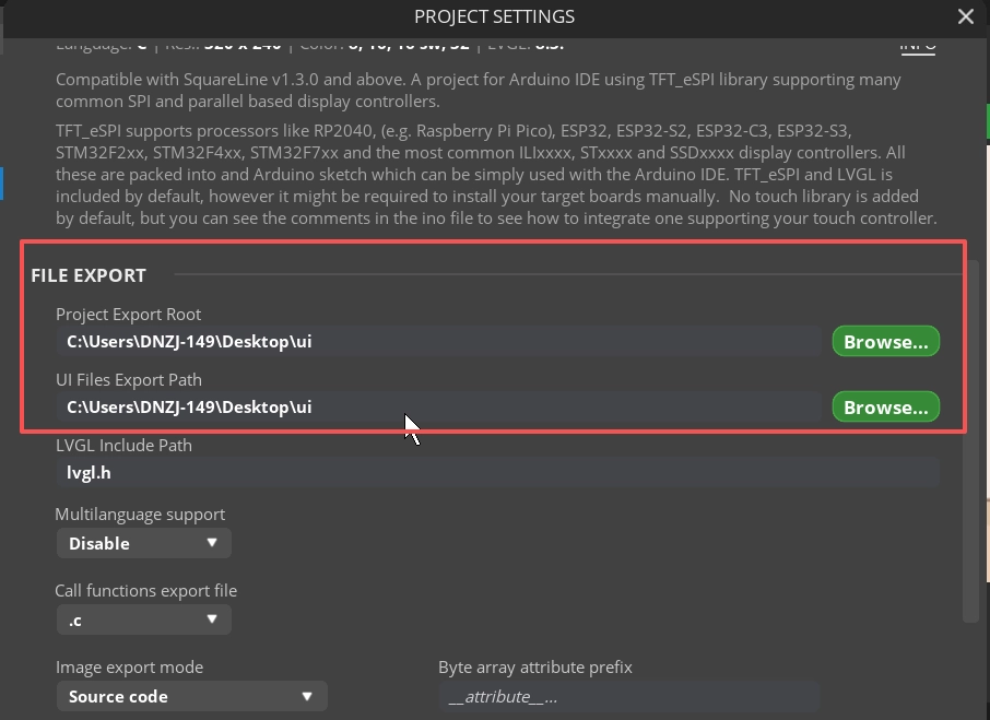

In the Assets area, click ADD FILE TO ASSETS and import background.png, on.png, and off.png from LVGL-Assets-320x240/ in order. After importing, you should see three thumbnails.
Material link:
CrowPanel-2.4-ESP32-HMI-320x240/example/V2.1/ESP_IDF/LVGL-Assets-320x240 at master · Elecrow-RD/CrowPanel-2.4-ESP32-HMI-320x240
22
Note: Image assets support only the PNG format; the pixel dimensions of an image should be smaller than the project's screen size; a single image should not exceed 100 KB, and preferably kept within 30 KB, to avoid affecting display smoothness.
Select Screen1, expand STYLE SETTINGS > STYLE (MAIN) > Background on the right, and enable the background image setting.
23
In Bg Image, select background. The canvas should immediately display the course background image, and the background should fully cover the 320×240 page.
24

Note: Since the buttons ultimately need to control the LED on/off, you can add any event here first, so that the exported UI file generates the button event code framework; the LED control code will be modified in a later step.
Complete this event. Here, I choose to switch screens, that is, switch to the Screen1 screen.

Open File > Project Settings, then configure the relevant settings for the exported files.
42
43

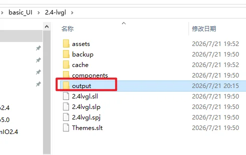

Set the export directory to an easy-to-find path using only English characters, create a new output folder, fill in and confirm that the LVGL Include Path is lvgl.h, then click "APPLY CHANGES" after confirming.
image-20260723170101760
45
Tip: After selecting Flat export, all output files are placed in the same folder, so the program does not need to modify file paths. If Flat export is not selected, files are scattered across different folders, and the compiler may not recognize them automatically, usually requiring manual path changes; therefore it is recommended to keep it checked.
Click Export > Export UI Files. After the export completes, the target directory should contain ui.c, ui.h, ui_Screen1.c, the event files, helper files, and the image array files.

Add the UI files to the PlatformIO project. We need to add the UI files from SquareLine Studio to the PlatformIO project. The .c files in the user interface should be placed in the /scr folder of the project files, while the .h files should be placed in the /include folder.
image-20260723162715905
PIO-34
PIO-35
8. Observed Behavior
After the firmware is uploaded and the board is reset, the LCD is first cleared to black, and about 300 ms later the backlight turns on and loads the 320×240 UI. The background image should be displayed in full, two white integers appear slightly left of center on the screen, and the ON and OFF icons appear on the right. When the DHT20 is connected properly, the two integers update according to the temperature and humidity readings, respectively.
ON -> LED lights up
OFF -> LED turns off
