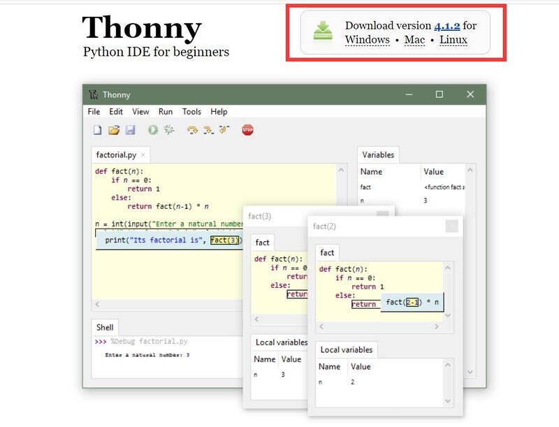

Go to https://thonny.org/ and download the corresponding software version (take the Windows version as an example).
Double-click the downloaded exe file to install the software. (Go to the next step and install directly)

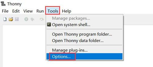

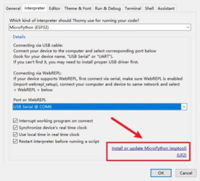

Open the Thonny software and click Tools→Options

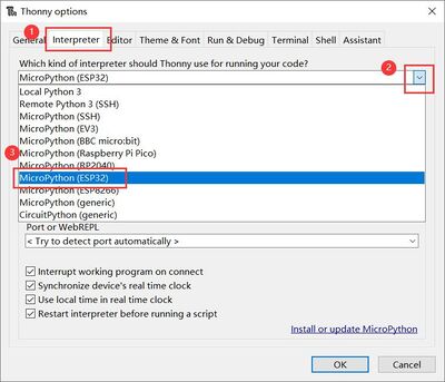

Click "Interpreter" and select "MicroPython(ESP32)"

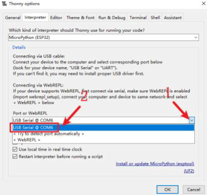

Select the serial port number (you need to press the hardware BOOT key and then connect to the computer, if no com number is displayed, check whether the serial port driver is installed)
Click "Install or update MicroPython(esptool)" to download the firmware

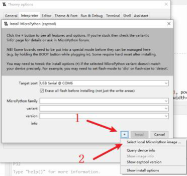

Choose to download the firmware from local and click Install (select the firmware corresponding to the screen)
Wait for successful installation

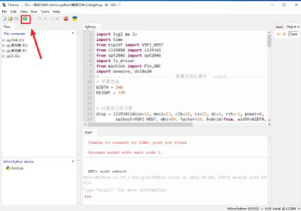

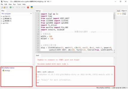

Run program¶
Click the reset button on the screen or reinsert the data cable to open the routine program.
When the light intensity exceeds 60%, the light goes out. Light is on when the light intensity is less than 60%
