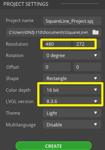

    Set the name of the project, set the screen resolution to 480*272, set the color depth to 16bit, and keep other default settings. After setting, click CREATE to create the project.
    SLS-UI-2

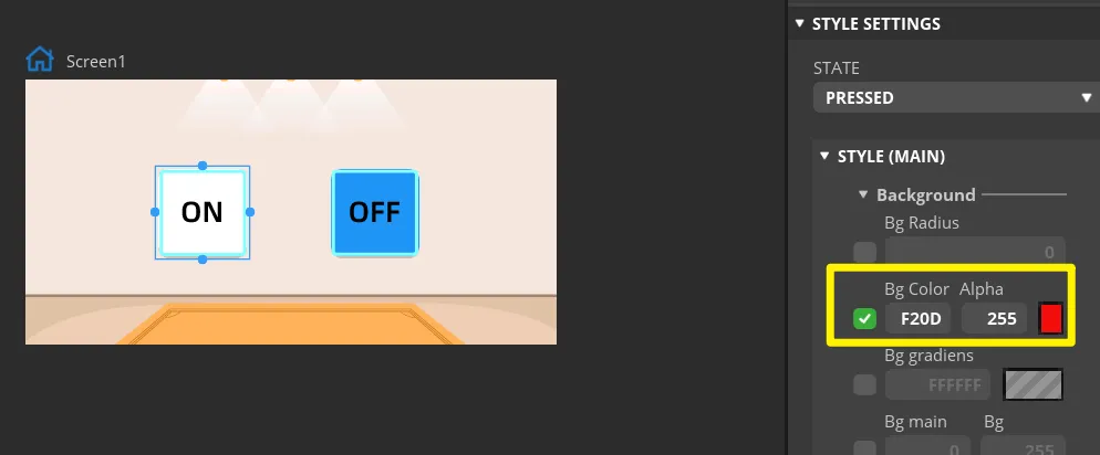

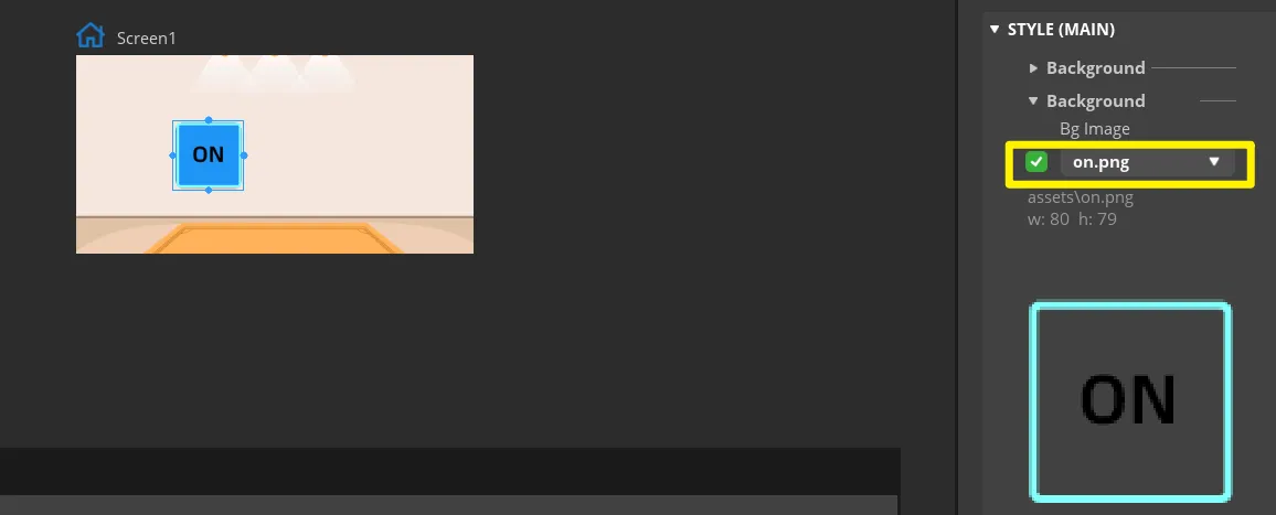

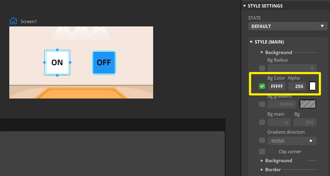

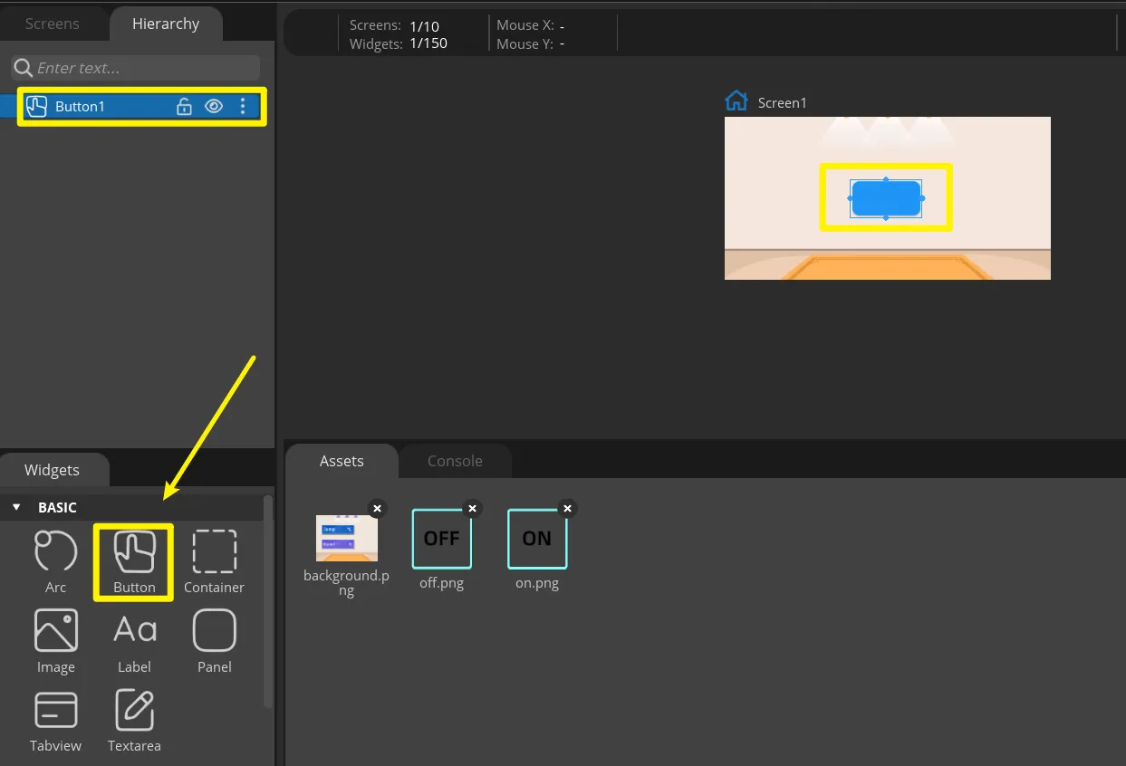

  5. Add Button widget to control the LED.
    SLS-UI-12
    SLS-UI-13
    SLS-UI-14
    SLS-UI-16
    SLS-UI-17
    SLS-UI-20
    SLS-UI-19

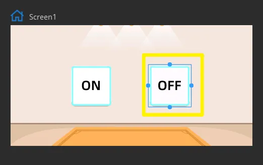

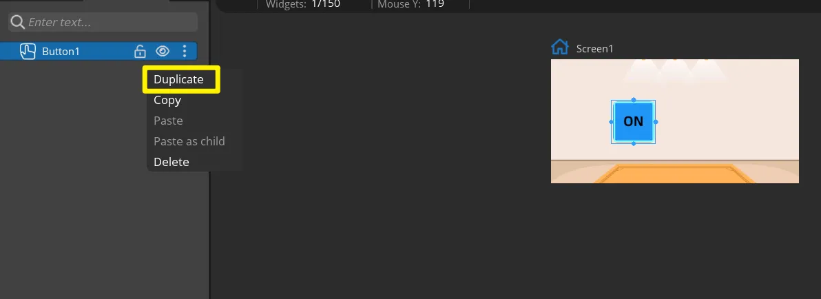

  6. Add events to buttons.
    SLS-UI-21
    SLS-UI-22
    SLS-UI-23
    SLS-UI-24

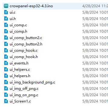

  7. Export UI files.
    SLS-UI-25
    SLS-UI-26
    Then click "APPLY CHANGES".
    SLS-UI-27
    SLS-UI-28
    SLS-UI-29
    Please click download to download the main program(and the expert UI is included).
    SLS-UI-30

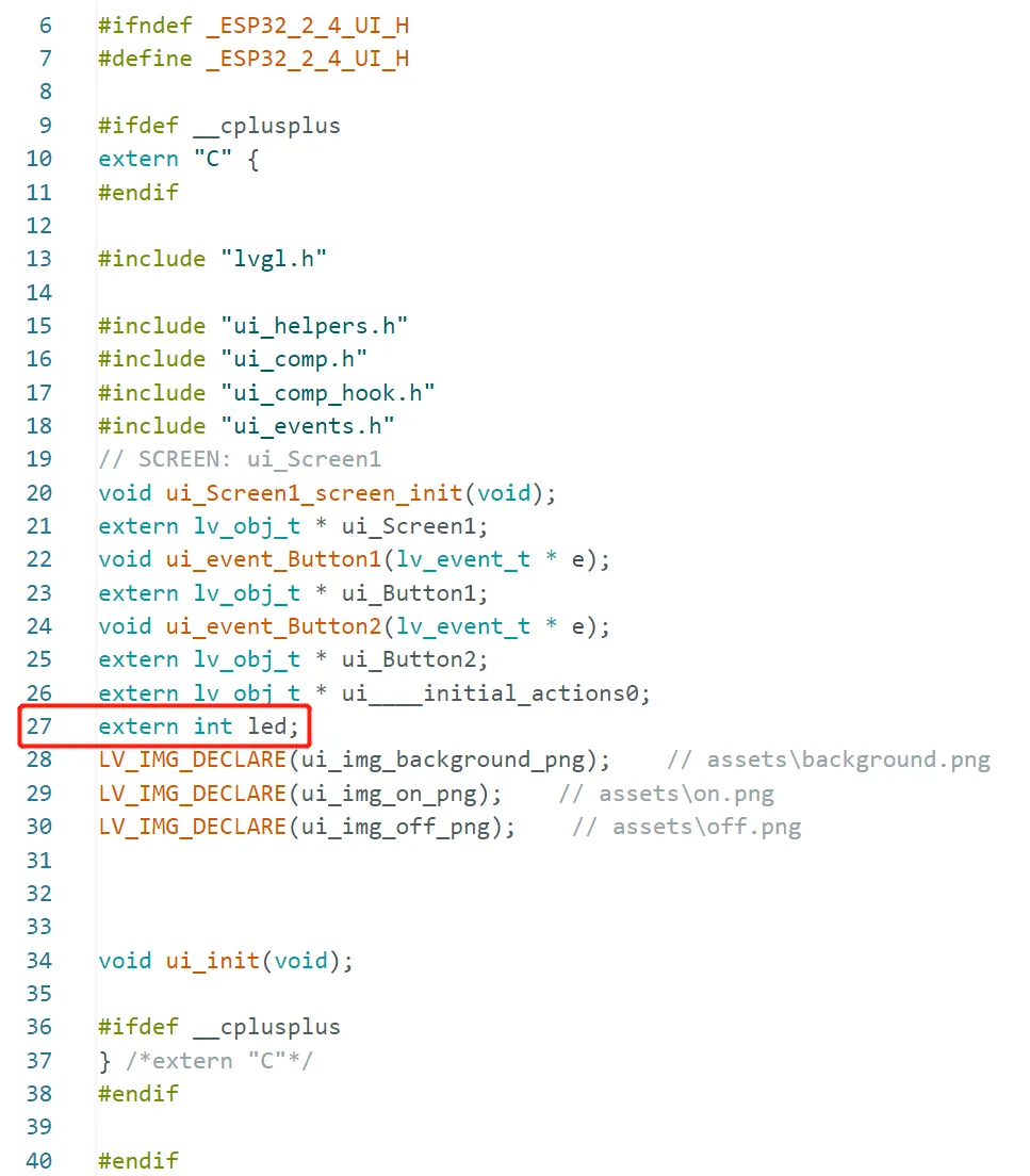

    First, define an extern variable in the ui.h file to store the status of the LED. In the main program, the LED light is controlled to turn on and off by judging the status of this variable.
    extern int led;

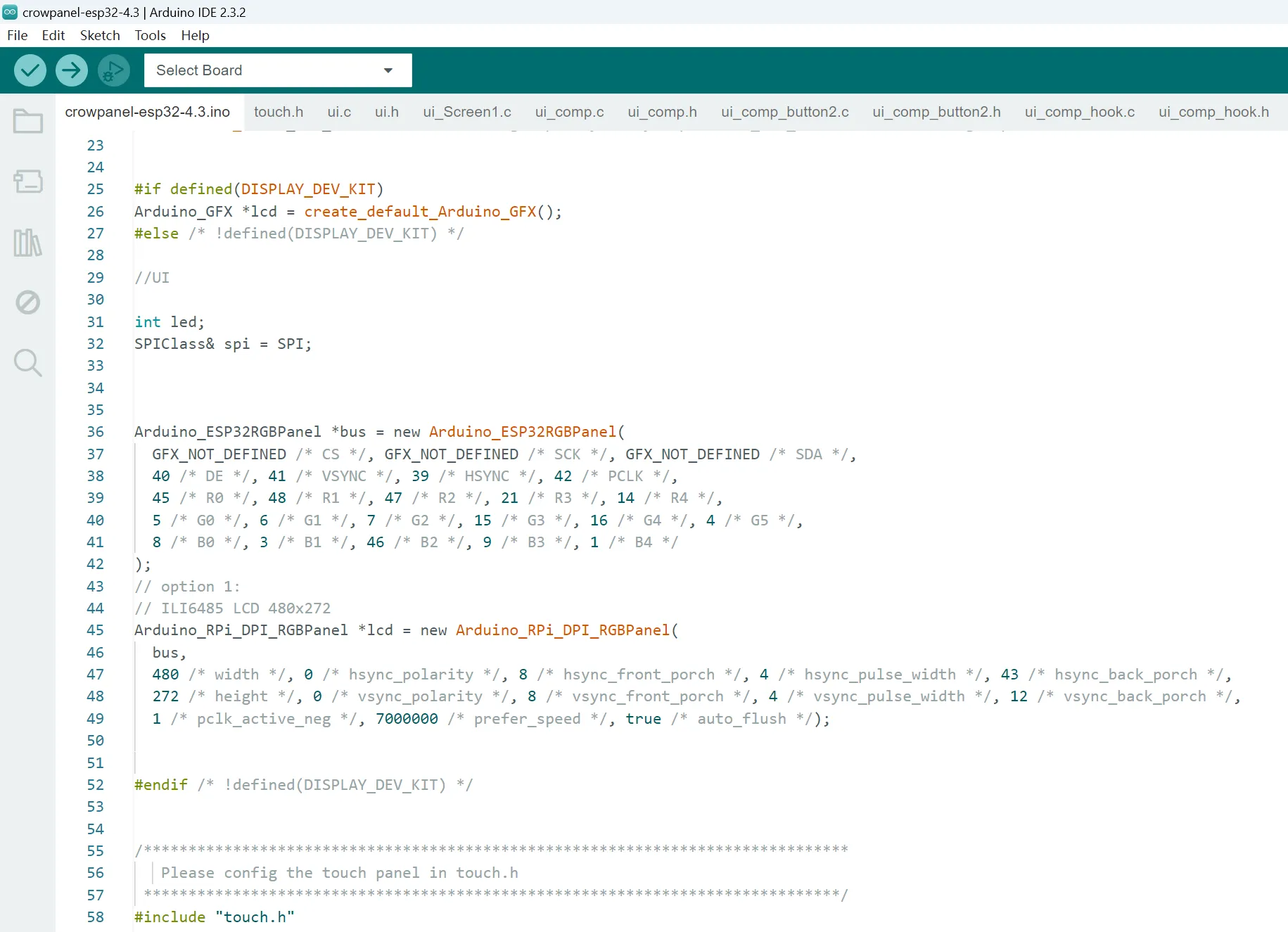

  • Create a default Arduino_GFX object lcd
    #if defined(DISPLAY_DEV_KIT)
    Arduino_GFX *lcd = create_default_Arduino_GFX();
    #else /* !defined(DISPLAY_DEV_KIT) */
    Arduino_ESP32RGBPanel *bus = new Arduino_ESP32RGBPanel(
      GFX_NOT_DEFINED /* CS */, GFX_NOT_DEFINED /* SCK */, GFX_NOT_DEFINED /* SDA */,
      40 /* DE */, 41 /* VSYNC */, 39 /* HSYNC */, 42 /* PCLK */,
      45 /* R0 */, 48 /* R1 */, 47 /* R2 */, 21 /* R3 */, 14 /* R4 */,
      5 /* G0 */, 6 /* G1 */, 7 /* G2 */, 15 /* G3 */, 16 /* G4 */, 4 /* G5 */,
      8 /* B0 */, 3 /* B1 */, 46 /* B2 */, 9 /* B3 */, 1 /* B4 */
    // option 1:
    // ILI6485 LCD 480x272
    Arduino_RPi_DPI_RGBPanel *lcd = new Arduino_RPi_DPI_RGBPanel(
      bus,
      480 /* width */, 0 /* hsync_polarity */, 8 /* hsync_front_porch */, 4 /* hsync_pulse_width */, 43 /* hsync_back_porch */,
      272 /* height */, 0 /* vsync_polarity */, 8 /* vsync_front_porch */, 4 /* vsync_pulse_width */, 12 /* vsync_back_porch */,
      1 /* pclk_active_neg */, 7000000 /* prefer_speed */, true /* auto_flush */);
    #endif /* !defined(DISPLAY_DEV_KIT) */

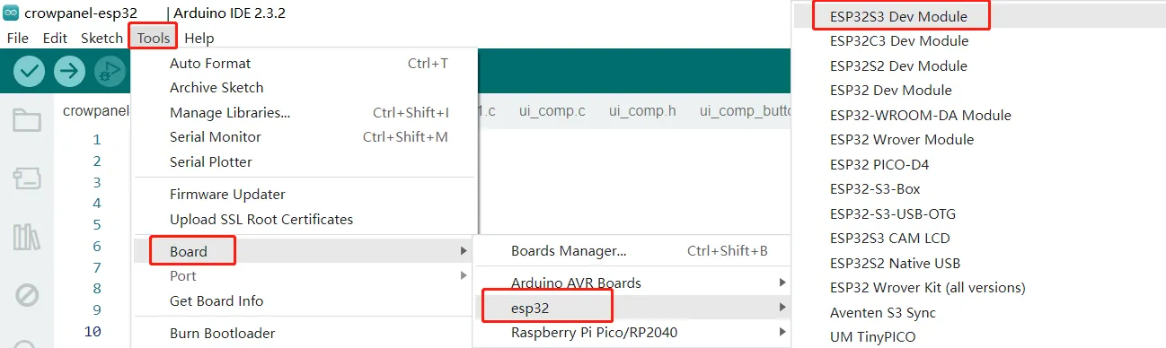

  1. After completing the installation of the ESP32 board according to "Get Started with Arduino IDE" and the installation of the library according to "Install Libraries", open the program and connect the ESP32 HMI 4.3-inch to the computer via a USB-C cable.
  2. Select Board: click "Tools" -> "Board" -> "esp32" and select "ESP32S3 Dev Module"

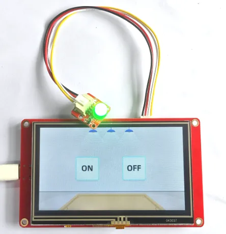

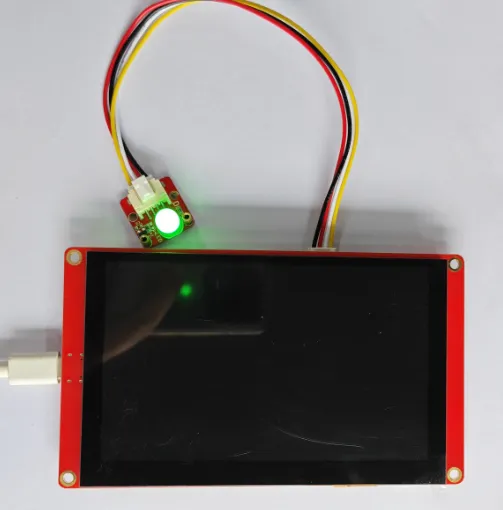

  6. After the program is successfully uploaded, connect the LED to GPIO_D. Click the ON button on the screen and the LED will turn on. Click the OFF button and the LED will turn off.
    CrowPanel-ESP32-4-3inch-demo

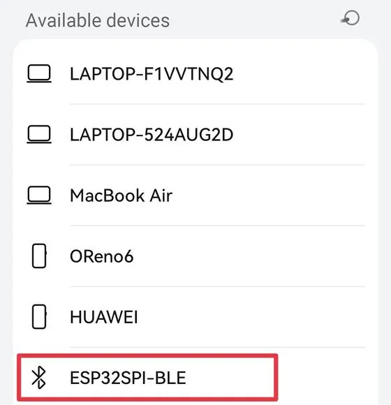

Example5: Initialize the interact communication of Bluetooth
Please check if you have installed the library BLE(Copy the BLE folder in the libraries downloaded above to the .../arduino/libraries directory). Upload the following code to the board, and use the phone to search the Bluetooth device.
#include "BLEDevice.h"              //BLE drive library
#include "BLEServer.h"              //BLE server library
#include "BLEUtils.h"               //BLE Utility library
#include "BLE2902.h"                //Feature Add Descriptor Library
#include <BLECharacteristic.h>      //BLE Feature function library
BLEAdvertising* pAdvertising = NULL;
BLEServer* pServer = NULL;
BLEService *pService = NULL;
BLECharacteristic* pCharacteristic = NULL;
#define bleServerName "ESP32SPI-BLE"  //BLE Server name
#define SERVICE_UUID "6479571c-2e6d-4b34-abe9-c35116712345"  //Server UUID
#define CHARACTERISTIC_UUID "826f072d-f87c-4ae6-a416-6ffdcaa02d73"
bool connected_state = false;   //Create device connection identifier
class MyServerCallbacks: public BLEServerCallbacks  //Create connection and disconnection calling classes
    void onConnect(BLEServer *pServer)//Start connecting function
      connected_state = true;   //Device is connected correctly
    void onDisconnect(BLEServer *pServer)//disconnect function
      connected_state = false;  //Device connection error
void setup() {
  Serial.begin(115200);
  //BLE
  BLEDevice::init(bleServerName);  //Create BLE and set name
  pServer = BLEDevice::createServer();  //Create BLE server
  pServer->setCallbacks(new MyServerCallbacks());  //Set up connection and disconnection calling classes
  pService = pServer->createService(SERVICE_UUID); //Create BLE service
  pCharacteristic = pService->createCharacteristic(  //Create ble feature(Characterristic_UUID)
                      CHARACTERISTIC_UUID,
                      BLECharacteristic::PROPERTY_READ | BLECharacteristic::PROPERTY_WRITE | BLECharacteristic::PROPERTY_NOTIFY);
  pCharacteristic->setValue("ELECROW");
  //start broadcast
  pAdvertising = BLEDevice::getAdvertising();  //A bleadvertising class pointer padvertising is defined, which points to bledevice:: getadvertising()
  pAdvertising->addServiceUUID(SERVICE_UUID);
  pAdvertising->start();  //Start broadcasting
  pService->start();
  //  pAdvertising->stop();  //Stop broadcasting
  //  pService->stop();      //Stop service

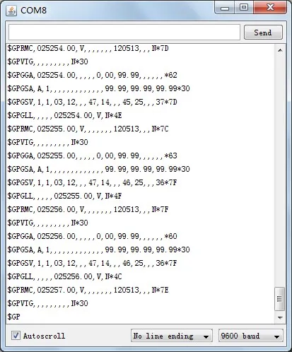

Example7: Connect Crowtail-GPS module via UART to Get Location
Connect the Crowtail-GPS to the UART port.
Upload the following code to the board.
#define SERIAL_BAUD 9600
HardwareSerial cardSerial(1);//Declare the UART1
unsigned char buffer[256]; // buffer array for data recieve over serial port
int count_1 = 0;   // counter for buffer array
void clearBufferArray()              // function to clear buffer array
  for (int i = 0; i < count_1; i++)
    buffer[i] = 0; // clear all index of array with command NULL
void setup() {
  Serial.begin( 9600 ); /*Initialize the serial port*/
  cardSerial.begin(SERIAL_BAUD, SERIAL_8N1, 18, 17);//4.3 /*初Initialize the serial port1*/18-RX\17-TX
void loop() {
  if (cardSerial.available())              // if date is comming from softwareserial port ==> data is comming from SoftSerial shield
    while (cardSerial.available())         // reading data into char array
      buffer[count_1++] = cardSerial.read();   // writing data into array
      if (count_1 == 256)break;
    Serial.write(buffer, count_1);           // if no data transmission ends, write buffer to hardware serial port
    clearBufferArray();              // call clearBufferArray function to clear the storaged data from the array
    count_1 = 0;                       // set counter of while loop to zero
  if (Serial.available())            // if data is available on hardwareserial port ==> data is comming from PC or notebook
    cardSerial.write(Serial.read());       // write it to the SoftSerial shield
GPS
