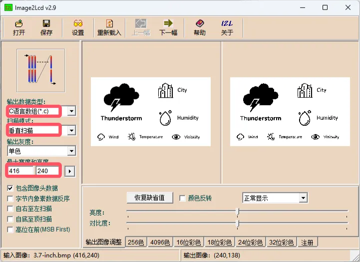

Convert the image format¶

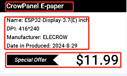

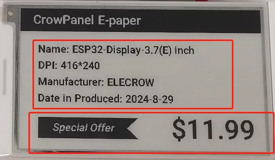

First, let's take a look at the price tag we design in this example, which is divided into three parts(all are images). The top bar is a fixed. The description and the price is variable. The parts we need to update are the description and price.

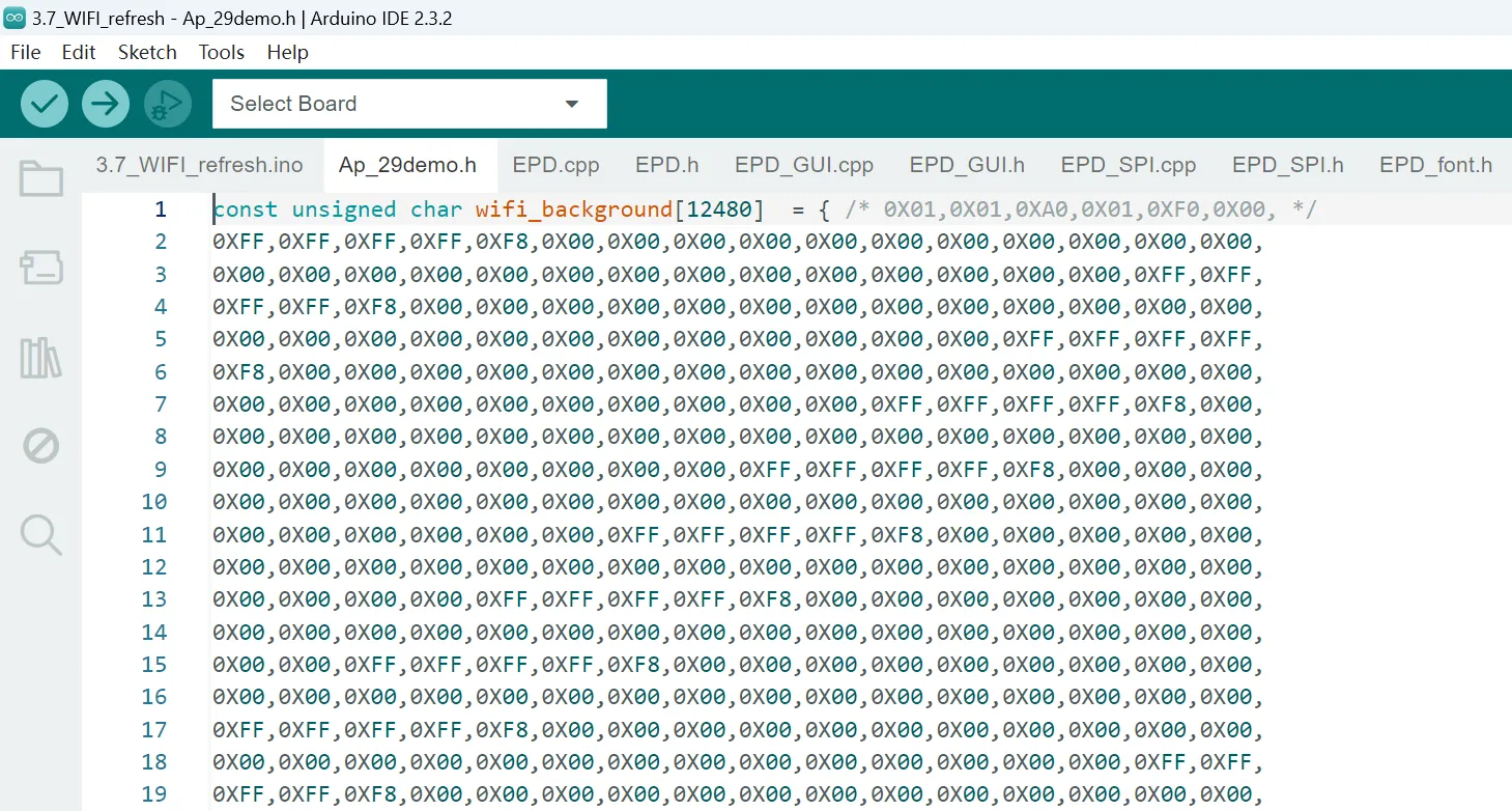

For the fixed top bar, we can convert it to C array and put them in the code.
For the variable description and price, we need to convert them to bin file and upload them to the board through WiFi.

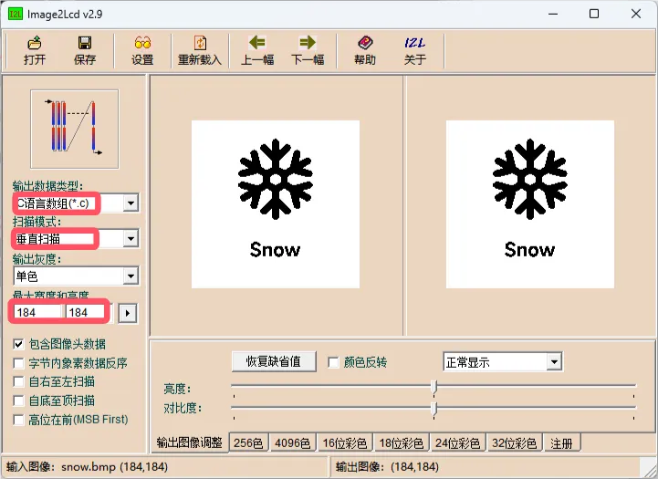

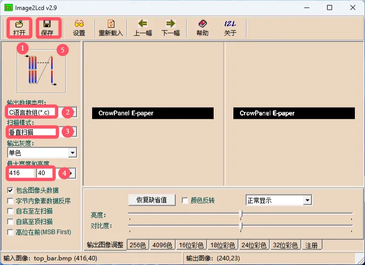

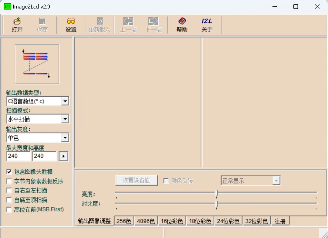

the image modulo tool Image2Lcd and open it.
Click open and select top-bar.bmp, convert it to array format.
- Open file
- Output date type: C language array by default
- Scan mode: Vertical scan (the 2nd one)
- The biggest width and height: Consistent with the width and height of the image. Note that it must be a multiple of 8, otherwise it cannot be displayed properly
- Save and output
You can put this array in a suitable header file, and I have placed it in Ap_29demo. h here.

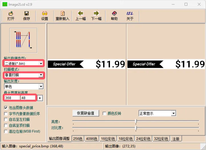

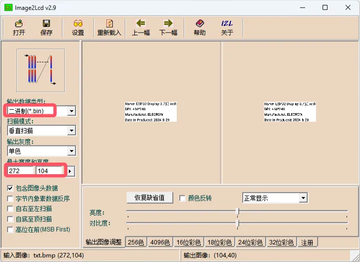

Convert the description pictures and price tag pictures to bin files. These bin files will be used to update prices over WiFi.
- Open the file
- The output type select .bin file
- The width and height should consistent with the width and height of the image. Note that it must be a multiple of 8, otherwise it cannot be displayed properly
- Save the file

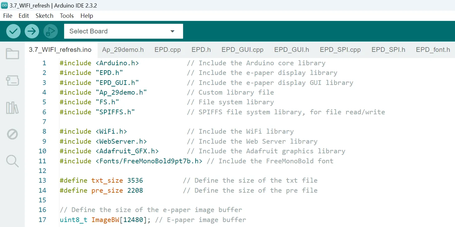

Add necessary libraries
#include <Arduino.h> // Include the Arduino core library
#include "EPD.h" // Include the e-paper display library
#include "EPD_GUI.h" // Include the e-paper display GUI library
#include "Ap_29demo.h" // Custom library file
#include "FS.h" // File system library
#include "SPIFFS.h" // SPIFFS file system library, for file read/write
#include <WiFi.h> // Include the WiFi library
#include <WebServer.h> // Include the Web Server library
#include <Adafruit_GFX.h> // Include the Adafruit graphics library
#include <Fonts/FreeMonoBold9pt7b.h> // Include the FreeMonoBold font
Define the file variable fsUploadFile Used for accessing files, txt_size and pre_size correspond to the size of the BIN file(Exported in the above steps) for the text label and price label to be transmitted. The image resolution requirement is smaller than the screen resolution and both width and height are multiples of 8.
#define txt_size 3536 // Define the size of the txt file
#define pre_size 2208 // Define the size of the pre file
Note: The size here can be defined based on the size of the images to be transmitted later, otherwise it will cause image transfer failure

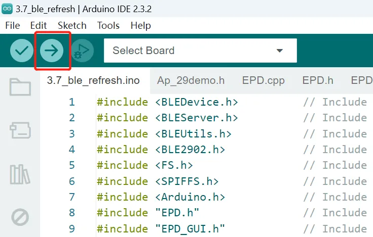

Upload the Code¶
Open the 3.7_WIFI_refresh.ino

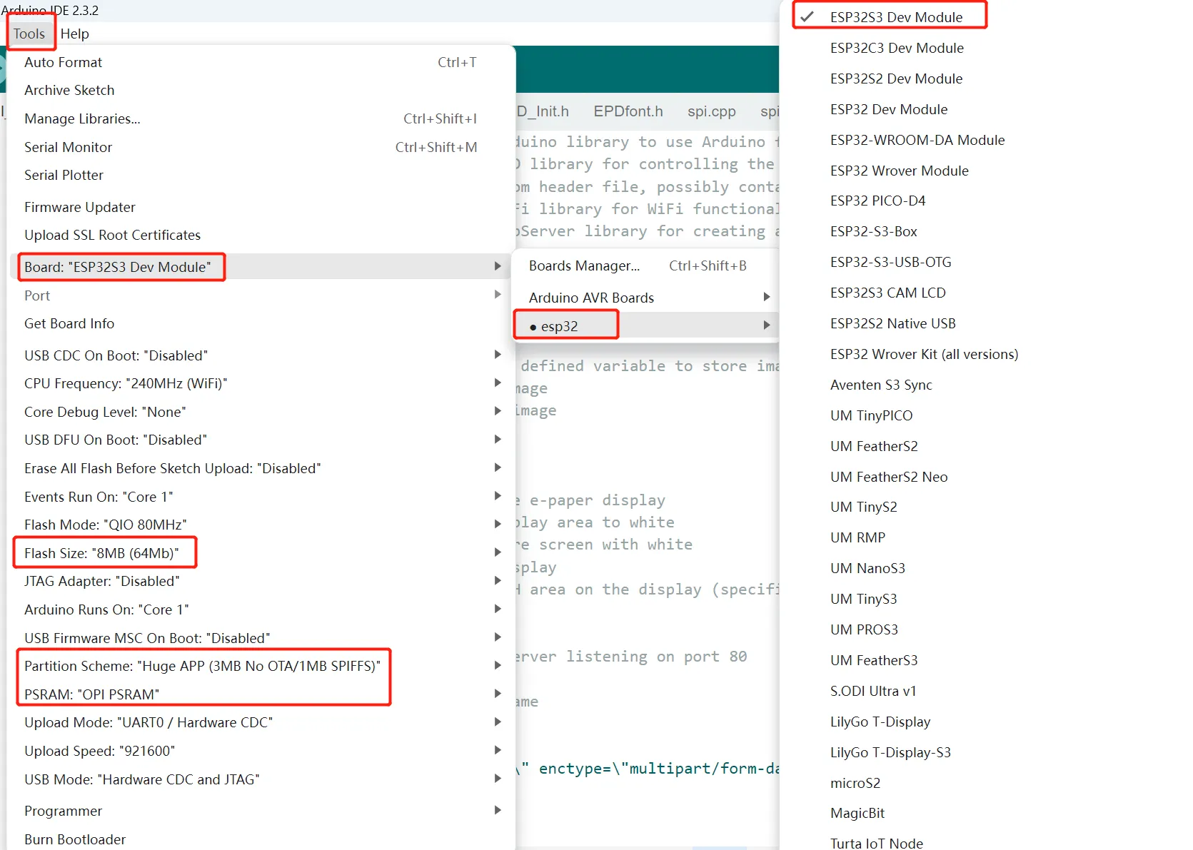

Click "Tools"->"Board"->"esp32"->"ESP32S3 Dev Module", and the "Partition Scheme" select "Huge APP (3MB No OTA/1MB SPIFFS)", "PSRAM" select "OPI PSRAM".
Connect CorwPanel to the computer, click on "Tool" and select the corresponding "port".

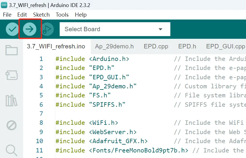

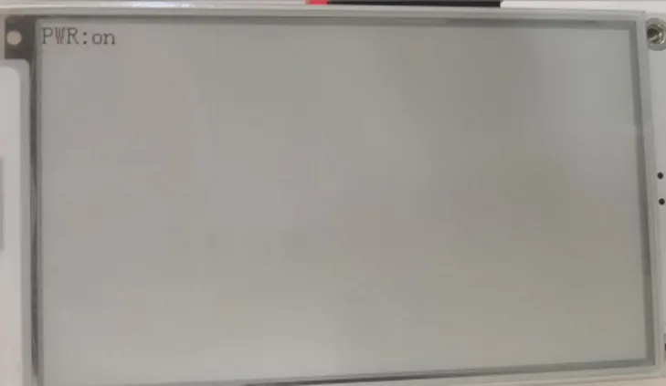

Click "Upload" to upload the code to the board. There will be an image show on the screen.

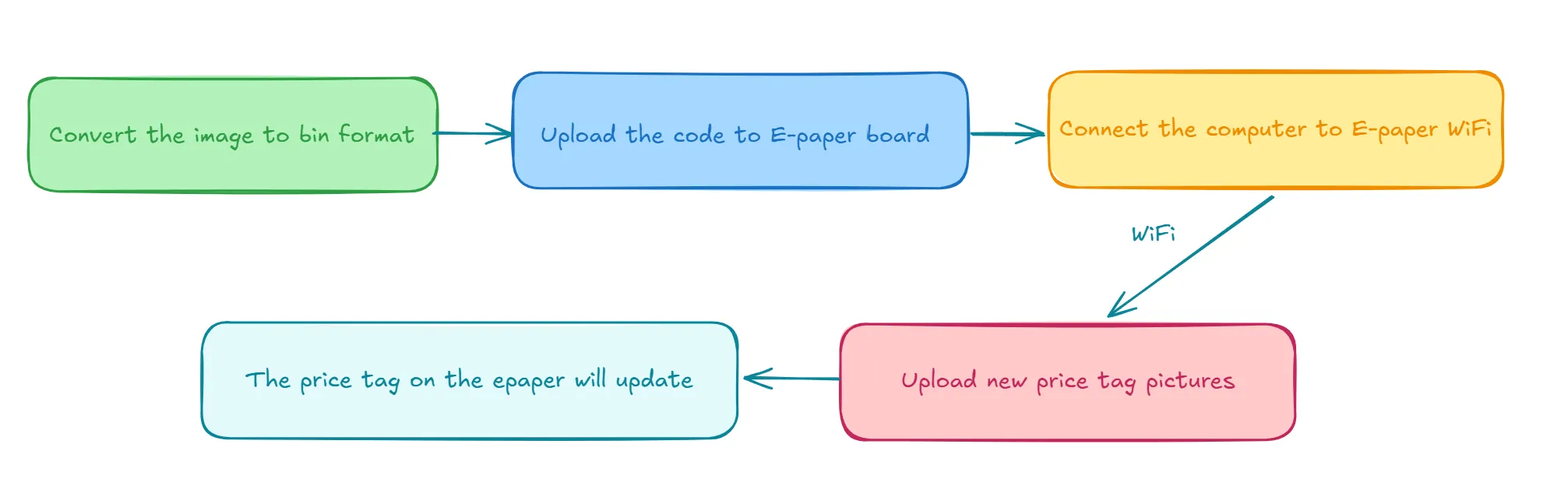

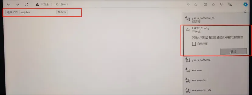

Update the price tag with WiFi¶
Connect a laptop to the hotspot of the ESP32 E-PAPER display.
Enter the IP address 192.168.4.1 in the browser.
Select the bin file of the picture you need to show, then click submit.
Note: The size of the images you transfer must be consistent with the size defined in the code, otherwise it will cause image transfer failure
After successful transmission, the price and text will be replaced, and the data will be saved in flash.

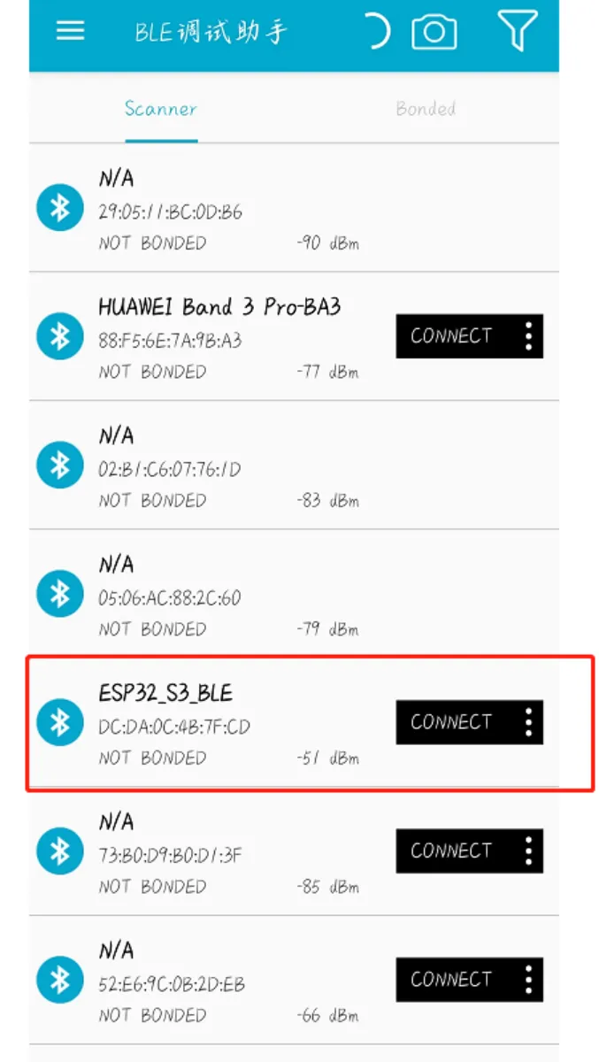

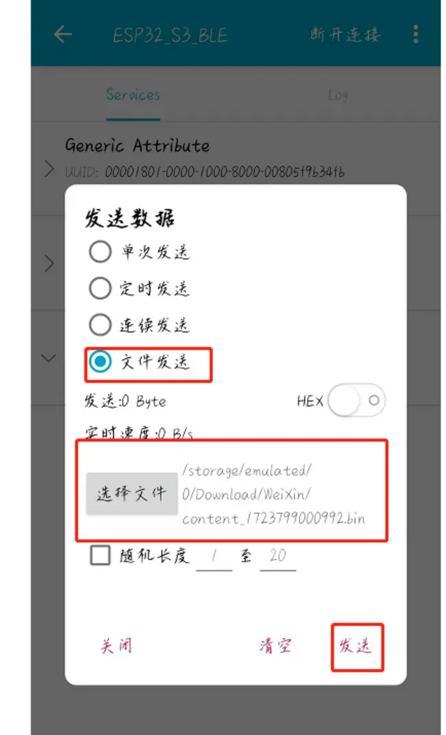

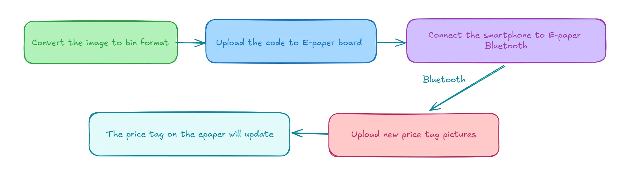

Update via Bluetooth¶
The same as the method in the "Update via WiFi".
Code Explanation¶

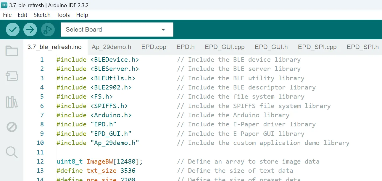

Please click to download the code file 3.7_ble_refresh.zip for this demo.
#include <BLEDevice.h> // Include the BLE device library
#include <BLEServer.h> // Include the BLE server library
#include <BLEUtils.h> // Include the BLE utility library
#include <BLE2902.h> // Include the BLE descriptor library
#include <FS.h> // Include the file system library
#include <SPIFFS.h> // Include the SPIFFS file system library
#include <Arduino.h> // Include the Arduino library
#include "EPD.h" // Include the E-Paper driver library
#include "EPD_GUI.h" // Include the E-Paper GUI library
#include "Ap_29demo.h" // Include the custom application demo library
#define txt_size 3536 // Define the size of text data
#define pre_size 2208 // Define the size of preset data

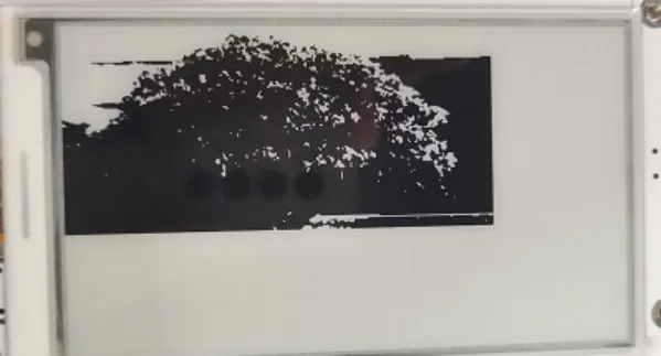

Double click the 3.7_ble_refresh.ino.

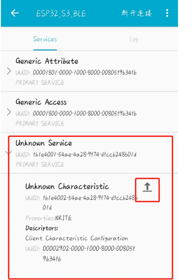

Update the images via bluetooth¶
Download a BLE debugging assistant to your phone, and connect it your phone to the screen device BLE.
Upload the bin file(Save the bin file to your phone in advance).
First, let's take a look at the weather information panel we design in this example, which is divided into 6 parts(all are images).
- weather icon
- city
- humidity
- wind
- temperature
visibility
Only the weather icon is variable, while the other icons are fixed. Therefore, we can use "3.7-inch.bmp" as the background image, while the weather icon varies depending on the weather conditions.

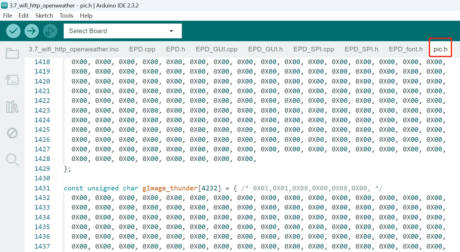

Next, we need to convert these images into a C array format and include it in the code
Click open and select the images, convert them to array format.
- Open file
- Save and output
You can put this array in a suitable header file, and I have placed it in pic. h here.

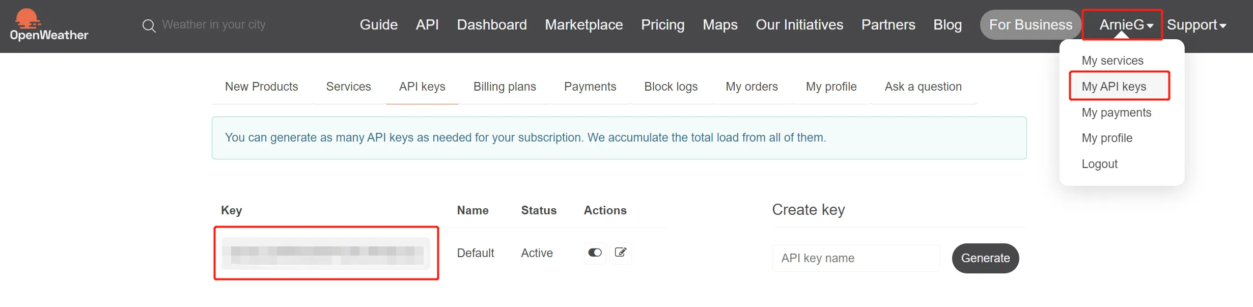

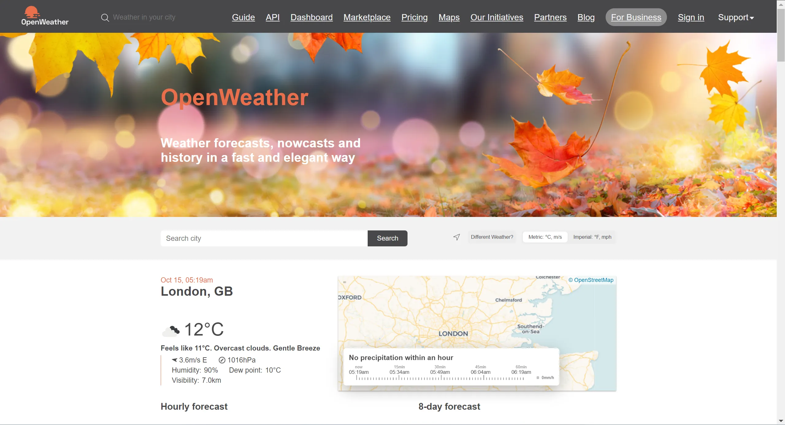

Register an OpenWeather account¶
Enter https://openweathermap.org/ and click "Sing in" to register an OpenWeather account.
Log in your account.
Click your user name -> "My API Keys" to find your API key.

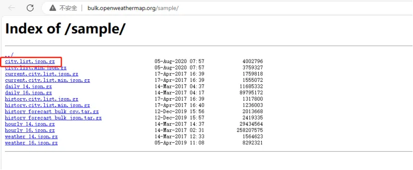

Country Code
You can find the country code at: http://bulk.openweathermap.org/sample/

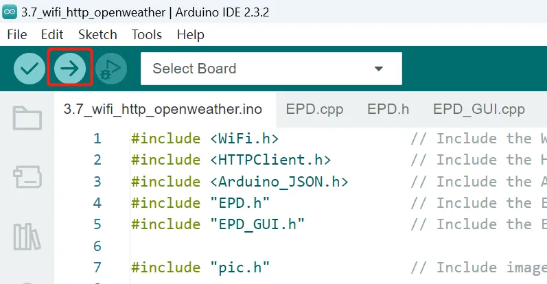

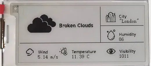

Upload the Code¶
Double click the 3.7_wifi_http_openweather.ino.
After downloading, the weather information for the city you have selected will be displayed on CrowPanel.

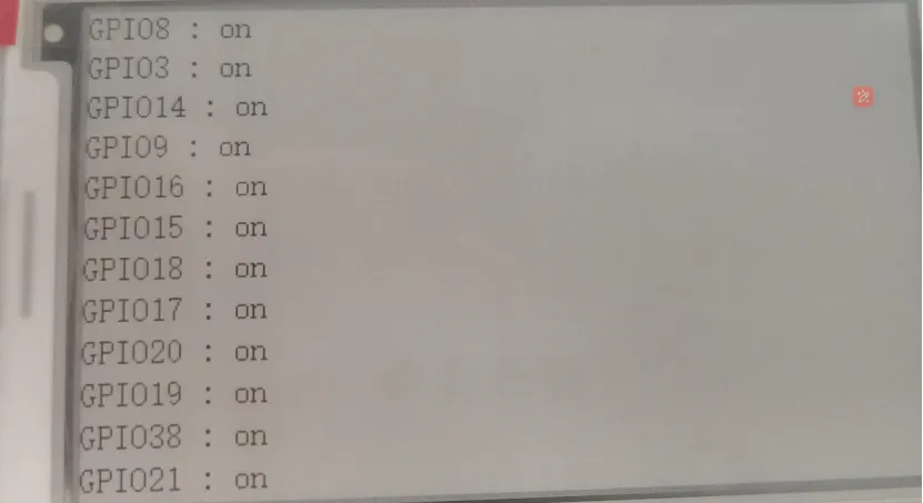

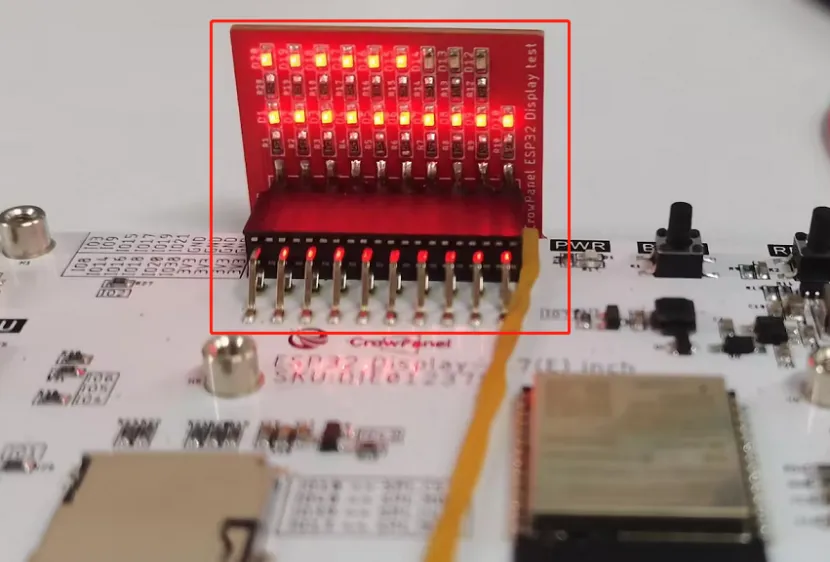

Example 1 Control the GPIO¶
Open the GPIO.ino.
Connect the LED to the GPIO pins.
Upload the code to the CrowPanel. The LEDs will turn on, and the status of the GPIO will show on the screen.

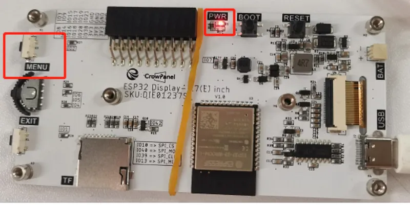

Example 3 Control PWR LED with menu Key¶
Open the PWR.ino
Press the menu key and the PWR LED will turn on/off.

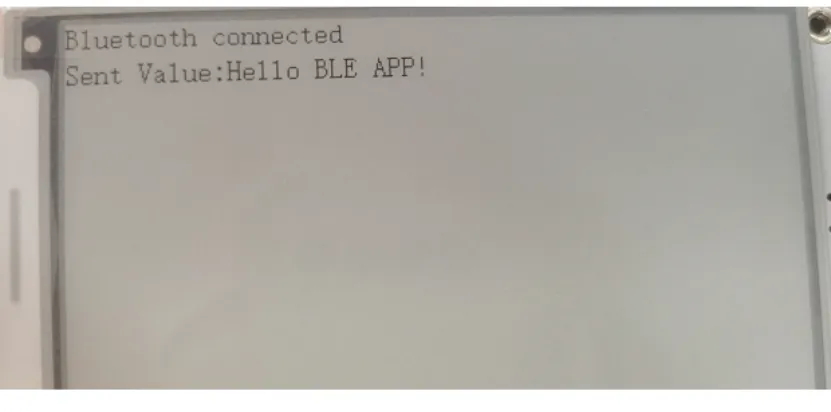

Example 5 Connect Bluetooth¶
Open BLE.ino
After the blutooth is connected, the screen will show:

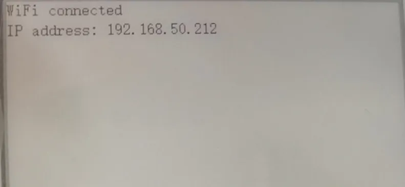

Example 6 Connect WiFi¶
Open wifi.ino
Modify your ssid and password
After the WiFi is connected, the screen will show:
Example 7 Refresh image¶
This example will demonstrate two scenarios: refreshing full screen images and non full screen images.
- Full screen image: The resolution of the image is the same as the screen
- Non full screen image: The image resolution is lower than the screen resolution
Refresch full screen image¶
Open Global_refresh.ino
The image will refresh on the screen.
Refresh non full screen image¶
Open partial_refresh.ino
