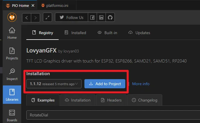

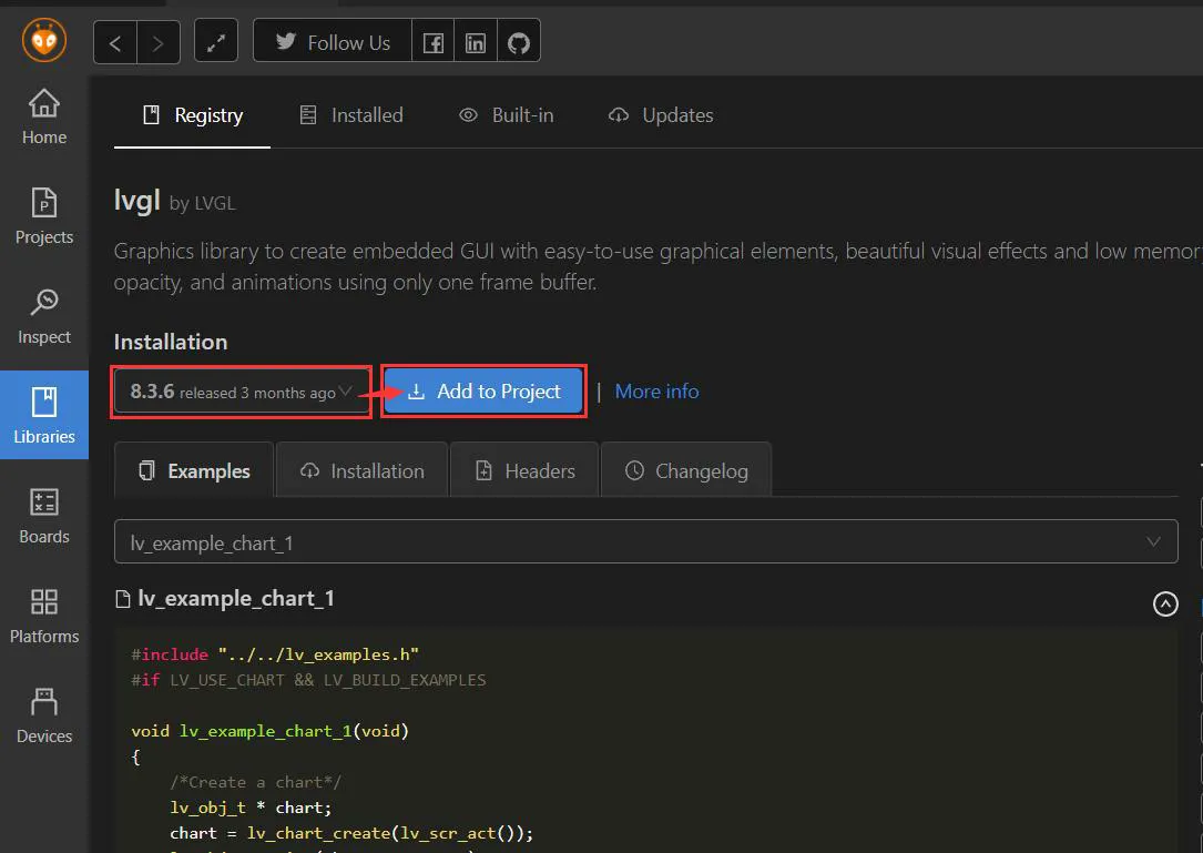

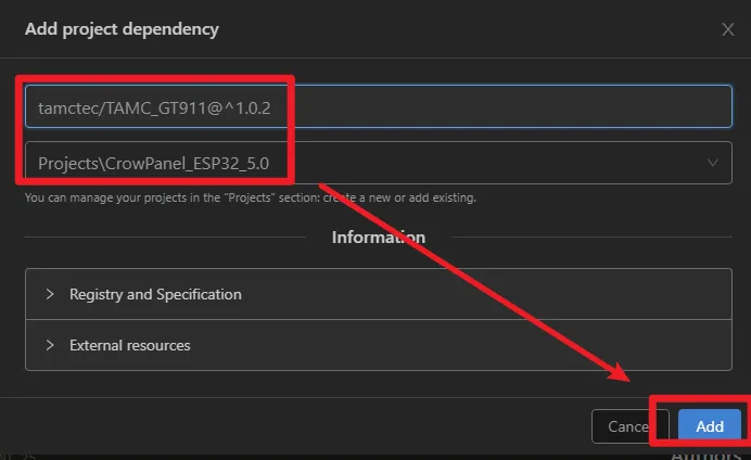

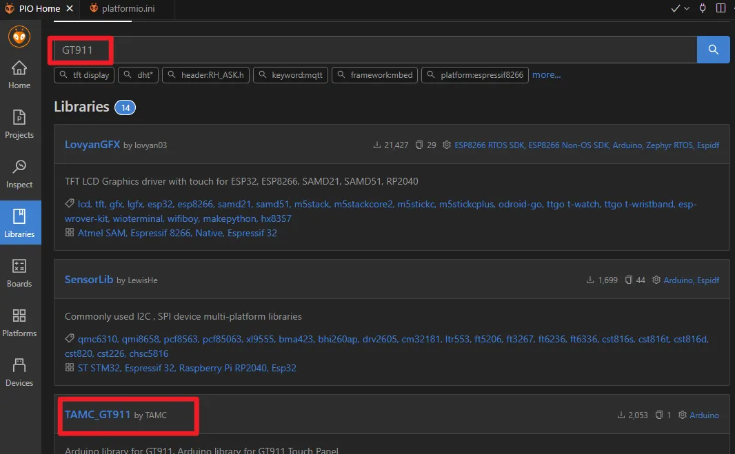

This lesson uses VS Code, PlatformIO, the Arduino framework, LVGL 9.1.0, LovyanGFX (in-project version), and SquareLine Studio 1.6.1 to drive the CrowPanel ESP32-S3 7.0-inch display. The program reads temperature and humidity from the DHT20 via the I2C bus on GPIO19/GPIO20, displays the values on the 800 × 480 screen through LVGL, and controls the LED on GPIO38 via an ON/OFF touch button.
Learners should first prepare the development environment and hardware, open the course project, then compile, select the serial port, and flash the firmware, before observing the screen, LED, and serial monitor. During normal operation, the LCD backlight turns on, the temperature and humidity labels display values, the LED state changes after a button press, and the serial port outputs coordinates when touched. This lesson uses the same set of UI resources as the Arduino version; the difference is that the project is managed by PlatformIO for dependencies and the build process.

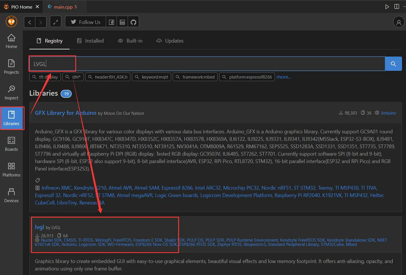

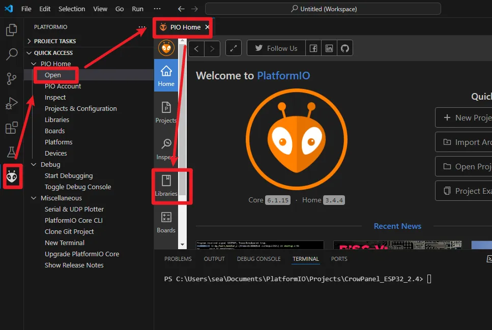

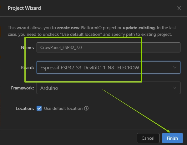

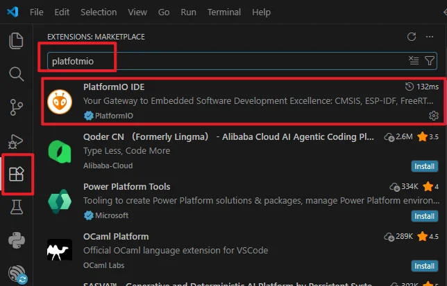

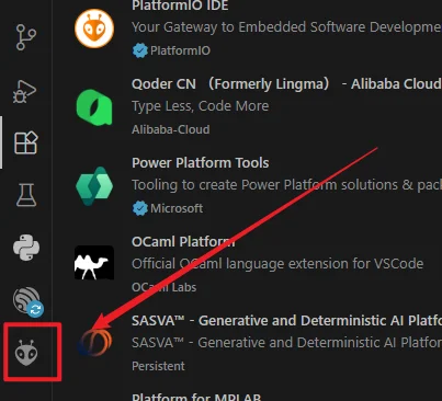

Open VS Code, search for and install PlatformIO IDE in Extensions. If it is already installed, make sure the extension is enabled.
Install PlatformIO IDE
After installation, restart VS Code; the PlatformIO icon should appear on the left sidebar. Click the icon to enter the PIO Home main page.

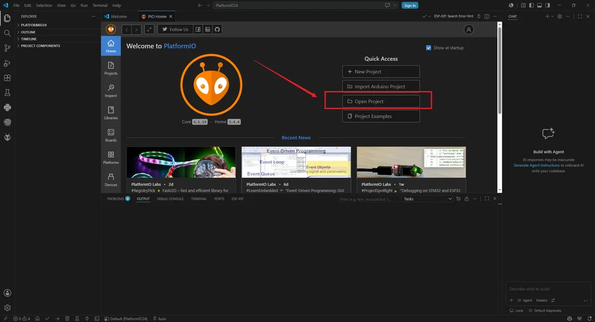

Open PIO Home

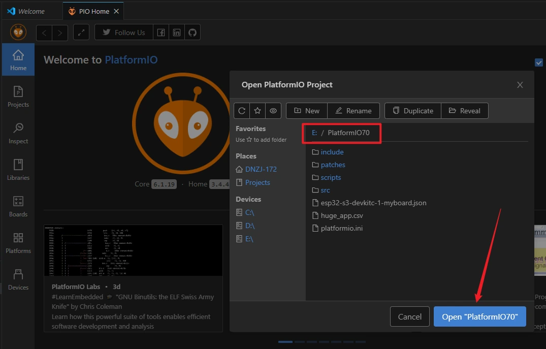

In the PIO Home Quick Access area, click Open Project.
Click Open Project

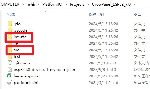

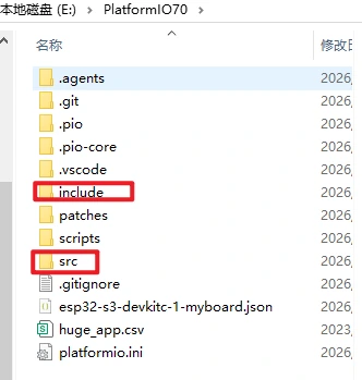

In the dialog, browse to the path and select the project root folder PlatformIO70. This folder must contain platformio.ini, then click the blue Open "PlatformIO70" button.
image-20260727104508098

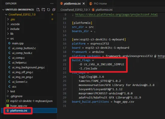

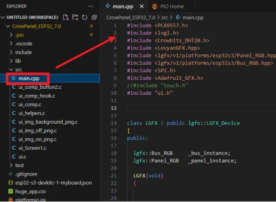

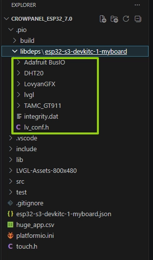

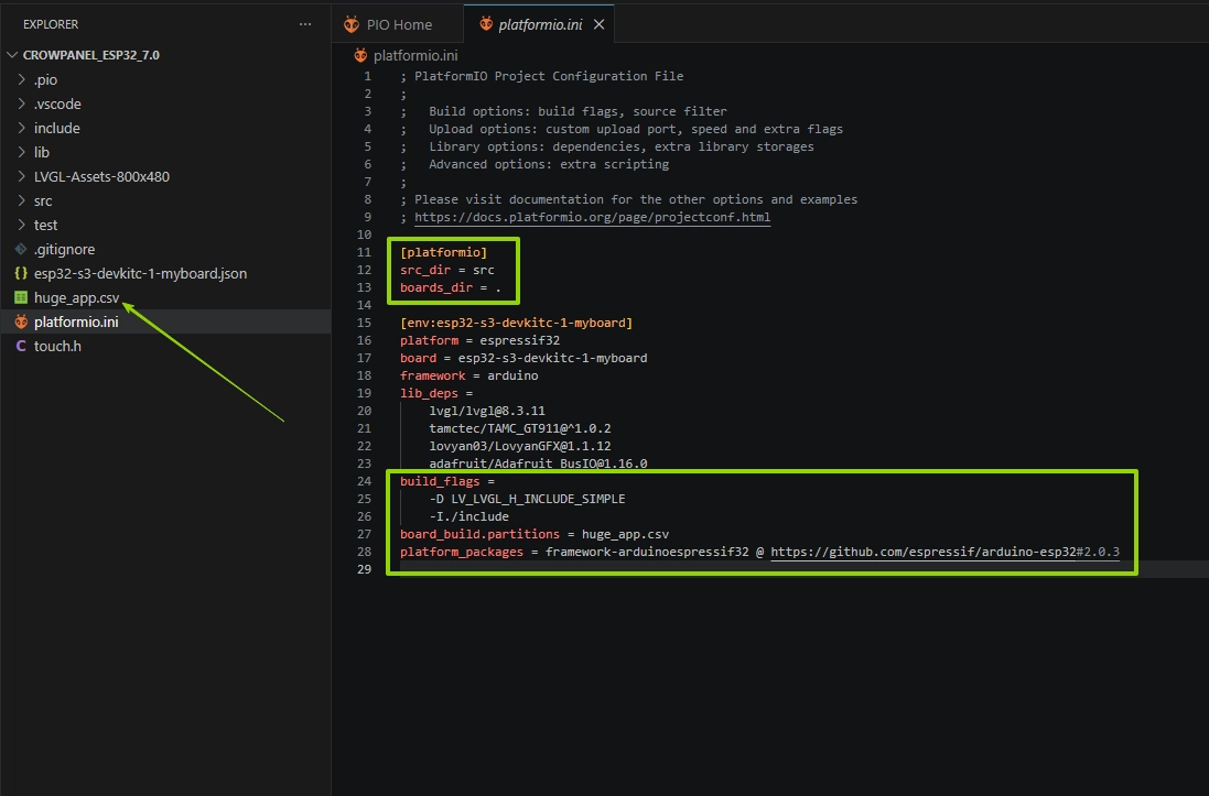

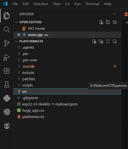

Wait for the Explorer on the left to load the project, then open src/main.cpp and platformio.ini to review the project contents. src/main.cpp is the main program code, and platformio.ini is the configuration file for the platform, dependencies, serial port, and build scripts; the include, src, patches, scripts, and other directories should be kept intact.
image-20260727104553809

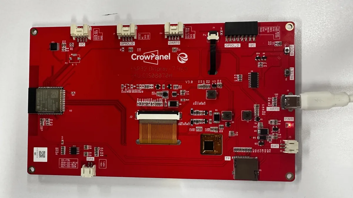

Connect the 7.0-inch HMI development board to a USB port on your computer using a USB data cable.

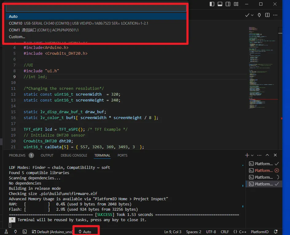

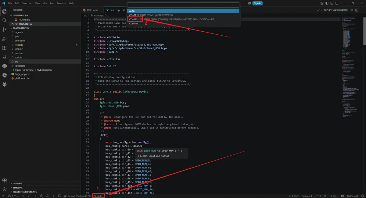

Select the device serial port: check the bottom status bar of VS Code; the dropdown on the left defaults to Auto. Click the dropdown and select the serial port corresponding to the development board. If upload_port and monitor_port are fixed in platformio.ini, change them to the actual port on the current computer, or delete these two lines to let PlatformIO auto-detect.
image-20260727104841940

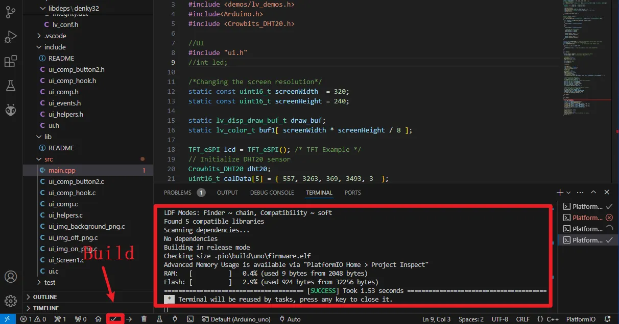

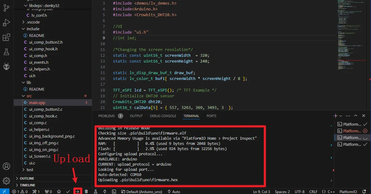

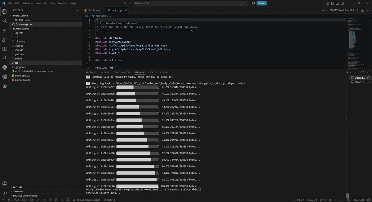

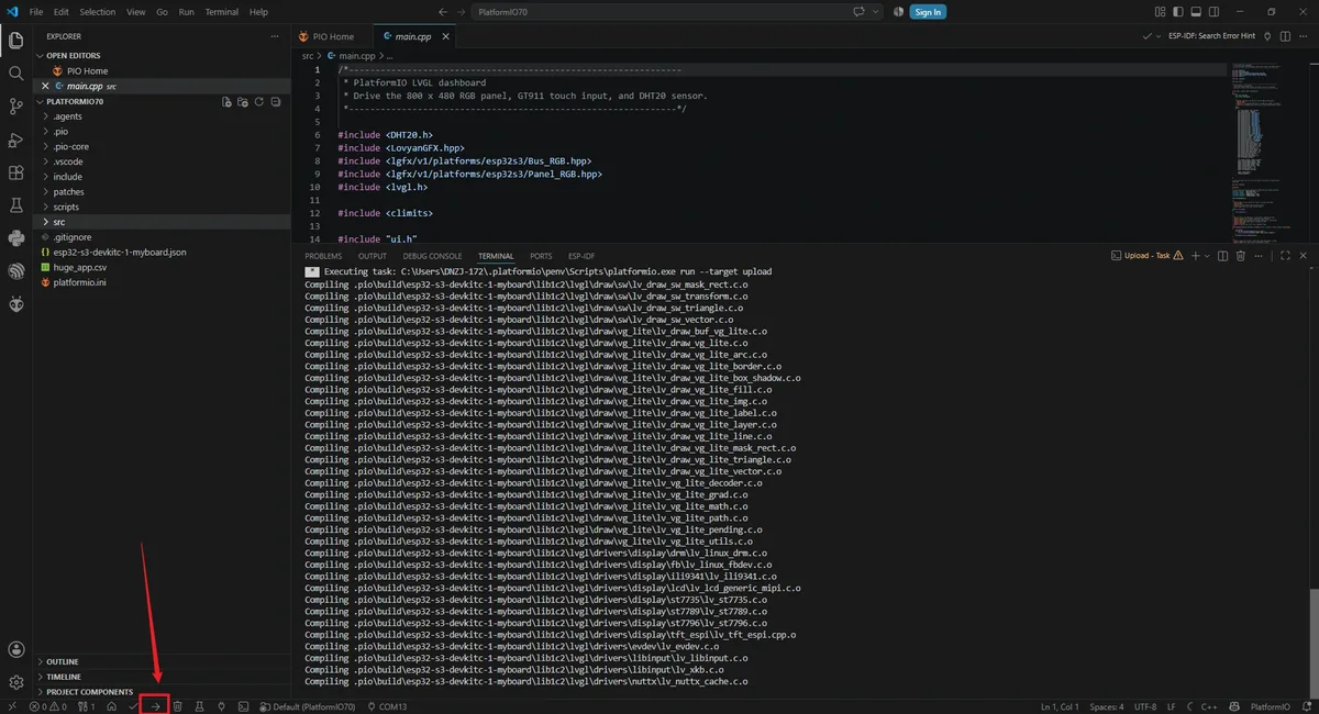

Click the right-arrow icon (PlatformIO: Upload) on the bottom status bar of VS Code. Wait for the compilation, dependency check, patch application, and upload process to run automatically. The first build will download dependencies such as Arduino-ESP32, LVGL, LovyanGFX, and DHT20, so it will take longer.
image-20260727104931841
image-20260727105520548
5. Hardware Operation Steps

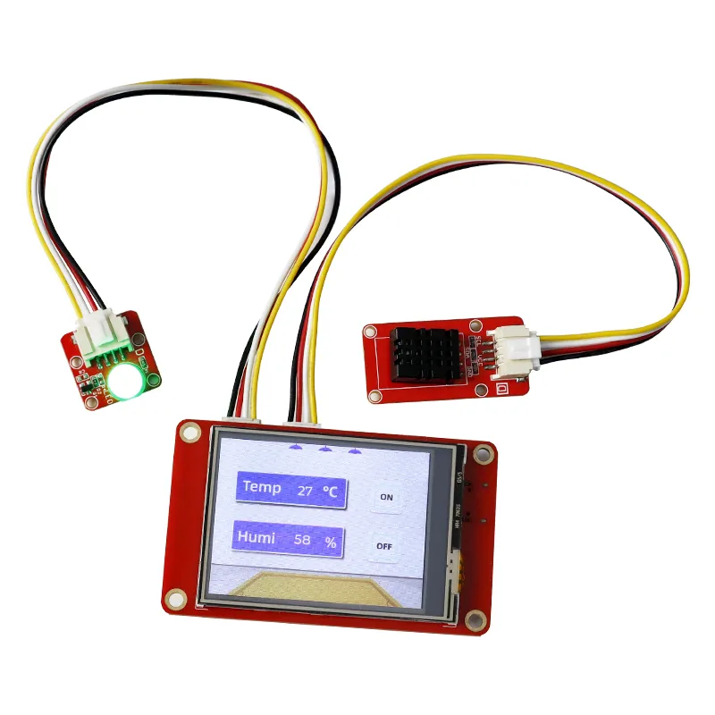

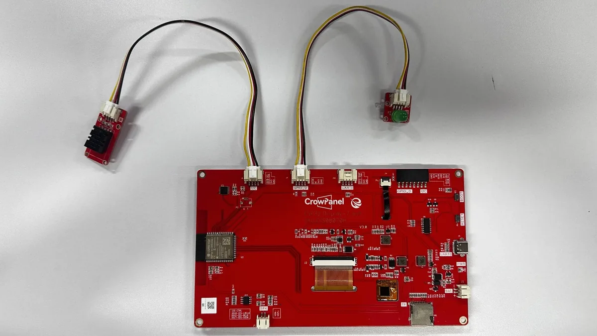

Wire the connections as shown in the diagram:
  • DHT20 temperature and humidity sensor → board I2C interface.
  • LED module → board GPIO_D interface.
IMG_7944

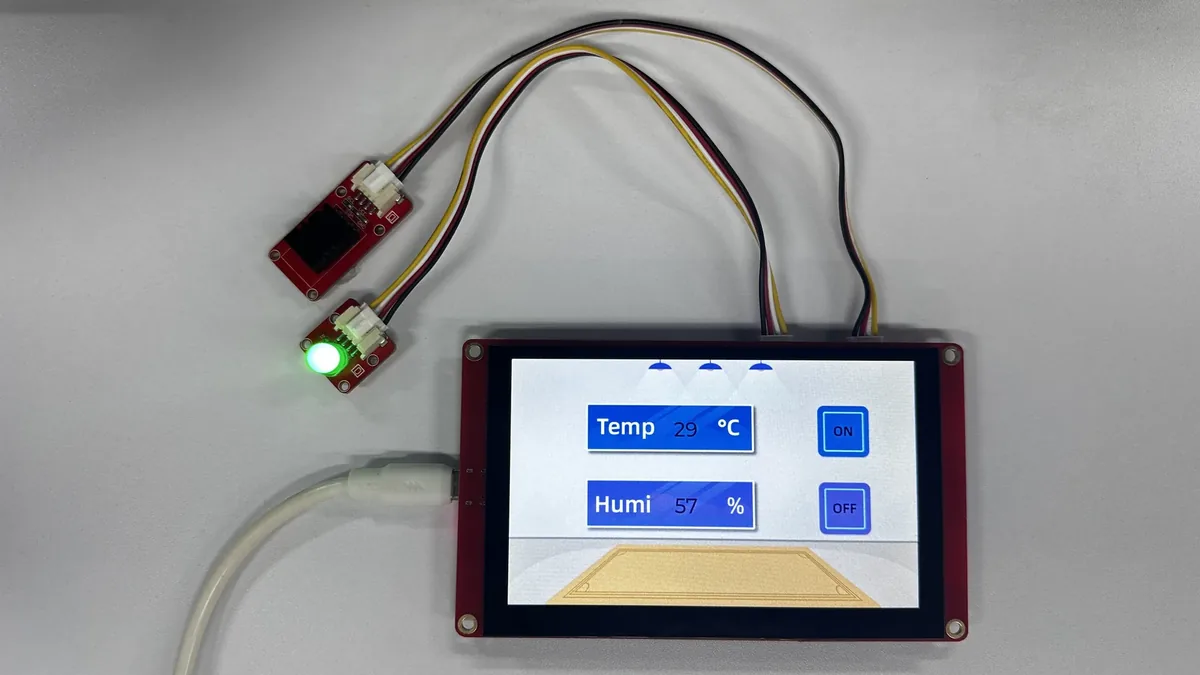

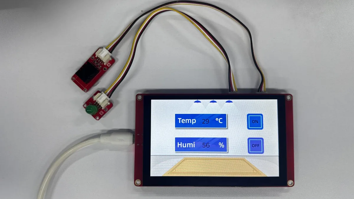

Reconnect the USB cable that supports data transfer. After the upload completes and the board auto-resets, the screen backlight should turn on, and the interface should show temperature, humidity, and the two buttons ON and OFF.
16
Tap ON with your finger, and observe the interface response and the GPIO38 output state; do not touch the screen with sharp or conductive objects.
IMG_7937
Tap OFF and confirm that the output returns to a low level and the LED turns off.
IMG_7938

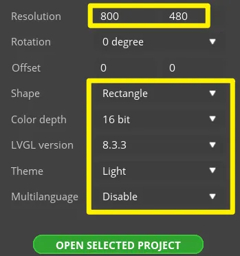

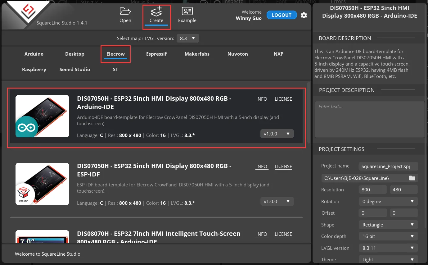

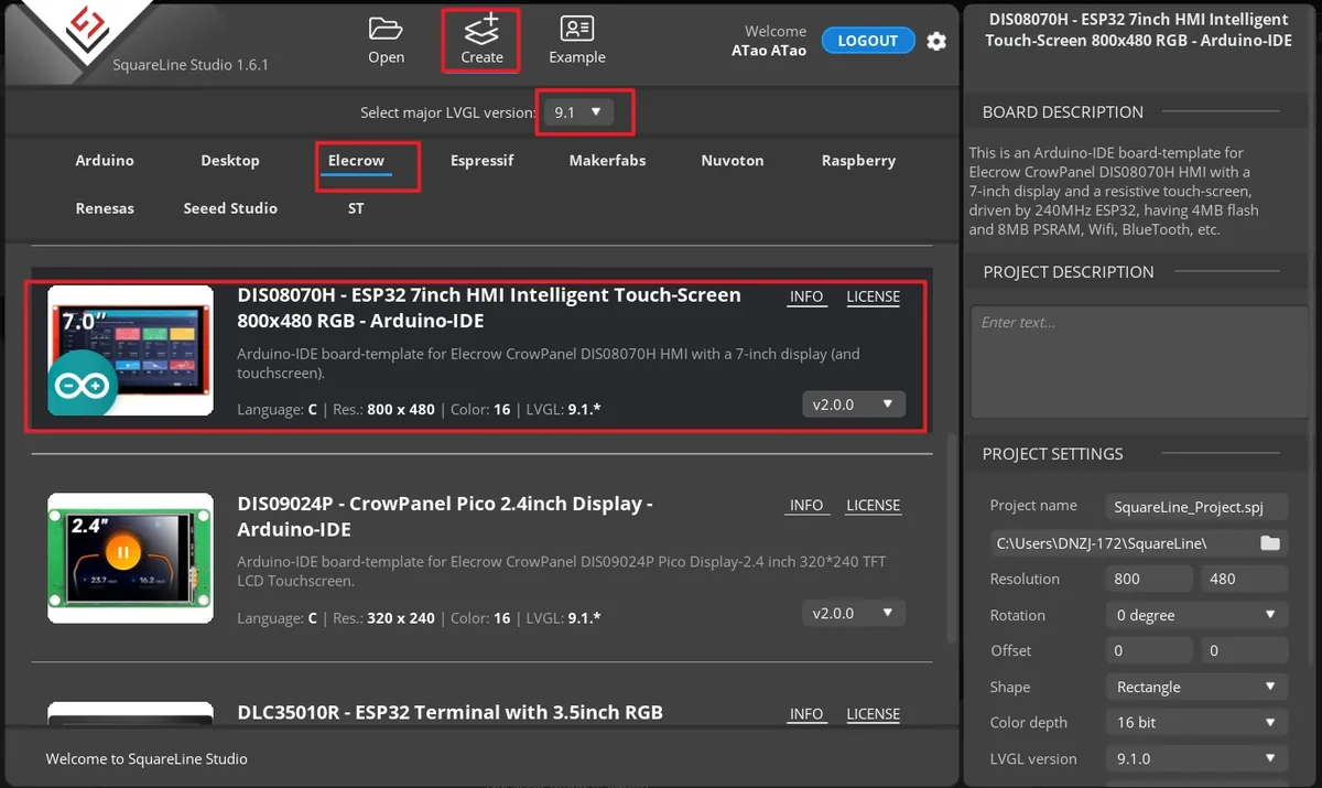

Open SquareLine Studio 1.6.1, click Create at the top to create a new project, select 9.1 as the LVGL major version, and choose Elecrow as the vendor category. In the template list, select DIS08070H - ESP32 7inch HMI Display 800x480 RGB - Arduino-IDE, which is designed for the Elecrow CrowPanel 7-inch capacitive touch screen, with preset parameters of 800×480 resolution and LVGL 9.1, then complete the project creation.
Note: This template is an Elecrow CrowPanel-specific Arduino project template that directly generates LVGL UI code matching the hardware; if you switch to a different screen model, you need to select the corresponding hardware template and verify the resolution and color depth configuration.
image-20260724111759549

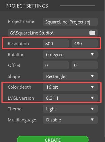

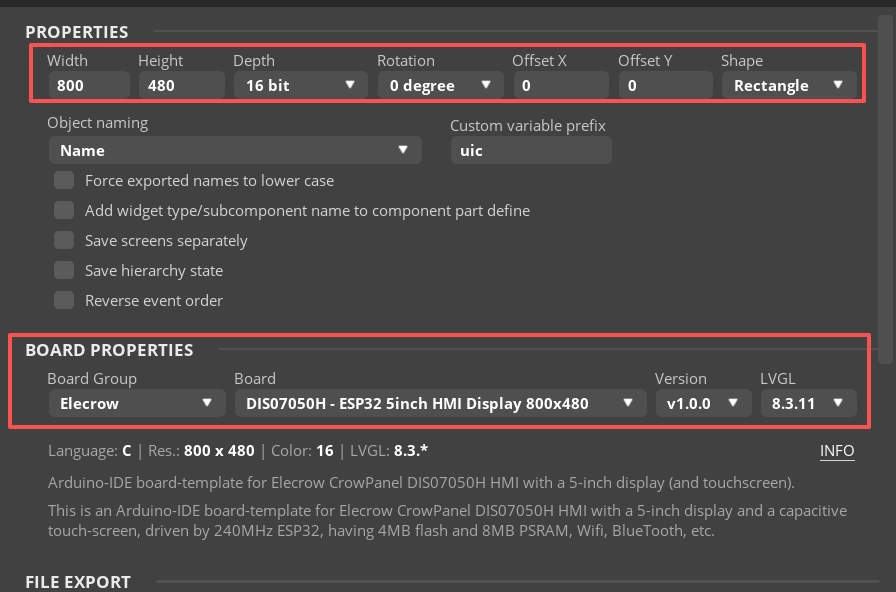

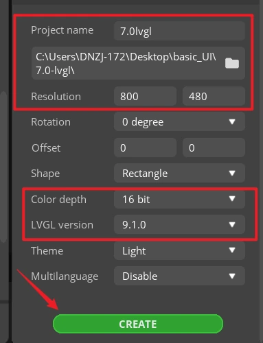

Enter the project name, set the LVGL version to 9.1.0, the resolution to width 800 and height 480, and the color depth to 16 bit, then click CREATE. After creation, the canvas should be a landscape 800×480.
image-20260724111904548
Note: A 16 bit color depth can represent 65,536 colors, using the RGB 5:6:5 pixel representation. Keep it consistent with the project's color configuration.

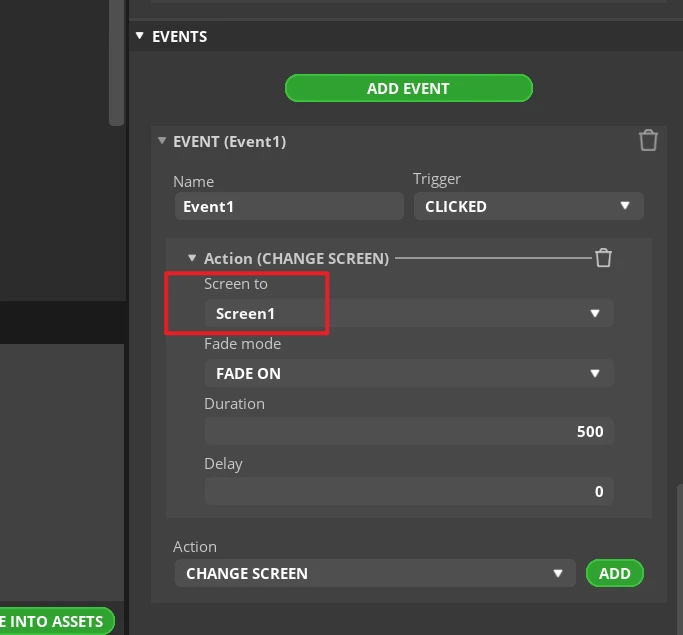

Select the ON button and click ADD EVENT.
Apply the button state settings
Select CLICKED as the trigger condition, and choose the triggered event in Action. The generated program will be modified later to implement the GPIO38 output control function.
38
Note: Since the button will ultimately control the LED on and off, you can add any event here first so that the exported UI file generates the button event code framework; the LED control code will be modified in a later step.
Complete this event. In the example, you can first choose to switch to the Screen1 screen to generate the event structure.

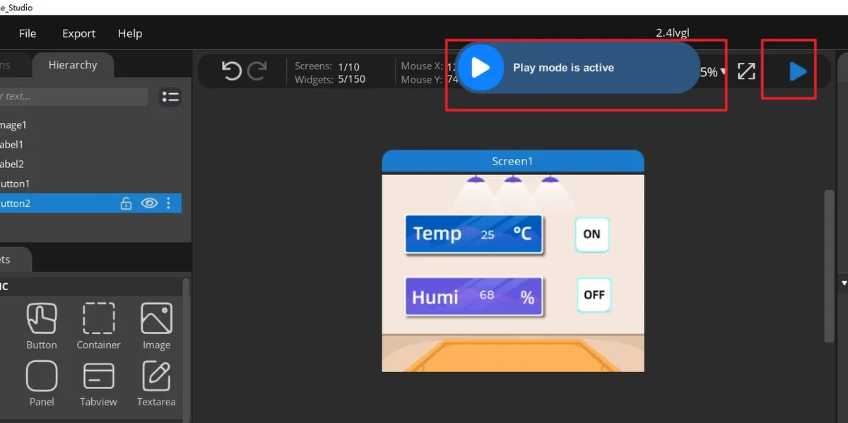

Click Run to preview the interface display and button states.
Add an event to the OFF button

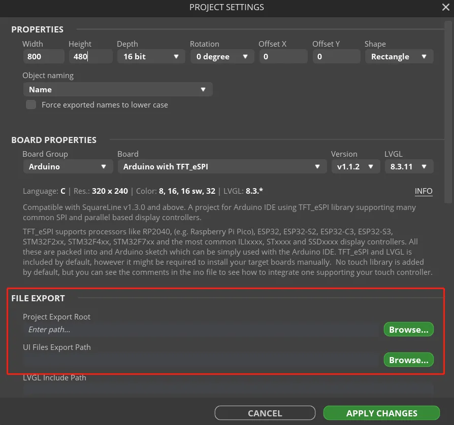

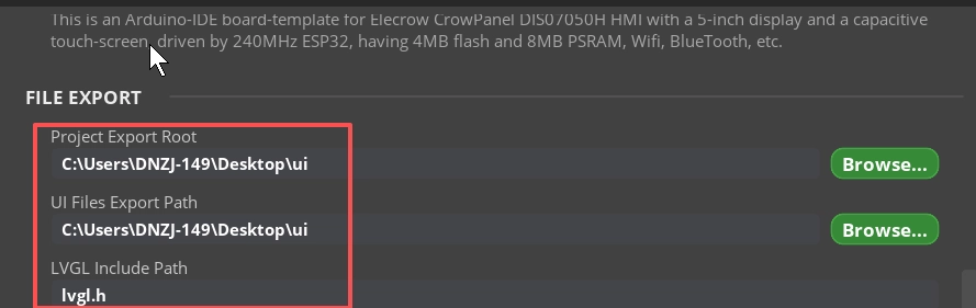

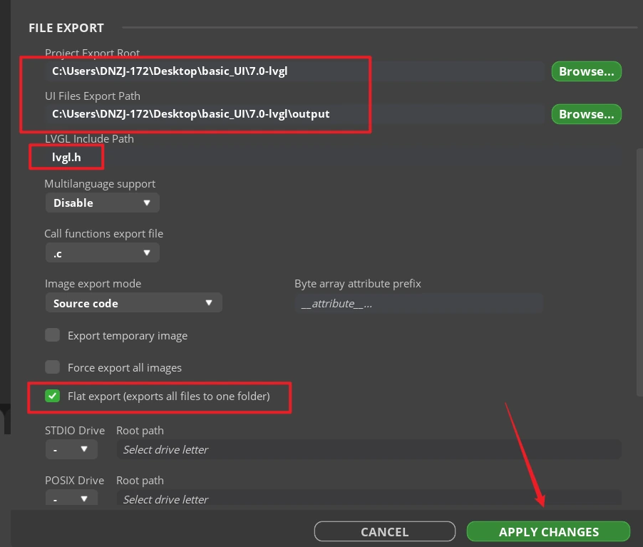

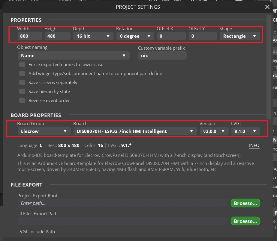

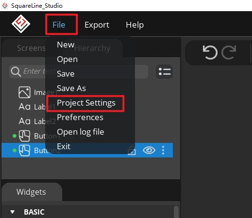

Open File > Project Settings, then configure the relevant settings for the exported files.
Run the preview
image-20260724113200377
Set the export directory to an easy-to-find path consisting only of English characters, create a new output folder, confirm that the LVGL Include Path is lvgl.h, and click APPLY CHANGES to confirm.
image-20260724113251380
image-20260724113402379
Tip: After selecting Flat export, all output files are placed in the same folder, so the program does not need to modify file paths. If Flat export is not selected, files are scattered across different folders and the compiler may fail to recognize them automatically, which usually requires manually modifying the paths; therefore it is recommended to keep it checked.

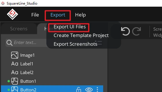

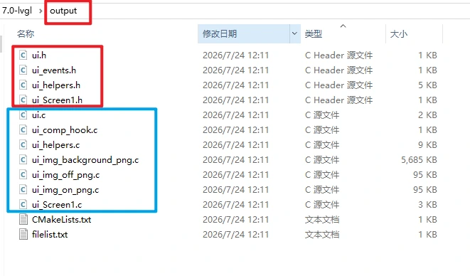

Click Export > Export UI Files. After the export is complete, ui.c, ui.h, ui_Screen1.c, the event file, helper files, and the image array file should appear in the target directory.
Export the UI files
image-20260724113447185

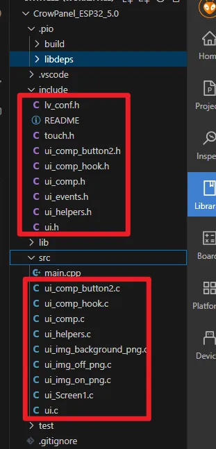

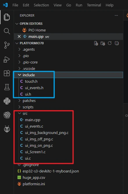

Add the UI files to the PlatformIO project. We need to add the UI files from SquareLine Studio to the PlatformIO project. The .c files of the user interface should be placed in the /scr folder of the project files, while the .h files should be placed in the /include folder.
image-20260727110158597
image-20260727110227278
image-20260727110258899
8. Expected Behavior
After the firmware is uploaded and reset, the LCD is first cleared to black, and about 300 ms later the backlight turns on and the 800×480 UI loads. The background image should display completely; two white integers appear slightly left of center on the screen, and the ON and OFF icons appear on the right. When the DHT20 is connected properly, the two integers update according to the temperature and humidity readings, respectively.
16
Tap ON with your finger and observe the interface response and the GPIO38 output state; do not touch the screen with sharp or conductive objects.
IMG_7937
IMG_7938
