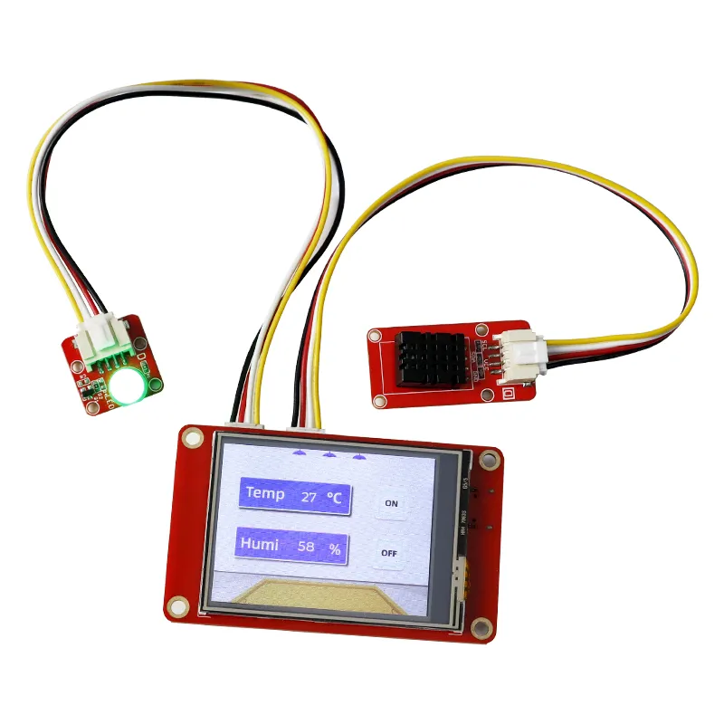

  • One CrowPanel ESP32 2.8-inch HMI development board.
  • One DHT20 temperature and humidity module, connected to GPIO22 (SDA) and GPIO21 (SCL).
  • One LED module, connected to GPIO25.
  • A 4-pin connection cable and a USB data cable that supports data transfer.

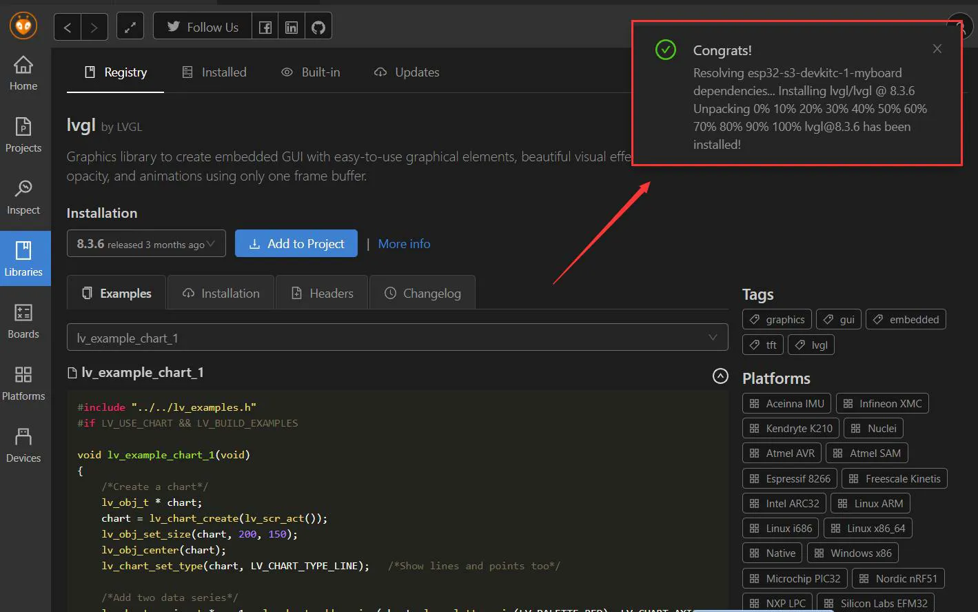

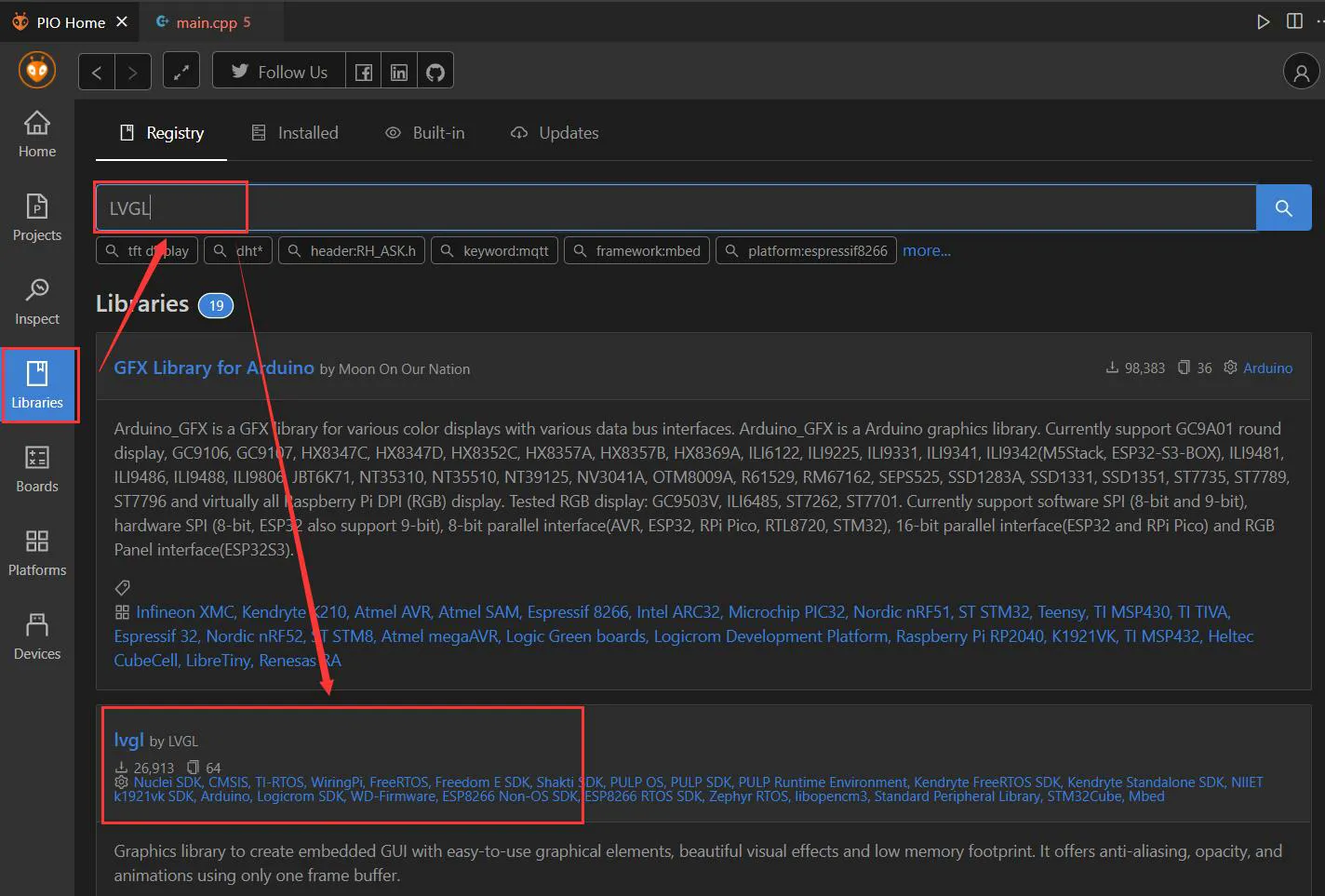

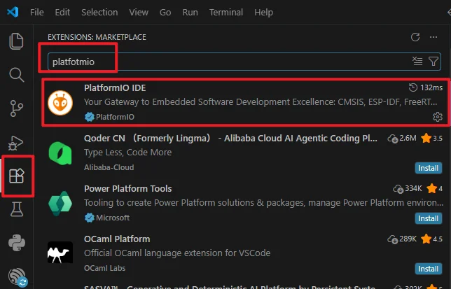

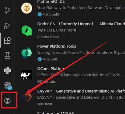

Open VS Code, search for and install PlatformIO IDE in Extensions.
image-20260723154828563

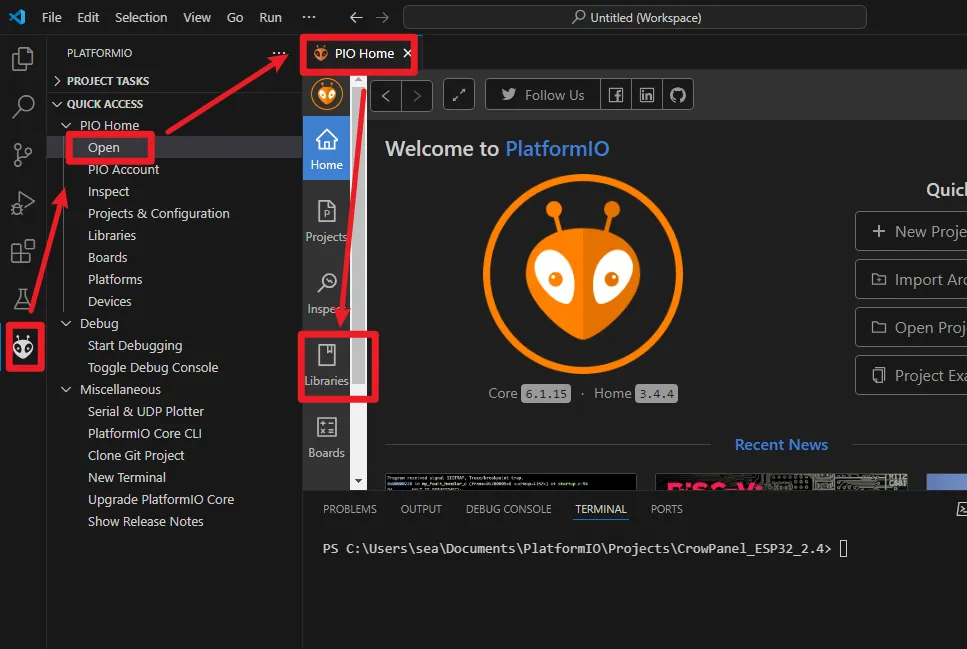

After installation, restart VS Code; the PlatformIO icon should appear on the left side. Click the icon to enter the PIO Home main interface.
image-20260723154858011

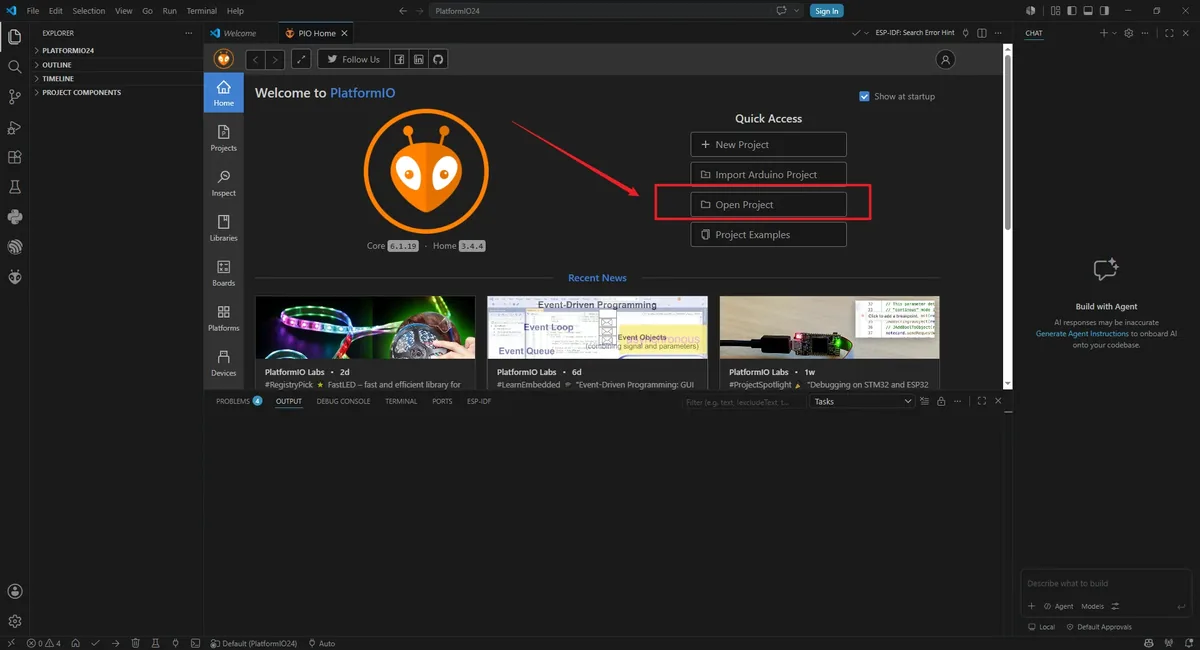

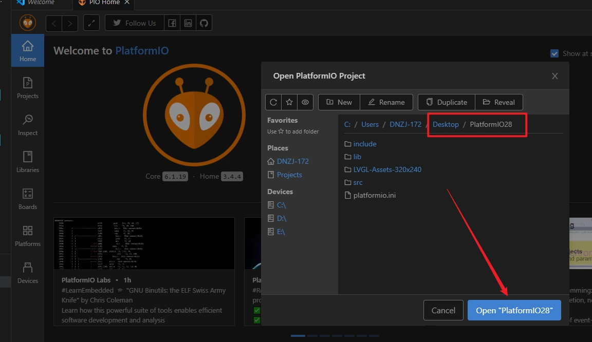

In the PIO Home Quick Access area, click Open Project.
image-20260723154324820

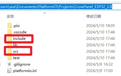

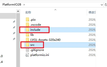

In the pop-up dialog, browse to the path and select the project root folder PlatformIO28 (the folder must contain platformio.ini), then click the blue button Open "PlatformIO28".
image-20260724173112582

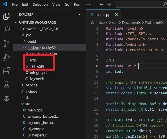

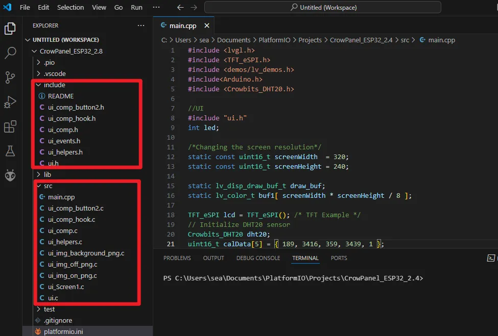

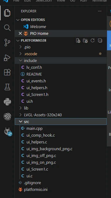

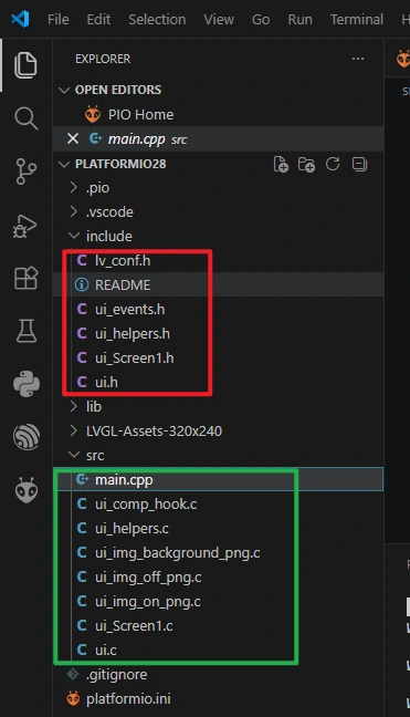

The project loads in the left-side Explorer

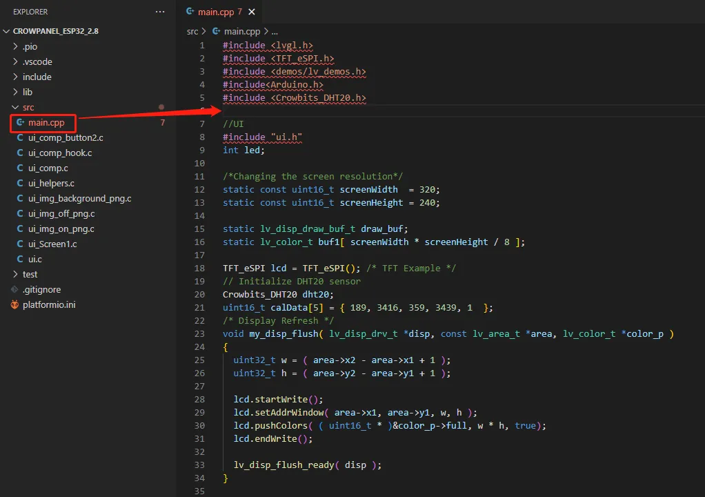

src/main.cpp: main program code
platformio.ini: platform configuration file
include and lib are dependency library directories
Open main.cpp to review the project code
image-20260724173141355

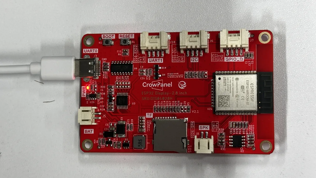

Connect the CrowPanel development board to a USB port on your computer using a USB data cable.

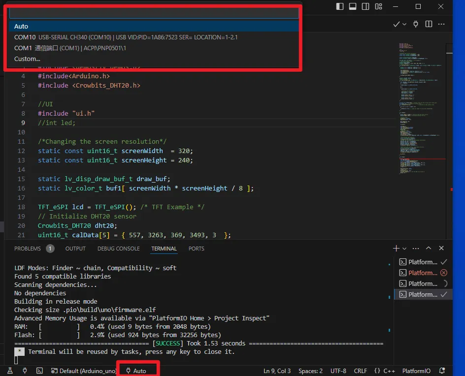

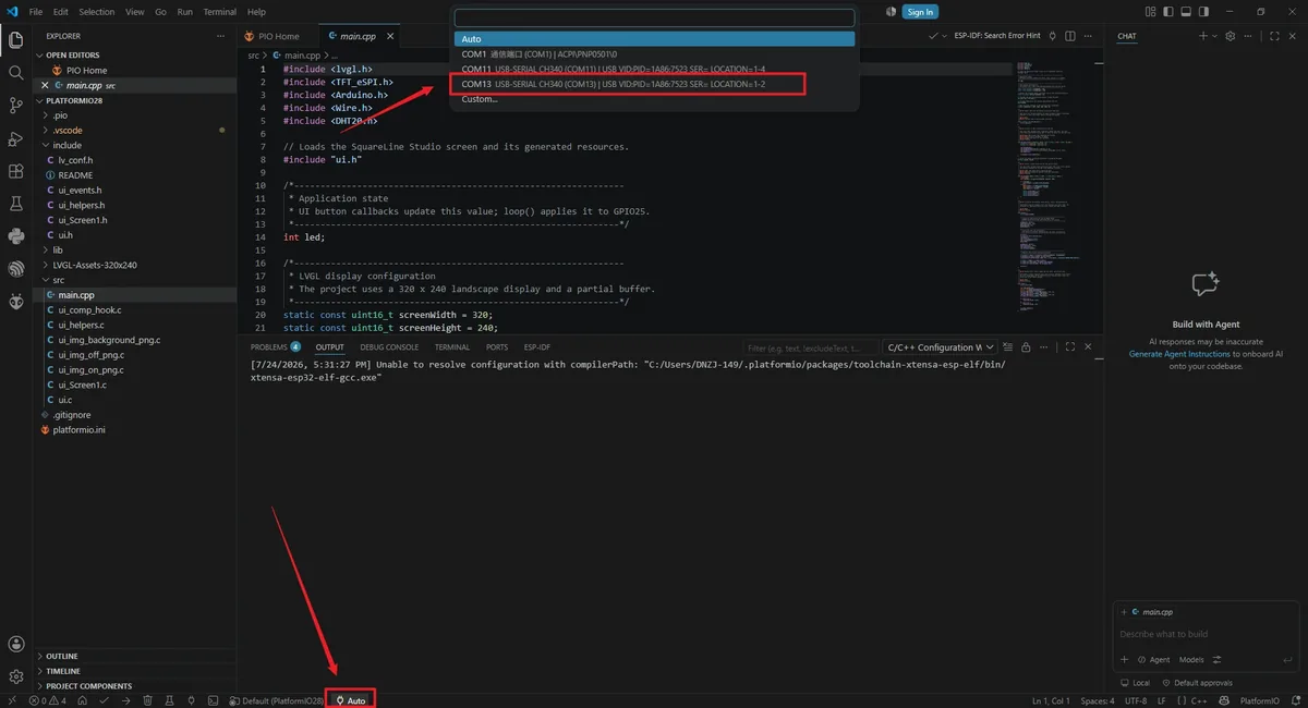

Select the device serial port: Look at the bottom status bar of VS Code; the dropdown on the left defaults to Auto. Click the dropdown and select the serial port corresponding to the development board (example: COM13).
image-20260724173414885

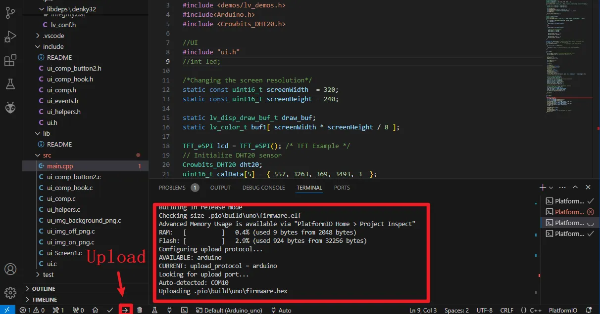

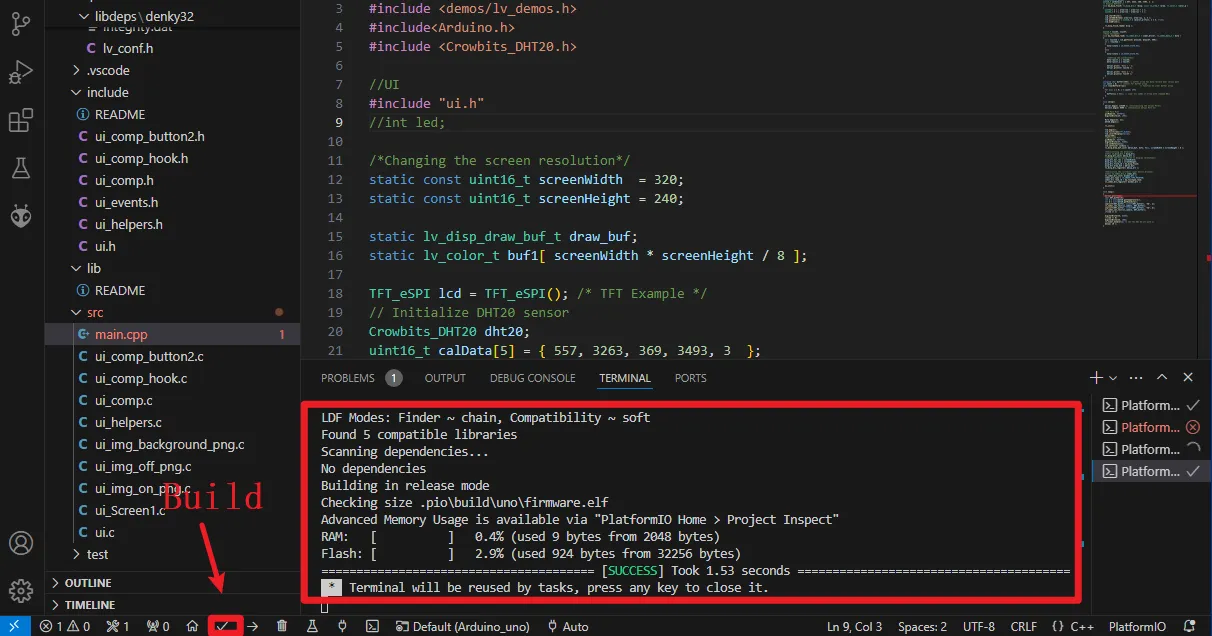

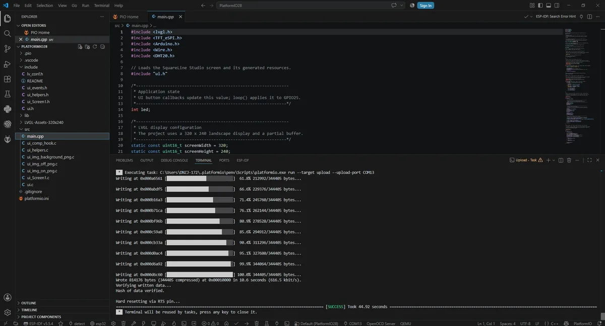

Click the right-arrow icon (PlatformIO: Upload) in the bottom status bar of VS Code. Wait for the compilation and upload process to run automatically.
image-20260724173506535
image-20260724173619773

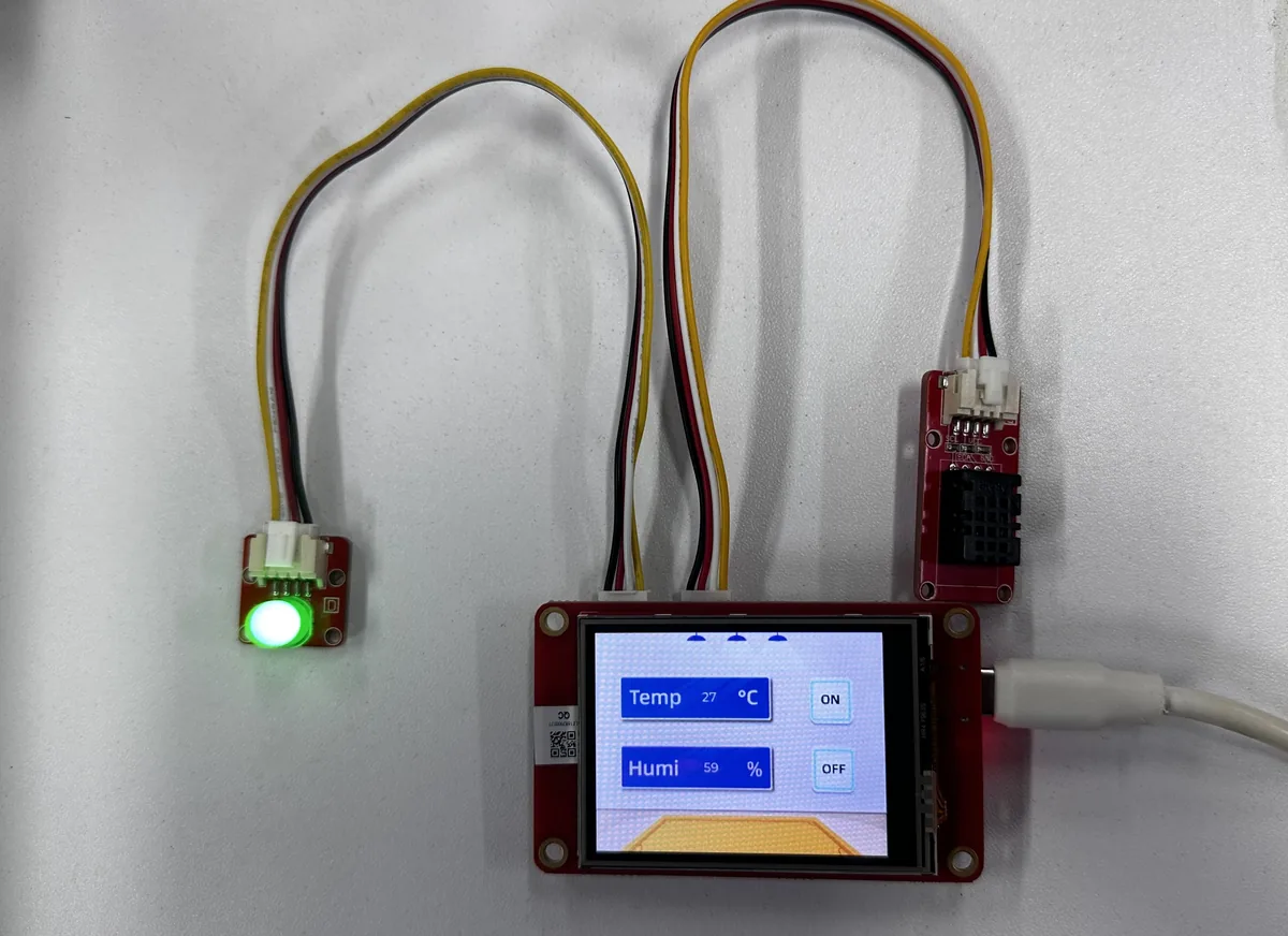

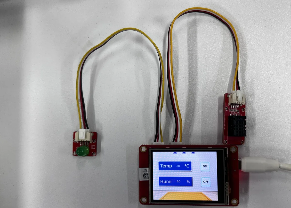

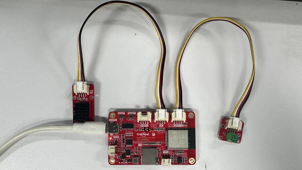

5. Hardware Operation Steps
Connect the wires as shown in the diagram:
  • DHT20 temperature and humidity sensor → main board I2C interface
  • LED module → main board GPIO_D interface
IMG_7931
Displays real-time temperature and humidity (data collected by the DHT20) and provides ON/OFF buttons to turn the external LED on/off.
PlatformIO flashing step 4
ON→LED lights up
17
OFF→LED turns off
18

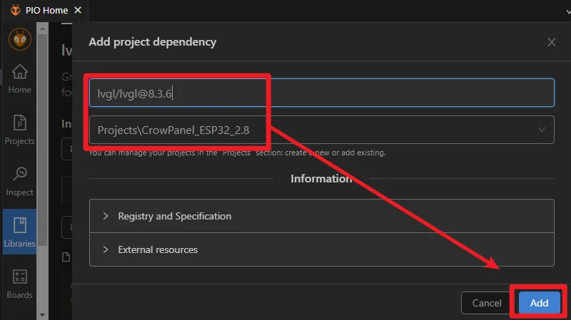

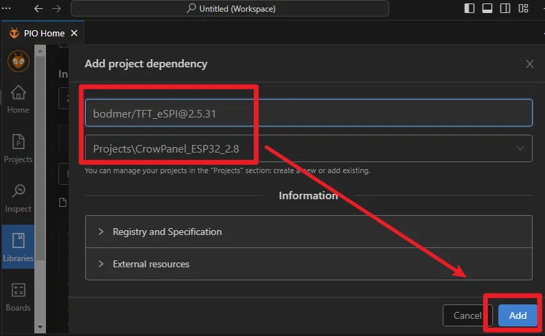

lib_deps =
    lvgl/lvgl@9.1.0
    bodmer/TFT_eSPI@2.5.31

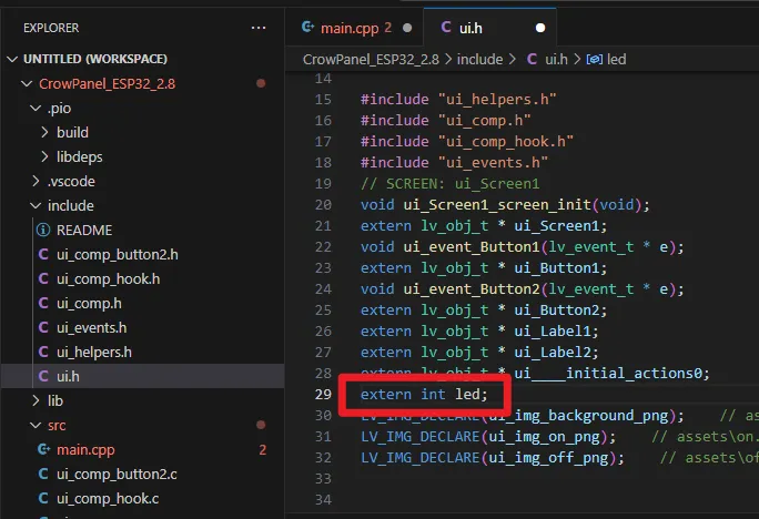

6.5 Button Events and GPIO25
// Shares the LED state with the PlatformIO application loop.
extern int led;
 * @brief Set the shared LED state when the ON button is clicked.
 * LVGL calls this handler for events from ui_Button1. The application loop
 * performs the physical GPIO write after the state changes.
void ui_event_Button1(lv_event_t * e)
    lv_event_code_t event_code = lv_event_get_code(e);
    if(event_code == LV_EVENT_CLICKED) {
        led = 1;
 * @brief Clear the shared LED state when the OFF button is clicked.
 * LVGL calls this handler for events from ui_Button2. The application loop
void ui_event_Button2(lv_event_t * e)
        led = 0;
When it runs and what it does: The button events in ui_Screen1.c only modify the shared variable led; loop() performs the GPIO25 output uniformly based on this variable. The source comments emphasize this division of labor: the UI callback updates the state, and the application loop handles the physical GPIO.

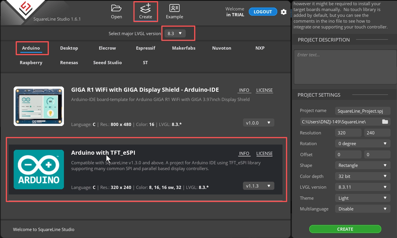

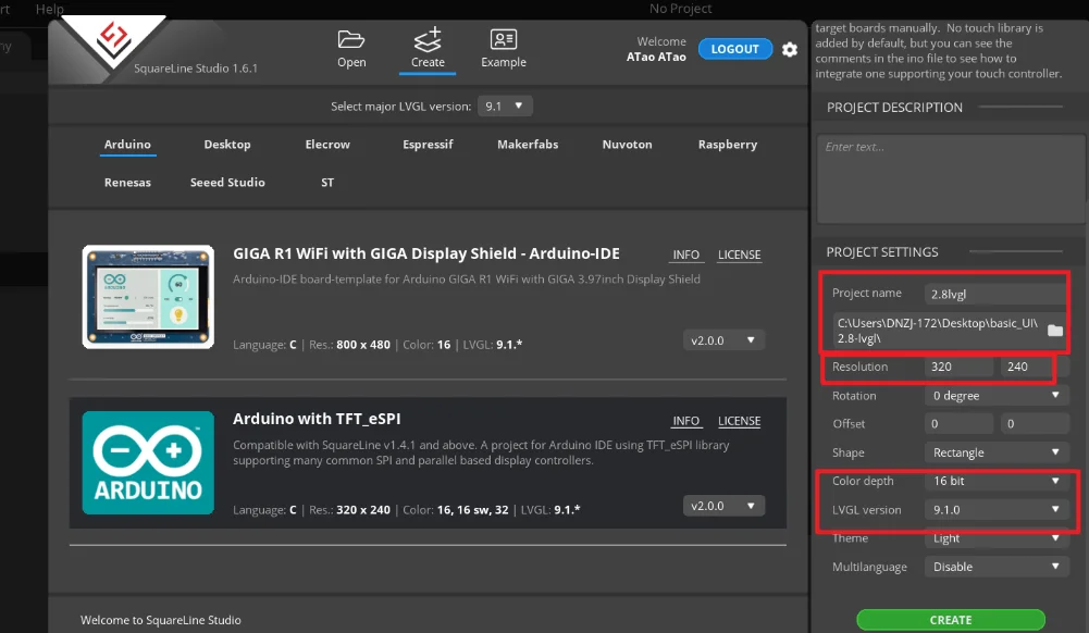

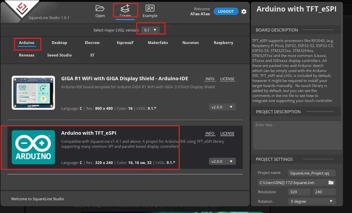

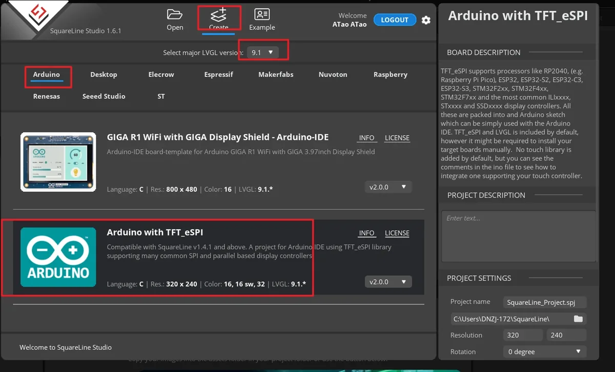

Launch SquareLine Studio 1.6.1, click Create, and select the Arduino with TFT_eSPI template for the Arduino platform. This template is responsible for generating the UI file framework suitable for Arduino and TFT_eSPI projects.
Note: When the Arduino framework is selected, SquareLine Studio displays only the Arduino with TFT_eSPI option. It generates template code suitable for TFT_eSPI, but SquareLine Studio also supports other graphics libraries; when switching to other hardware, you need to modify the display code according to the actual library.
19

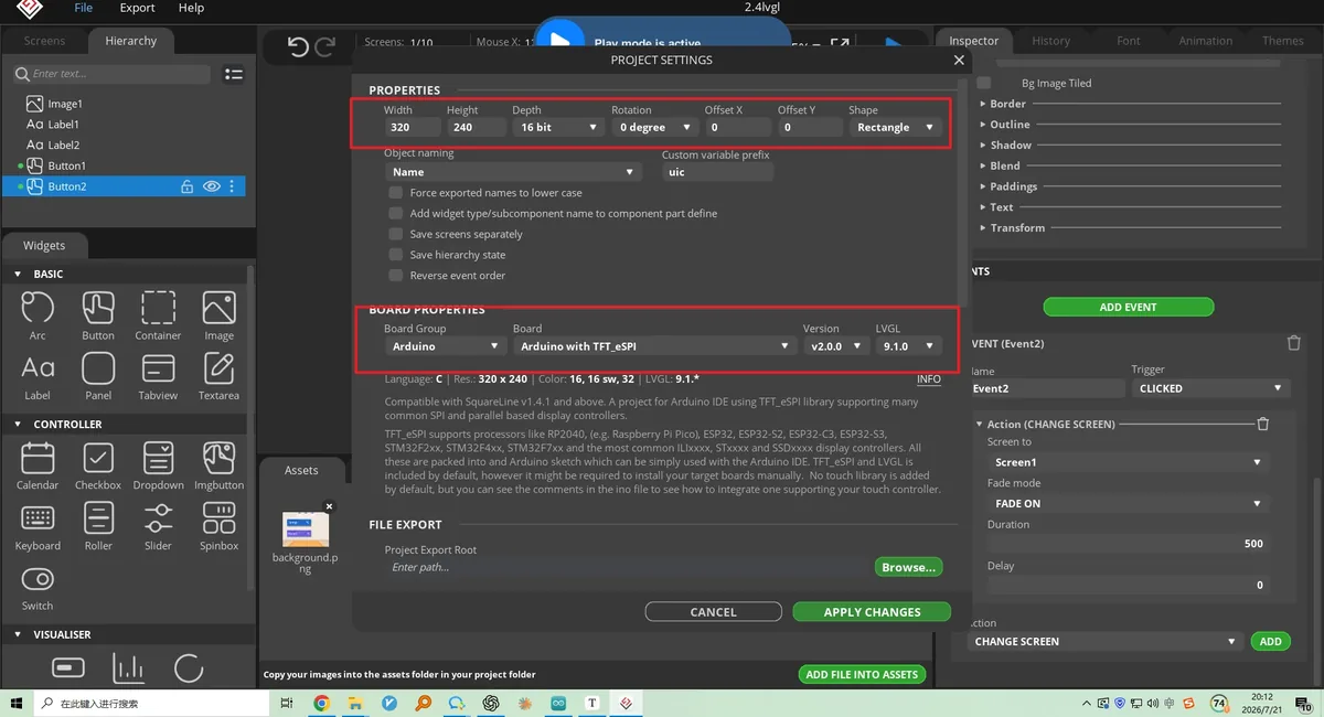

Enter a project name, set the LVGL version to 9.1.0, set the resolution to width 320 and height 240, set the color depth to 16 bit, then click CREATE. After creation, the canvas should be in landscape orientation at 320×240.
image-20260722182857564

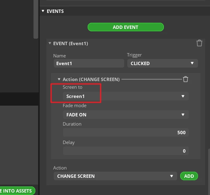

Select "CLICKED" as the trigger condition, and in "Action" choose the trigger event. It will be modified later in the generated program to implement LED control.
38
Caution: Because the buttons will ultimately control the LED on/off, you can add any event here first so that the exported UI file generates the button event code framework; the LED control code will be modified in a later step.
Complete this event. Here, I chose to switch screens, that is, switch to the Screen1 screen.

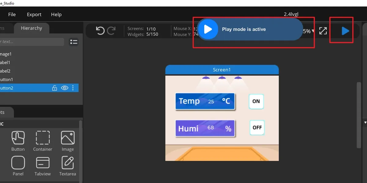

Click Run.

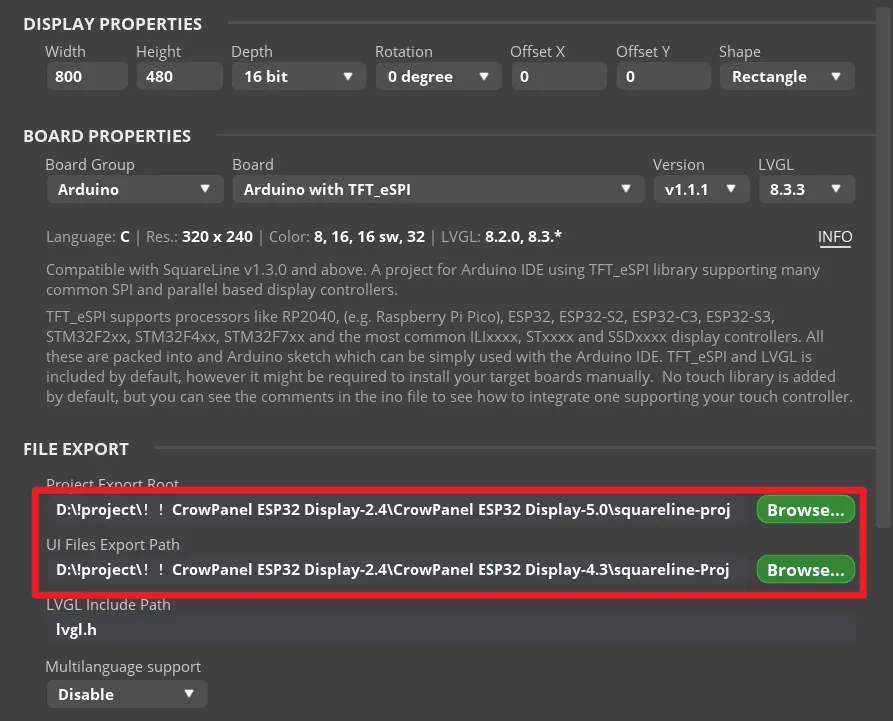

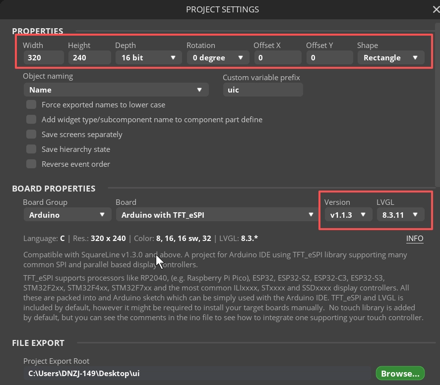

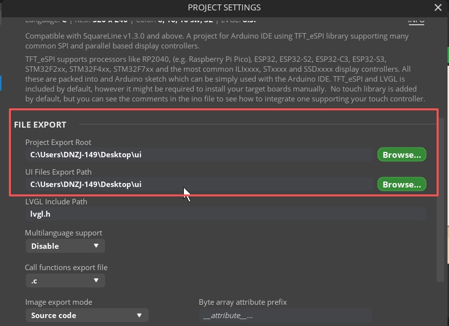

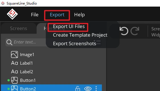

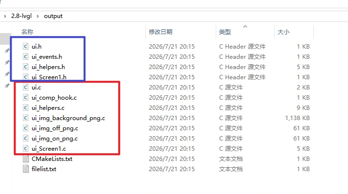

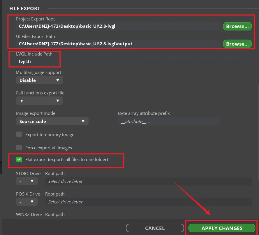

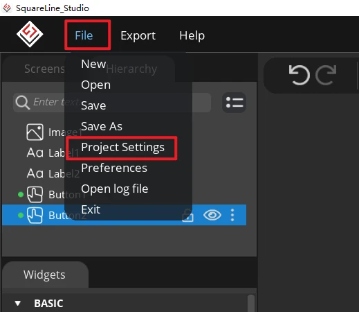

Open File > Project Settings, then configure the relevant settings for the exported files.

Set the export directory to an easy-to-find path consisting of English characters only, create a new output folder, fill in and confirm that the LVGL Include Path is lvgl.h, then click APPLY CHANGES.
image-20260723191231439
image-20260722183055936
Tip: After selecting Flat export, all output files are placed in the same folder, so the program does not need to modify file paths. If Flat export is not selected, files are scattered across different folders and the compiler may not recognize them automatically, usually requiring manual path changes; therefore it is recommended to keep it checked.
Click Export > Export UI Files. After the export finishes, the destination directory should contain ui.c, ui.h, ui_Screen1.c, the event files, helper files, and the image array file.

Add the UI files to the PlatformIO project. We need to add the UI files from SquareLine Studio to the PlatformIO project. The .c files of the user interface should be placed in the /scr folder of the project, and the .h files should be placed in the /include folder.
image-20260724173918734
image-20260724174105271
image-20260724174014980
8. Experimental Results
After the firmware is uploaded and reset, the LCD is first cleared to black; about 300 ms later the backlight turns on and the 320×240 UI loads. The background image should be displayed in full, two white integers appear slightly left of center on the screen, and the ON and OFF icons appear on the right. When the DHT20 is connected properly, the two integers update with the temperature and humidity readings respectively.
16
ON -> LED on
17
OFF -> LED off
18
