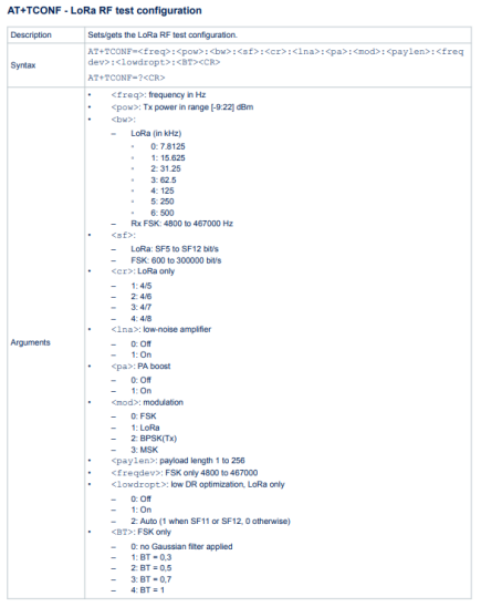

1. Configure the transmitter and receiver
Basic configuration of the receiver and transmitter using serial port tools.

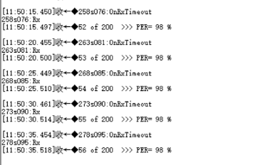

2. Receiving end settings
AT+TRX=2 (the parameter is the number of receipts, the maximum number is 2147483647)
3. Setting the transmitter
AT+TTX=2,ffff (the first parameter: the number of times to send, the maximum number of times for 2147483647; the second parameter for the hexadecimal data sent, the maximum 254 bytes, the number of even)
4.Exit P2P Test
