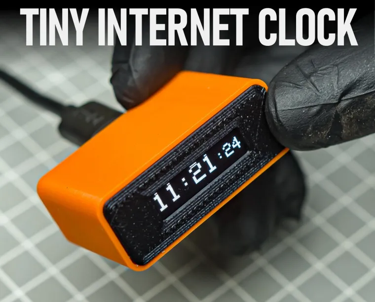

Tiny Internet Clock
In this project, we will build a tiny internet clock connected to your wifi to get time from NTP servers.
Tiny Internet Clock
  • XIAO ESP32C3
  • 0.91 Inch 128x32 OLED LCD Display

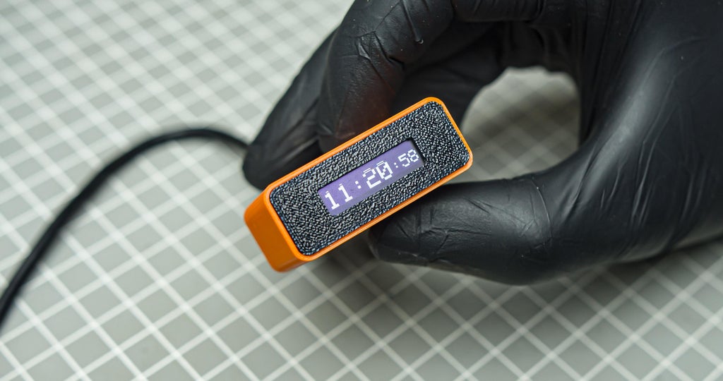

Step 6: Test
Test
Please connect the USB cable to power the device, which will automatically update the time.
