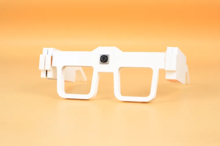

In a world where communication barriers persist for individuals unable to speak, sign language stands as a vital means of expression. However, the necessity of a third-party interpreter often impedes spontaneous and natural communication, posing challenges for seamless interaction. To address this prevalent issue, we've developed an innovative electronic device equipped with AI technology capable of detecting hand symbols and translating them into audible speech in real-time. Powered by the VIAM app and the Raspberry Pi Zero, our aim is to empower individuals who are deaf or hard of hearing to communicate more freely and independently, eliminating the constant reliance on interpretation assistance.
The electronic device we've created takes the form of wearable spectacles, providing a practical and discreet solution for communication barriers. Designed to be worn by individuals with disabilities, the spectacles seamlessly integrate into everyday life, allowing users to communicate effortlessly with those who do not know sign language. This wearable design not only enhances accessibility but also promotes a sense of independence and autonomy, empowering users to express themselves confidently in various social and professional settings.

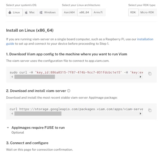

So we can start creating our smart machine. The process is pretty simple. First we logged onto the VIAM app and created a new machine. Then we installed the VIAM server by running these commands which are given in the image below. Just follow this guide if you have any doubts.
Once the Viam server successfully starts running on the Pi Zero 2W, you can see the device's online status on your dashboard.

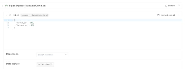

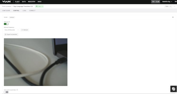

So it's time to add the camera component, then only we can capture the image of the signs. csi-pi module is used here to get that job done.
This module easily integrates CSI Cameras into your Viam projects using this camera module. These are the attributes given.
The camera is working perfectly. The below image shows the live view from the camera that is accessed in the control tab.

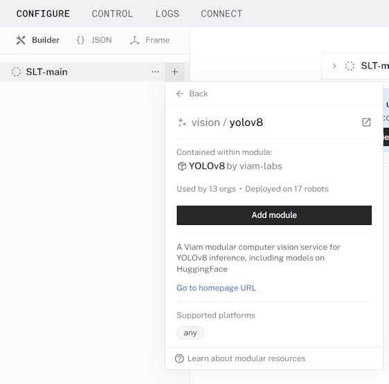

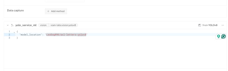

While Viam's default mlmodel vision service is compatible with Tensor Flow Lite models, this project employs a YOLOv8 model. To achieve this, we'll utilize a module from the modular resource registry designed to enhance Viam with YOLOv8 integration.
With the YOLOv8 module, we have gain the capability to leverage any YOLOv8 model seamlessly to the Viam machines.

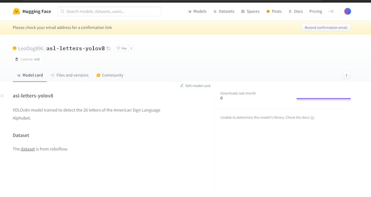

We have used a yolov8 model from the hugging face that is capable of reading the 26 letters of American sign language alphabets.

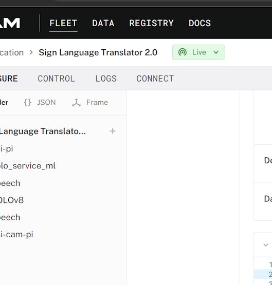

So we added the yolov8 module.
In the attributes field of the vision service, we just put our model location.

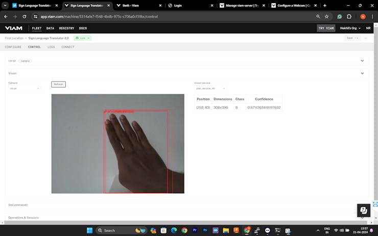

It's time to test the vision service. Here is the output shown on the control tab when the letter b is shown to the camera. It is working perfectly.

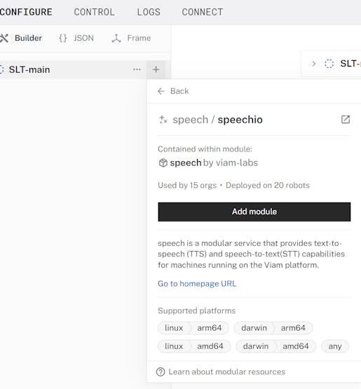

So we can detect the sign language letters. Next, we need to add a text-to-speech service to speak these letters.

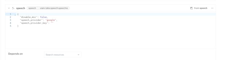

For that, we used the speech service from VIAM. It is a modular service that provides text-to-speech (TTS) and speech-to-text (STT) capabilities for machines running on the Viam platform.
We have used google as the speech provider. The below image shows its remaining attributes.
So we added all the required services and components to the Smart machine.

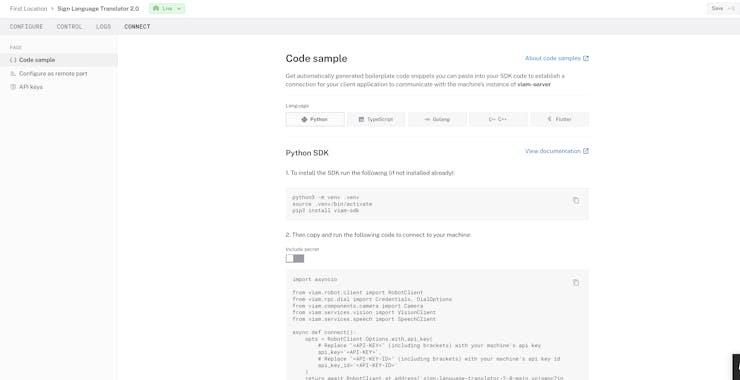

To run this project we are using their Python SDK and they also provide a 70% completed code snippet to get started with. To install the Python SDK just go to their connect tab.

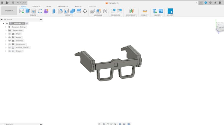

The case for this project is designed on the Fusion 360 and 3D printed with the PLA filament.
So let's start assembly. Refer to the images below for the assembly.
This is the thing we got after the assembly
