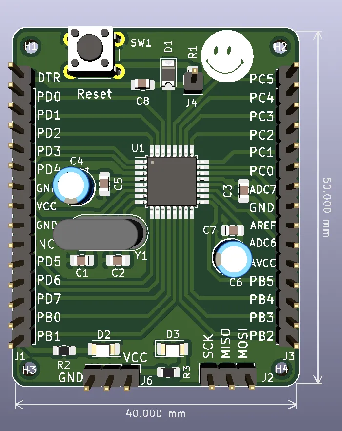

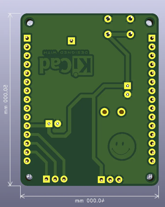

For some time I wanted to make simple board versions with ATMega uC, even if I don't make them in small sizes like the Arduino Nano, I wanted to have a board containing only uC and pin headers. Why? Because I need to have quantity, and the constructions are advantageous to me. This particular board contains an ATMega8AU-TH, I bought several pieces cheaply from a well-known source Grin. I made a PCB in KiCAD, later I multiplied it. It's not a grade 10 PCB, but I'm satisfied. I also had an adaptation problem, I found a promotion for the manufacture of PCBs, and I tried to import the project on an online platform, in order to later place the order with the manufacturer, only that the import was performed incorrectly, I did not realize it , and when I received the PCBs I noticed (not at first glance) that the top-bottom GND plan is not interconnected, and that's it. In the end, I did the top-bottom interconnection manually.
You can find the PCB below. I must mention that D1, C8, R2, D2 are no longer needed for this version. The board is in two layers, with dimensions of 40*50mm. Initially I started with only TH components, and I kept the proportions, but later I also added some SMDs. I know that it's a rather robust board, and about twice as big as an Arduino Nano, but it's still useful for me.

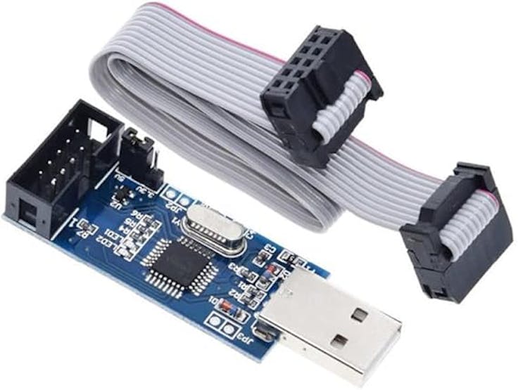

I tried to program uC in 2 ways. The first way was with FTDI programmer, but I didn't succeed, I tried to upload a bootloader in this uC but I didn't succeed and I tried various methods, still without results. I have previously done this with an ATMega8 DIP version, I think it is an ATMega8A-PU. What do I do in this case? This was the only method I had tried, until I found another source of information, this guy uses an AVR USBASP Programmer (thank you for this), and I think hmm, interesting, I think I have something like that through THAT BOX! I have collected some things that I keep in boxes, sometimes I forget if I have something or not and I buy it again, then I find it Laughing.
I installed the driver to be able to use AVR USBASP and I get to work.
So, the programming method is like this: after identifying the pins, I make the connections between the programmer and uC. In my case I use ATMega8AU-TH, and I can use this diagram to recognize the pins:
I have a 10-pin plug on the board. These are simple connections, just use jump wires and that's it.
